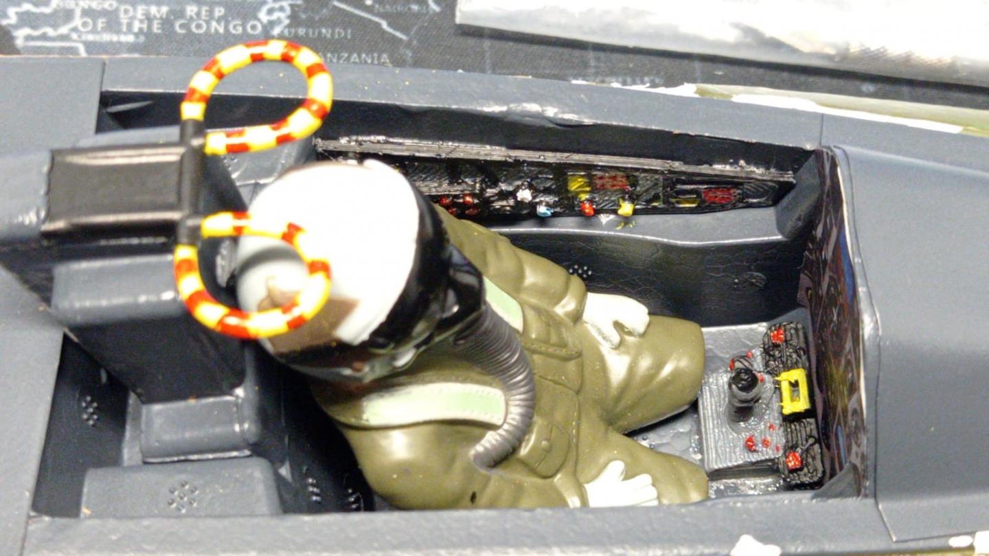

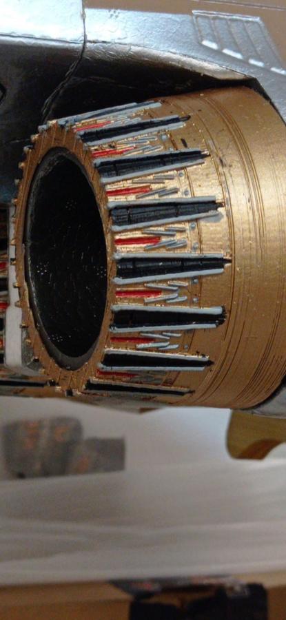

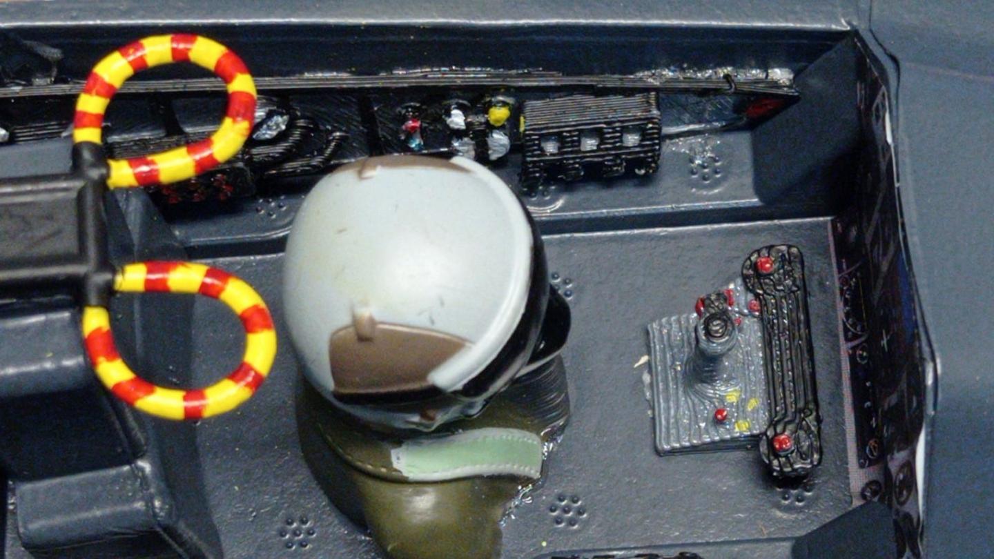

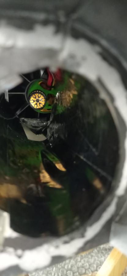

          Love it man!

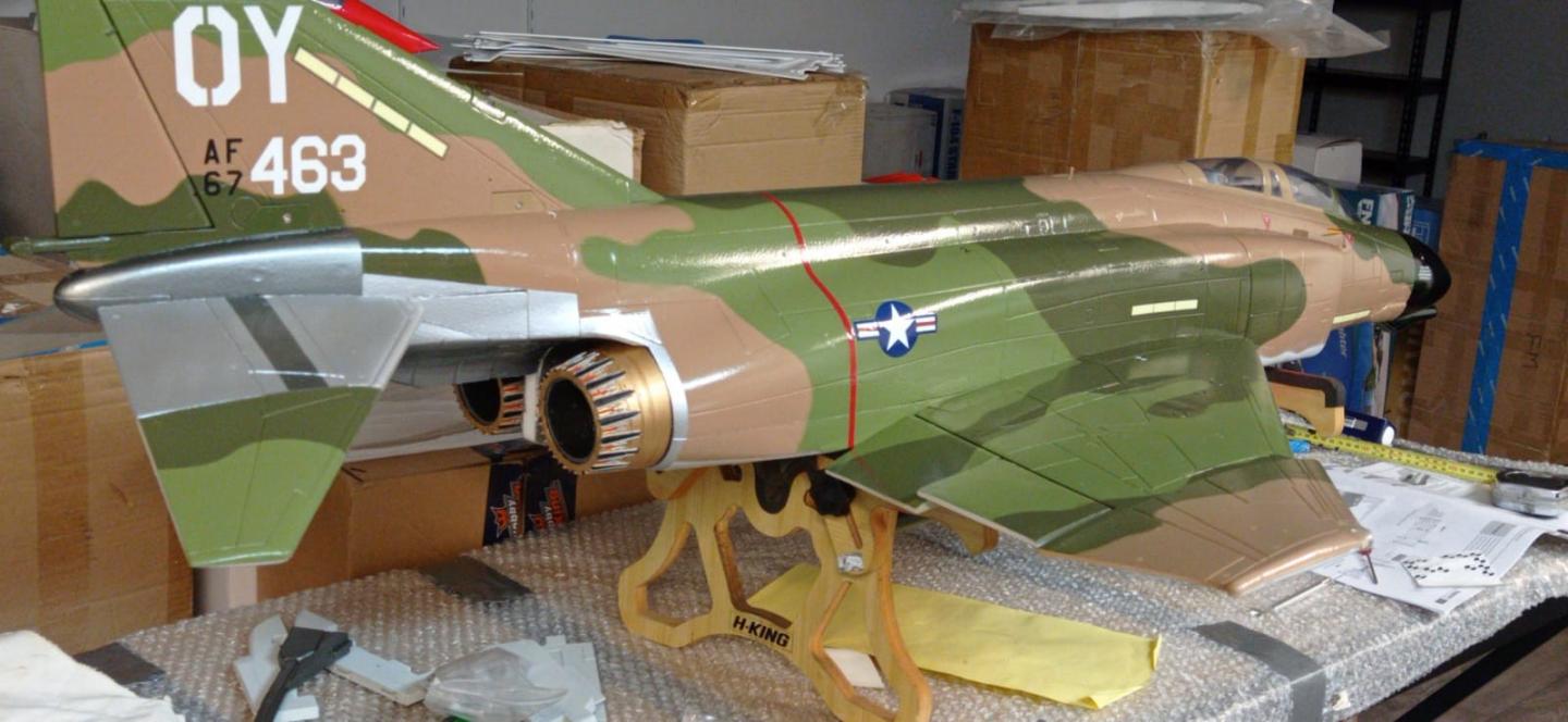

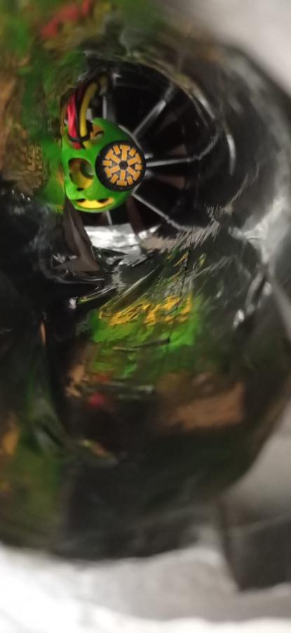

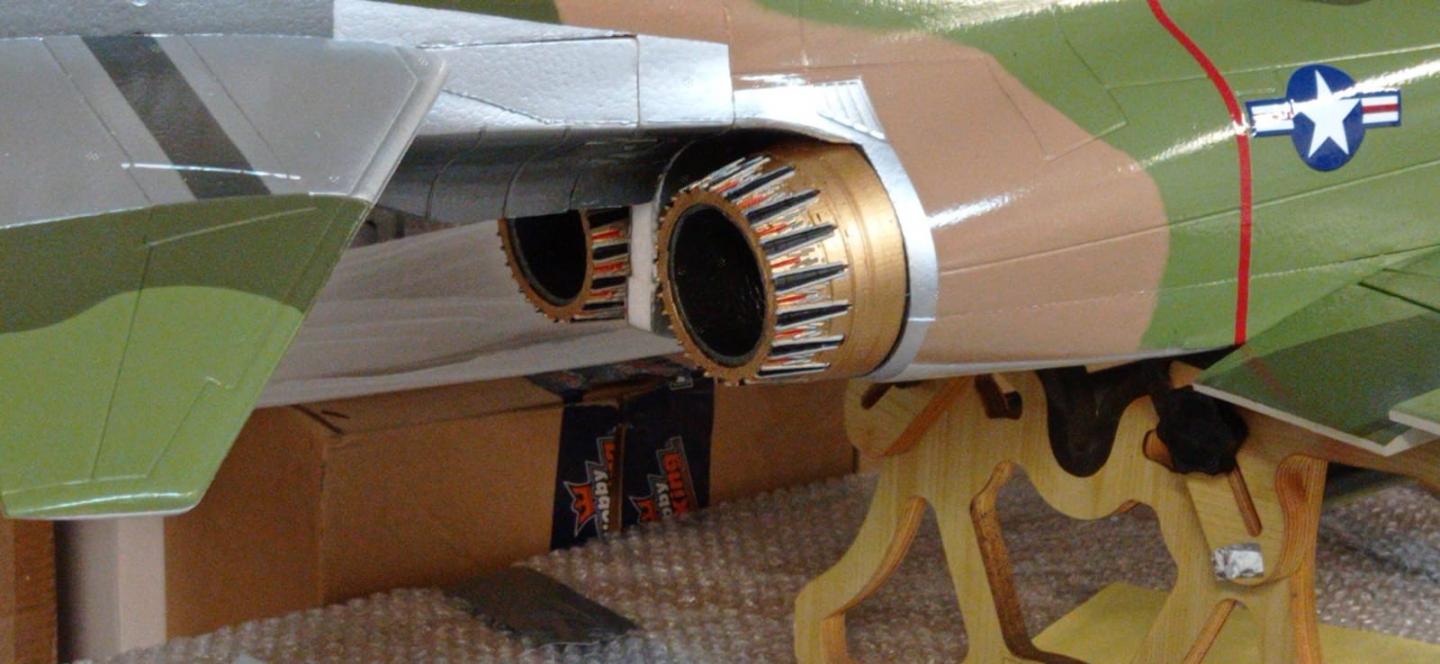

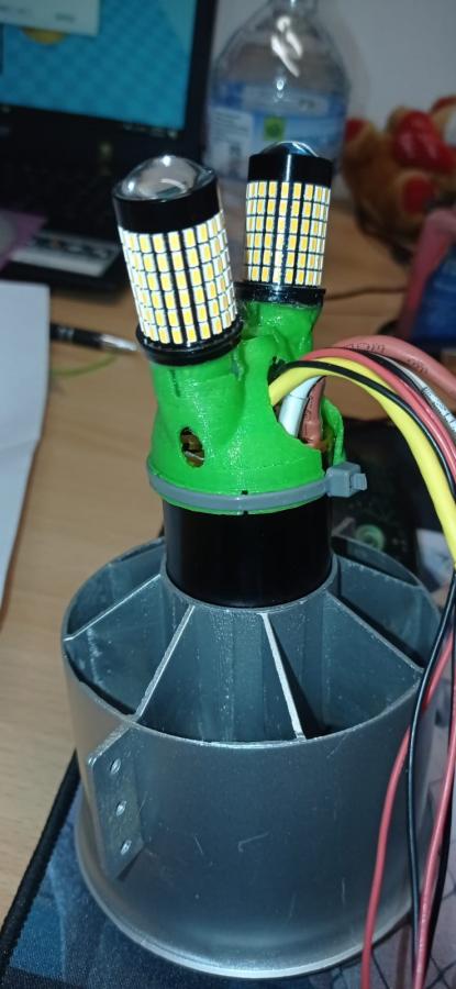

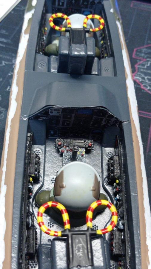

          Nice dude.
          I have done something similar but not the pilots the original ones look good I did 3D printed instruments and controls,also 3D printed exhausts. ,& a duel 144 led center burner.
          Check it out.

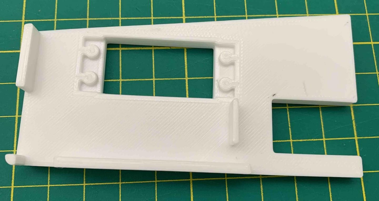

                          Hi guys.
                          If somebody of you have to fixe the elevator servo after some flights or directly out of the box. I have made a 3d printed thing.
                          You must not remove the servo. The part will be glued over the servo.
                          Have alook on thingy: Link: https://www.thingiverse.com/thing:4819088
                          You can find it under: Reinforcement elevator servo of the 1:11 Freewing F-4 Phantom
                          Here are some pics...
                          Hopefully I can help some of you guys. This is my first post here, but I read a lot in here for my Freewing planes. Greatings from Germany.

                            PE, Welcome to Hobby Squawk. Thank you for the 3DP Elevator Reinforcement print/part. You are definitely going to fit in here, glad to have you onboard. Best, LB

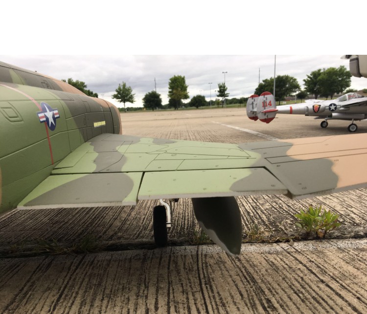

                                      Congrats! Gear down and tanks + missiles on + canopy on + right side up....CG by the manual is an OK starting point. I’ve never changed it. But she will drop her nose on approach when you chop the power at factory CG. So, you might experiment with moving it back a little as time goes by. Consider gluing on the tanks...they may otherwise depart the plane when bumps are hit on roll outs.
                                      Quick tips:
                                      • Search “ferrite” or “choke” or “RF choke” and read/learn/buy/install these. Failure to do so....risk a loss of control crash due to the RF noise of the high current ESC. Ask me how I know.....lost an A-10 and an F-4 before I began to use them.
                                      • Use a 4-40 threaded rod and heavy duty Du-Bro ball link and clevis. DO NOT use the stock stuff in the tail. It will either bend or break. Well documented in this thread!
                                      • Make sure your elevator servo is glued in securely.
                                      • Set up the flap and elevator mix exactly per the manual
                                      • Set the elevator trim exactly per the manual
                                      • Use Lock Tight on the full flying stab’s hardware....keep it away from all plastic
                                      • Buy some extra nose gear pins....brittle metal...they break
                                      • Embed a metal skid of your design into the bottom of the nose radome for when the nose gear pin snaps on a hard landing. A couple of pieces of the kit’s steel pulling wire works.
                                      • Keep her outa the sun when sitting to help keep the nice finish from gatering.
                                      • Reduce to 50% on down wind then about 15% to 20% on final. Gradually reduce to cut-off once in ground effect and be ready for the nose trying to drop a bit. Bring her in fairly flat until you get a better feel. She’s not a floater. Touch mains first but not too nose high.
                                      • If you get a nose high bounce, go around. If you get a crow hop going...trying to save it, the nose gear pin will snap on a bounce.
                                      • No need for flaps on take off. Use full flaps on landing. She’s a ground hugger on take-off...get speed up and you ease her off. She won’t fly off by herself.
                                      • Get the RX antenna as far forward as possible and away from the ESC.
                                      • Add some hot glue beads to the inside periphery of the lower part of the main gear doors. Make sure this doesn’t interfere with the door fit upon closure. This helps prevent door breakage when they contact the runway on a less than perfect landing. Add some hot glue around the bottom screw post area on the door, too.
                                      • Every FW F-4 I have ever flown (several) has required a bit of right aileron trim. Might as well throw in a few clicks of trim before the first take-off to reduce your “surprise” at lift-off...see photo below. An amount equal to 1/2 the trailing edge thickness is a good starting point.
                                      • Once you get her trimmed, put a small mark on the fuselage aligned with the FFS. This gives you a visual checkpoint pre-take-off to see all is RIGHT. Smack the FFS on something, and you might cause a servo horn tooth slip. Then your next take-off will be VERY interesting. Ask me how I know....
                                      Have fun—You will like it! Nothing looks like an F-4 in the air!
                                      Crash history to help you NOT crash....
                                      #1 Elevator servo not glued in. It came out during a flight. Repaired. CHECK THIS! Add more hot glue!
                                      #2 Same bird....elevator ball link broke after many, many flights. Total loss. UPGRADE TAIL HARDWARE!
                                      #3 New F-4 went down when a loss of control event happened. Total loss...Not using RF chokes at the time. Lesson learned.
                                      Happily flying bird #3 for about 1.5 years and well over 1,000 flights. The elevator servo stopped working a couple of weekends ago on final. Bad servo verified in the post crash analysis...intermittent. Repaired...in the air again. Flying good as new. New tail servo, and I did replace all the landing gear to be on the safe side. Strong design! She went in at about 45 degrees from 50 ft up and broke her back at the intakes. Amazingly little damage. The gear and under-wing stuff was wiped away. Sooooo lucky it was low and slow.
                                      -GG
