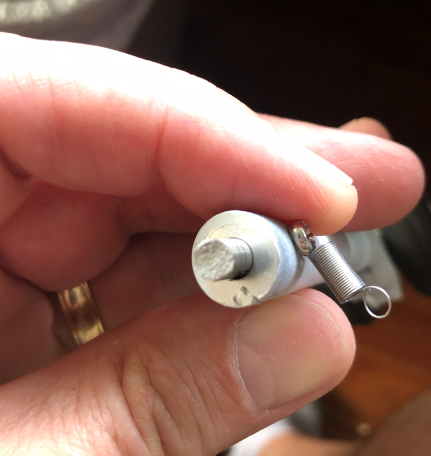

                                  Nose pin upgrade? Some make one out of drill pin blanks or other stronger materials. When mine snapped on a easy paved landing I replaced it with the F-14 one and that has been flawless since. But that was when they first came out and I'm not sure they haven't changed the stock one or the replacement F-14 one since then.
                                  Hey Evan.... I know right... totally blown away that mine snapped as easy as it did.

                                    Oh and I took a pic of the broken pin. Looks like pot metal.

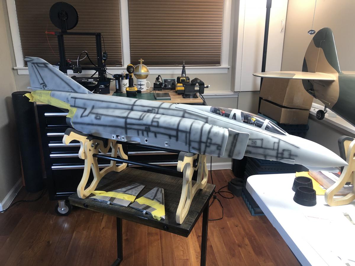

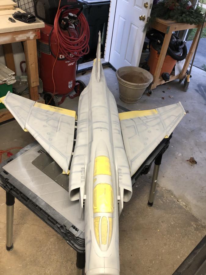

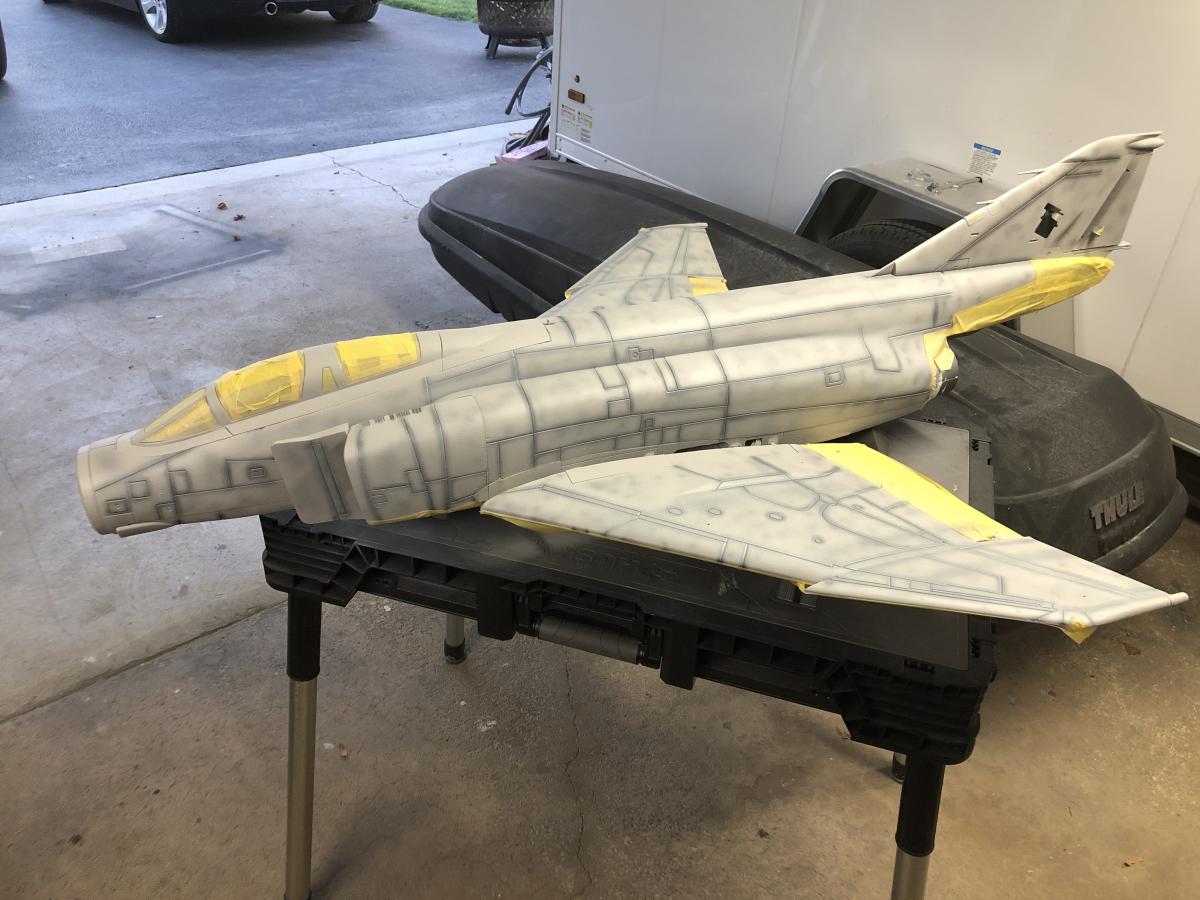

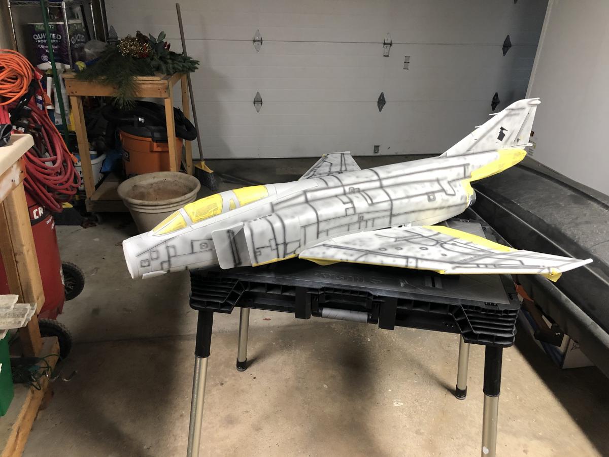

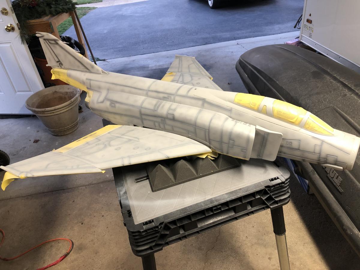

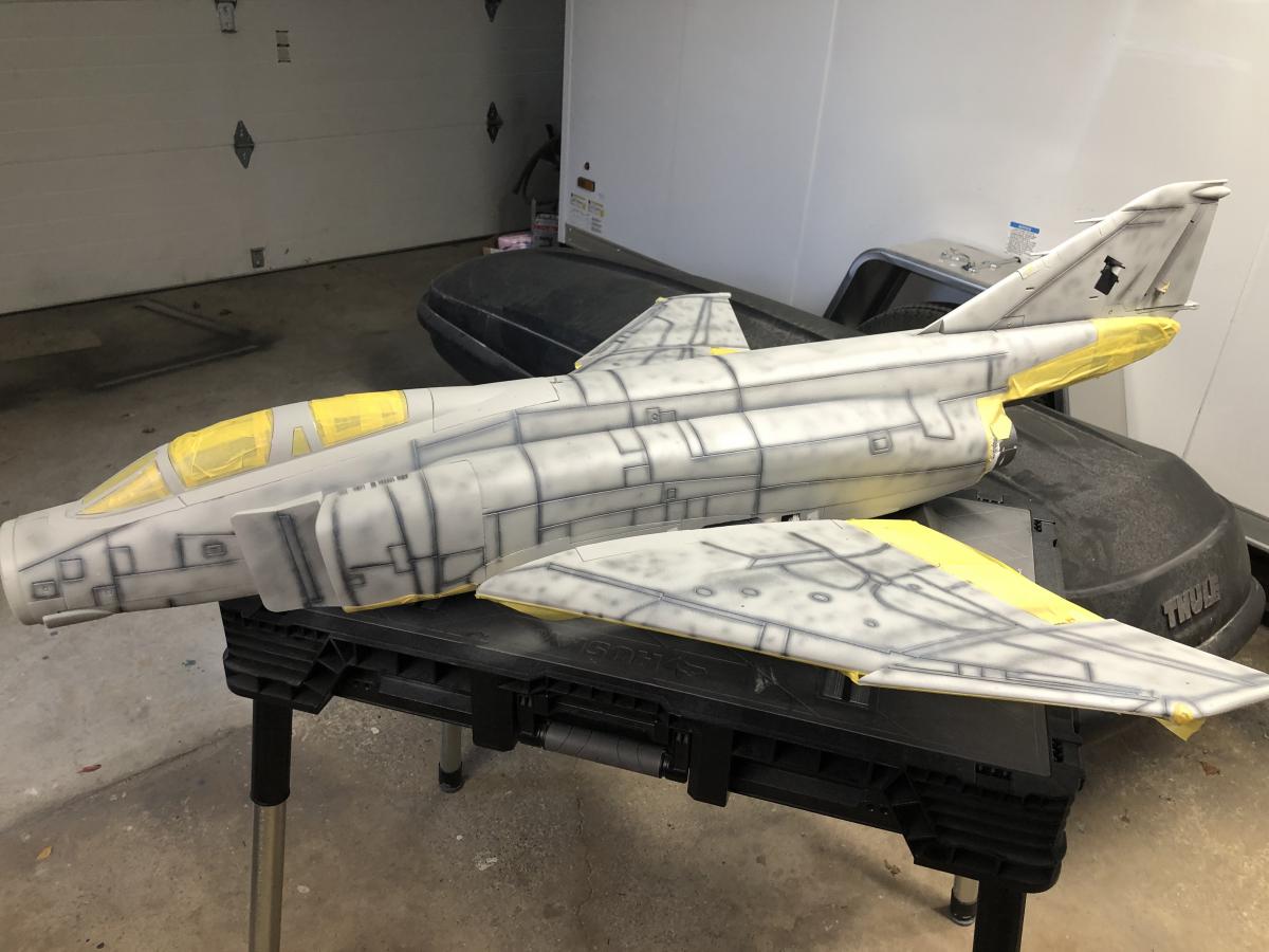

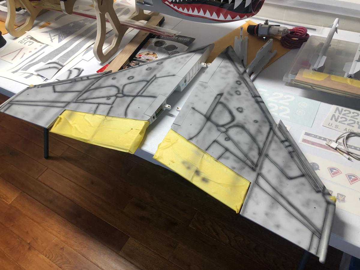

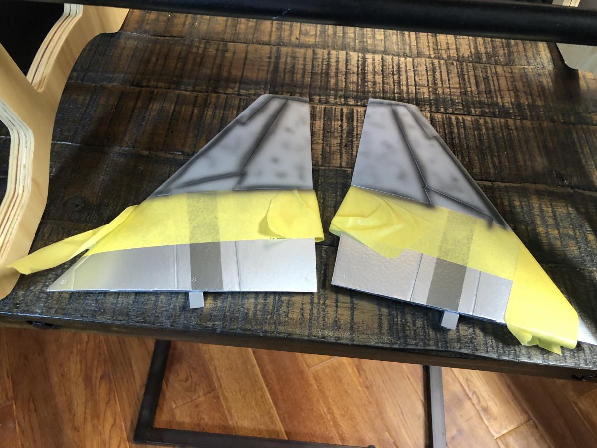

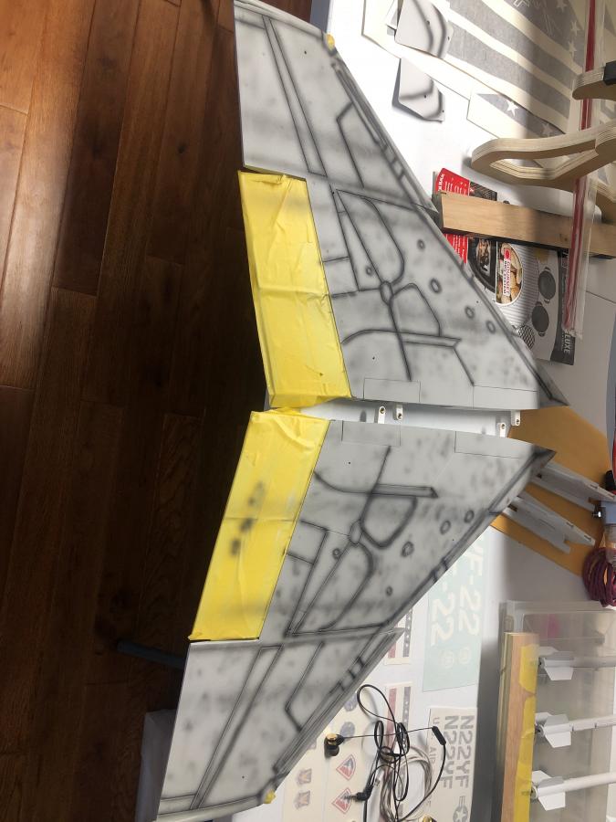

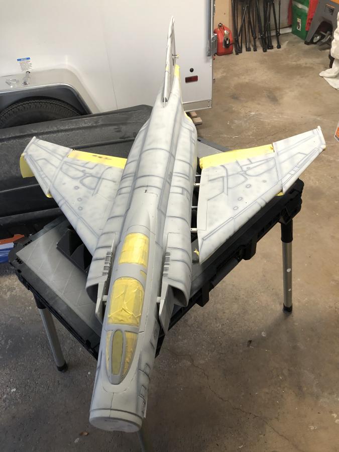

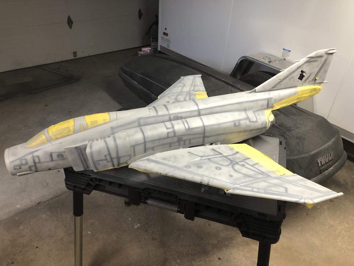

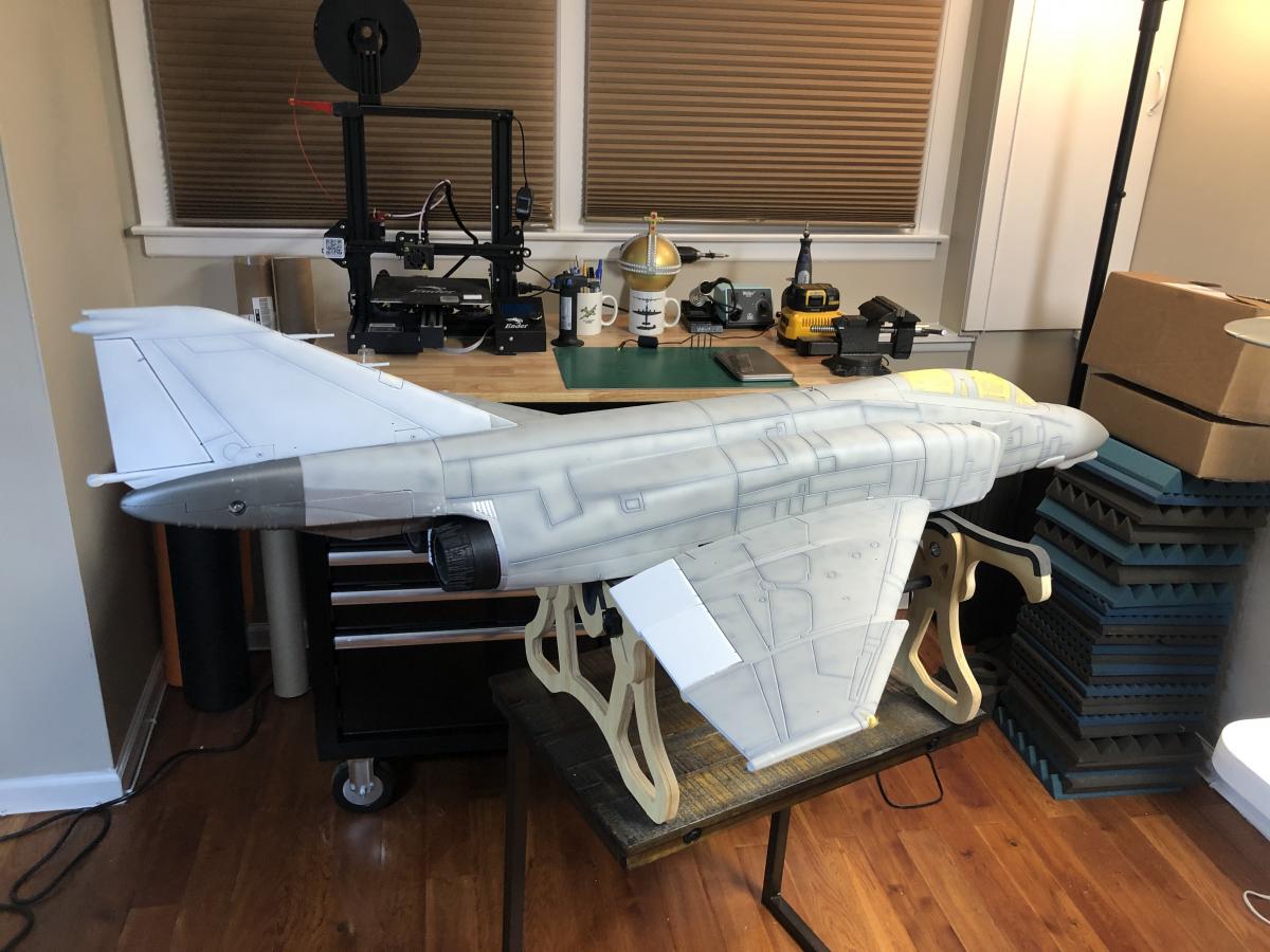

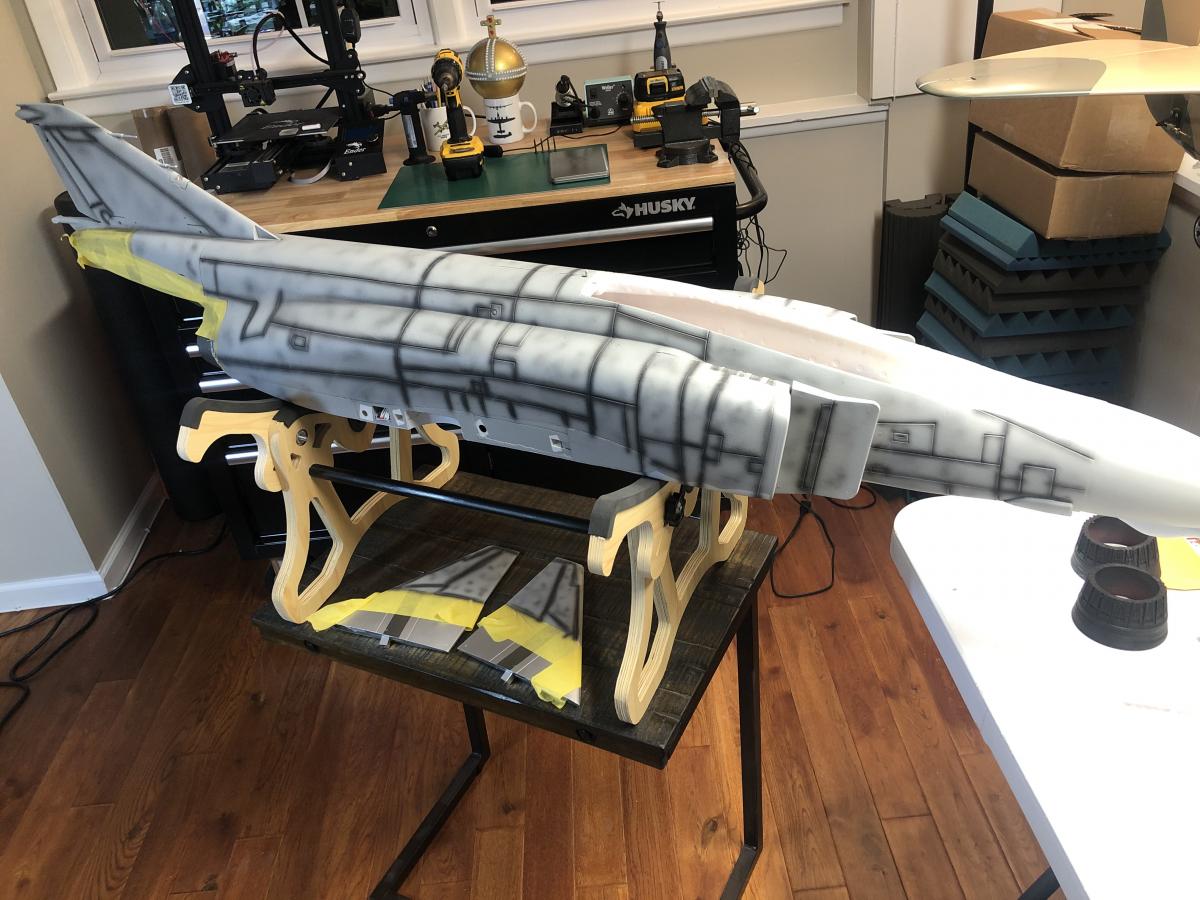

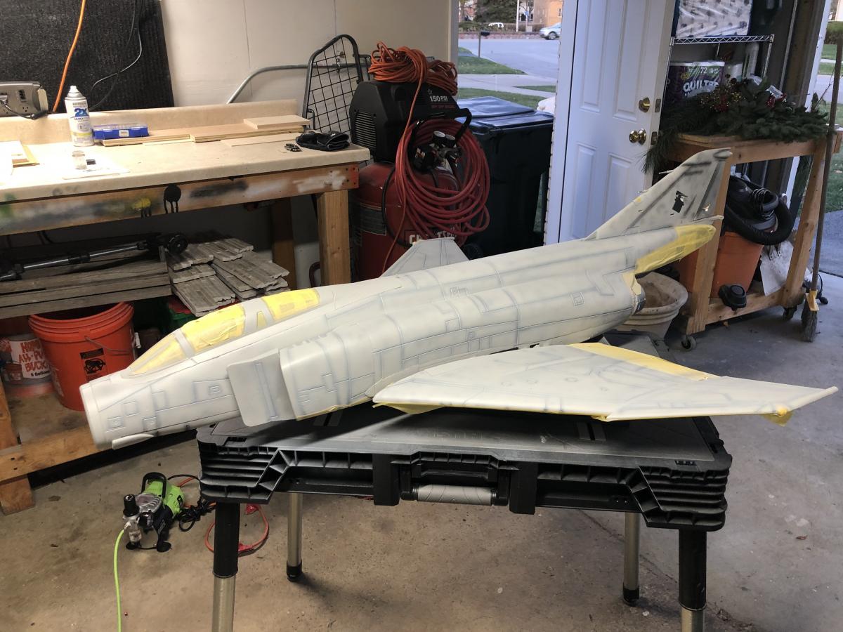

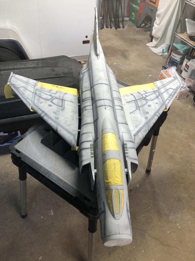

                                      Here is the loose process of pre-shading and over-spray. The pre-shade is just Vallejo grey-green thinned for airbrushing. I tried to order the pics to show a progression of softening the starkness of the original pre-shade. I am undecided if there is more softening to do. I will take her out in the sunshine today to see what's what. Plan to hit it with Poly to prep the surface for the Callie graphics, then apply a nice flat clear to even everything out.
                                      Tools: Grex T3 airbrush and Grex compressor.

                                        e4dragongunner - Stunning work! Can't wait to see the final

                                          E4, Now that's what I'm talkin' about. Lookin' good, Sir. Best, LB
