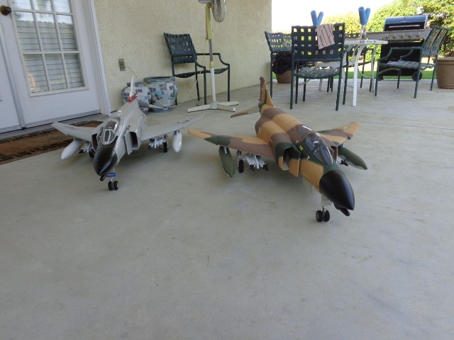

            #3665

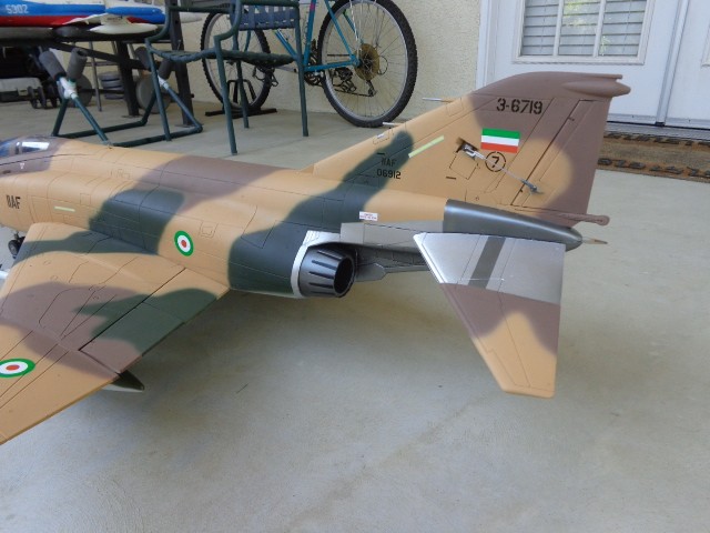

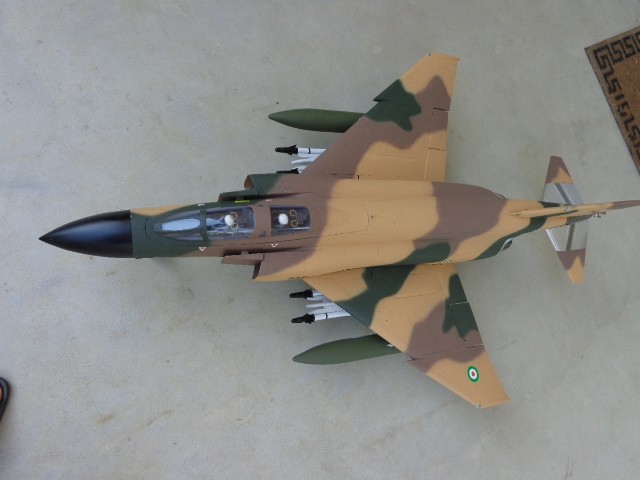

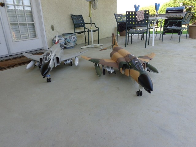

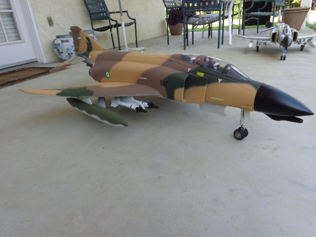

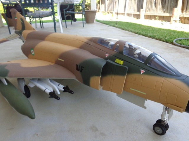

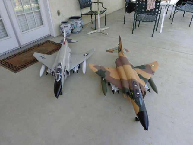

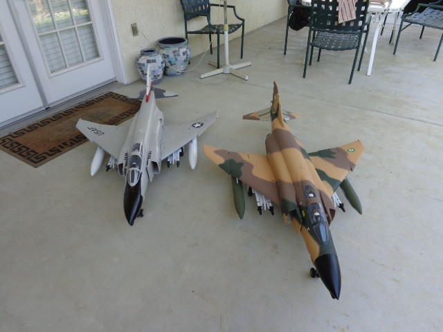

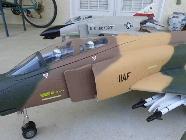

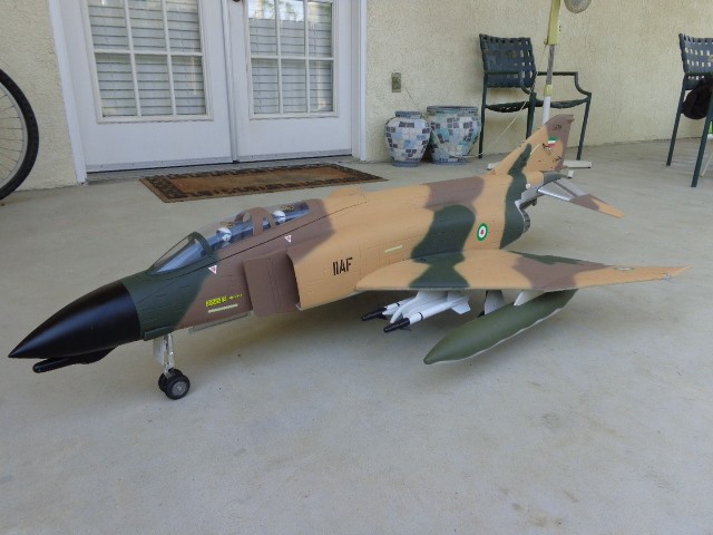

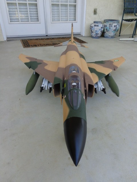

            Here is something a little different Imperial Iranian Air Force.

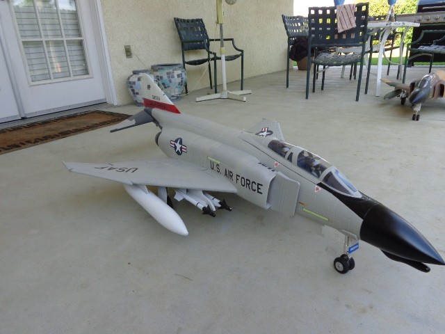

              #3666

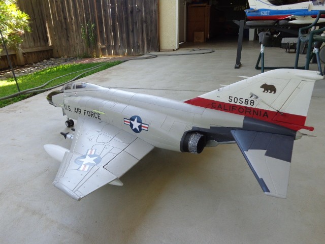

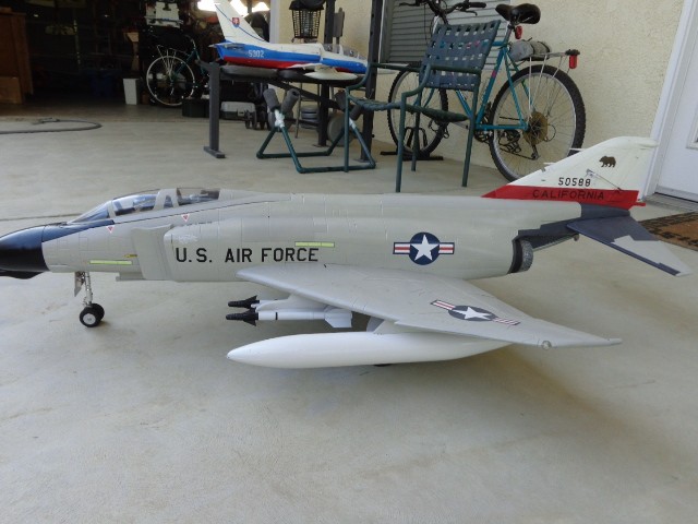

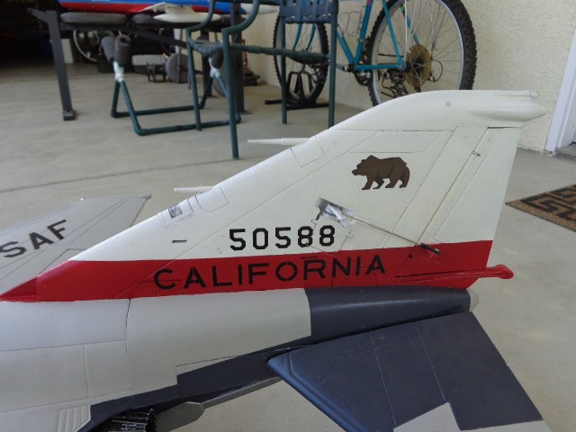

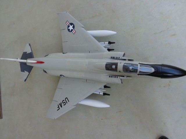

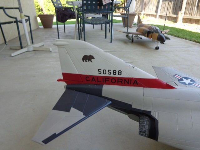

              My second F-4. CA ANG based in Fresno CA. Did a retro tail like the F-106 jets had at Fresno in the 1970s

                #3667
                MF1, Beautiful Phantoms, Sir. Bravo Zulu. Best, LB
                  #3668
                  Better watch that Iranian bird.... May be blown out of the sky at any moment!!! ;) They look fantastic!!! Great job! :Cool::Cool::Cool::Cool:

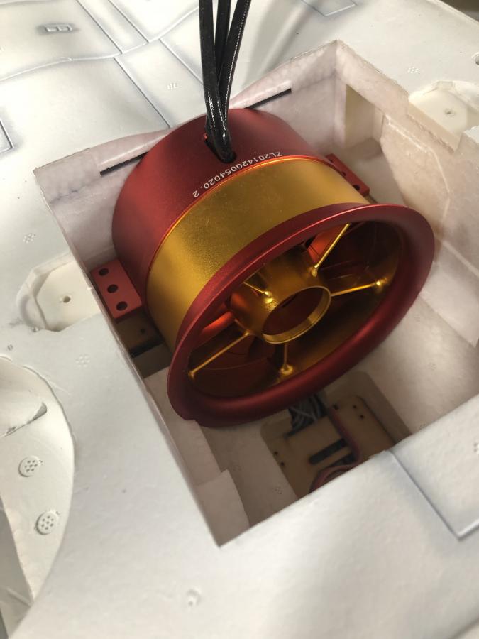

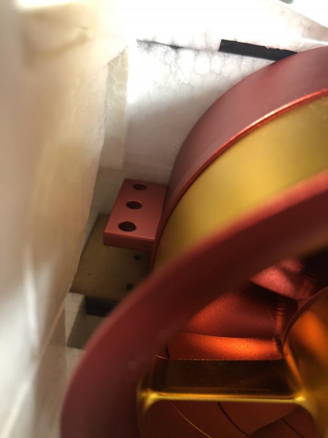

                    #3669

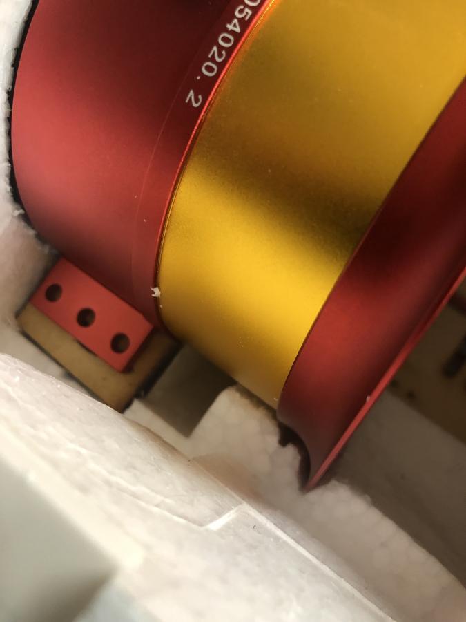

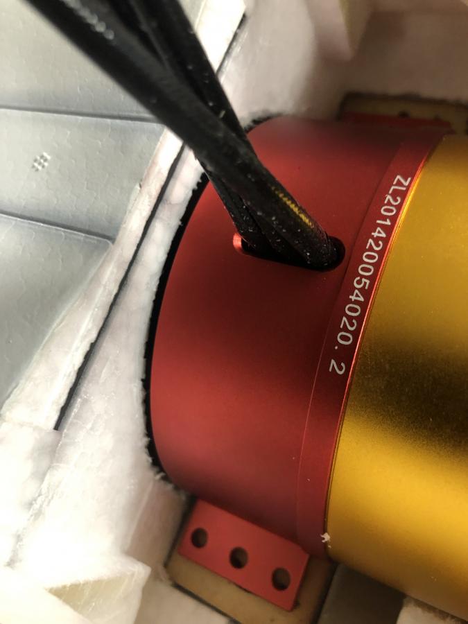

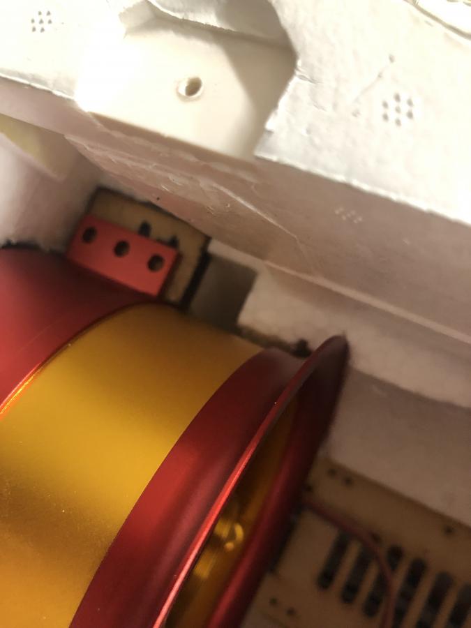

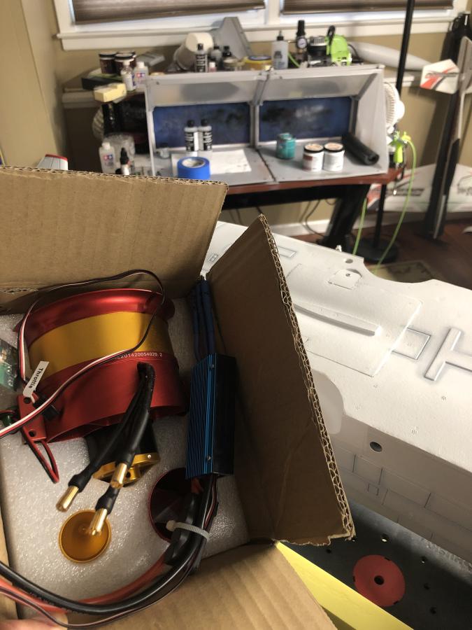

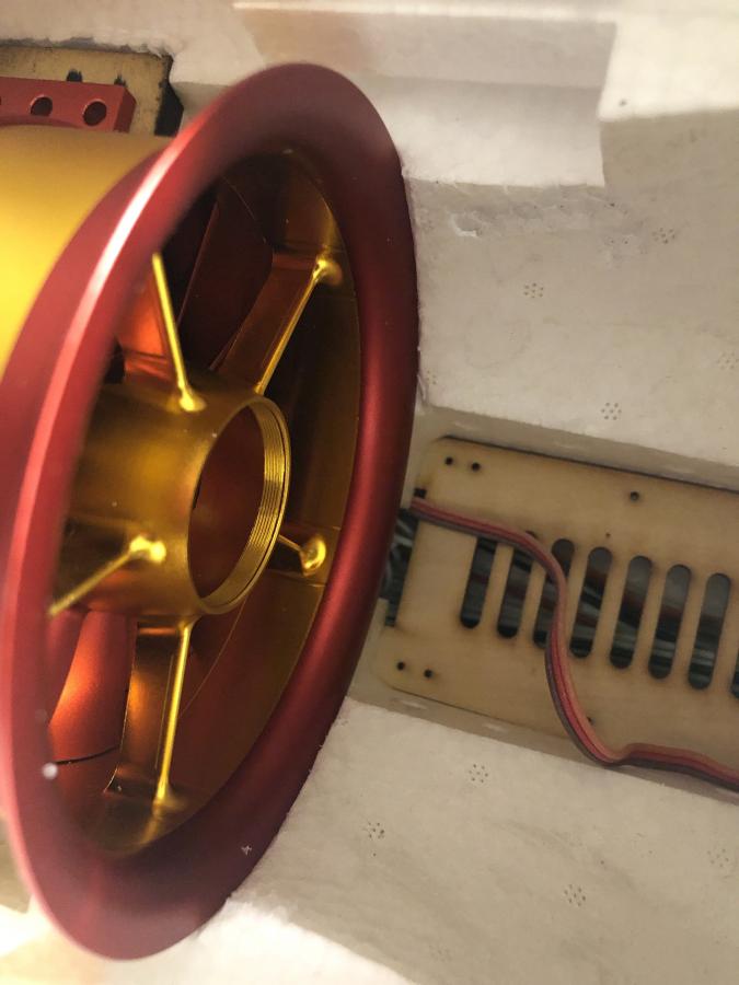

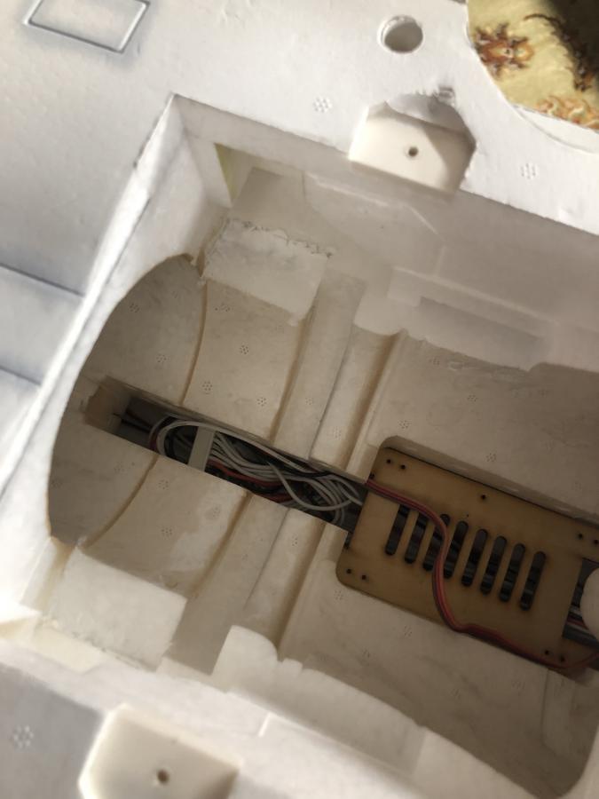

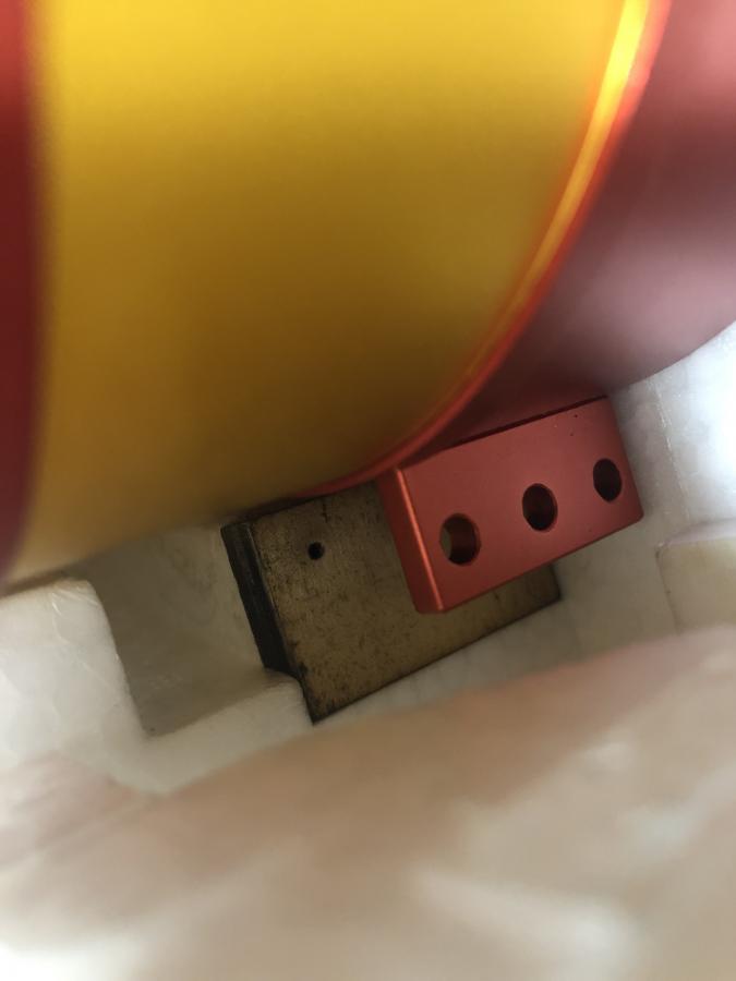

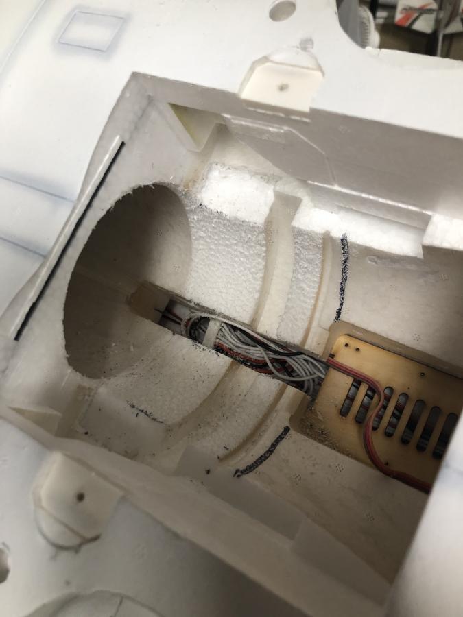

                    Just back from Jet Jam.... Tons of successful flights and beautiful landings. Getting the F4 Ready now! Retro fitting the JP Hobby 6S Fan/ Motor. Stock ESC. Ryan's vid was VEY helpful!

                      #3670
                      E4DG, Well done, Sir. Ya got skills, Man. What is the advantage going with that particular EDF refit? :Thinking: Best, LB

                        #3671
                        Its pretty... LOL..
                        Sound and efficiency! We will see on efficiency... Positive reports from Jetwerx and Ryan. Will be using the new Admiral 6000 50C!

                          #3672
                          Nice work E4DG. Maybe nothing, but noticed in your photos one of the servo wires from either the elevator or rudder is on top of the wood plate were your ESC will go. On one of my F4s, I missed the channel for the elevator servo wire and it ended up on top of the ESC (in the inverted position) and the heat from the ESC managed to burn the wires on takeoff, leaving my elevator non-functional. Don't have to tell you what happened after that. BTW, originally from Mt. Prospect, just down the road from you, but now in Miami.

                            #3673
                            Woah!!! THANKS A TON MAN! probably saved this aircraft! :-) you missed our seven months of winter!

                              There is a happy ending to my "agony of defeat" (although not happy for my bank account). Obviously crashed on take-off as it never got off the ground (it was it's 3rd flight so took some time to burn the wire), but immediately ordered a new replacement plane, redid it to the original scheme, then took the parts from the crashed F4 (actually could have rebuilt the crashed one but what the hell now have extra parts, wings, canopy, etc.) and got an ARF and turned it into an Blue Angel F4. So now have 2 of these great birds where normally I would have ended up with only 1. At least that's how I justified it.:Silly: Now I just need to figure out a way to justified a third with a scheme like yours-absolutely love your plane.:Cool:

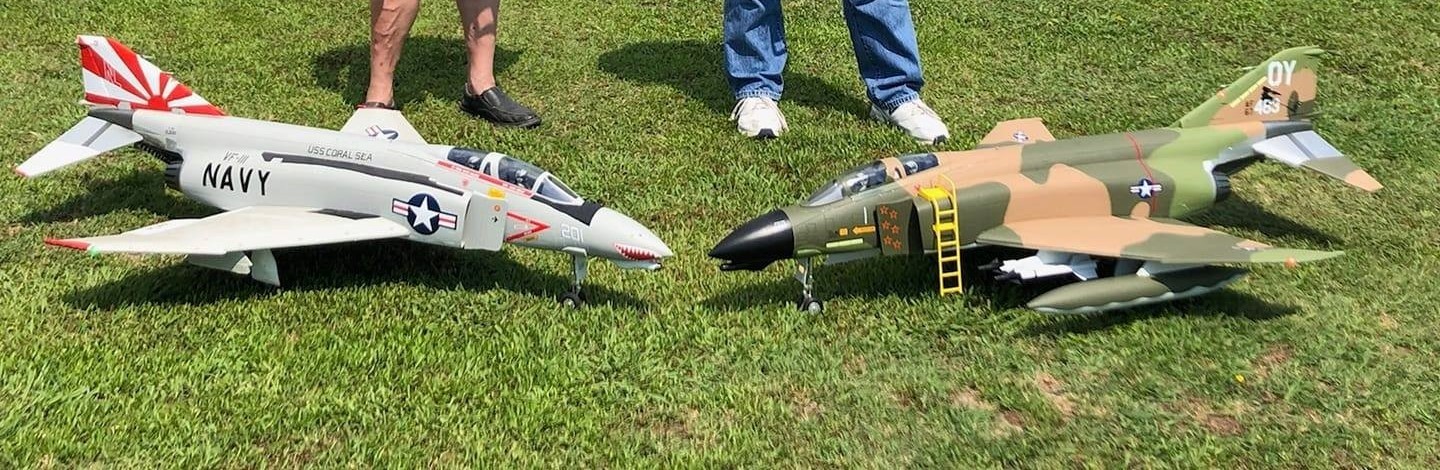

                                #3675

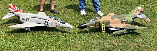

                                Navy 8S and AF 6S . The 8S has better vertical but top end speed is similar.

                                  Sex with wings....All day !! Beautiful Planes
