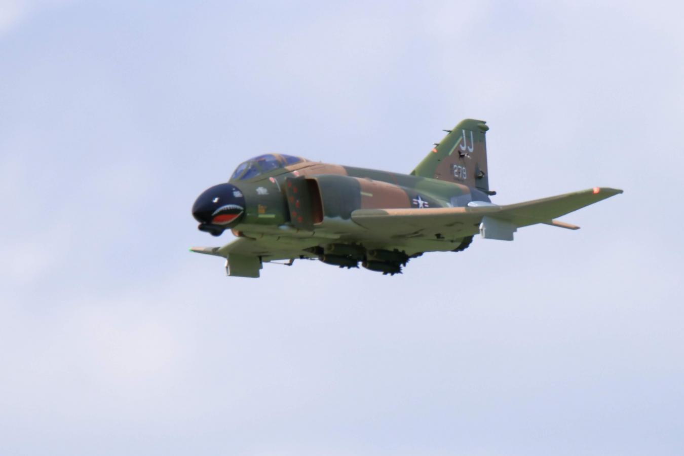

              You are welcome! Here is a shot that my wife got of mine. It does shift the CG aft a bit so you may want to compensate for that.Click image for larger version

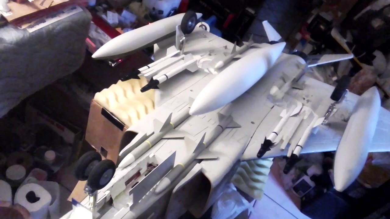

                      And you think those Pylons are gonna remain attached to your wings with Tanks (or anything else for that matter) attached to them using only Magnets ?? Ok... GL with that !!

                        Did you actually connect the tip of the aft sparrow to a modded gear door? That is way cool! I would love to see how you did the inner gear door mod!

                          Affirmative !!!

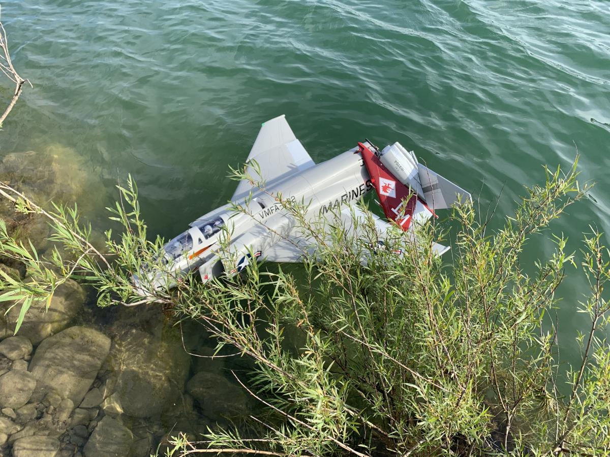

                                Well was happily enjoying flight number 5 when it was time for landing. Flew by with gear and landing flap and all was good. Turned downwind and selected landing flap when all hell broke loose. Jet rolled hard left. Pulled up flaps increased power but it was still rolling left. Hard right aileron slowed it down then it departed controlled flight and cartwheeled until water impact. Luckily little damage but ill have to inspect everything. Going to add in Castle creations Pro BEC when I rebuild during fall or winter. 😞
                                  • 5415
                                  #3696
                                  Sounds like you had control so not the BEC. Sounds like a flap stopped working in the half flap position.
                                  • slamdance64
                                    • 70
                                    • Ottawa, Ontario, Canada
                                    #3697
                                    Hi Evan
                                    yes I did not loose link so I am not blaming BEC. I have to go through plane tonight and see what happened. I had gone over all linkages before every flight. It was my 3rd flight of the day. Oh well I will get back to it later on.
                                      • 5415
                                      #3698
                                      There have been many reports of flap servo issues with the Avanti and a few with the L-39. You’re the first with the phantom. Most are the people having the wrong up travel and it is trying to push further up than the stop, heats up and stops working usually in the half flap position...
                                      • themudduck
                                        -TMD- Foaming at the Mouth!
                                        • 1041
                                        • Burton OH (near Cleveland)
                                        #3699
                                        Maybe it was a stripped gear on the left flap servo that may not have been noticed... that can happen If the flap is struck during a hard landing. It will be very interesting if you discover what happened during your investigation, let us know.
                                        Some of us have had problems with the stab attachment. were both stabilizers still firmly attached?
                                        • fhhuber
                                          • Aug 2015
                                          • 1476
                                          #3700
                                          Definitely not loss of RX system, since it was still responding.
                                          It had to be a control surface, linkage or servo failure. (includes failed connection between servo and RX)
                                          It sounds like you attempted every control input possible to try to level the model, except rudder was not mentioned.
                                          A rudder "hard over" failure could have caused that type crash.
                                          Pulling flaps up should have reversed the roll if it was a flap stuck in the middle position.
                                          Fighting what is essentially a crossed control issue, you add a lot of drag and so you need power. The amount of power needed can be high, and you were just at end of flight, when the high power might trip LVC.
                                          Once you stall in this type situation, it rarely recovers.
