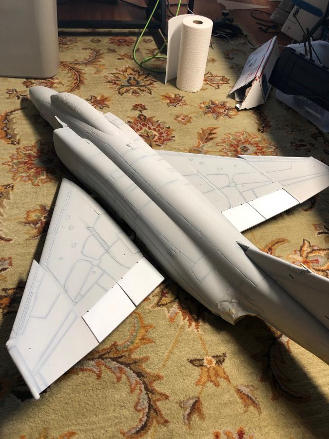

    Well was happily enjoying flight number 5 when it was time for landing. Flew by with gear and landing flap and all was good. Turned downwind and selected landing flap when all hell broke loose. Jet rolled hard left. Pulled up flaps increased power but it was still rolling left. Hard right aileron slowed it down then it departed controlled flight and cartwheeled until water impact. Luckily little damage but ill have to inspect everything. Going to add in Castle creations Pro BEC when I rebuild during fall or winter. 😞
    Could it be that one of the elevator surfaces came loose? That happened to me on the 4 or 5th flight once, everything was flying great, had the landing gear down, was just about to deploy flaps and all of a sudden it did a hard left roll, and started to spiral to earth, but I was only about 50 feet off the ground as I was just starting to get on the landing glide slope. Still not sure what I did with the surfaces, but eventually gave it full up elevator, hard over ailerons and 80% throttle when it ended up in a hover position 3 feet off the ground. Stayed there for a few seconds, then I brought it down for a helicopter landing. I called it a "crazy Ivan", and the guys next to me had their jaw on the ground and all they could say was "well, that's something you don't see every day". After I cleaned the crap out of my pants, I noticed that one of the elevators was slightly loose and about 8mm off from the other. Tightened both again with lock tight and 30 flights later, no issues.
    Your situation sounds eerily similar. Took me about 10 flights to get over the trauma and always expected another "crazy Ivan", but fortunately, so far no more. Every time I take the F4 out the guys always ask me if I'm going to do another hover with it.:Silly:
      Man that was funny, still laughing about your flight, got the fruit of the looms a little dirty did ya.?LOL
        Sorry to hear. I was just curious but in the picture the entire rear section of the fuse is detacted. Granted that could have happened on impact but I wonder if it wasn't starting to come loose and caused the crash. My gray F-4J was starting to separate and I caught it before anything catastrophic and I know of one other instance where the back of the fuse came detatched at that joint causing the total loss of the aircraft. Something to consider.

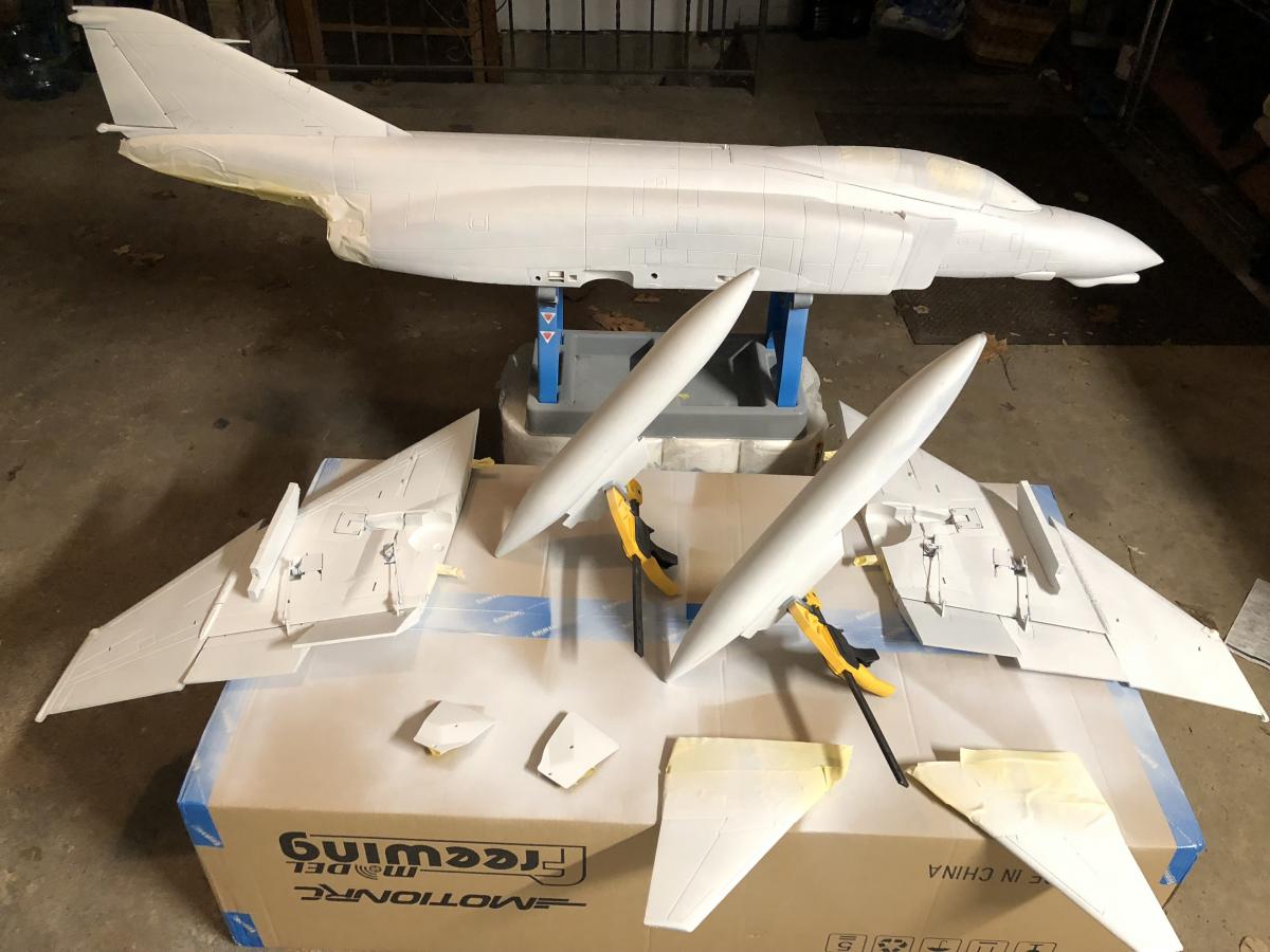

          On inspecting the Phantom for assembly, I decided to add 4 long toothpicks inserted at angles to improve the joint between the main fuselage and tail section.
          And I removed all paint from the surfaces to be glued, then glued it up with Gorilla white foaming glue, which fills any voids in the joint.

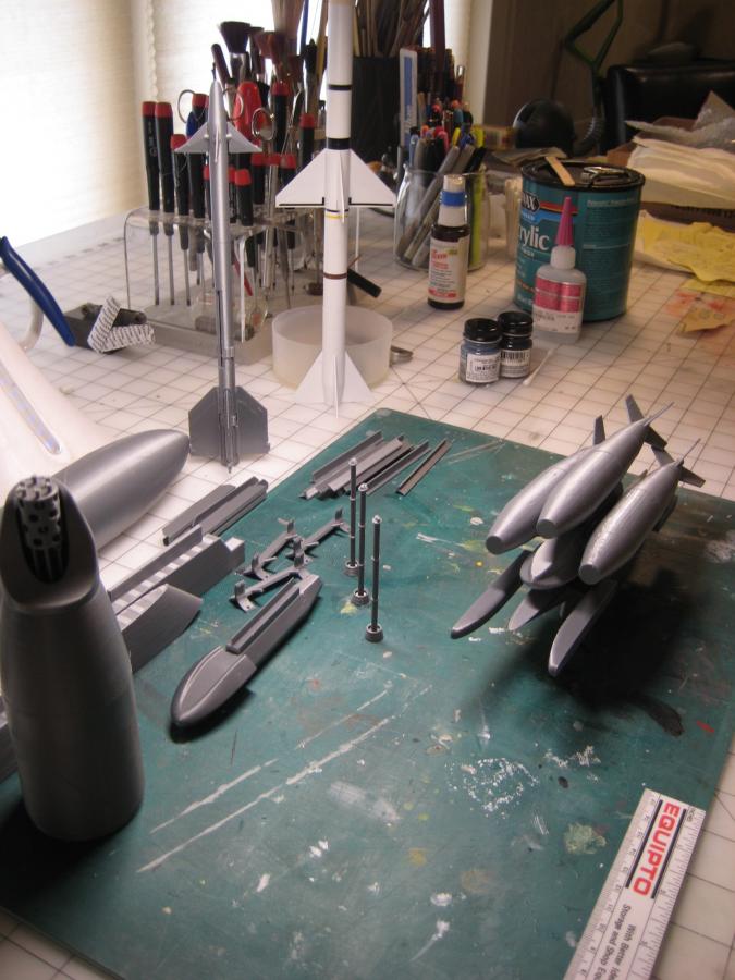

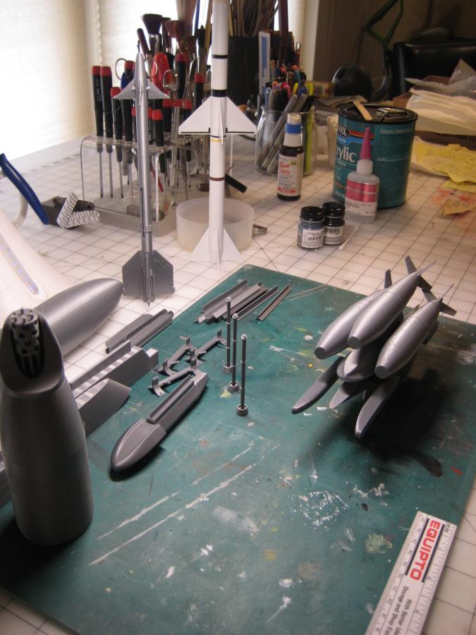

            Hey Y'all, As I am building and modding ordinance for the F-4, I ran across this "Ordinace" thread from our plastic model brethren. Good overview.
            This is a abbreviated timline on MBRs, MERs, & TERs:
            https://www.tapatalk.com/groups/hang...notes-t42.html
            This is a paint color guide to ordinace stripes and meaning:
            https://www.tapatalk.com/groups/hangardeckresource/weapons-colors-and-stripes-t13.html
            Best, LB

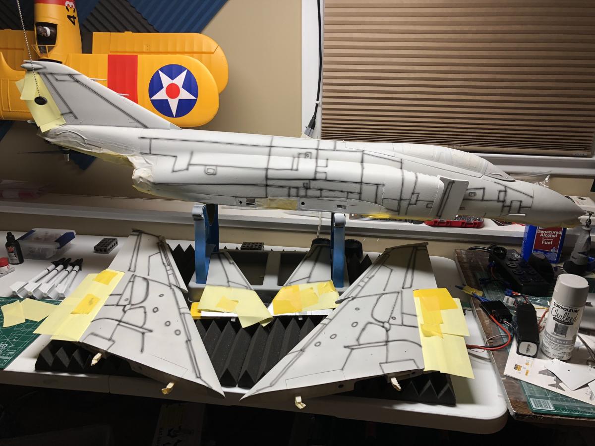

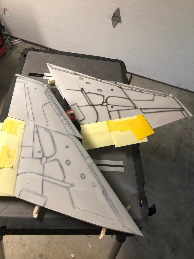

                          Would be glad to assist. Same theory as plastic models. e.g. Over spray darkened panel lines with base color until satisfied. I have found that Utilizing a gloss coat before applying the Callie graphics really helps adhesion. Then dull coat over the top to seal them in.
