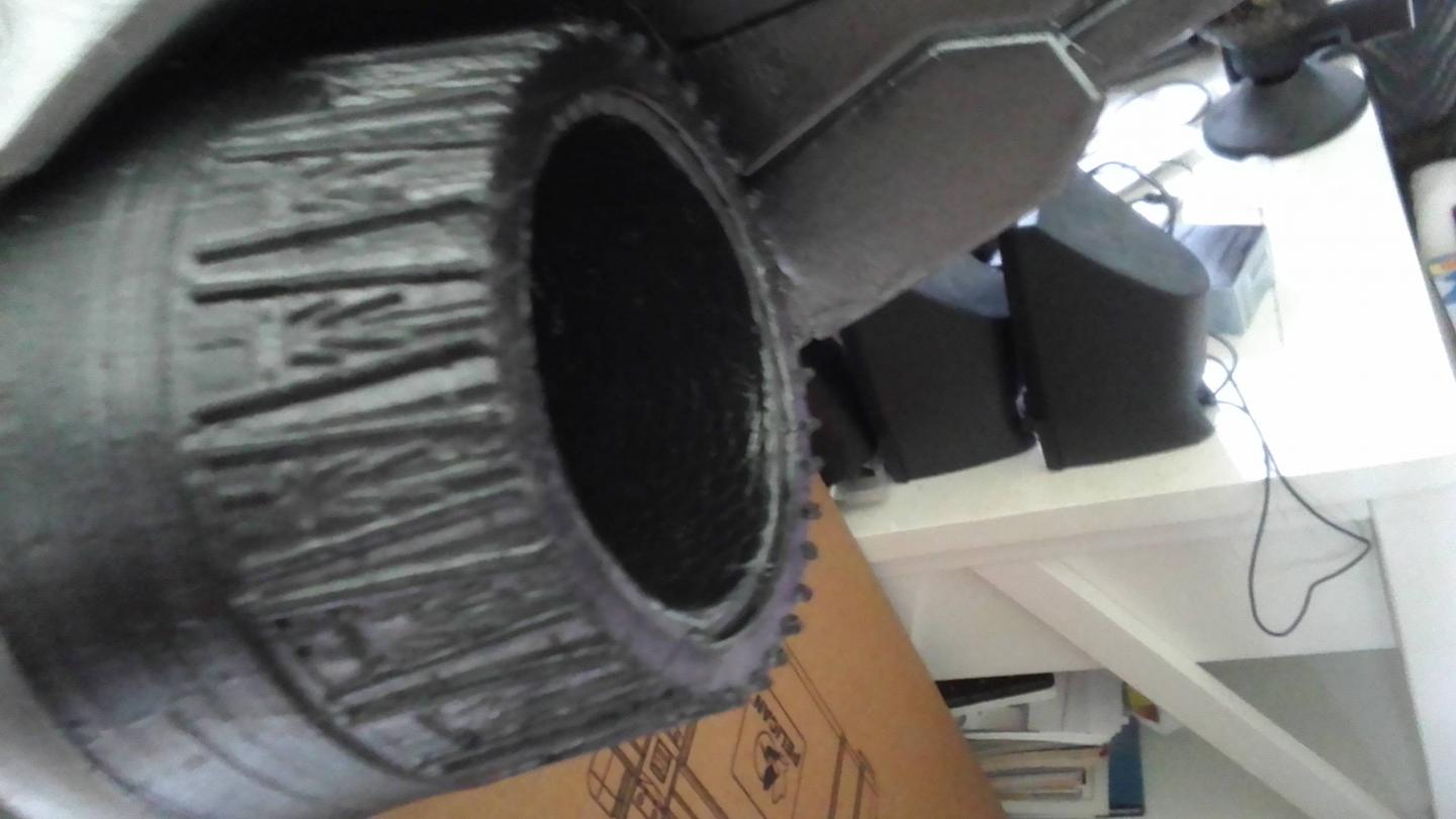

          BBR, Did you not rotate the foam nozzle parts to eliminate an up/down thrust line? Also, is there an advantage to 'sharpening' the foam nozzle portion, i.e., less turbulence or something to that effect? Seems you posted your work here. Best, LB
          Yes,... I put a Drop on the No.1 F-4D Nozzles and used a Plastic Drinking Cup for the Nozzles. Extended them to the Later E-Model Length.
          Click image for larger version  Name:	IMG_20190424_141432.jpg Views:	0 Size:	81.7 KB ID:	191598
          No.2 F-4E (Early) has the FW 3DP Nozzles shown here before the Drop and Chop !!! This Extraordinarily Wide Exit Lip was unacceptable to me. This is what you get when you just stick them onto the Foam after removing the stock plastic cones. Most guys just leave it like this.
          Click image for larger version  Name:	IMG_20190424_141433.jpg Views:	0 Size:	84.1 KB ID:	191599
          The No.3 F-4F will be getting the RCGeek LongNose F-4E/F 3DP Nozzles. They are 'Longer' and have a very nice Exit Lip on them and are already at a nice Thickness. No need for Chopping back the Foam as they are already extended past the Inner Nozzle Boundary. Depending on which Aircraft you are modeling, there is a nice set of Nozzles to be added for someone who desires a more realistic F-4C/D/E/F look on their Foamie !! Cheers

            BBR, So part of the issue was the bluntness of the foam OEM nozzle ends with the OEM 3DP nozzles versus a more 'hidden' look with the Geek's longer nozzles? Aesthetics and function? Best, LB

              Purely 'Aesthetics' is driving this Train over here Boss !!! The heck with Weight and Drag and everything else that's going to Slow this one Down in flight. I fly 'DirtyJets'... everyone knows that !!! I like them to look 'Exceptionally Good' while they're up there for their 3mins getting passed by Avanti's, Futura's, Habu's and Viper's !!! Some things that get done from the factory, for whatever reason, on these Jets make me cringe !!! Hahahahaha
              ^Note: I had added a little 4" Mylar ThrustTube Extension on the -8's bringing the Inner Ducting out to within about 1/4" of the Nozzle Rim. It made the sound less Whooshy and the 'DuallyBurner' was playing off it too, It had no discernible impact on performance or 'Efflux',... so I removed that.

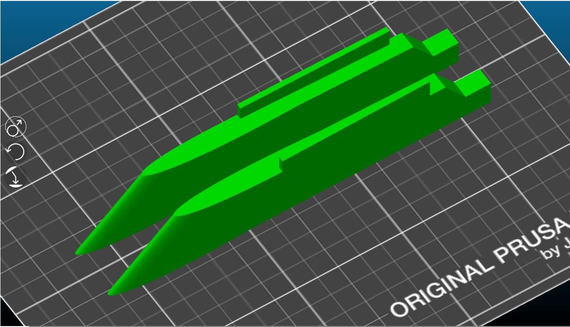

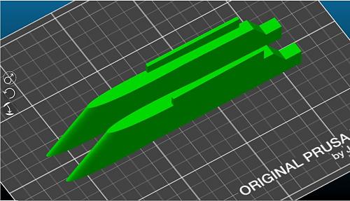

                  Hey All, Question, as a rule, do the actual weapons have the 'Male' OEM mounting lugs and the pylons the 'female' fitting for the Freewing Jets? I have 3DP designed the outer wing pylons for the Freewing F-4 to carry weapons instead of the wing tanks and will need to add the correct mount to the bottom. My thought is should I just put in a blank space to fit either? Best, LB

                    the pylons always have the female T-slot. Here are the dimensions I have used that allow me to fit the female mounts.

                      :)Thank you, DD, that's what I needed. Best, LB

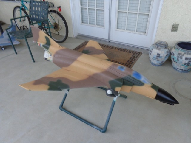

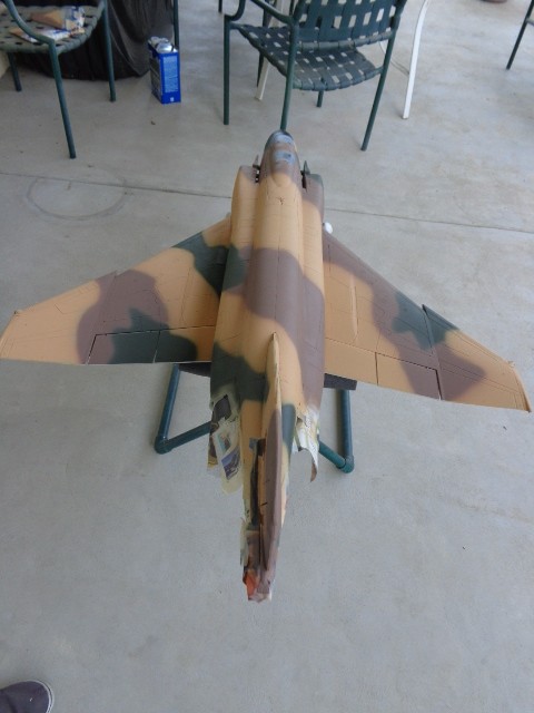

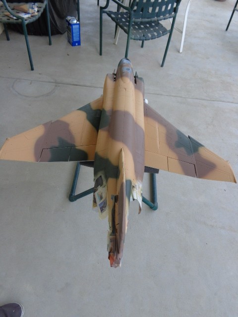

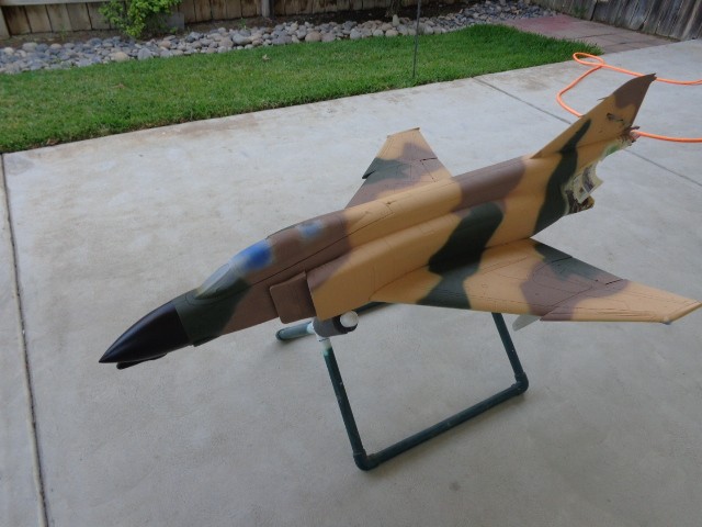

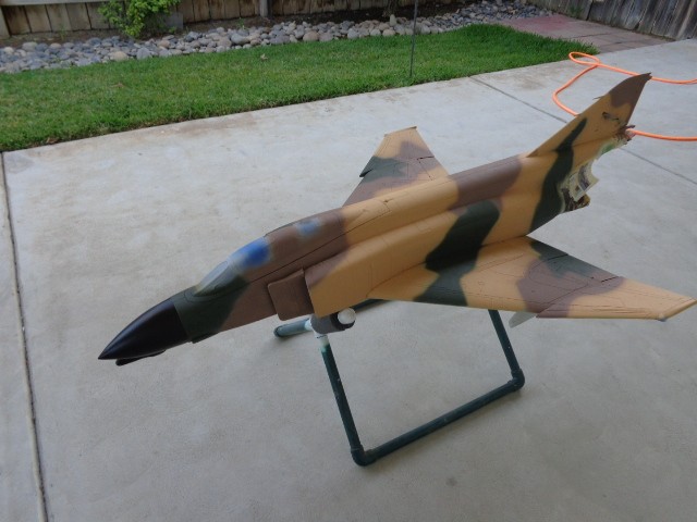

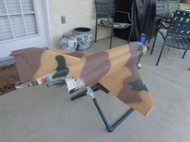

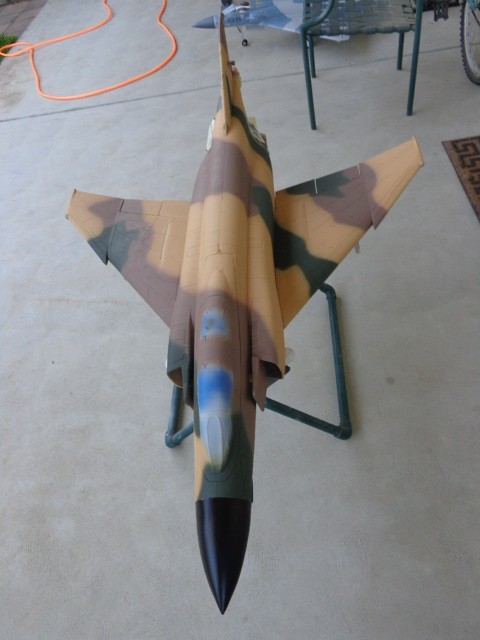

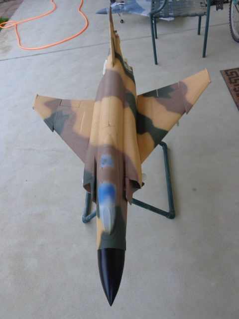

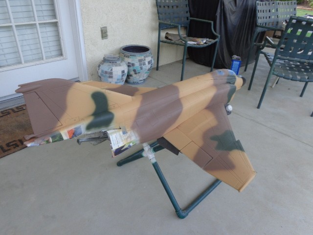

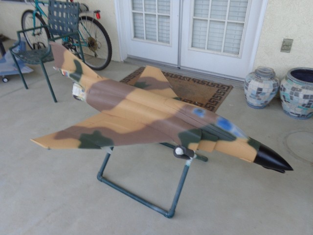

                        Enjoyed flying the F-4 all winter and this spring. Now was the time for a paint job. Going for the Imperial Iranian Air Force scheme. I really like the desert scheme and it really stands out in the clear or cloudy days. Here is a preview, will be ordering decals from Callie Graphics. Click image for larger version

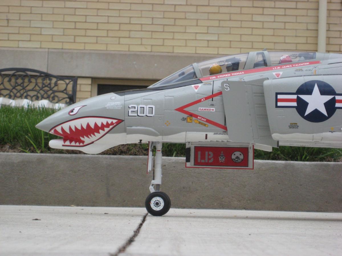

                                      Hey Y'all, She's on her own feet for the first time. Some soft weathering on the upper fuselage, light touch up, airbrushing the tailhook, and a matte finish coat yet to do. Ordinance is a work in progress. :Whew:Best, LB
