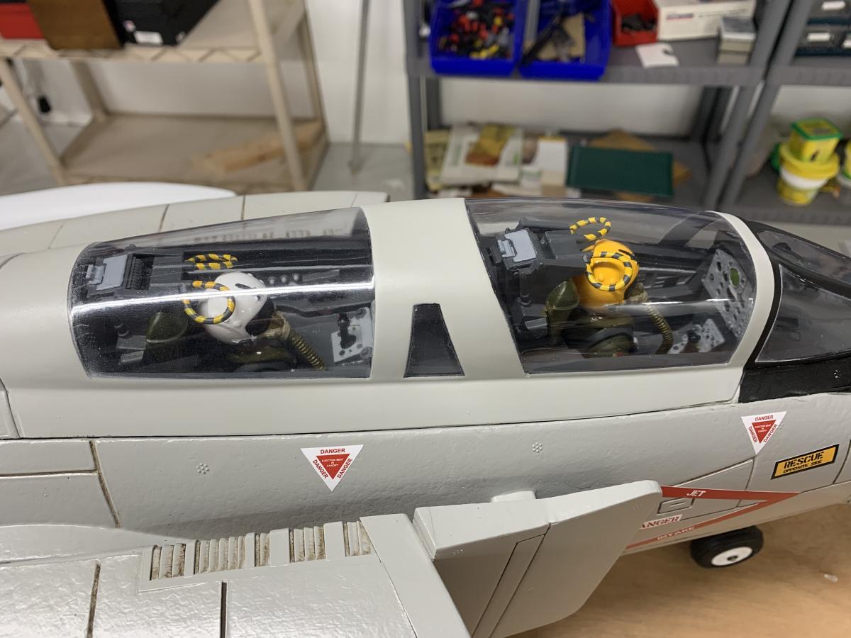

        As Nomenclature Application Madness sets in, I got the 'anti-glare' painted which finishes the cockpit with the exception of gluing down the canopy. Some airbrush-weathering to tone down the markings yet to go. Best, LB

          I like your Rear View Mirror there LB. NiceOne !! Click image for larger version

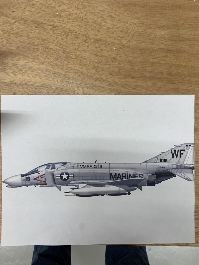

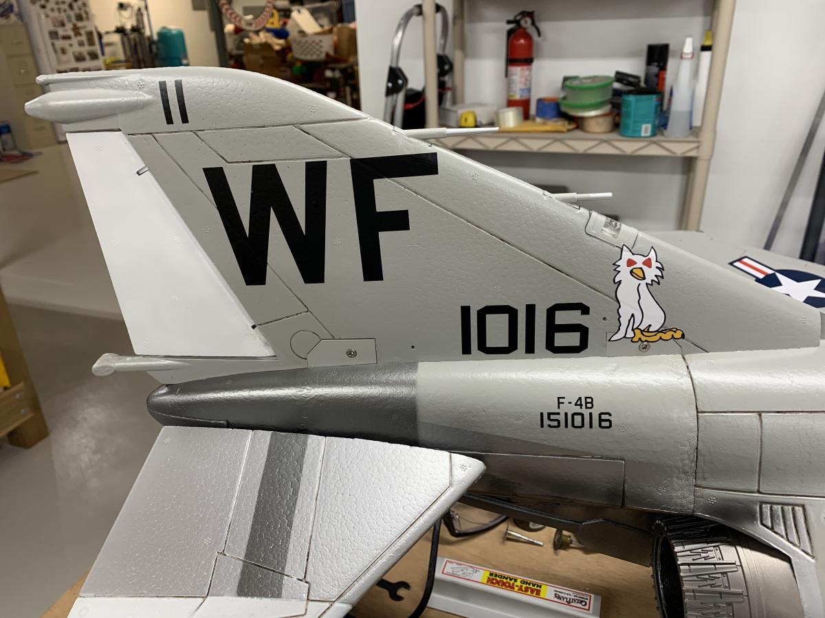

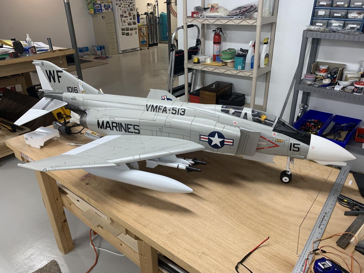

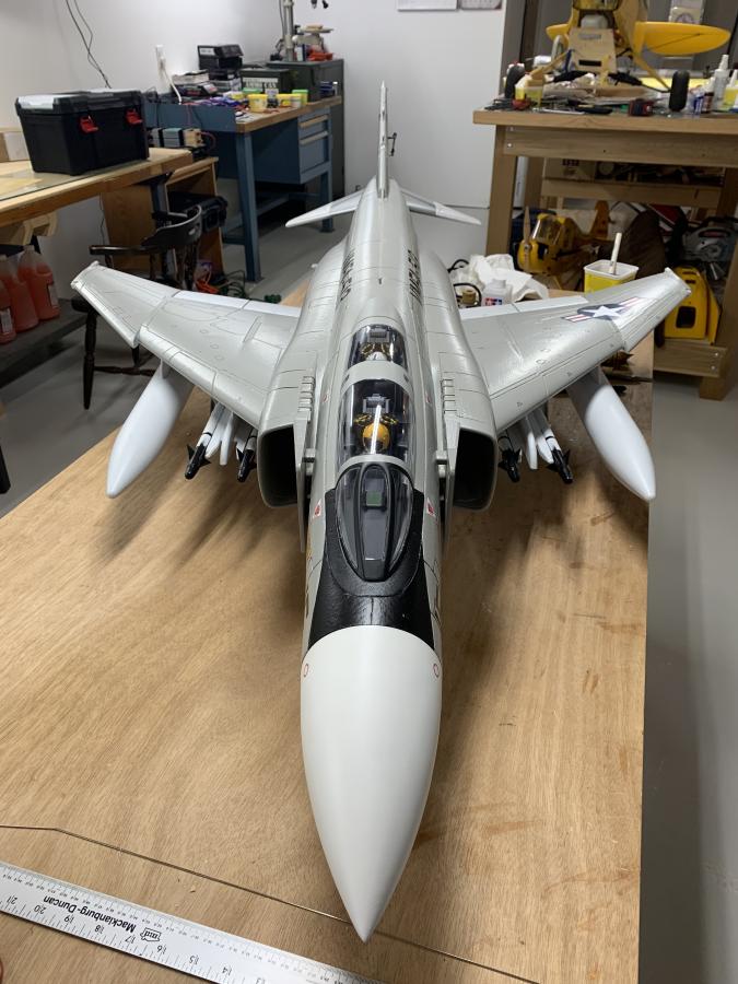

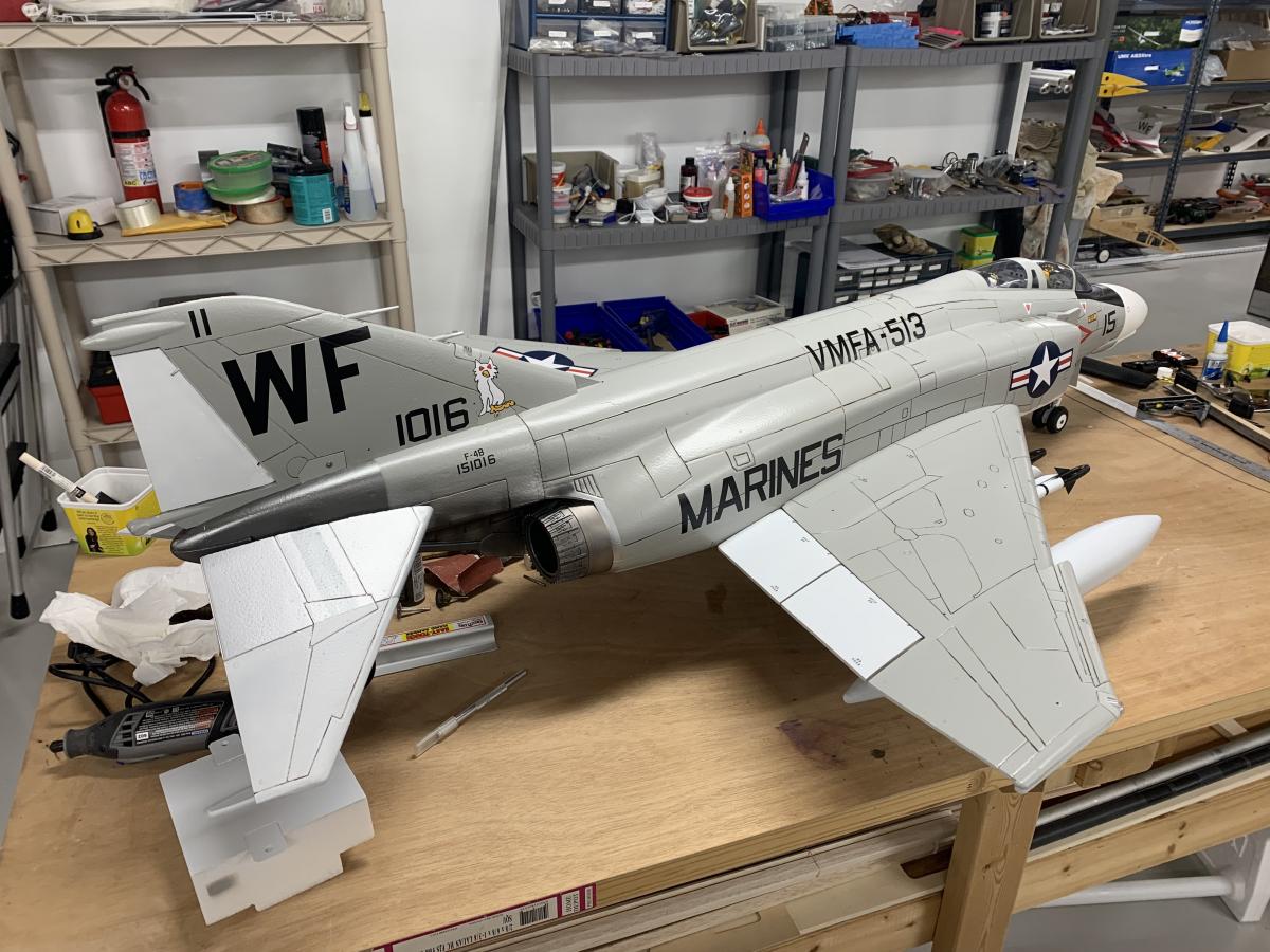

              Here is my rendition. Ghost grey 8s. VMFA-513 Flying Nightmares. My dad was an F4 maintenance technician in this squadron based at Cherry Point. It was pretty difficult to find any photos of this livery online, but I was able to find a few. One of the pics below is what I went off of for the graphics. Callie did the graphics. I used the Motion 3D printed cockpit parts and exhaust nozzles, or as my dad calls them “turkey feathers.” Pilot figures are JHH 1/12 scale jet pilots. Radome was painted white, as well as the landing gear and wheels. Thinned raw umber was used for the panel lines and some weathering. For the exhaust nozzles, I used Model Master burnt metal and accentuated with Model Master exhaust. Exhaust used around the tail as well for the soot. Overall clear with Minwax WBPU Matte finish. Did a good job of sealing the vinyl graphics and knocking the high gloss off them.
              Travis
                • 4869
                #3447
                Travis
                TM, Absolutely beautiful work. Well done. Best, LB

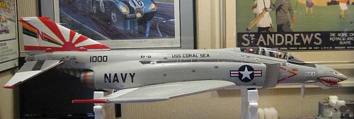

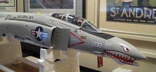

                                      Got to rub on this one after the demo flight...… 2003 I think....:Cool:
