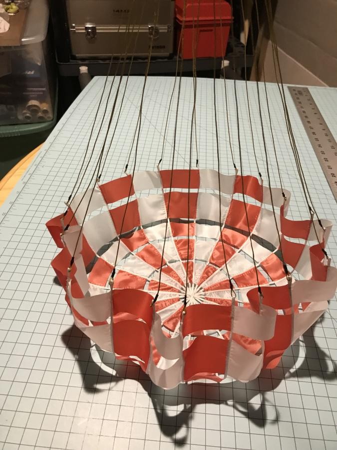

ID:	180121 I received my tailchute from mr Paul Helms today, and I want to tell you all publicly, that his craftsmanship is truly superb.
                I am over the moon with it, and would recommend this workmanship to you all.
                Gordon Fraser.
                U.K.

                  I received my tail chute from Mr. Paul Helms today, and I want to tell you all publicly, that his craftsmanship is truly superb. I am over the moon with it and would recommend this workmanship to you all. Gordon Fraser.U.K.
                  Gordon, Kudos to both of you for this addition to your F-4. Bravo Zulu. Looking forward to the un...veil...ing. LOL Best, LB

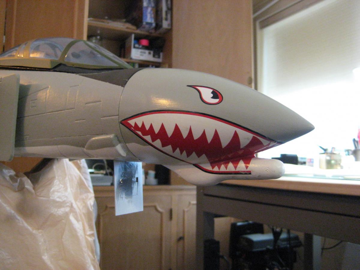

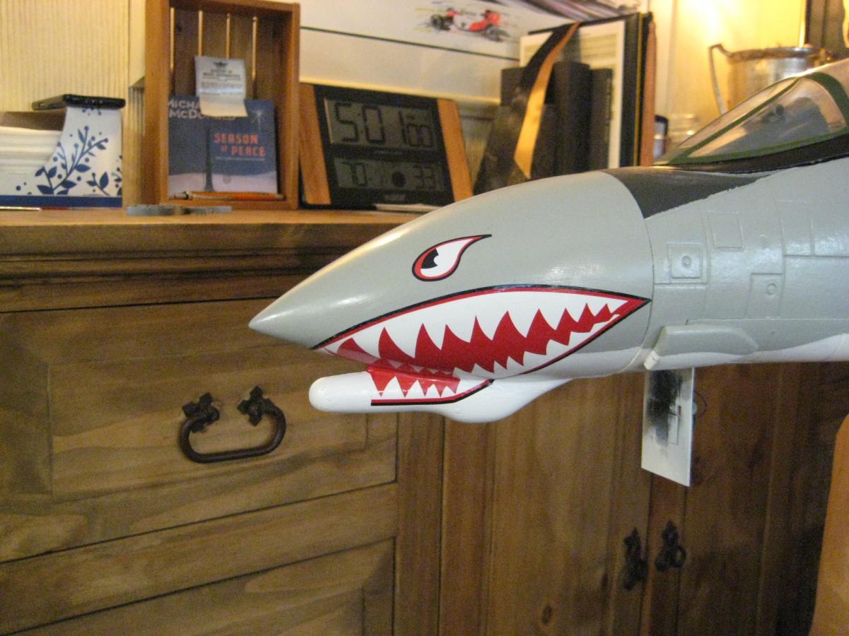

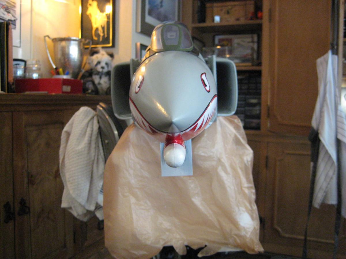

                    Once again, Big Thanks to Callie and her Graphics Machine, the Dbl Zero can now see where she's goin'. :Cool:
                    Though I'm wondering if she looks a little like 'Letterman' from the front. :Scared:
                    Best, LB

                      Hey LB,.. When do you think you're gonna fly that thing ?? How close are you on yours ? Has it flown yet before you started the detail work ?
                      Hey 'Wildman' // Hey Evan,.. What Brand/ Color Paint are you Guyz using on your BlueJets ?? I'm gonna have to do a BlueJet now !! Awesomeness there Guyz Thanks

                        Looks good LB. It is just saying "Smile!"
                          LOL I go for it. B'sides, trips for her to the orthodontist are not in this build budget. Best, LB

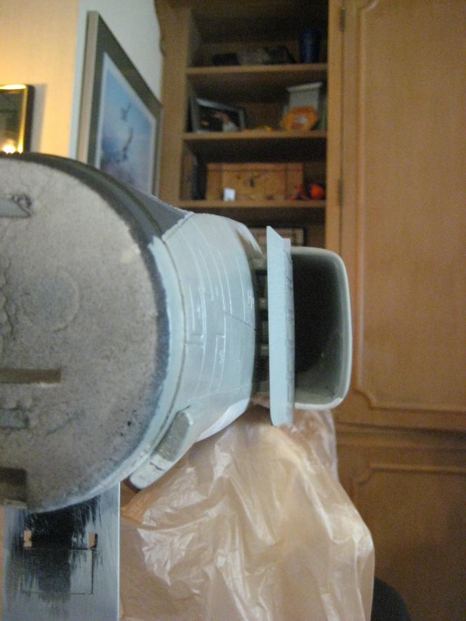

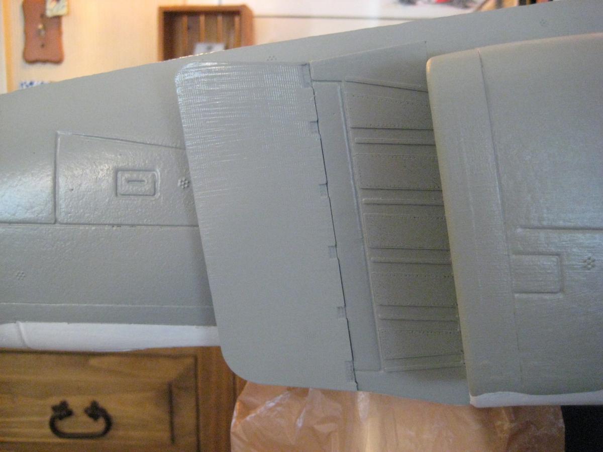

                              Y'all, Installing the 3DPUP LE VIRs. One Down & One To Go. Made a nice template for marking the slots/pegs but it was bass-ackwards but worked when held my tongue just right:P Best, LB

                                Looks really good LB. Did I miss how you did the intake aft of the VIR?

                                  RCJD, Thanks. Aft of the LE VIR? I didn't do anything to the ramps, except to sim the perfs on VIR, but I might do something with the actual intakes in my 2nd Phantom. Best, LB

                                    The ridges...did you print a thin plate and glue it on or something else?

                                        The VIR (Variable Intake Ramp) has a fixed panel including Leading Edge (LE) Forward Panel or 'Fixed Plate' that's the part I replaced today and a movable ramp (boundary layer vent) that is perforated with holes which moves outward closing the intake to "slow" the airflow so that remains at a subsonic speed at supersonic airspeeds. The portion I think you're asking about is a 3DP simulation of the perforated portion of the variable ramp. Could be done with anything, decal, card stock, Sharpie. I chose 3DP just 'cuz I got one and I think it's cool-lookin'. :Cool: I agree that this is one very noticeable part of the design detail that Freewing just simply missed. Best, LB
