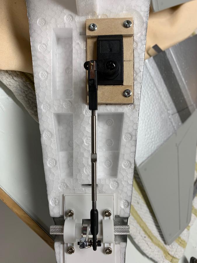

        I'm Into the TailEnd of F-4 today working on the LB TailHook (Awesomeness) and thought I'd share my Elevator/FFStab Servo Mod since a few Guyz have mentioned their Linkage Upgrades.
        I felt it not enough to simply have a Ballistic Control Rod, I needed to ensure my Servo was properly anchored into the Foam with a very low probability of wallowing out that material under load. I cut a Plywood Frame Around the servo anchored with some Bamboo Spikes. About 70 Packs through the Jet and it's RockSolid back there ... Yaaaaaay .
        I also have Plywood Bumpers installed on the bottom of the FFStab to keep that Foam intact on those Tips under there !! Cheers !!

                I posted a long time ago about my experience reinforcing the elevator pushrod. There is always a weakest link and I found that even though I had put in a stronger rod the stock ball link was bending. Since it normally is pushing to give up pitch it was bending, folding over on itself. I suggest you replace yours.

                  #3148
                  Mine is now a HysolBonded CarbonFiber Tube over Wire (Rather Indestructible). The central point of my post was the Plywood and Bamboo Reinforcements I had done to Keep the Foam rigid around the Servo when it Torques there in the foam... I could have a LeafSpring out of a 69' Ford Mustang back there for a Pushrod and it'd still have potential for Flutter and Softening up that Servo in the foam unless I Stiffen up that Servo in it's Foam Cradle !! I don't Think a lot of Guyz are doing that second step of Plywood Reinforcement. Stiffening the Rod seems only a Half Measure to me on this Jet due to It's Mass/Potential. Had FreeWing chosen to set that Servo back there in a Nice Hard Mounted tray with a Proper Pushrod in the first place, we most likely wouldn't be discussing this business at all This was noticed and discussed back in the pre-Release days actually !! AllGood really. Cheers

                      Originally posted by Bobaroo
                      Mine is now a HysolBonded CarbonFiber Tube over Wire (Rather Indestructible). The central point of my post was the Plywood and Bamboo Reinforcements I had done to Keep the Foam rigid around the Servo when it Torques there in the foam... I could have a LeafSpring out of a 69' Ford Mustang back there and it'd still Flutter unless I Stiffen up that Servo in it's Foam Cradle !!
                      BBR, Copy on the hook not to scale. Not an easy task, though doable given the willingness and time. Like what you're doing with it. Great work. Best, LB

                          While it’s all good it was discussed before and you have the strongest push rod in the galaxy my point is that I see in the picture you have used the stock black plastic ball link and, on my F-4, the plastic ball link was bending and causing a change in elevator centering. Given more time it would’ve failed.

                            #3153
                            Ahhhhhh,. I hear ya. Thanks for that clarification. I looked over that ball link and considered replacement. I've had some Cheap ones Split on me before. This one looked solid enough and once I Fused it to the Rod with Hysol, there was no bending at the threads !! I don't actually know how many flights this one had on it before I got it but I did detect a little Softening around the Servo when I got it. Next one will get the Full FFStab Mod with all the goodies !! I'm kinda excited about it. AllGood, ThankAagain

                              #3154
                              This is my upgraded pushrod and beefed up servo mount. Pushrod is a H9 4-40 titanium Pro Link, Dubro 2-56 ball link for 4-40 rods on the stab end and a Dubro 4-40 safety clevis on the servo end. Quite strong and rigid.
                                #3155
                                As it should be!!! :Cool: Good job and Welcome to the Squawk TM!!! ;) Jerry (I did mine almost the same way, but I have ball links on both ends and a Hitec Digital MG servo in there for added measure....

                                  Looks 'Solid' there TM. NiceOne
                                    #3157
                                    Maybe overkill, but no elevator is kind of an emergency.... :Scared::Sick2::)
