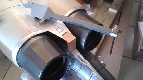

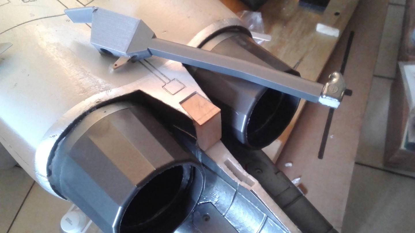

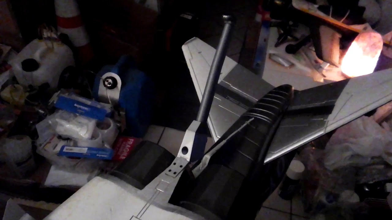

            • Well Now,.. Got the Operating TailHook Mod pretty much done. The Spring Rebound System I am installing will allow for Ground Contact (Inadvertent) resulting in minimal Damage to the Hook, Linkages and Servo. Some Contact Wear is to be expected on the ContactShoe and therefore, they are replaceable . Hey LB,.. Awesomeness here Man.... Click image for larger version
ID:	179403 URock !! ThankAagain
              • Originally posted by Bobaroo View Post
                Well Now,.. Got the Operating TailHook Mod pretty much done. The Spring Rebound System I am installing will allow for Ground Contact (Inadvertent) resulting in minimal Damage to the Hook, Linkages, and Servo. Some Contact Wear is to be expected on the ContactShoe and therefore, they are replaceable. Hey LB,... Awesomeness here Man...URock !! ThankAagain
                BBR, :Cool:You did a magnificent job with actuating the pivot arm. My Congrats to you, Sir. Bravo Zulu. Also, like the reinforcement of the fuse at the hinge line. Best, LB
                  Well Sir,.. My success here with the Hook Mod is merely a reflection of Your skills an Your outstanding work on this. ThankAagain
