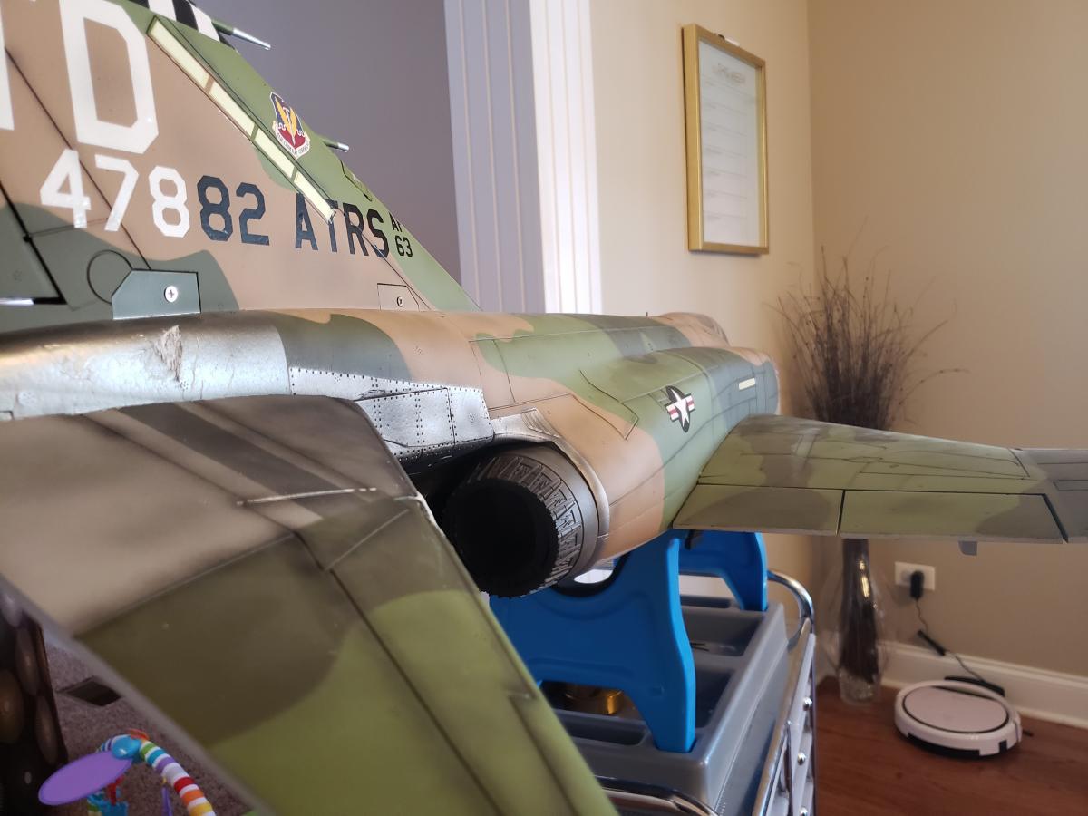

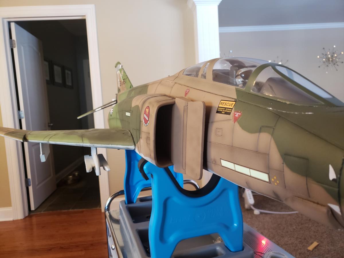

                  -51 where I live. Northern Illinois is shut down today. F4 is out of the shop and ready to go!
                  Word of the wise, if you're using aluminum tape, make sure it firmly in place. My maiden was not so great after the fan blew up a portion of the tape which occluded one of the exhaust nozzles. I'll do some high intensity tests before the next flight!

                    Stay safe there Bro!!! Just too cold. Dang. :Cold: F-4 looks nice!!! :Cool::Cool:

                      Great weathering on that F-4. I'm still afraid to try that. There are some amazing modelers on this Sqwak. Stay warm!

                        That was my second attempt. It's a little thick in some places but overall I think the jet looks pretty cool. I'd recommend thinning the black/brown to more of a dark gray/black. This will allow for more layers and IMO a more realistic weathered look.

                          It takes some guts to do to a new model, but if you airbrush the panel lines on too thick or dark, use 0000 steel wool and rub in the airflow direction and give it a gentle scrub. It blends everything in and dulls the paint too.... All good effects on a worn flat finish. CAUTION! Blow all the metal dust from the steel wool off with an air compressor. Make sure it doesn't get in the radio compartment or the magnets (in your motor and such!!!) I usually do the rub down before I install the radio and remove the motor and ESC just to be safe, then give it a once-over with the airhose….

                                        PPG, She looks outstanding! Best, LB
