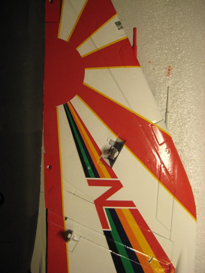

            My F4 is almost done, added some weathering and Callie graphics. I painted the vertical stab white to avoid any grey showing trough. I’m trying to figure out how to tackle the servo side of the vertical stab, since the decal is one piece it’s hard to line up and make the correct cut for the servo arm. Maybe I’ll cut the decal in to to make it easier ????.

              Lcacing, I had a similar issue and cut-out the white portion first as I had sprayed Insignia White over my primer. I figured this would be easier in the long run rather than trying to put down a large decal. I then cut off the 3 sun-rays that would lay over the rudder servo and the control horn (if Required). I matched the "sun" with the other 3 sun rays attached to the opposite side and using a line drawn where the vertical meets the fuselage (slip fitted the vertical to that part, drew a line) as a horizontal reference measuring back from forward attach point.to the 'sun'. I then applied the sun rays to match the sun cut point and the opposite side sun rays. Not a fun task but worth the extra bit of care required. Hope this helps. Best, LB

                What spray paint did you use?

                  CP, I just used rattle can Testors. Not my favorite, but I will matte coat the entire airframe when completed. Don't think it matters, just wanted a gloss finish to apply the markings. Best, LB
