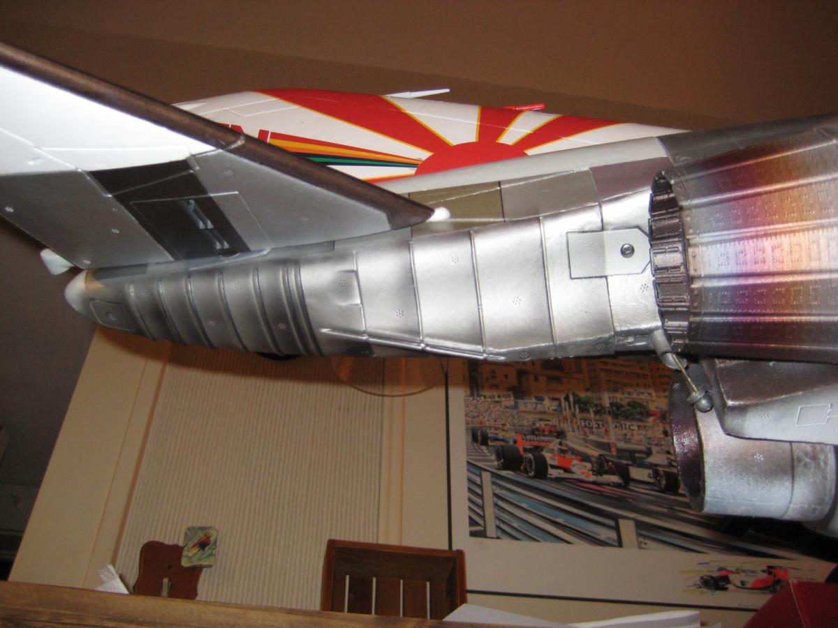

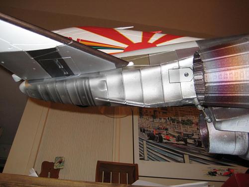

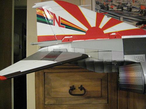

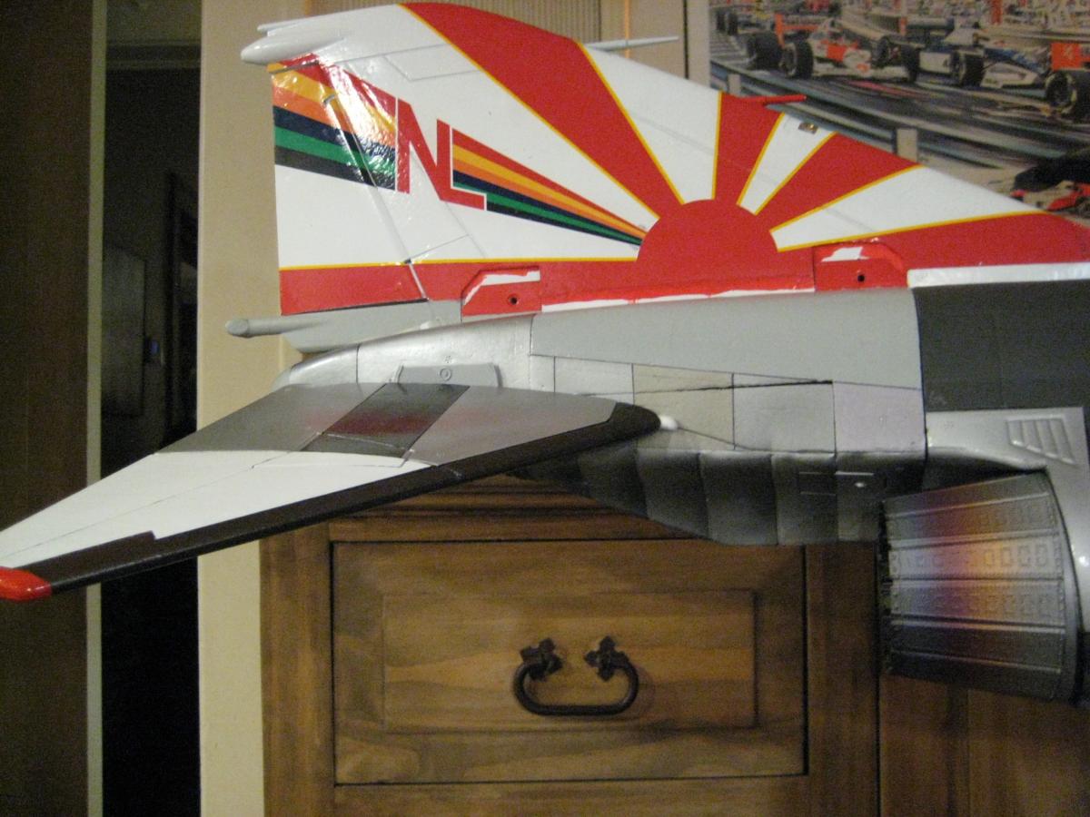

        Hey Y'all, Empennage painting, shading, and assembly continues slowly, though getting there. Best, LB

        Fantastic job LB!
        What colours did you use to achieve the heated metal look on the tailpipes?

          MH, The exhaust nozzles are 3DP printed in black ABS. I airbrushed flat steel to about 80% coverage on the outside. For the burnt metal look, I used flat brass for the brownish tones, gloss purple and clear blue for those tones. I added a flat black at the tips. I thinned all of these to the consistency of water using low-pressure and a fine nozzle on my airbrush. The interior of the nozzles is airbrushed with burnt iron followed by the 3 colors listed above but not applied in a ring just misted in an up/down motion. I like that look better as it is a bit more realistic. I will add more silver color with flat aluminum to soften the colors and weather with a black wash to finish. The F-4 nozzles are not really burnt-colored in this way, but I think for a model the effect is pretty cool. Best, LB

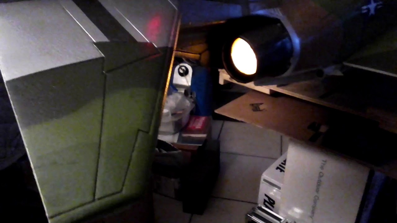

                                GoonieBurner and RudderTab install complete !!
