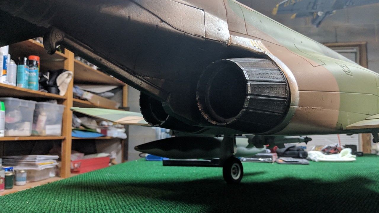

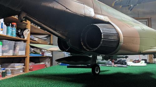

          A little airbrush work and Chris Wolfe's exhaust nozzles.
          RCJD, Now those are some dirty nozzles. Bravo Zulu, ;) Sir. Best, lB

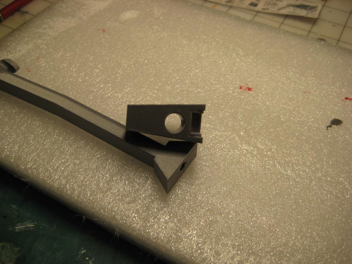

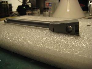

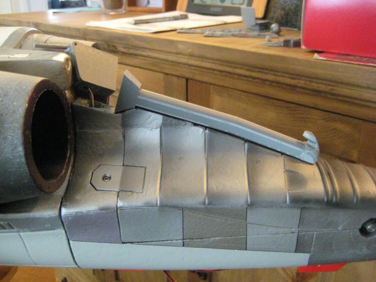

                      BBR, You crack up. LOL Yeah, the hook is a separate piece as I was thinking the same thing. (Also, had to go through several 3DP protos to get one that I liked. It is designed in 3 parts: 1) the pivot base (for lack of a better term), 2)Arm, 3)Tailhook. I used a micro servo, sheath/cable with a 'sphere' on the end that slides inside an angled cylinder column in the 3DP pivot base. The pivot base is hinged to the A/C. There is a compression spring in the cylinder that acts as the equalizer and pushes the pivot base down inside the column and gives some 'spring-back' motion for landing. In the up position, the sphere pulls the pivot base flush taking the pressure off the spring. I've got a little servo buzz, so figure I'll use the 'knob' on the TX to activate it. As far as parts, I'm not confident my designs would meet the standards being set here by the likes of DD, apmech1, RCJD, and others. My stuff is a bit clunky in that circle. LOL Best, LB
ID:	173961Click image for larger version
ID:	173962 ​​​​​​​ Click image for larger version
ID:	173963 ​​​​​​​ Click image for larger version
ID:	173964 ​​​​​​​ Click image for larger version
