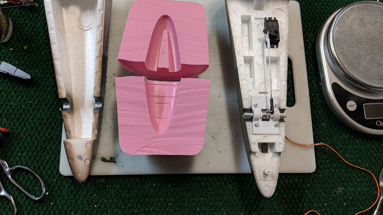

      Now this is unusual... I may have a new 3D printer but until I am up to speed on how to design stuff to make on it I still have to do some things the old school way. Here I am making a silicone mold of the tail cone to be able to make fiberglass pieces that will hold my chute. Once cured I will remove the tail cone and split the silicone to allow laying up the fiberglass in each half.

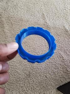

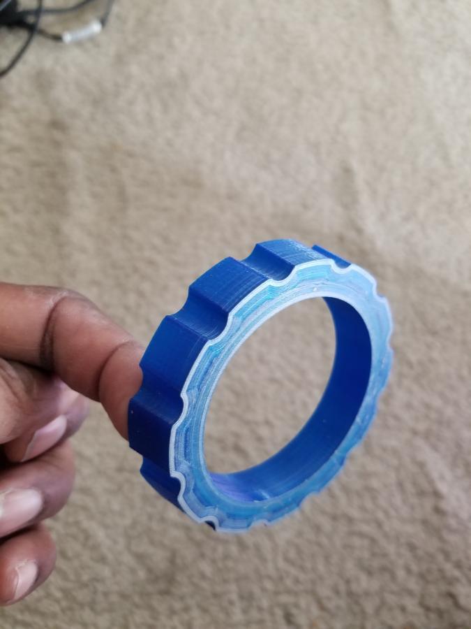

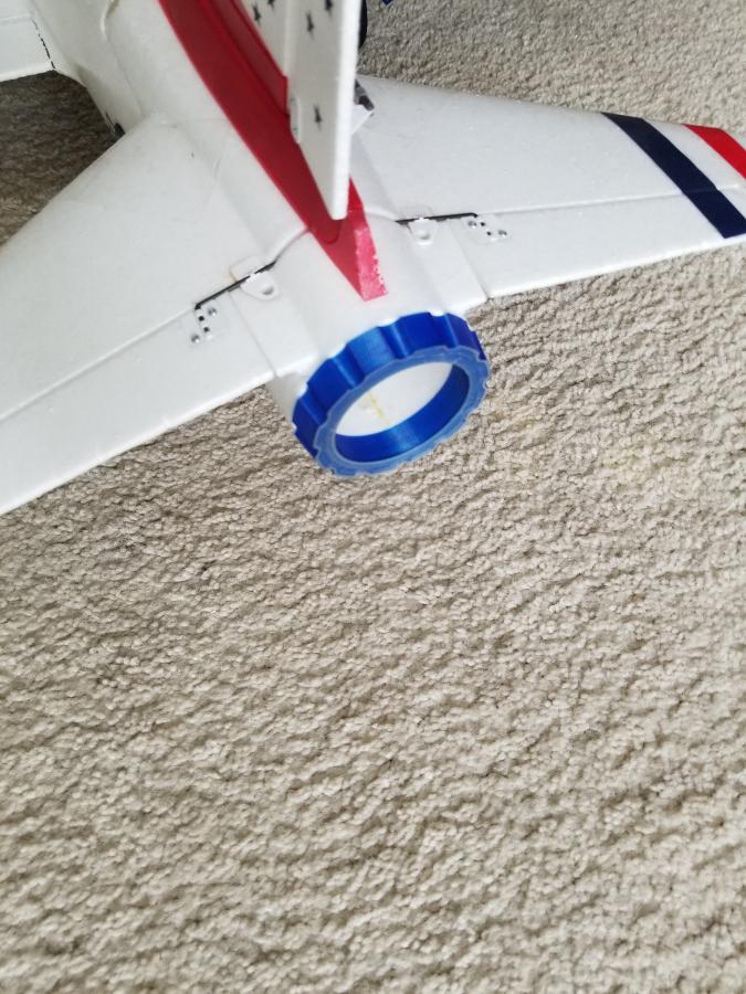

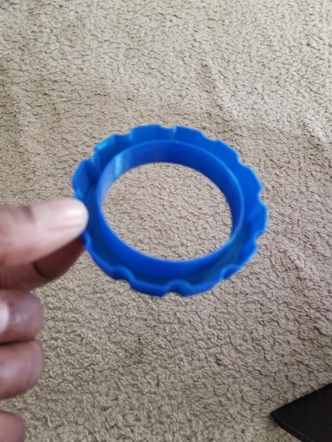

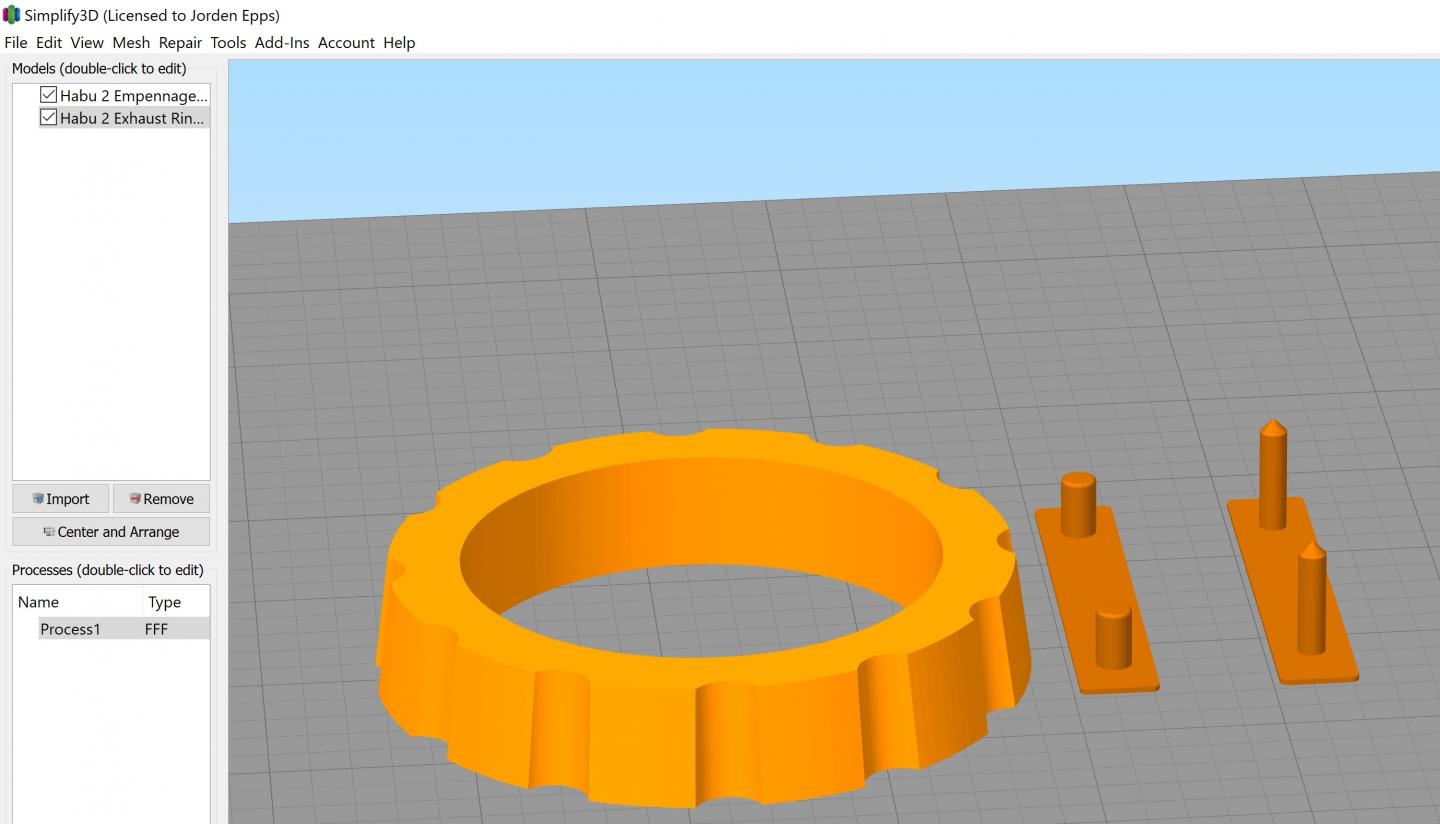

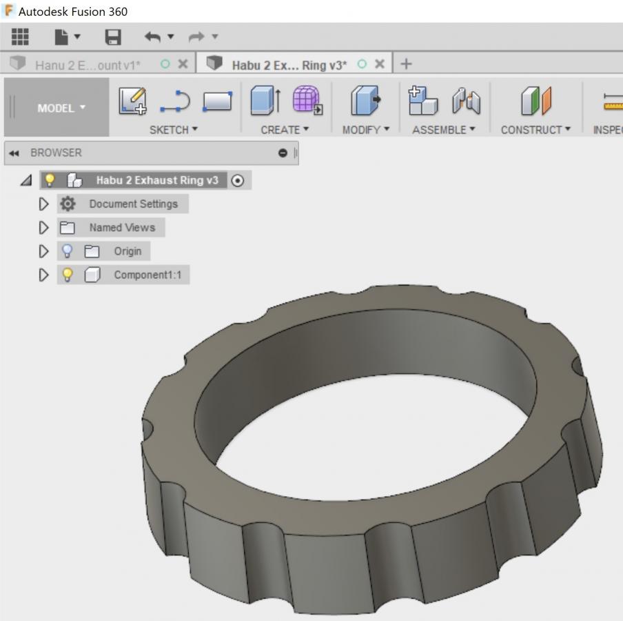

      I hear you! It takes time and practice to model it up in CAD. I'm learning Fusion 360, and was able to model up and print a new tail cone for my Habu 2. Took some time, but it was so satisfying to do it.

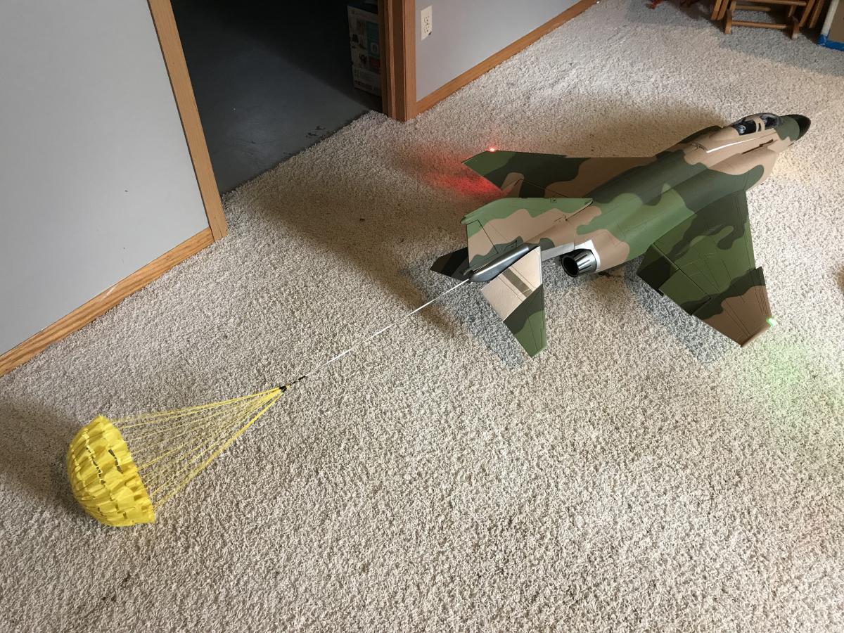

          That looks totally killer! Did you figure out a release mechanism for the chute already?

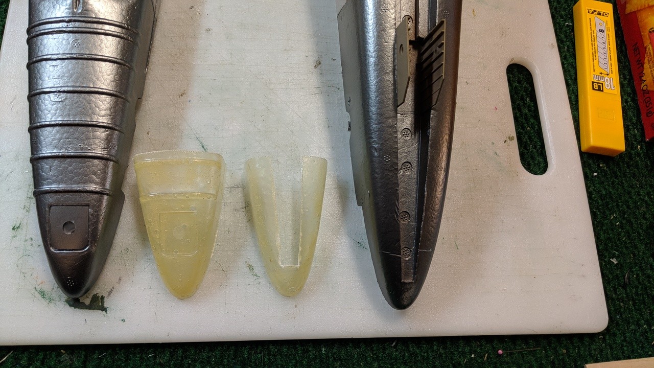

            Just split the silicone mold of the tail section. Next I will lay up some fiberglass.

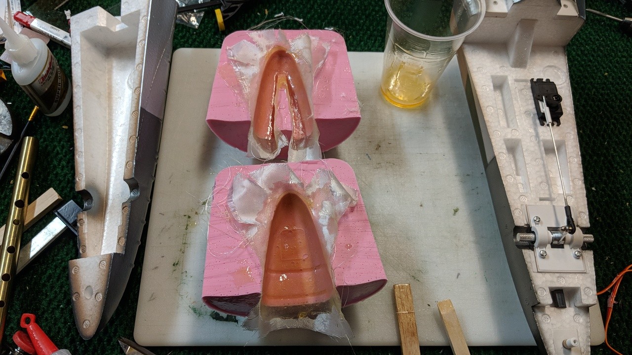

                                Fiberglass in the silicone tail cone mold.

                                    Looking good man!
                                      #1038
                                      And here are the fiberglass parts. Should be plenty of room to play with in the tail cone now.
