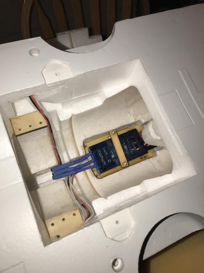

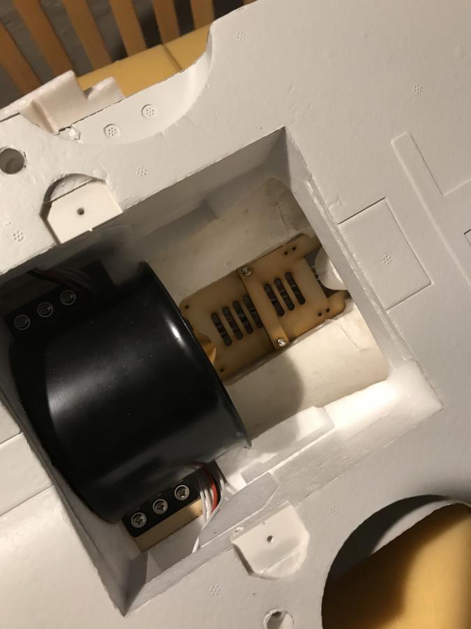

ID:	123732 My esc was not connected so do I have fins up or down when re installing? Thanks!

                                      The fins should be in the open air flow.

                                          Not sure what you mean by "fins". Are you talking about the slots cut into the ply in your second pic?
                                          The way the ESC sits in your first pic is correct. Do not do it like you have in the second pic. This way, the bulk of the ESC sits in the airflow into the fan. The ESC sits on top of the ply part with the slots cut into it, and then you have the thin strip of ply holding it in place. There is a wire channel that runs above the ESC, and the slots cut into the ply plate allow a little additional cooling to it. But the bulk of the cooling happens when air flows over it and into the fan.
