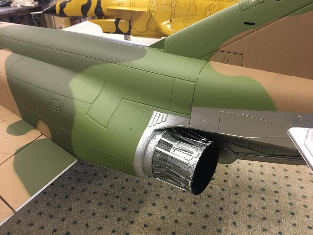

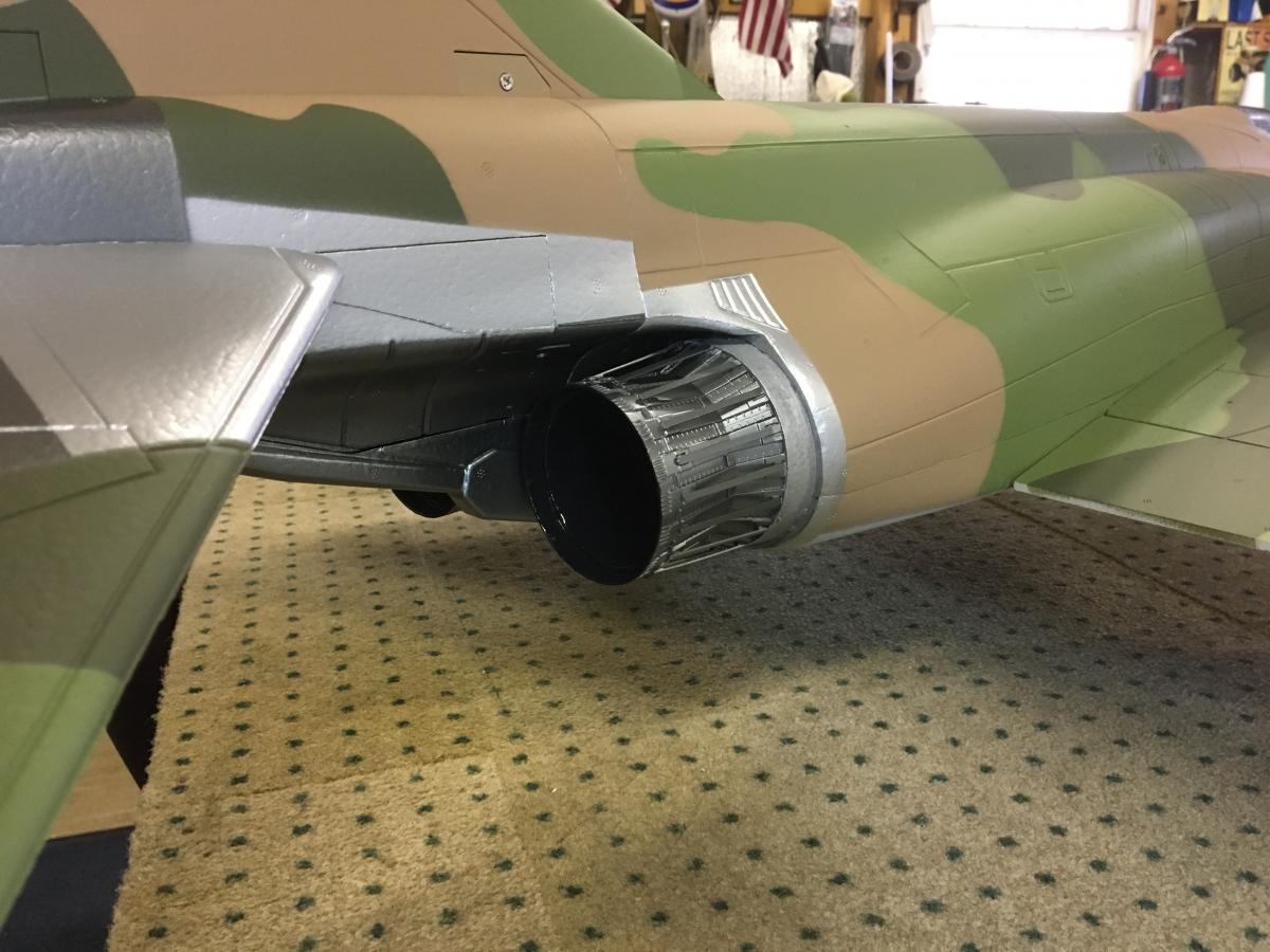

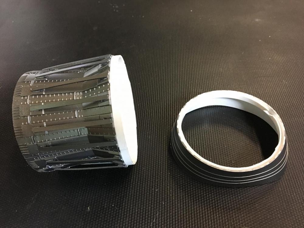

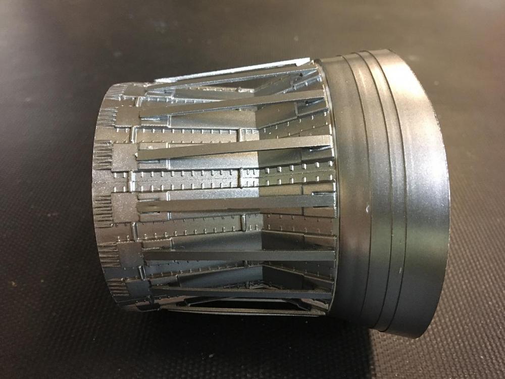

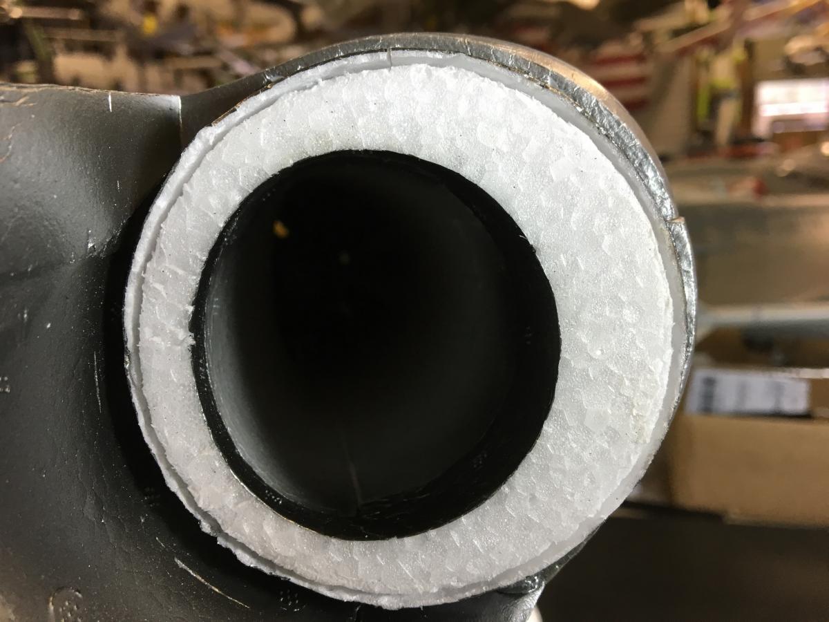

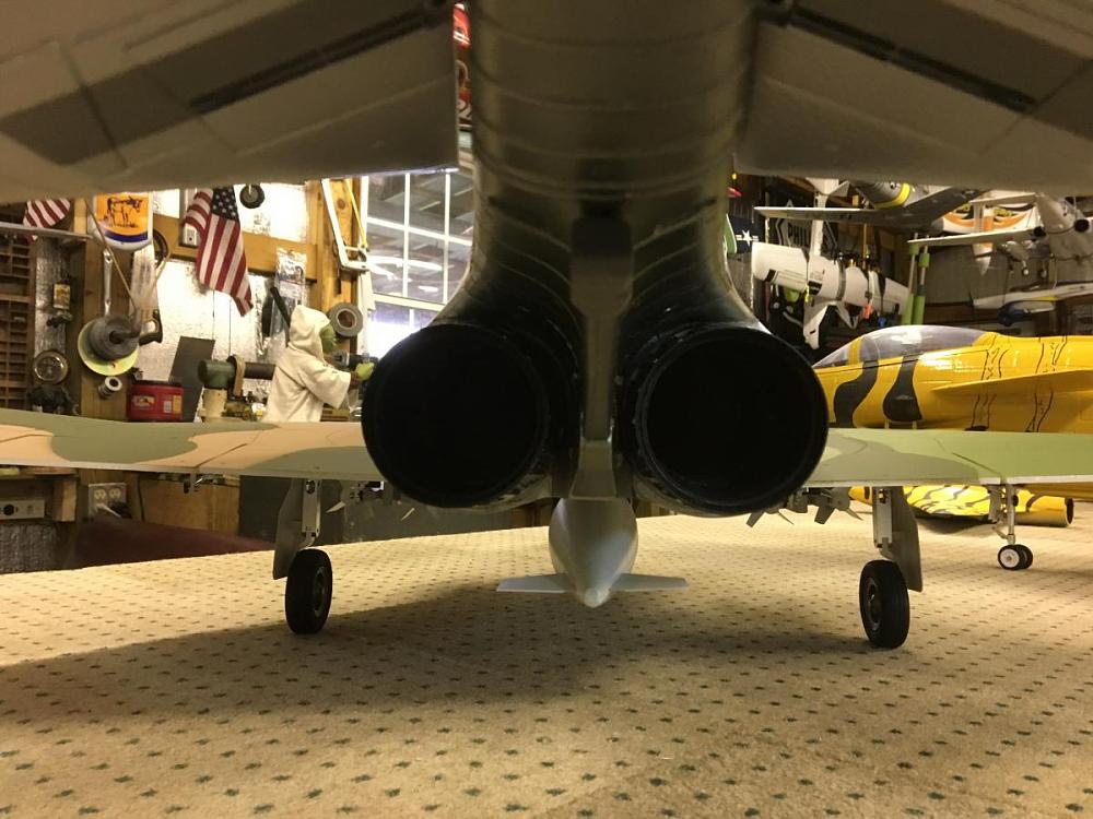

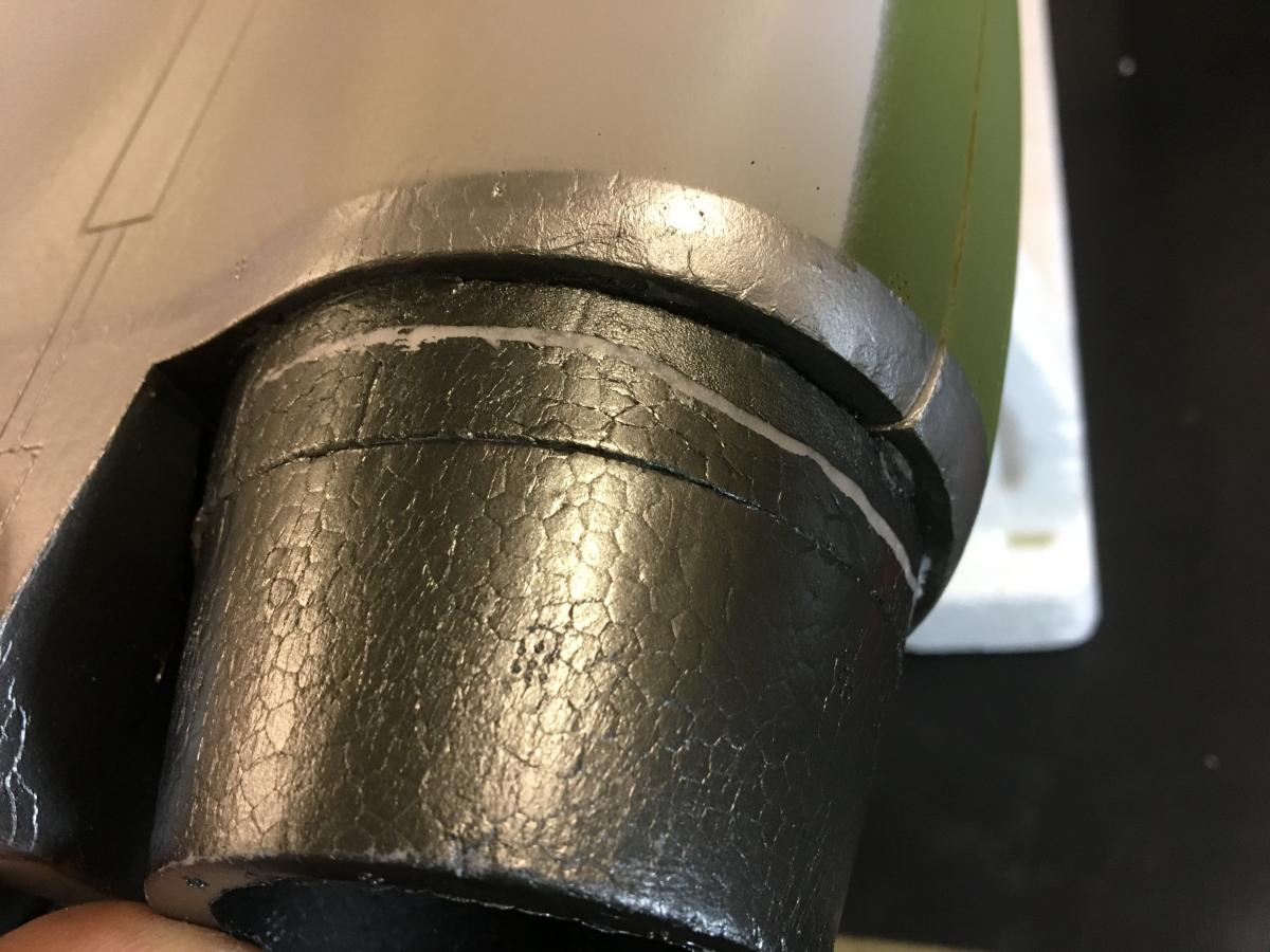

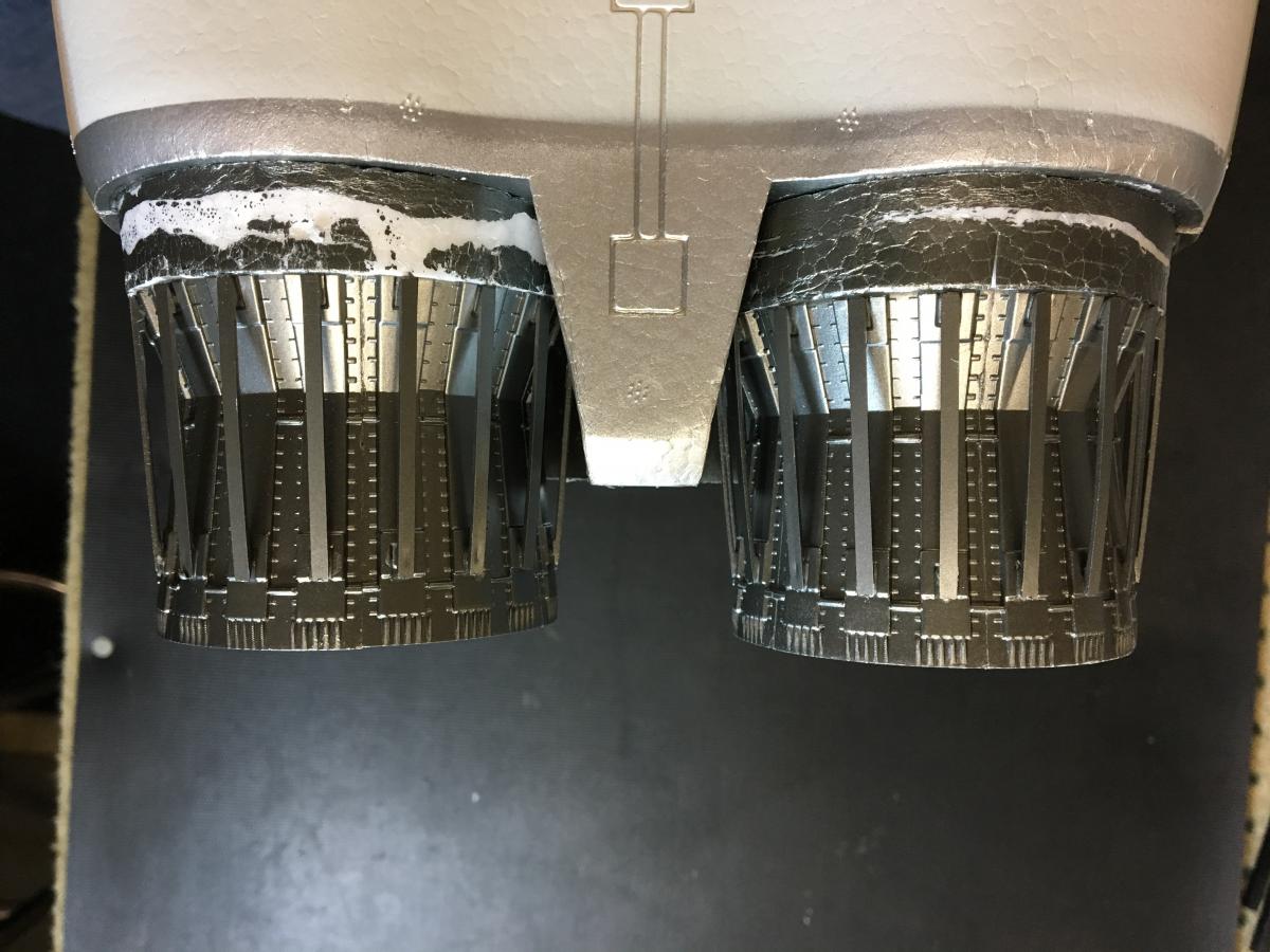

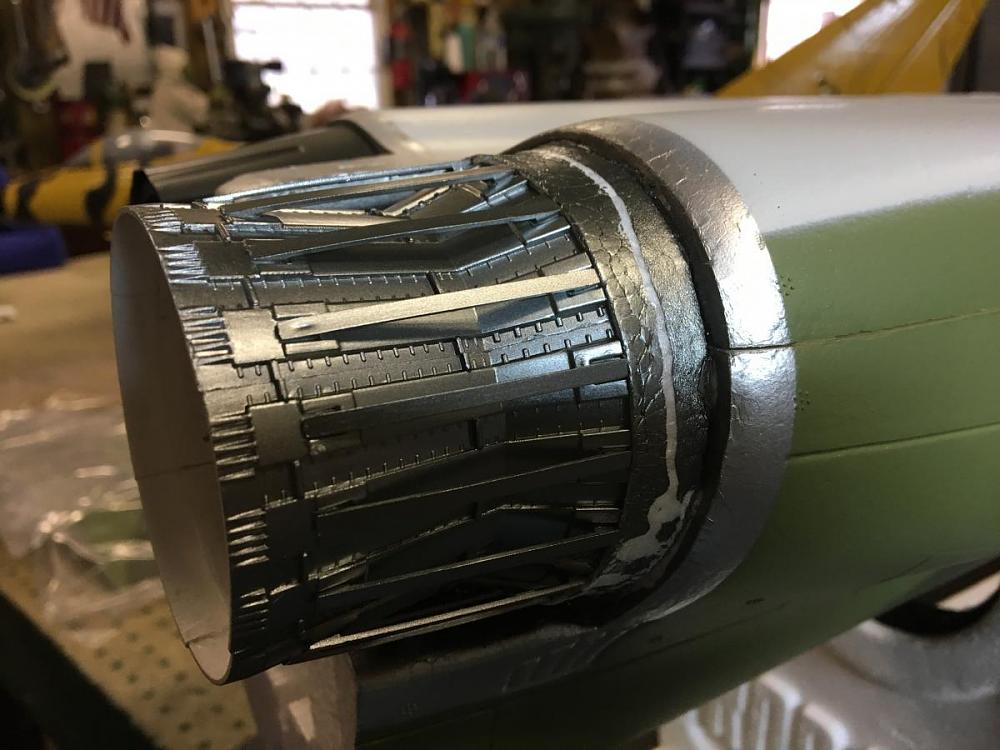

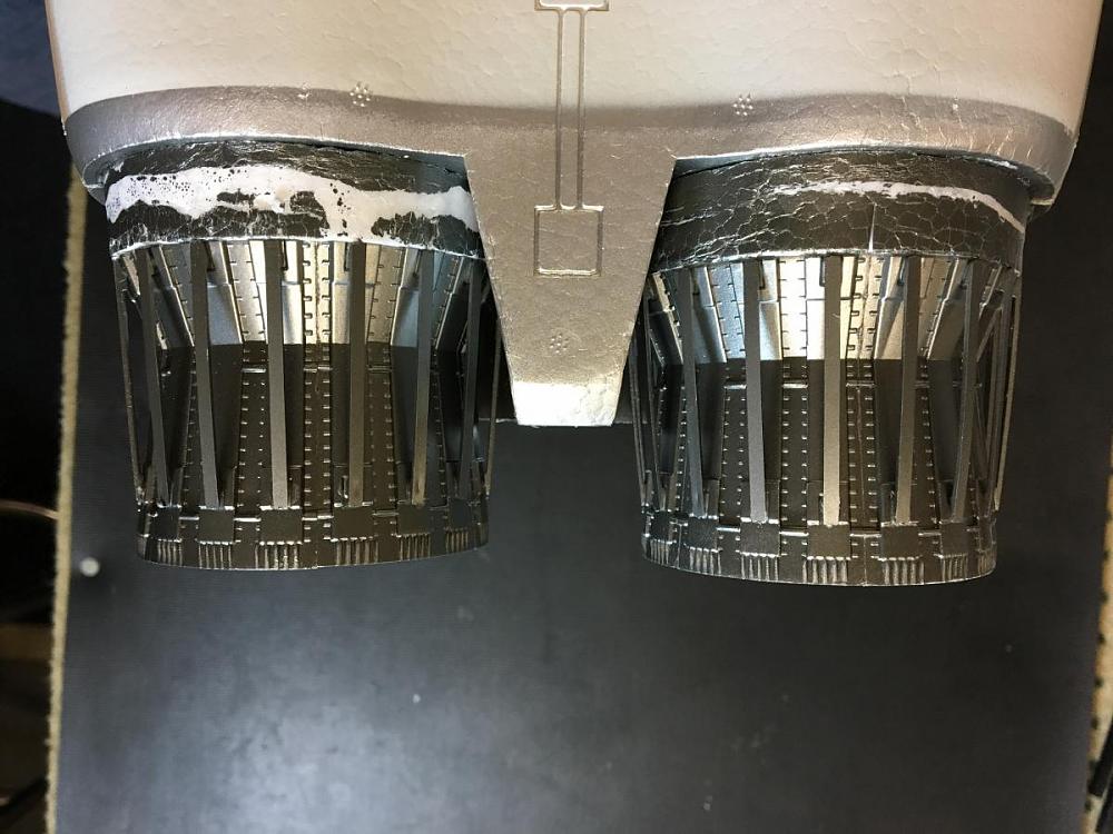

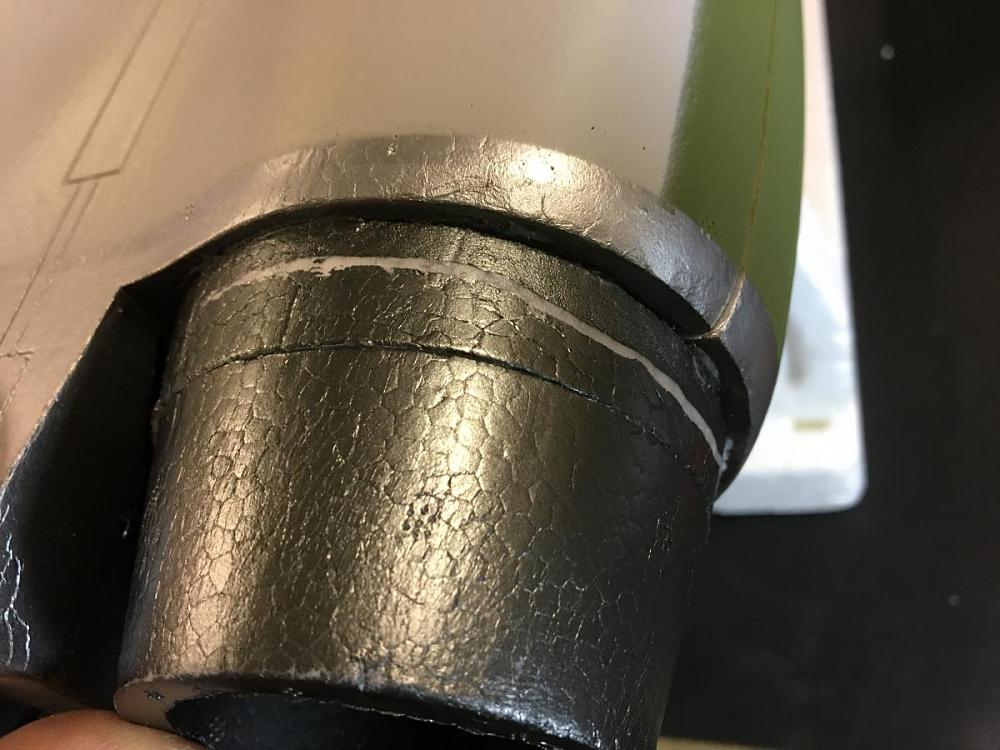

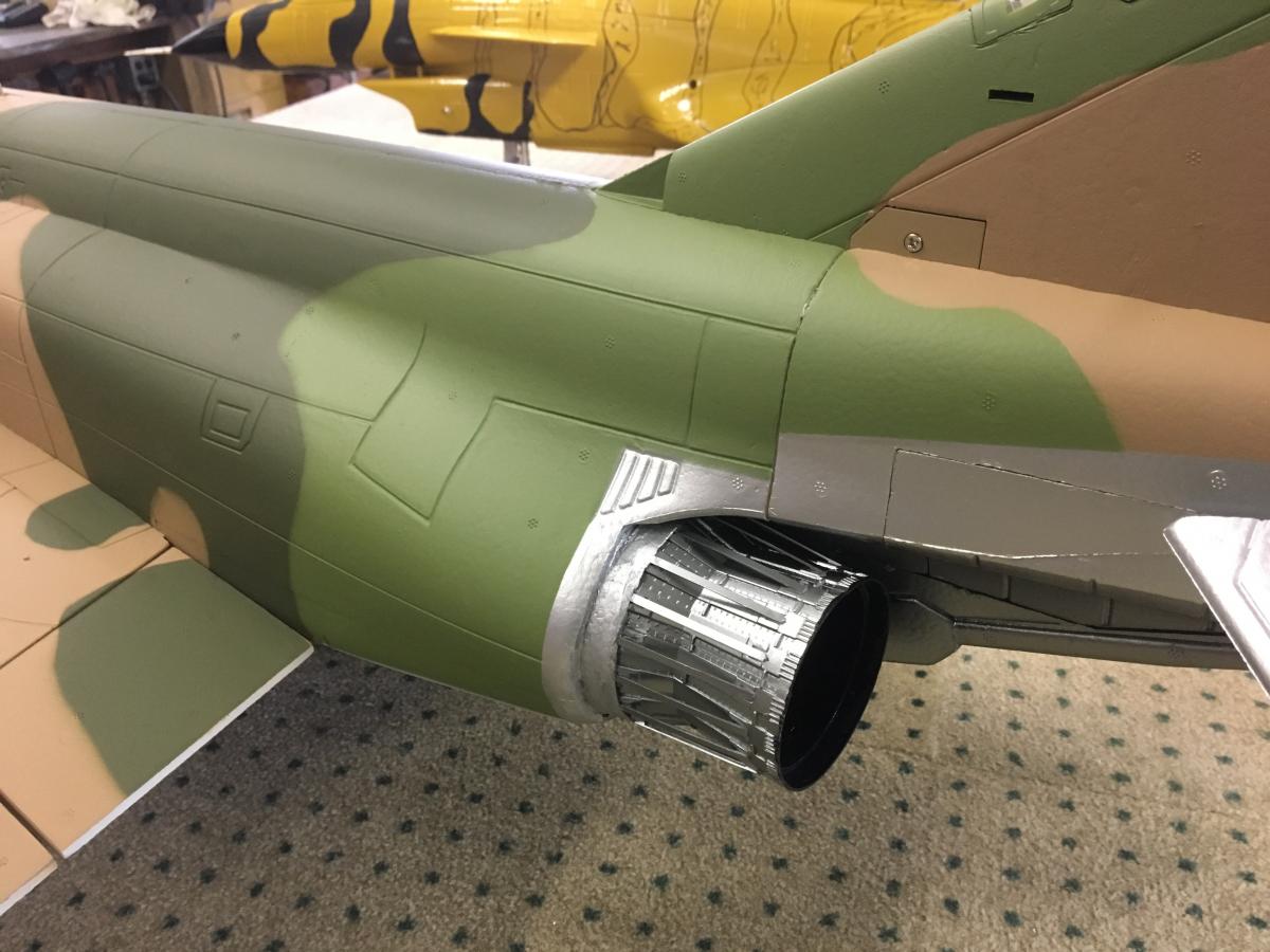

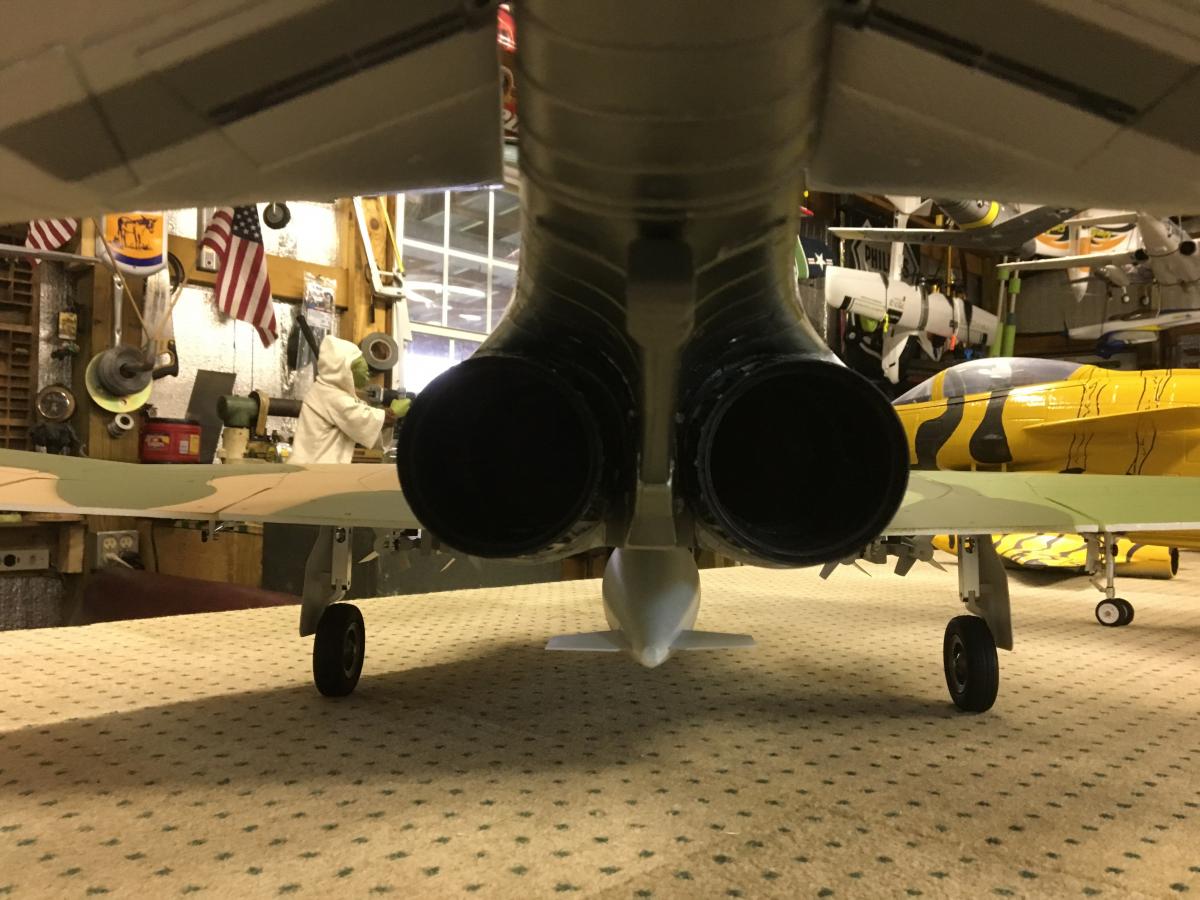

                  I know this isn't going to get past the scale police but I like it...
                  I've always loved the scale nozzles of the F-15 and when I saw the first pics of the F-4 I thought they might work on it.
                  Click image for larger version  Name:	20180320_170317865_iOS.jpg Views:	1 Size:	108.5 KB ID:	124172
                  Click image for larger version  Name:	20180320_170332522_iOS.jpg Views:	1 Size:	119.7 KB ID:	124171
                  I pried the plastic nozzle covers off with a pick then cut the foam on the stepped edge which is just slightly larger than the diameter of the F-15 nozzles after you remove the fuselage end (see pics). After cutting the foam off I cut a slot around the edge to allow the lip of the new nozzle to fit in then glued inside the slot and around inside the nozzle.
                  Click image for larger version  Name:	20180320_170134414_iOS.jpg Views:	1 Size:	114.4 KB ID:	124175
                  Click image for larger version  Name:	20180320_170357723_iOS.jpg Views:	1 Size:	110.7 KB ID:	124176
                  Click image for larger version  Name:	20180320_170709576_iOS.jpg Views:	1 Size:	108.7 KB ID:	124173
                  Click image for larger version  Name:	20180320_172657959_iOS.jpg Views:	1 Size:	125.1 KB ID:	124174
                  Click image for larger version  Name:	20180320_203619564_iOS.jpg Views:	1 Size:	115.3 KB ID:	124169
                  Click image for larger version  Name:	20180320_203523357_iOS.jpg Views:	1 Size:	124.1 KB ID:	124170
                  Click image for larger version  Name:	20180320_203542590_iOS.jpg Views:	1 Size:	93.4 KB ID:	124167

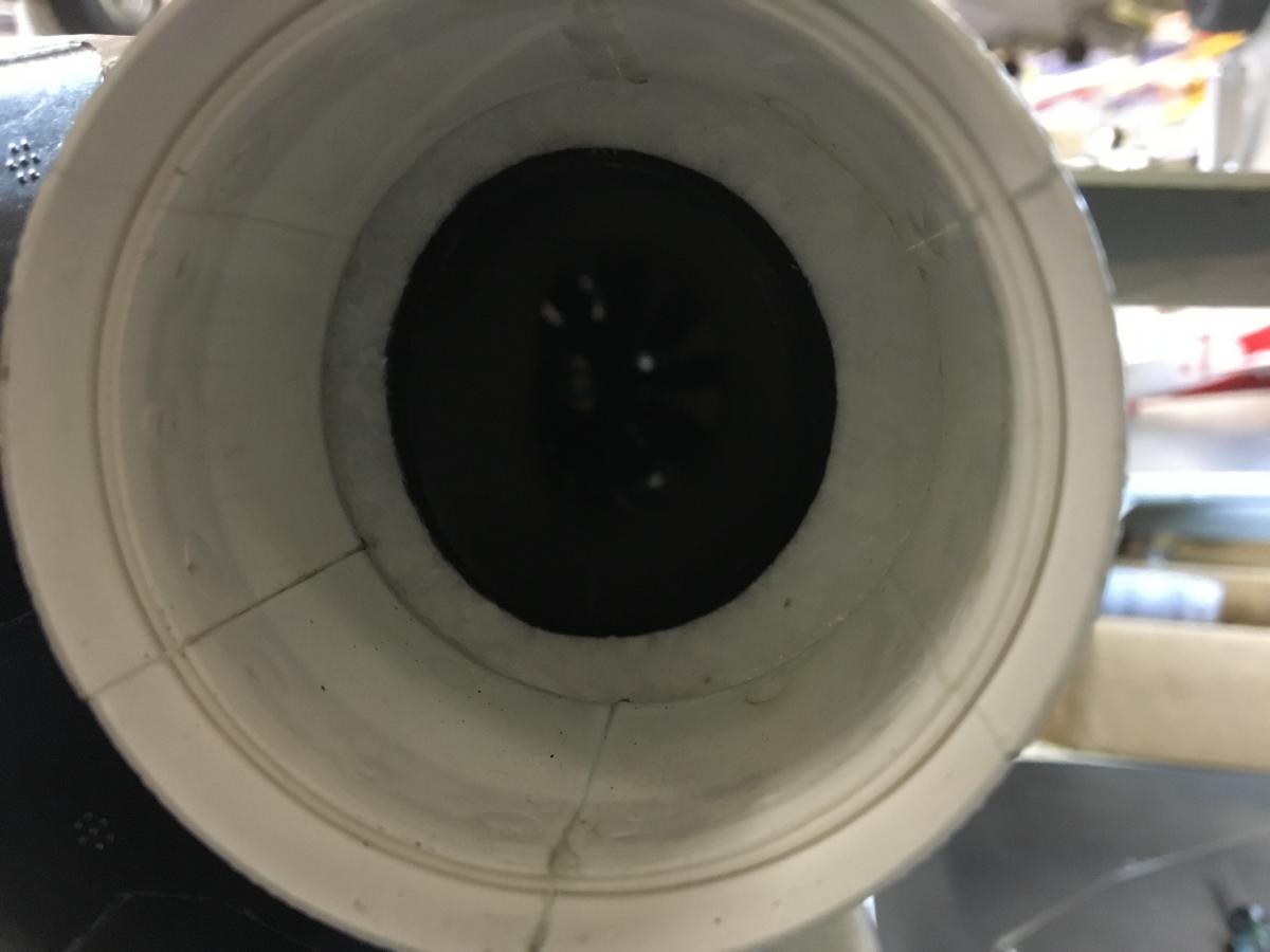

                            Here's what I found when I pulled the battery hatch on mine. OOPS

                              Originally posted by john2kx
                              Tired,
                              kind of new to EDF, other than making sure wires are connected and not making contact with fan, any other pointers? I did pull hatch cover and didn’t see anything alarming, followed by a spool up.
                              John
                              On occasion, the plugs from the motor will barely be seated to the ESC wiring. I use color coded heat shrink on all three leads (after a rotation check) to secure them on all my models. Also, checking the ESC mounting is important so nothing moves out of the airflow or gets sucked into the fan. I have had the motor and fan units have loose screws too, so check them and the fan to motor screw as well...
                                #915
                                Case in point for ESC mounting!! :saywha

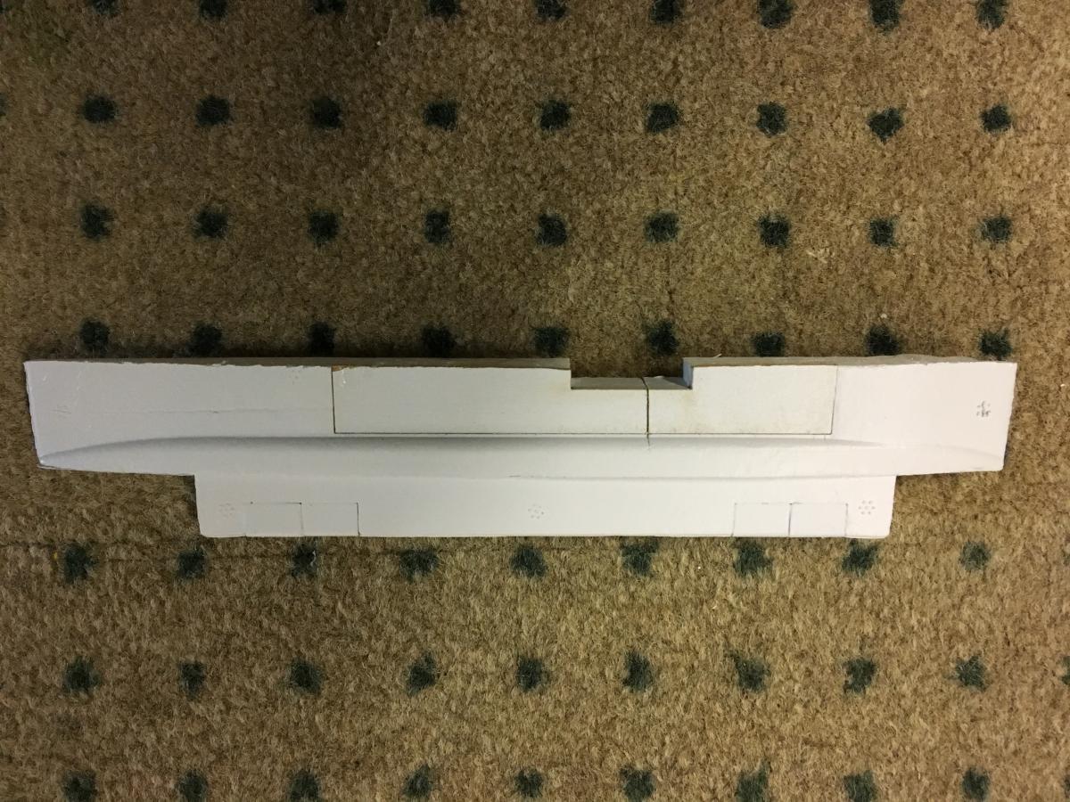

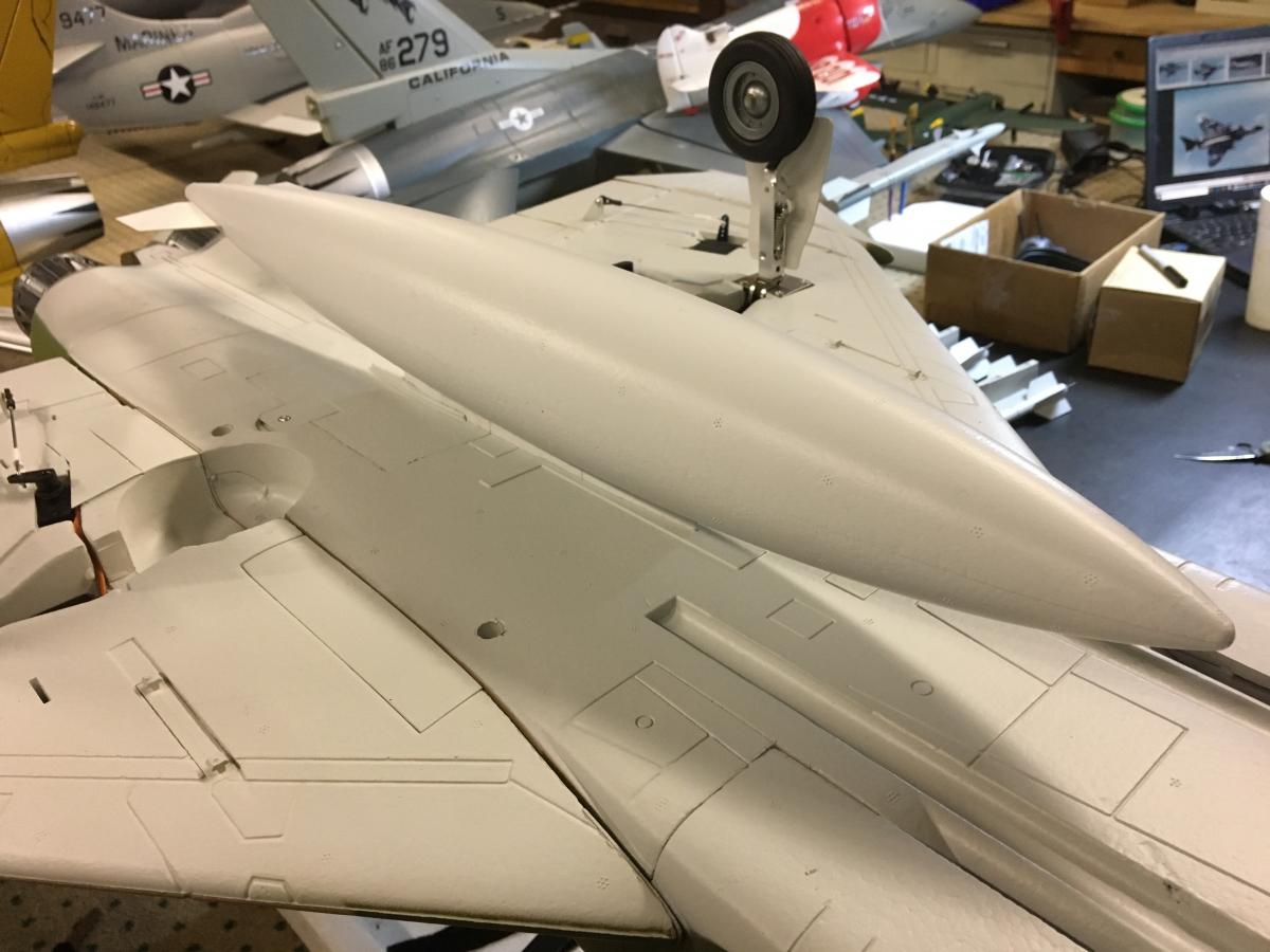

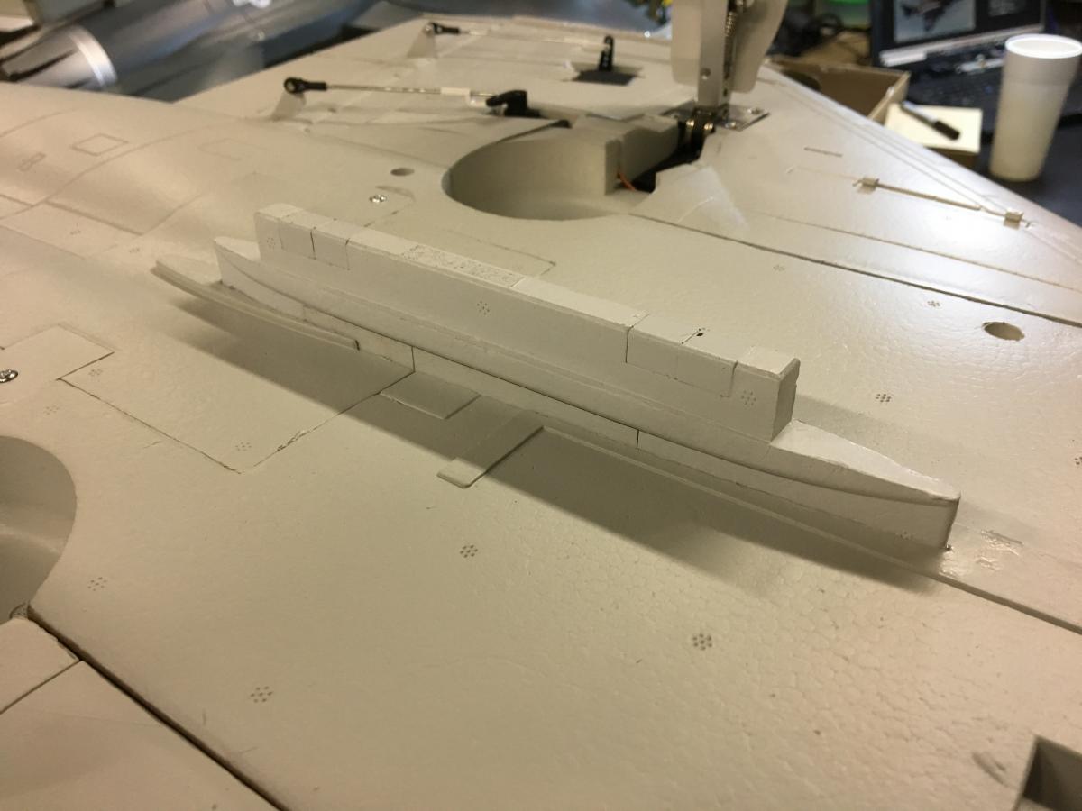

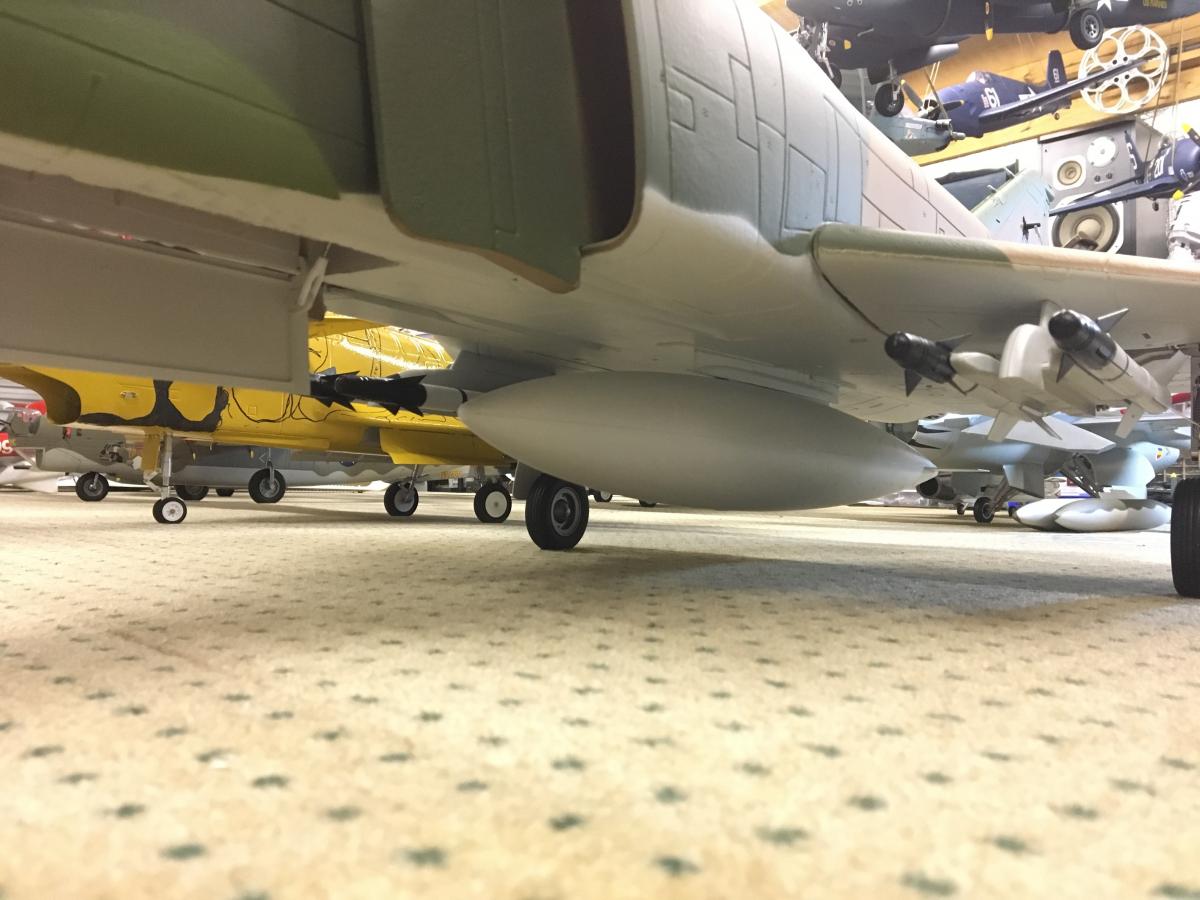

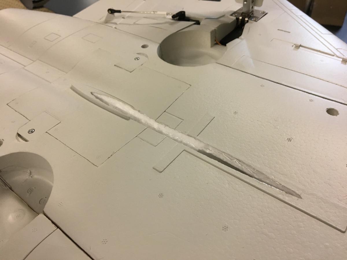

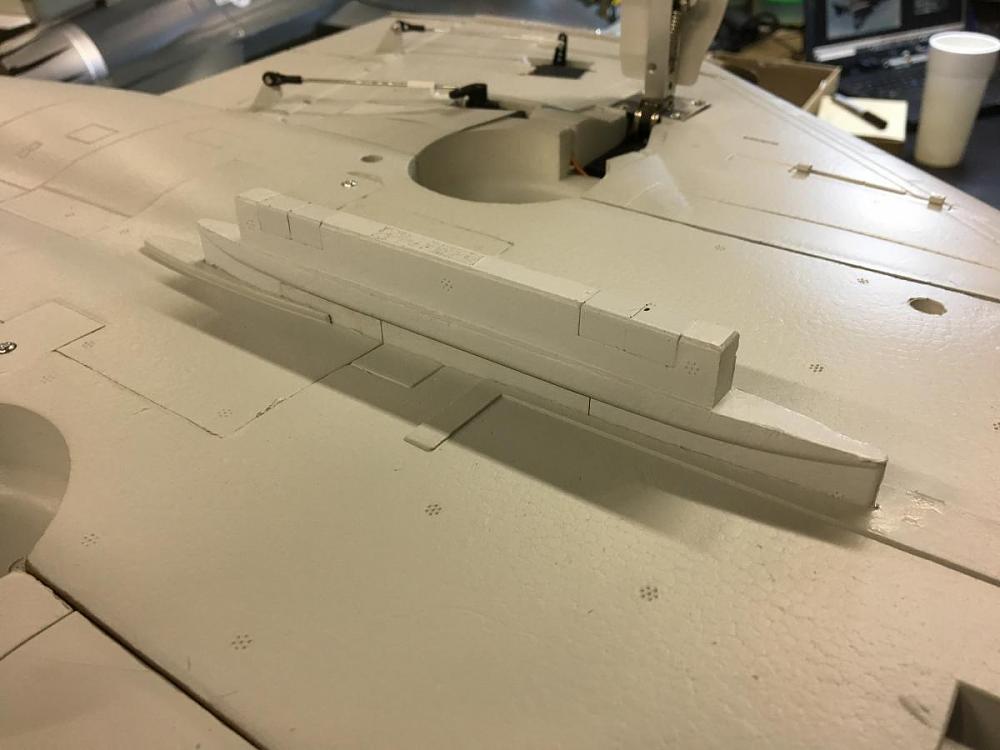

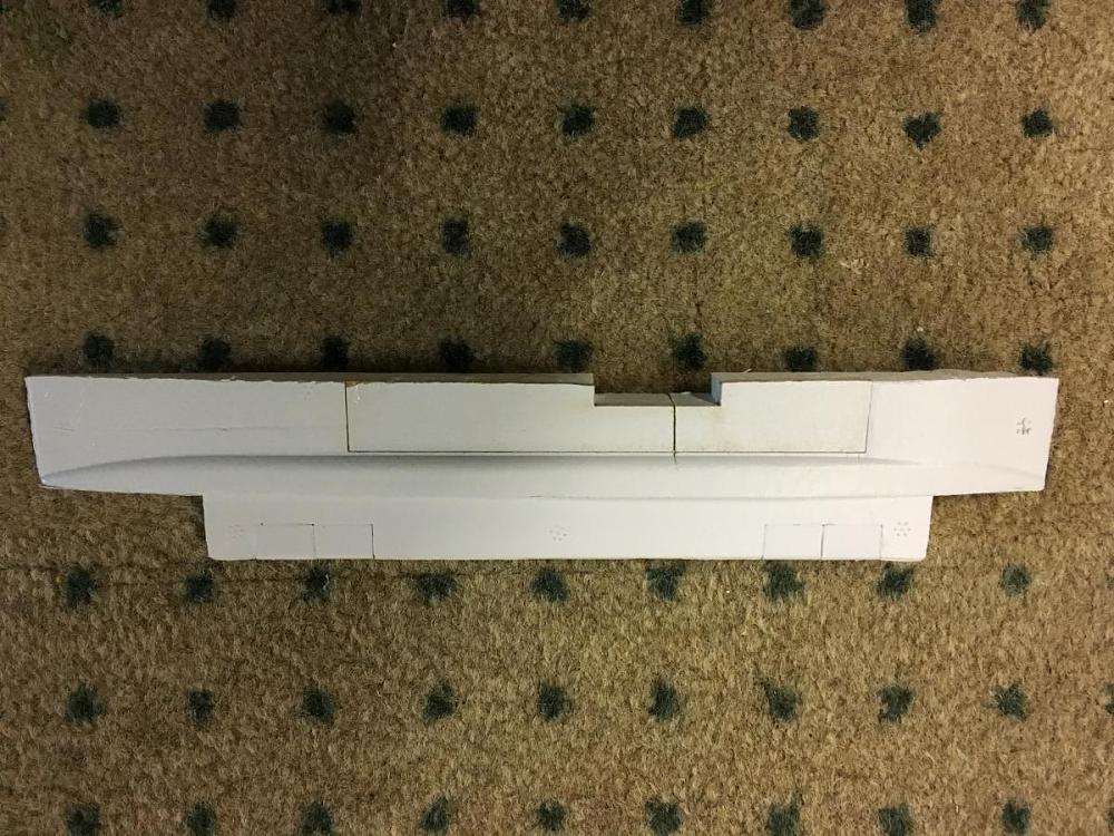

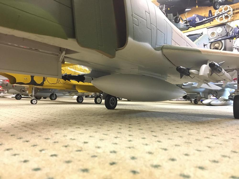

                                        Center drop tank mod, I put a center drop tank on my A-4 so I had an extra tank.
