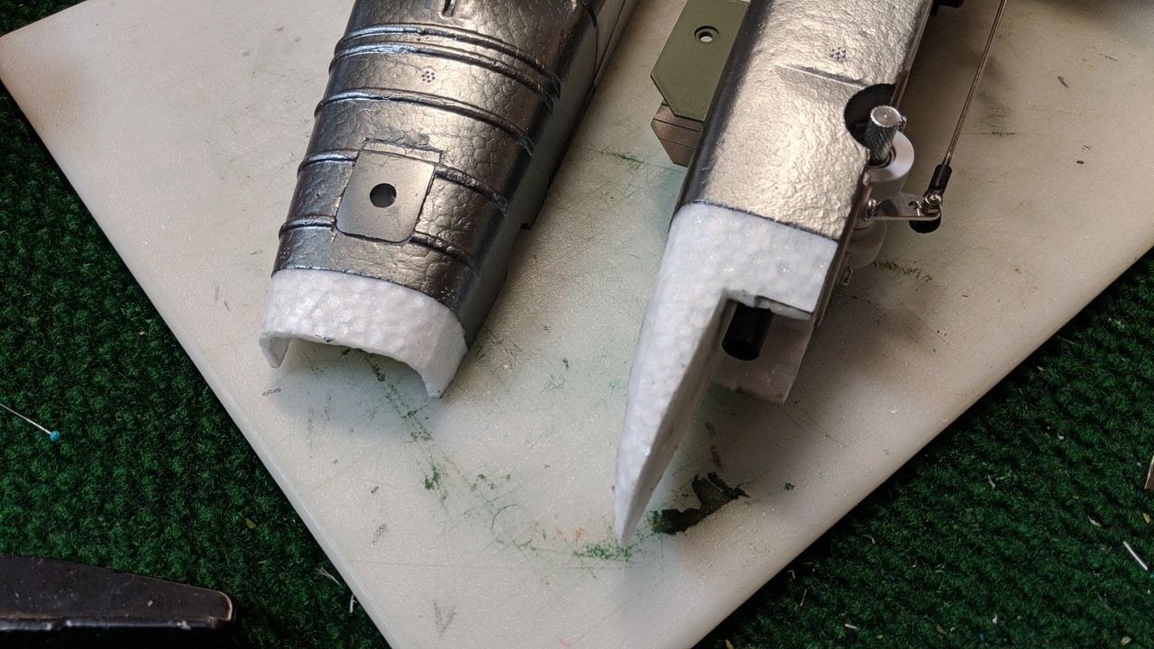

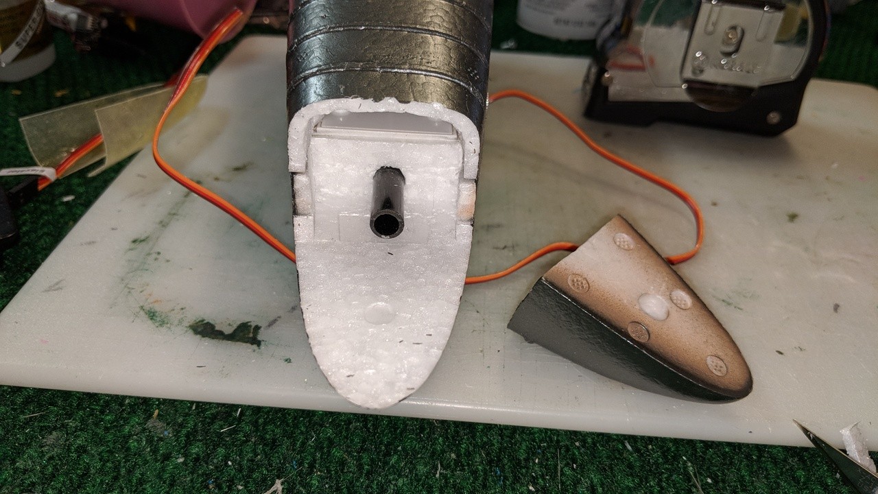

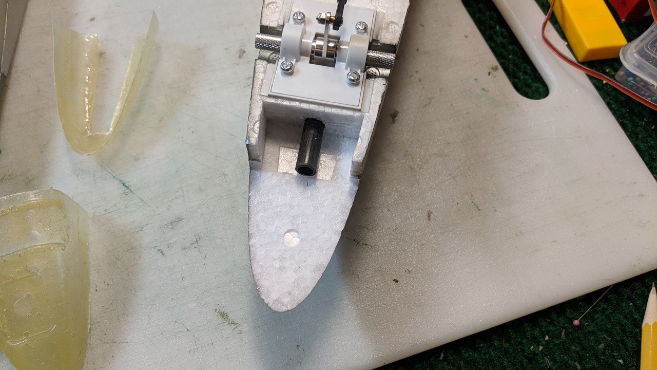

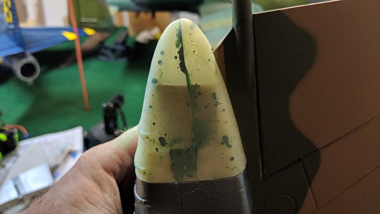

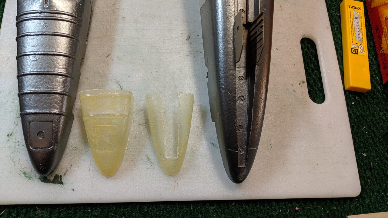

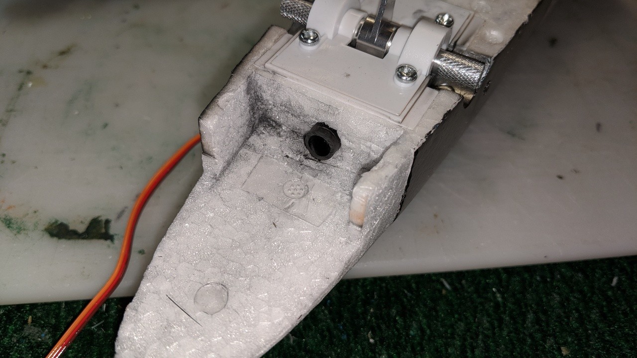

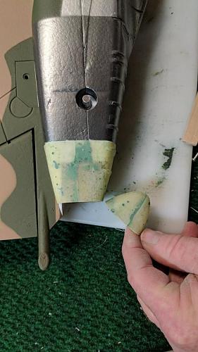

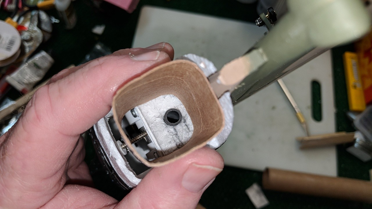

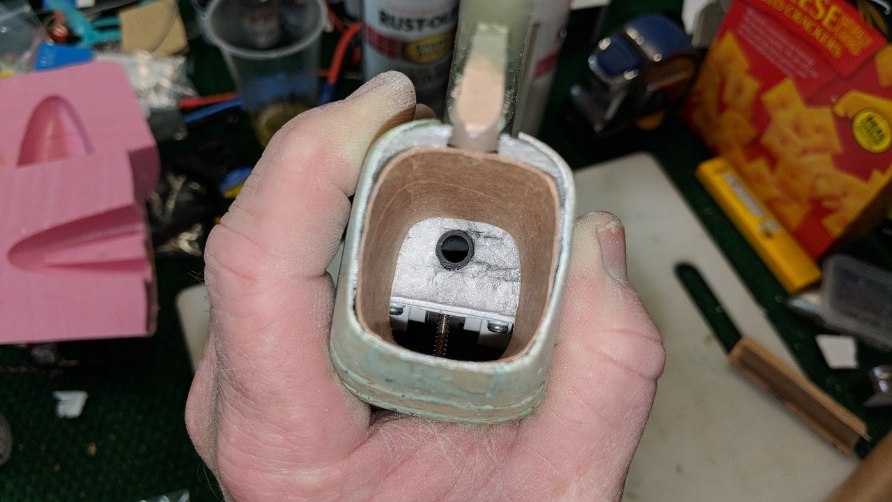

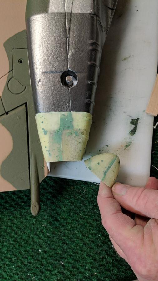

                            Latest progress on the chute mod. After molding the tail cone with silicone and laying up fiber glass in each half I started whittling away at the foam trying to figure out how I planned to do this as I went. I ended up fiberglassing the two halves I made together and formed an Estes BT-55 body tube into a 2" long rectangular box to fit inside the tail cone. I did cut off the FG tube that helps secure the tail section to the fuse and will use it to anchor the chute cord. Also relocated the rear hard point. The pictures kinda speak for themselves. Next, I will add a hinge to the bottom of the hatch and think further on how to latch it. I have some ideas.

                              That's awesome Steve! Can't wait to see it done and in action.
