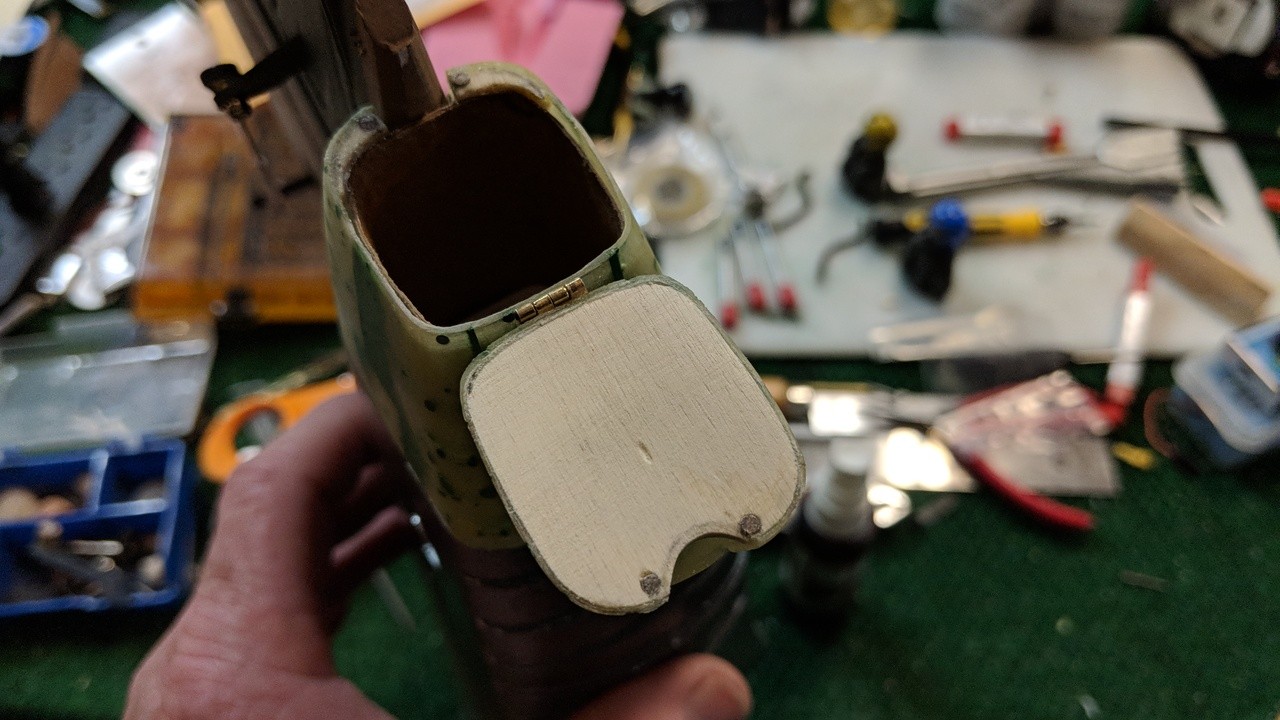

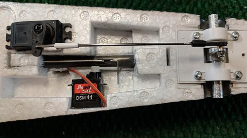

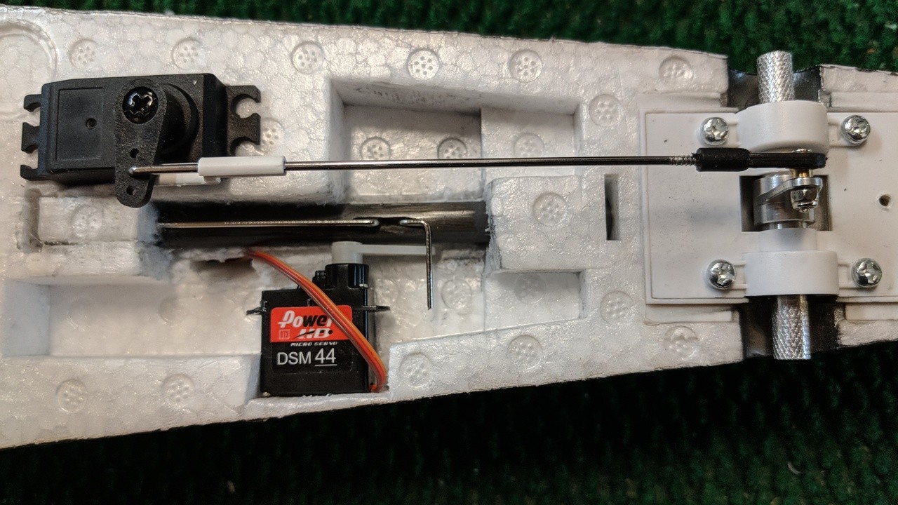

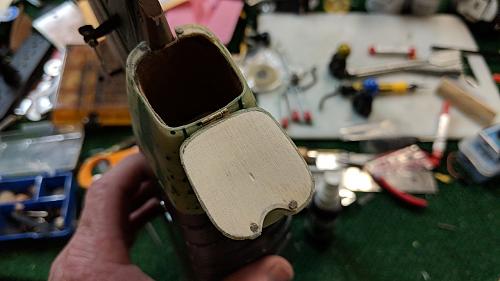

                          Completed release mechanism with magnets and servo installed. And a test video.
                          Click image for larger version  Name:	IMG_20180402_190330.jpg Views:	1 Size:	239.4 KB ID:	126637
                          Click image for larger version  Name:	IMG_20180402_201752.jpg Views:	1 Size:	205.8 KB ID:	126638

                                [QUOTE=RCjetdude;n126636]Completed release mechanism with magnets and servo installed. And a test video.
                                Steve, This brings a big ol' smile to my face. Again, very clever. Best, Elbee
                                  #1156
                                  I must give credit where credit is due. Helmsman52 (Paul) has been hugely instrumental in helping to come up with what you see. I may have brought the parts together to make it work but Paul is the one who had the idea to use the existing CF tube in the tail section to make the spring loaded release mechanism. He is a very clever individual. ;)I just ran with his idea and I like how his chute turned out so I will be making one like his.
                                    #1157
                                    Superb!
                                    • Boots Whirlygig
                                      • 560
                                      • Granville Ohio USA
                                      #1158
                                      I like how easy it is to reset for the next flight. Now what would happen if it accidentally deployed in flight?
                                      • janmb
                                        Slow and low
                                        • 729
                                        #1159
                                        This will be awesome indeed!
                                        What plans have you made this far for releasing the line? Needed in terms of safety as well I'd imagine...
                                          #1160
                                          I would expect the elastic shock cord to snap but let's hope I never have to find that out. LOL I could also try building in a weak link where the shock cord attaches to the eye screw on the plunger assembly.
