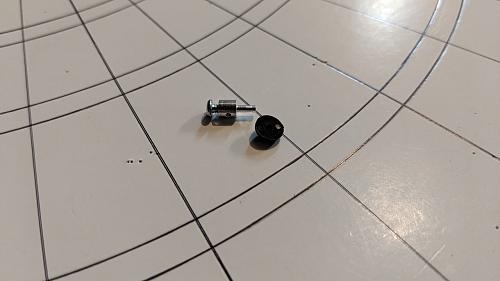

                    Rick, mechanically, other than replacing the servo arm with a standard arm and adding one of these style of connectors I don't know of another way to increase the throw to the steering arm.

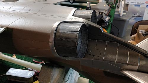

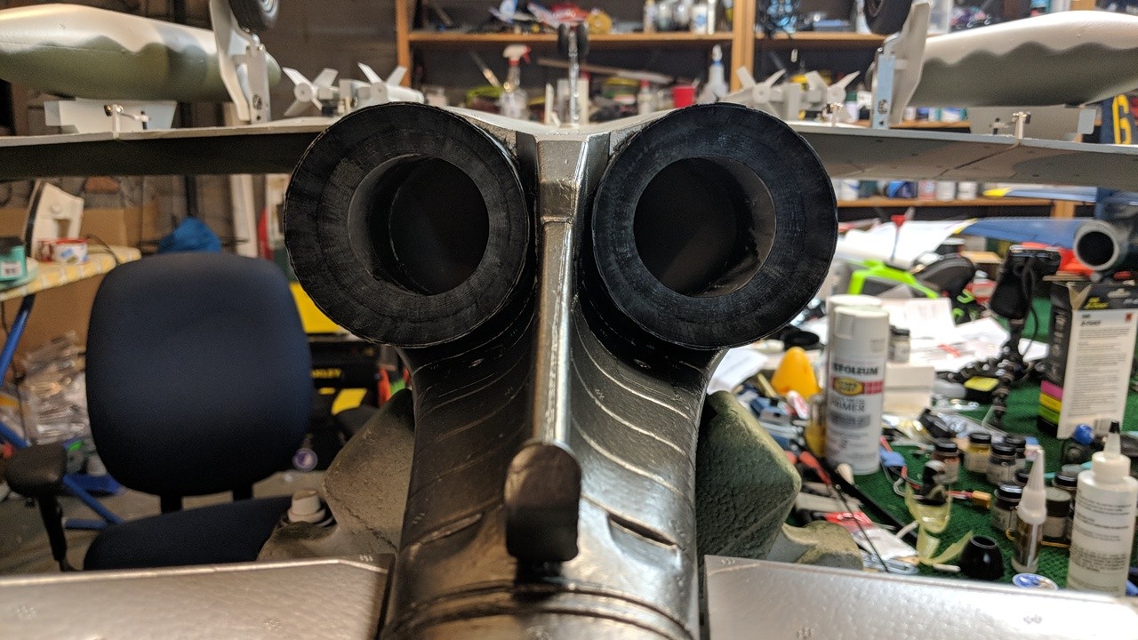

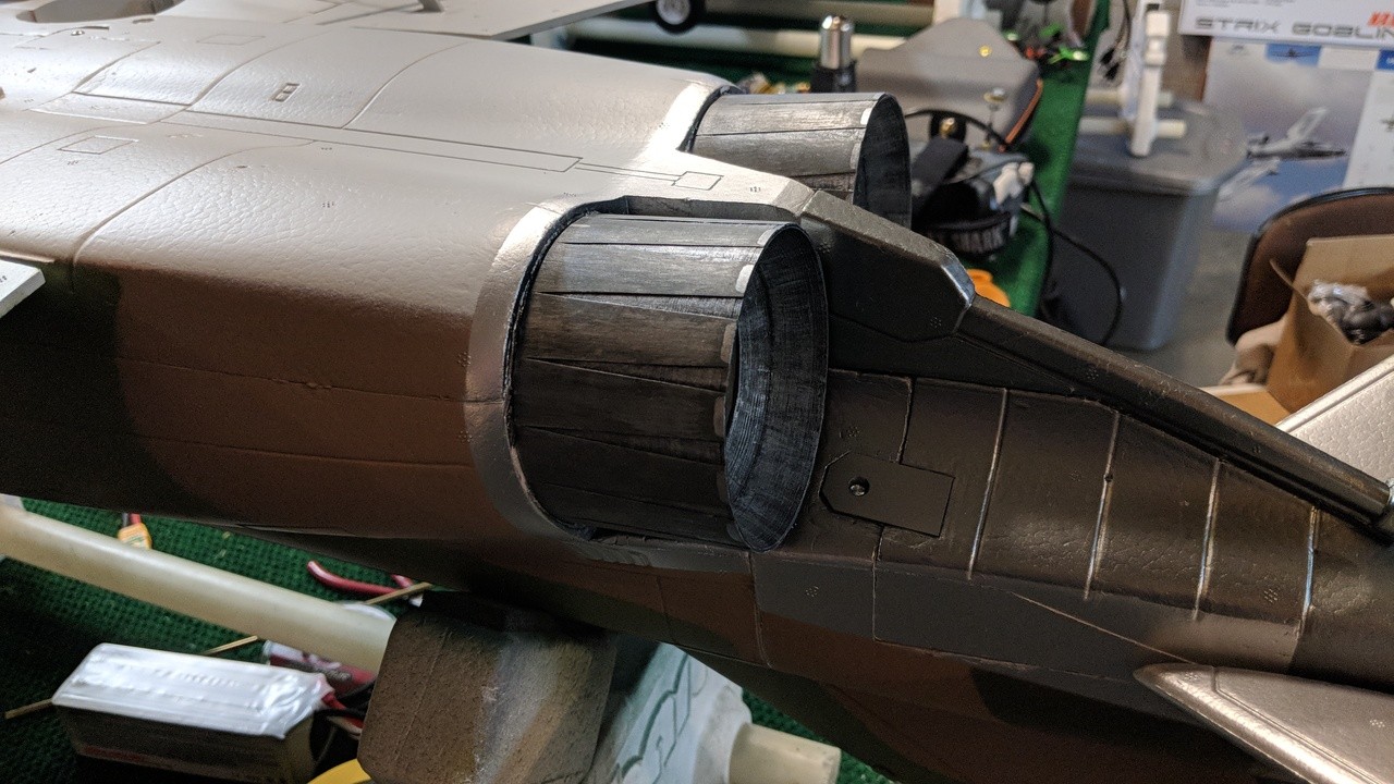

                      Got my cans painted last night.
                      Click image for larger version  Name:	IMG_20180412_073237.jpg Views:	1 Size:	249.6 KB ID:	128391
                      Click image for larger version  Name:	IMG_20180412_073229.jpg Views:	1 Size:	259.3 KB ID:	128392

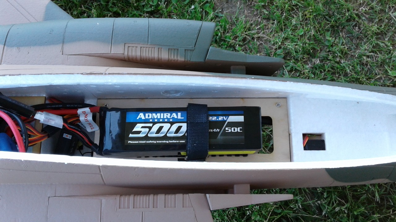

                                        Maidened mine today. Two flights so far.
                                        Fms 90mm edf unit
                                        flt 1...3:43, 3.77/cell, turnigy 5000 hd
                                        flt 2...3:07, 3.85/cell, Admiral 5000
                                        Click image for larger version  Name:	20180412_135048.jpg Views:	1 Size:	222.3 KB ID:	128448
                                        Right now i am at high rates, increased elev-flap mix a little, and cg is spot on no trim.
                                        It's windy here and she doesn't care. She just floats in like a trainer
                                        Click image for larger version  Name:	20180412_135526.jpg Views:	1 Size:	231.0 KB ID:	128449

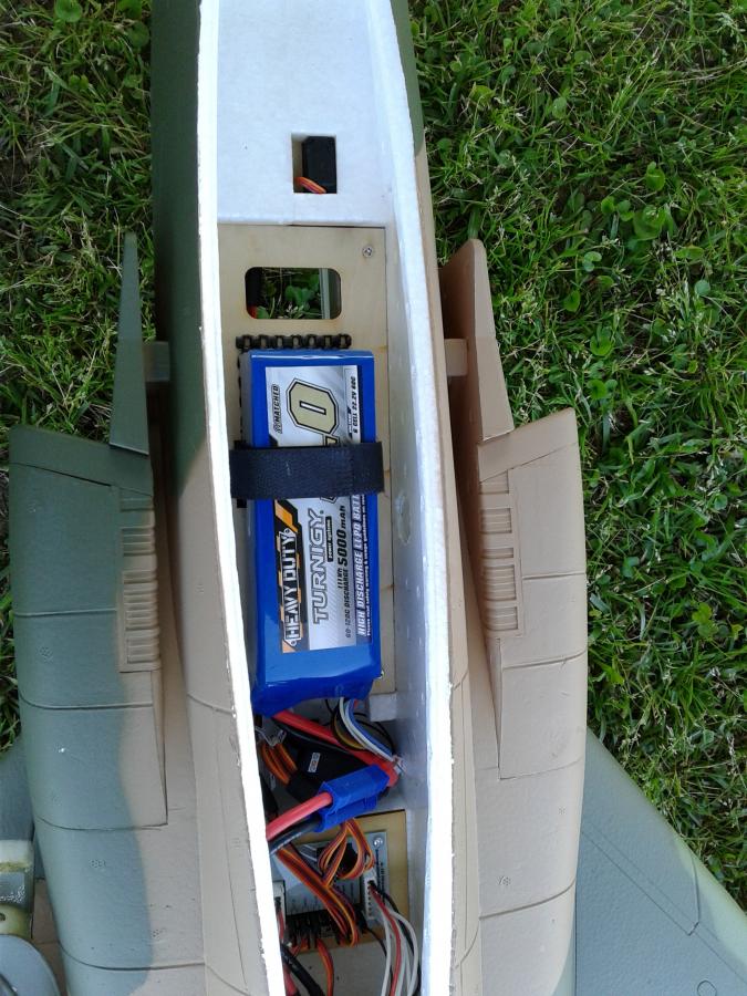

                                          Here is my heavy Turnigy placement. FMS fan unit.
