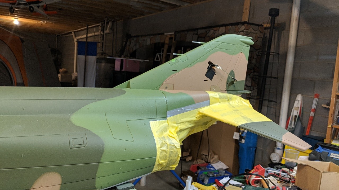

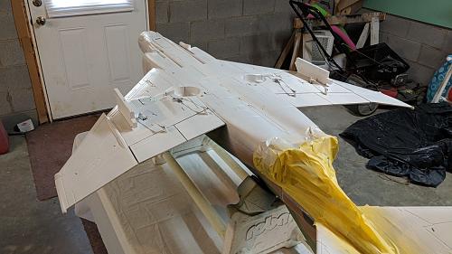

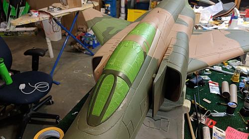

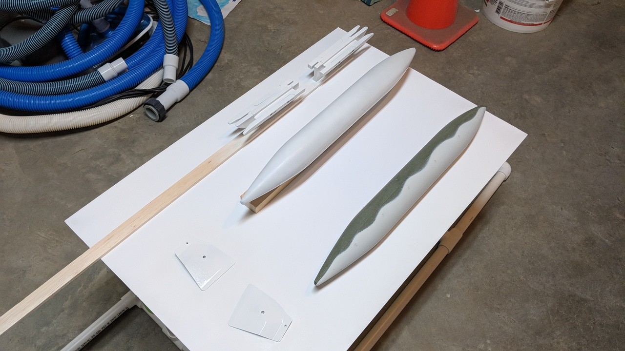

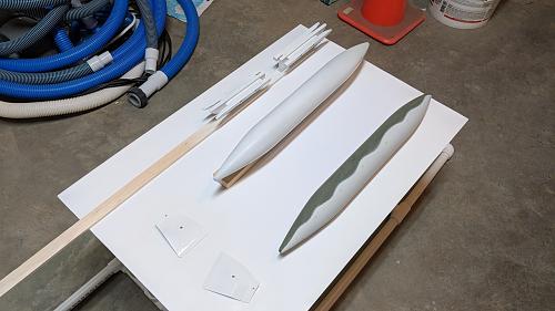

    Center burner test.
    Got it masked tonight.

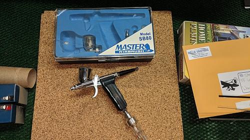

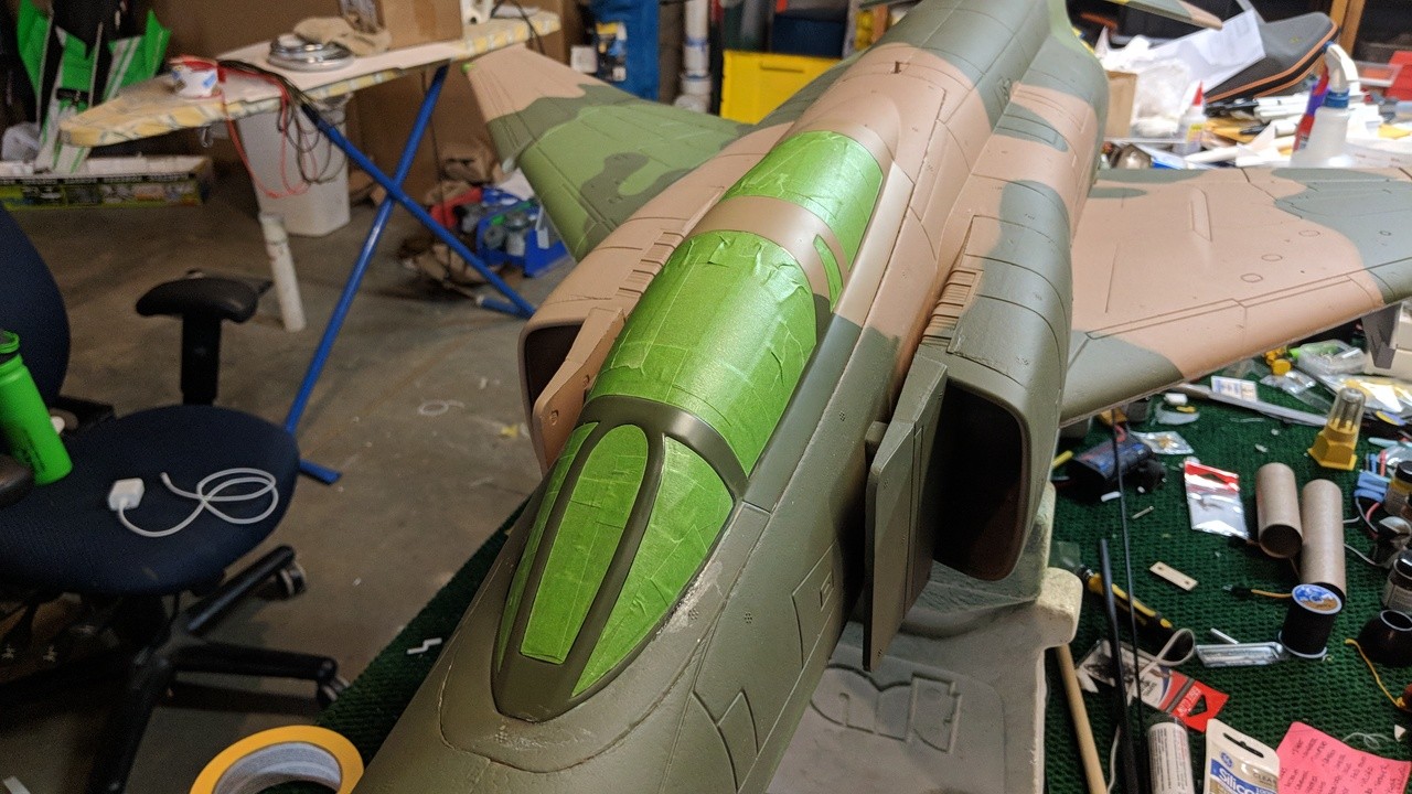

        Looks great Steve! Questions:
        What masking tape are you using?
        What paint, rattle can or airbrush, if airbrush what gun for large coverage?
        Are you doing an overall primer coat first, if so, what?
          #1424

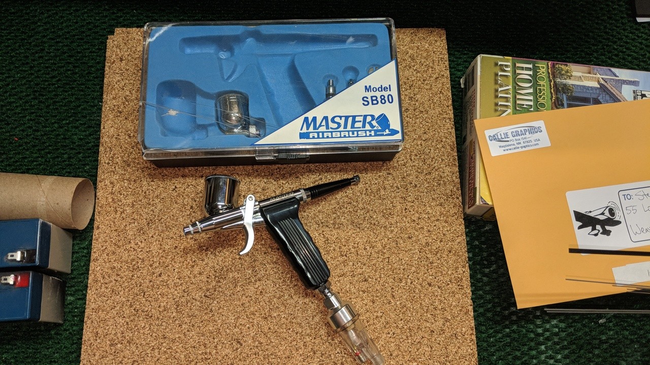

          Hey Boots, I am using green and yellow frog tape. Green on the canopy and LED lenses. Yellow on any painted surface applied after sticking it to my shirt first. Next I will be giving it a light sanding with some 220 grit sandpaper and then wiping it with denatured alcohol. After that I will wipe it down with a Tac Cloth. I will then spray it with light coats of Rust-Oleum white primer until the original SEA camo is covered. Finally, I will airbrush it with Model Master's acrylics that are thinned as necessary with Createx reducer. The airbrush I have is a Master SB80 and works very well.

            I like the trigger airbrush style much better then my traditional one...I will have to pick one up.
              #1426
              Me too. I would love to have a GREX but those things are spensive!

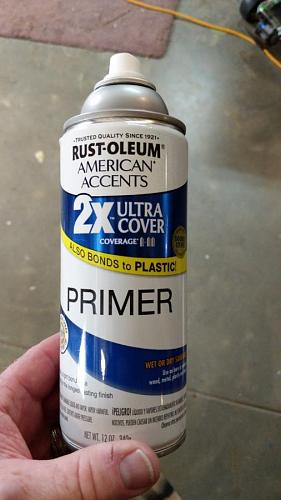

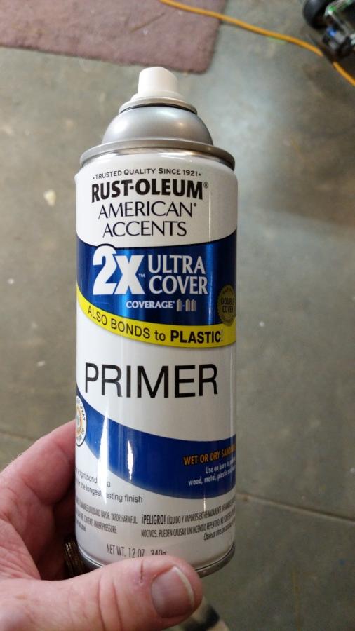

                  Originally posted by Boots Whirlygig
                  Thanks for the info, I may order that airbrush. Is the Rustoleum white primer a “filling or sandable” primer? I know the finish on my Freewing F-16 and A-4 are beautiful and wouldn’t require filling and sanding, but the finish on my FMS P-40B is not so nice, and I wondered if a primer could help smooth out the foam cells prior to a repaint?

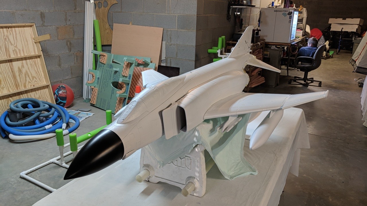

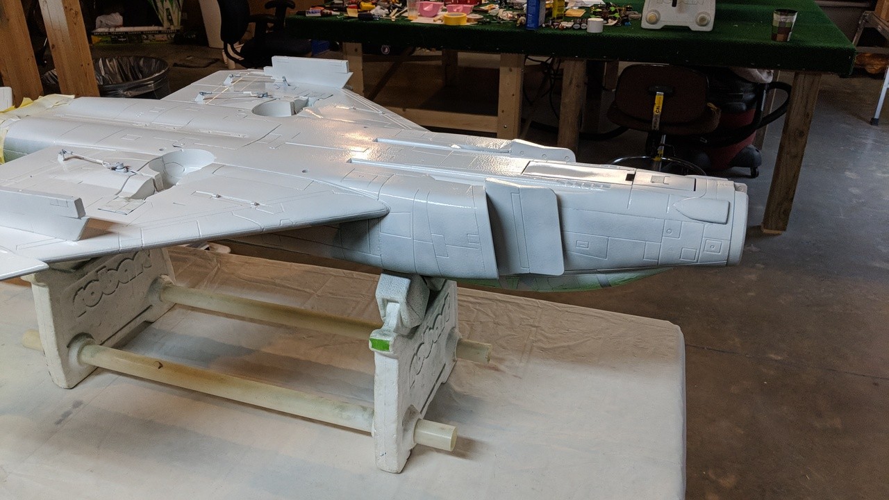

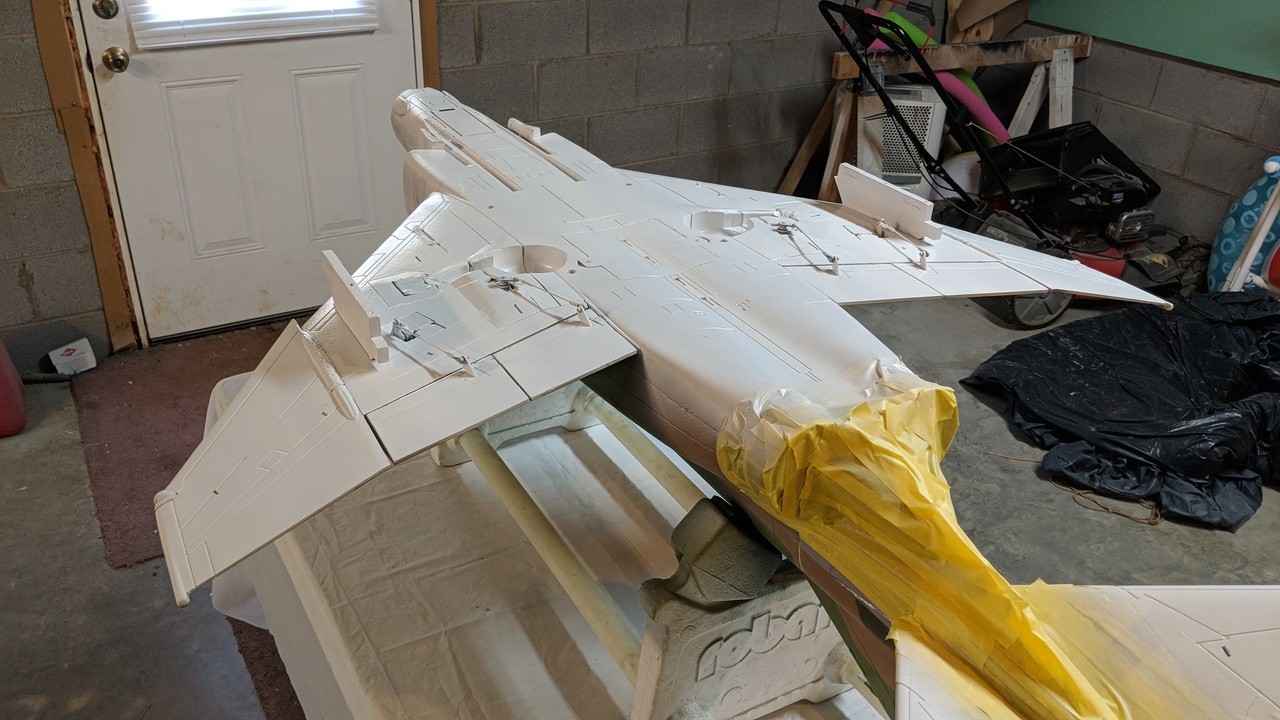

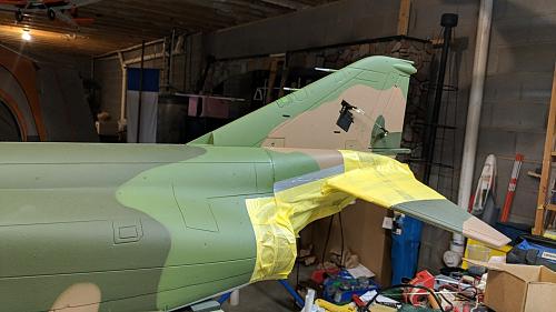

                    Primer going on...finally getting to paint this bird. After a light sanding with 220 grit and a good wipe down with denatured alcohol followed by a tac cloth this is where it's at. I should have everything primed by the end of the day.

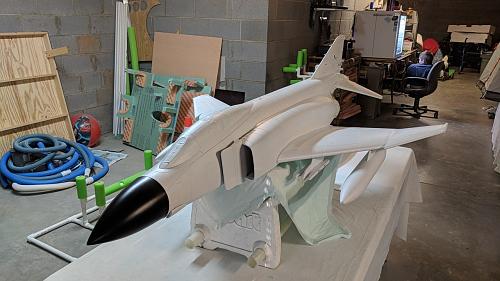

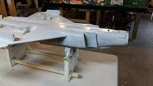

                            Primer is done. Painting tomorrow.
