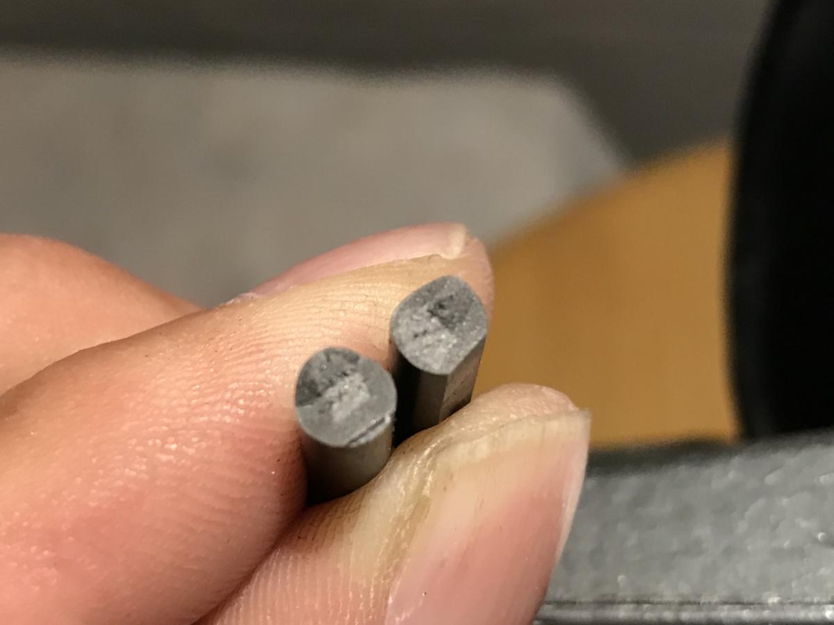

      I finally got around to my maiden lol. I used a 838gram Turnigy Heavy Duty 5000 60 all the forward to the bottom of the hatch. I did the 8mm on the elevator but ended up with 11mm. The flap mix was a wash so I came in hot and sheared the front gear pin. Pretty brittle I’d say... metal looked contaminated to me. Nice flyer!

        Not a premium pour (cast?). :Scared::Confused::Angry: Why??? I mean..... I understand all the dynamics, but a little more bend before break would be great... :Confused: Congrats on the maiden!!!
          #2424
          Yeah that has way too many pits in it to handle a hot landing, probably would have given up on an easy landing as well after. That really looks rough

            Reminds me of the A-10 pin

                  That is because it IS the A-10 pin.... LOL
