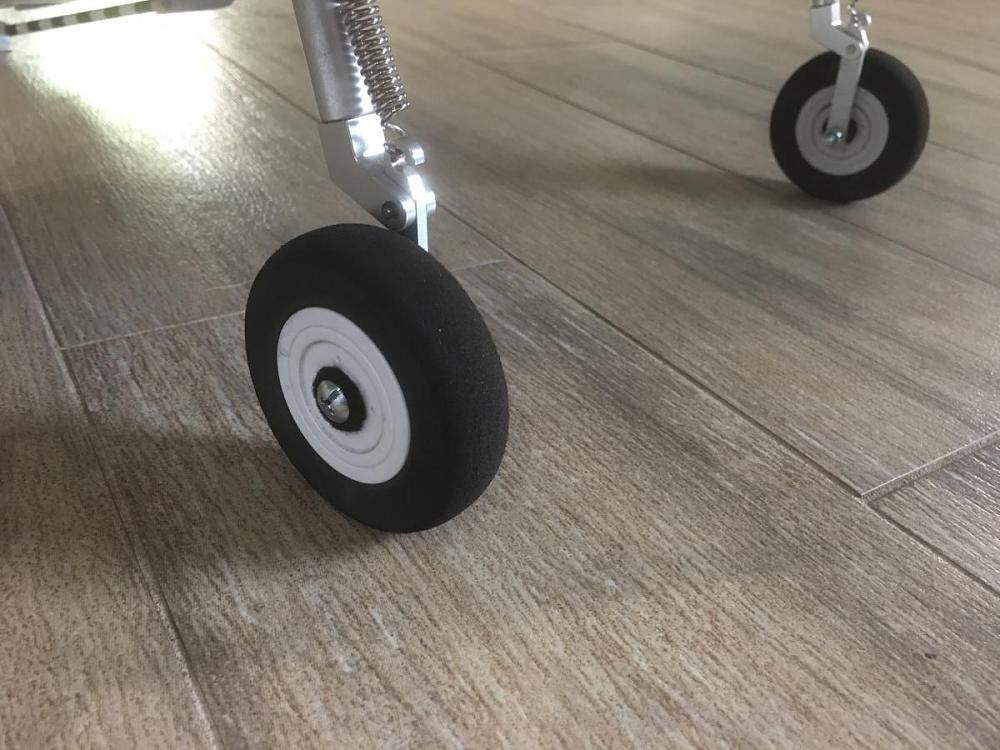

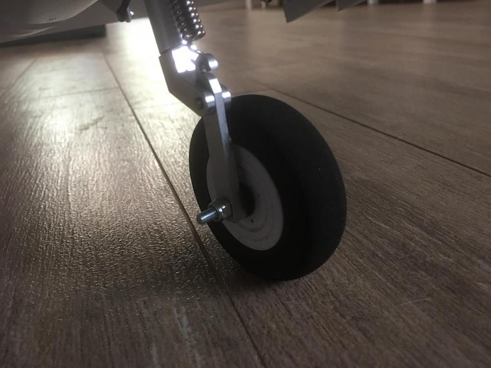

    I just cut a 9” x 12” sheet of felt slightly larger than the washers. I used machine screws for the axles. I placed the washers and felt on the inboard and outboard side of each main wheel and tightened the nylon insert lock nuts. It increases the takeoff distance only slightly. If braking action isn’t needed simply loosen the nut about a half turn. Today I adjusted them so my jet won’t move until my throttle is beyond 20%. I was able to land my Skyhawk in 100 ft. I’ll post some Phantom videos soon. Try it out and tell your friends. It works great!

      How hard is it to balance the drag on both sides?
        #2363
        I like the simplicity of it. Nicely done! I may give that a go. I always tend to run out of room at the school parking lot I fly her at. (I have to turn her hard right before she goes off the pavement into a berm),

          ...used machine screws for the axles, placed the washers and felt on the inboard and outboard side of each main wheel and tightened the nylon insert lock nuts.
          RuthR720, Thanks for the tip. I am pretty sure that is what my C/C used on our "4" in the late '80's. Very quiet though deadly w/o the 12K foot runway.LOL I'll give it another try in 1/12th scale. :Cool:Best, Elbee
