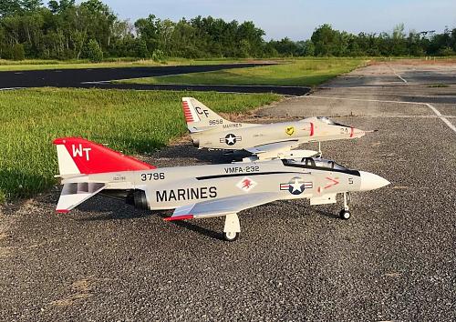

          This jet flies so great! Cannot get enough of it. From early this morning Click image for larger version
            #2285
            Very nice, I like the simple clean paint job.
            • dahawk
              Augermeister
              • Jun 2013
              • 1006
              • Keller,Texas
              #2286
              Great to see some sister company livery ! Nicely done !

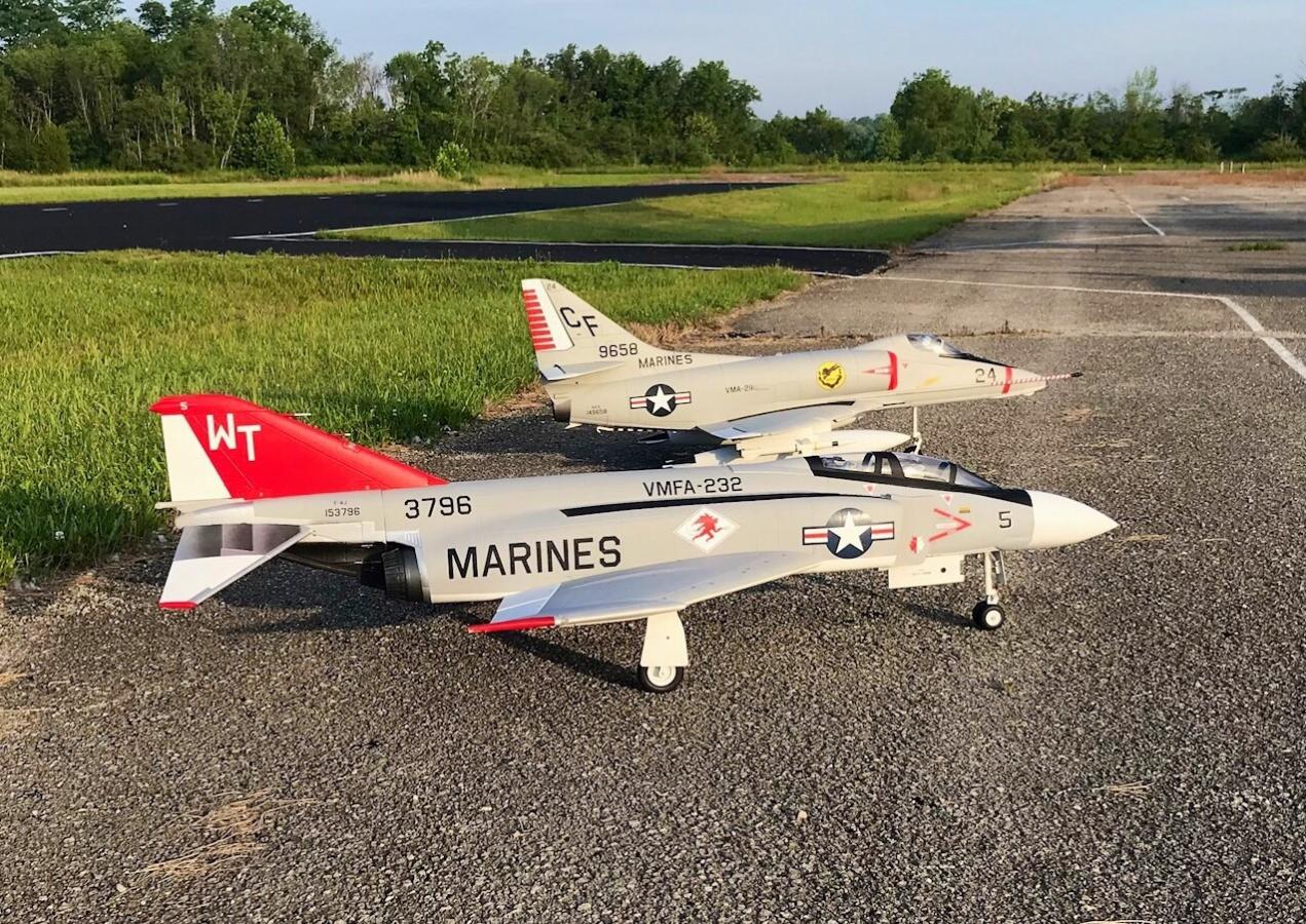

                #2287
                And a few in-flight photos of the same Phantom ... with pilot Justin posing down with the collectively bought/built/custom painted and graphiced/piloted model:
                  #2288
                  Great shooting and flying, looks great:Cool:
                  • Justin k
                    • 7
                    #2289
                    Those are some incredible pics good job Jonny thanks a bunch
                    • goosekiller1
                      The Hun in the Sun.
                      • 134
                      • Santa Rosa CA.
                      #2290
                      Outstanding pics Johnny, THANKS a million. Looking good Justin. :Hug::Cool::f4phantom
                      • TomPatton
                        XNitroJunkie
                        • 279
                        • Elida Ohio
                        #2291
