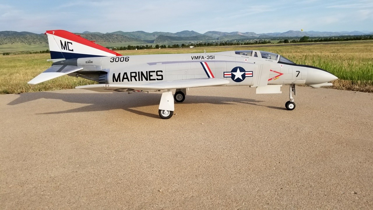

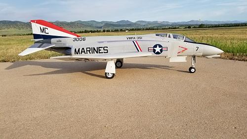

                                        In Denver, I use this setup - a bit pricey but, great performance. Modified 90mm EDF (JetFan 9B with 2250 HET motor running on a Roaringtop, 5100mah, 6S, 80C battery and Castle Creations 200A ESC) gets 3.5 minutes with 35% left. (It pulls 137A and gets 3000 watts).
                                        Beats any 8S system out there - I can out Click image for larger version
ID:	137802 perform these in Denver. Plane weighs 8 lbs and gets 7.7 lbs of thrust at 7000' PA. (At my altitude, an EDF looses 20% to 25% of its sea level thrust rating). The RT 80C battery has the least resistance and develops more power than the RT 70C battery. I tested all the high performance, pricey, overrated batteries out there and the RT, 6S, 5100mah, 80C battery beats them all as far as price/performance. I tested the 8S system with 2, 4000mah, RT 70C batteries and got 6.7 lbs of thrust in Denver - the plane weighs 9 lbs with these batteries. With EDFs, weight/power is elusive - have to keep the plane light as possible to get the best performance. I also standardized on 6S batteries (use them in the A-4, Viper, A-10, 70mm F-16, etc.) because I don't want to invest in different size, mah batteries for individual airplanes. I use an EDF test bench for power testing (amps/watts) but, the real test is a digital fish scale attached to the plane to get a thrust measurement. In Denver, it takes about 400 watts per pound to get a great performing EDF - my estimate. Again, the real test is with the fish scale. The stock 6S EDF with a RT 5500, 70C battery gets 6.3 lbs of thrust in Denver and the plane weighs 8 lbs. If you decide to upgrade an EDF make sure you use overrated ESCs so they stay cool - that's why I use the CC 200A ESC - never even gets warm at WOT.
                                        I'm open to any suggestions to get better performance for the money. You never have enough power - that's a given. Until we get Li-S batteries, we'll probably only get 3 to 4 minutes of high performance flying.
