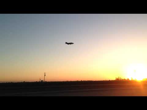

    Can't even tell it's weathered in flight. This is the second filmed flight of my F-4, my son tried my wifes phone for the first time, he lost it on my vertical roll with a loop at the top but he got the take off and landing, this is yesterday evening at sunset. I swapped out the stock 9 blade for a better all around performance and sound, this is the 12 blade fan and 4068-1680kv motor on 6s.

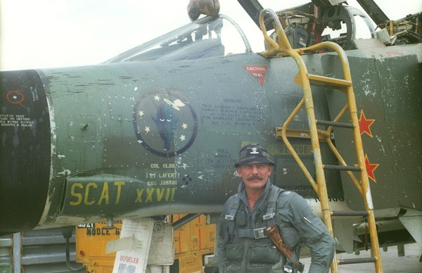

      So I am wanting to add some realism to mine. Looking at photos of the 1:1 Scat...You can clearly see weathering on various elements (below)...
      Specifically I am looking for advice for the best way to approach the missing paint. I have seen various methods like silver or white paint...Just curious if anyone has a tried and true method you feel is effective. Standing by...
      Click image for larger version  Name:	blog-110330-f-dw547-020.jpg Views:	1 Size:	67.8 KB ID:	136648

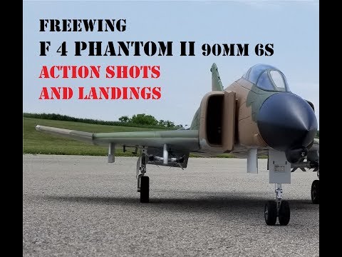

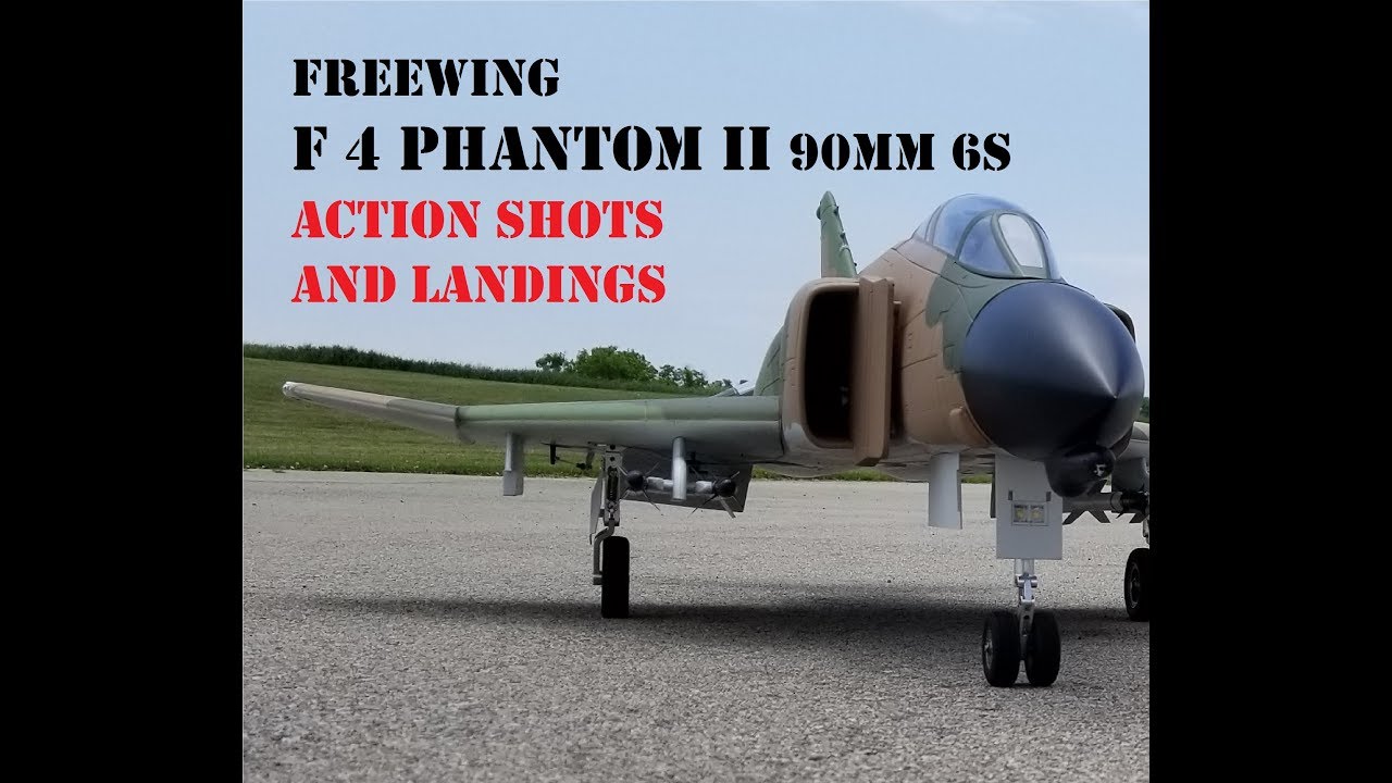

                            Here is a Collection of Action clips.

                                Great flights, dude! The first section of clips seemed quite a bit less windy. What flap setting are you using on those landings, calm vs windy ? Also, what flight times are you getting from the 5000mah packs? Thanks!

                                    There was a strong cross wind gusting to 12mph. I was using full flaps and landing with power. Last weekend I had even stronger cross winds and tried to land with pull flaps with too little power and got into trouble. Had a bounce and stalled it a foot or two above the runway and snapped my nose gear pin when i got blown into the grass. No damage otherwise. Half flaps with more throttle would have been the more intelligent option. BTW is use an Eagle A3-L gyro. With normal winds of 8 MPH or less I use full flaps.
