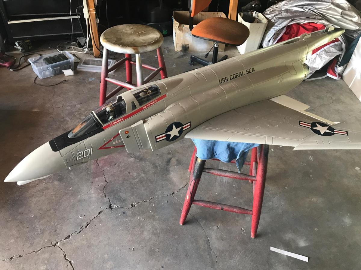

                                    #1817
                                    Click image for larger version  Name:	 Views:	1 Size:	159.4 KB ID:	135030 Just a quick update my F4 Phantom ll has gone under the airbrush By Master airbrusher Rob who lives here in Sonoma County can't wait till she's done she will be weatherize to. VFC-111
                                    • dahawk
                                      Augermeister
                                      • Jun 2013
                                      • 1006
                                      • Keller,Texas
                                      #1818
                                      Awesome and Bravo Zulu ! I also plan to do VFC-111 ( Fixed -Wing, Fighter, Composite). Working on RCjetDude's drag chute mod. Would like to get the 3D J39 nozzles and 3D cockpit

                                        Originally posted by goosekiller1
Name:
ID:	135030 Just a quick update my F4 Phantom ll has gone under the airbrush By Master airbrusher Rob who lives here in Sonoma County can't wait till she's done she will be weatherise to. VF-111
                                        Looks good GK! Love love LOVE! the gray liveries that are being created.
