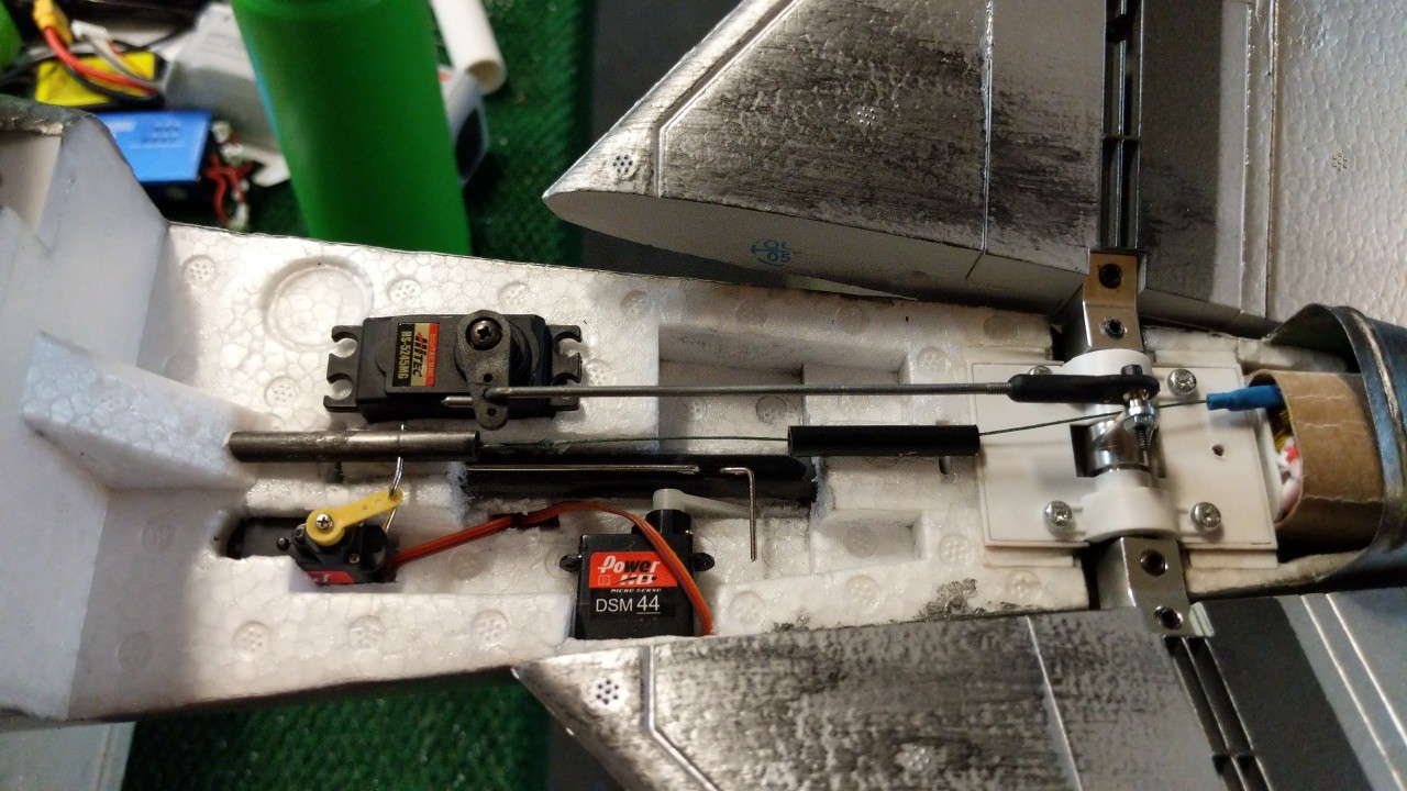

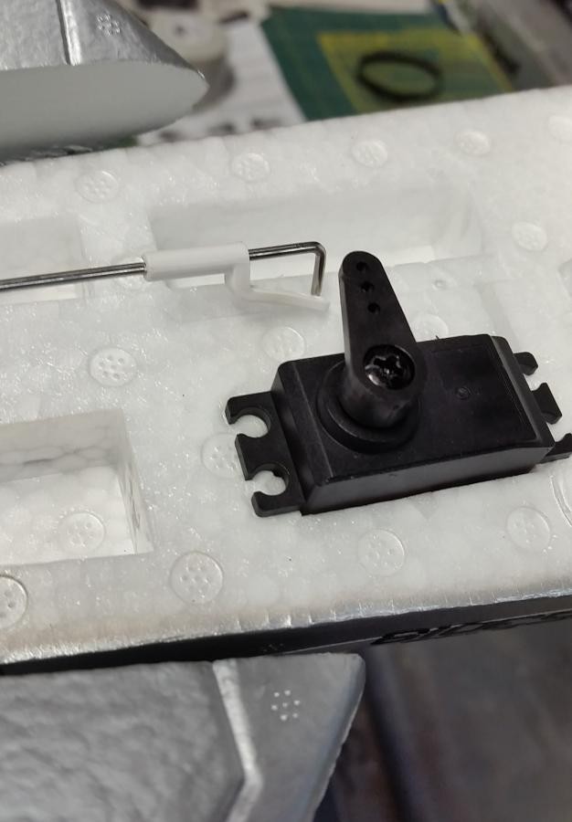

    Well I have some news that you guys may be interested in. I had a crash today, very unfortunate, although the damage is not bad and that was only plain dumb luck. I was nearing the end of my second flight, flying level at half-throttle just 30 seconds before landing, when I noticed that something wasn't right. At the time I really had no idea what was going on - basically it wasn't responding to pitch and was rising by itself. It didn't want to level when I used a little "down". Before I knew it, the plane appeared to stall and then it acted like a "falling leaf" or like it was in a flat spin... right into trees. but then it pulled out (didn't hit anything) and then did a second flop, and hit the ground pretty much upright. It went into tall brush and damaged the nosecone and cockpit but everything else is OK. If had gone in nose-down then it would have been destroyed, no doubt.
    Upon retrieval I discovered that the reason was that the stabilator was completely disconnected from the servo! This happened while I was flying, and I wasn't doing anything particularly violent or high-G, just regular jet maneuvers.
    Interesting that it continued flying like this for several hundred feet. I don't know that I could have saved it, even if I knew what was going on. Anyway, I have it on the bench now and I took the rear cover off, this is what I found. I think that this is probably a high-stress connection and I think that a better connection to the servo arm should be considered. Nothing is broken, the pushrod just popped out. I'm posting so you guys can check yours. I think a Z-bend would be a better solution.
    Click image for larger version  Name:	20180603_184819.jpg Views:	1 Size:	46.1 KB ID:	135606
    Are you sure that didnt hapen when it crashed. If this was a issue , then there would be more jets crashing . Thats a very common set up and has been used for many many years. Another thing I would do is use a piece of fuel tubing on it so it keeps it from popiing off

        I went with a z-bend before I ever maidened mine. That is a big surface and nothing against the designers but I did not want to even take a chance on it coming loose. I also went with a tighter ball link and larger diameter pushrod to eliminate as much slop as possible.

                Mine was the same way after my crash, but I couldn't tell if it came off before or after the crash. I thought I had lost pitch control before the crash, but I couldn't be 100% sure. I'm going to change mine to a Z-bend now after seeing your post. Better safe than sorry. Maybe some fuel tubing over the rod keeper might help.

                    Hey flash....same thing happened to me ystrdy on maiden flight, was trimming out and trying to turn to come back when it seemed I had the feeling of no up of down authority either, fortunately I went down on a hudge thicket of briers and landed on belly with barely any damage except for a few scratches from briers. Once back on table, I found the ball link was unattached and servo was not responding,pulled servo,put on servo tester and nothing, servo doesn’t work at all. Like you said, did the link come off in flight? With plane in excellent condition upon retrieval , I can’t see where the pretty soft landing could have caused this nor seem to have no explanation why servo is gone. This is definitely one to watch and investigate. I will definitely be using a better linkage for this servo once I get all redone, I really hope Motion will send me out another servo. I’ve already put in a ticket on this and as always their customer service is impeccable!!! Just very happy my beautiful bird wasn’t totaled due to this problem. Let’s hope we don’t start hearing more about this issue, maby post such as this will make guys more aware so we can nip this before there more unfortunate crashes.

                          What's the dominating consensus on cg and throws? (no offense to anyone, but I consider pilot experience a far better source than the manual - the latter seems to be more and more off lately)
                              Man those pics in the previous posts are fantastic, awesome work!!
                              If I hadn't experienced the problem before the crash, I would be suspicious that it happened because of the crash. But I had definitely lost elevator control during flight. It wasn't the ball link, it was the keeper. A piece of tubing as a safety would be good but I am going to install a z-bend just for that extra margin.

                                Click image for larger version  Name:	image_25095.jpg Views:	1 Size:	63.9 KB ID:	135663 Look at this picture, and think of the G force being applied to that plastic part on every high speed turn.
                                At least turn the metal 180 degree bend upside down and let the G force be on the metal. Or, you can just go with a Z bend and be done with it.

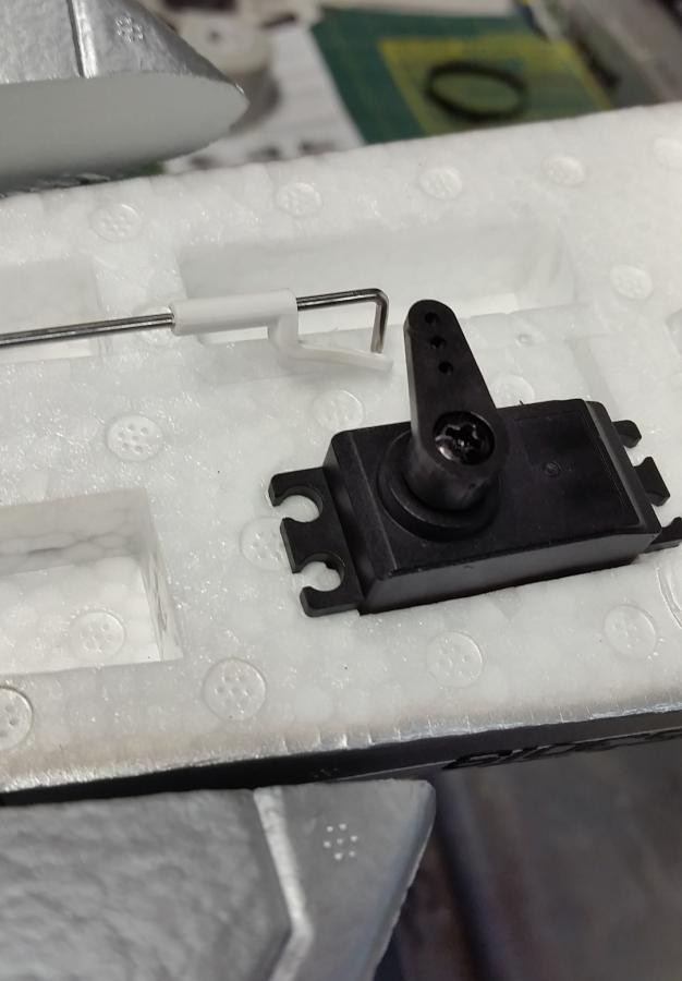

                                  I flipped mine around so the bent rod is down when the jet is upright, I don't fly it to much inverted and I also put some fuel tubing on the keeper part and where it clips on the rod, so far no issues but it does have mean thinking I will need to change it soon maybe.
                                    #1917
                                    I will bring this to Alpha's attention. Definitely something to examine that is for sure. I am going to check mine later today as well. Thank you for bringing it to our attention!
                                      Thanks for bringing this out there. Definitely needs attention. A Z-bend would clearly be safer, but typically comes at the cost of slightly more slop, since threading the rod will extend the hole by a tiny amount.
                                      Other options might be to use a small bushing with a grub screw for locking the rod in place, or better yet, replace the entire thing with a ball link.

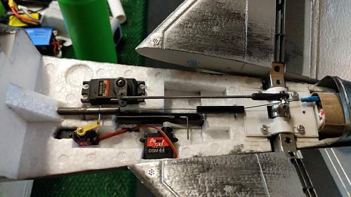

                                        DuBro ball links on both ends. 2/56 rod, and new Hitec mg digital servo. :Cool:
