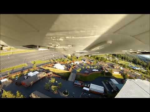

        #1723
        Maiden success! :Cool:
        I knew the instant she left her feet this was a jewel. I didn't need a lick of trim and she was as well behaved as I could have ever expected. It's astonishing to me to have a foam Phantom at this size fly so fantastically. My pattern was off because the sun was in a terrible location relative to where I fly. I was hoping the sun would have been lower behind the trees and hills at that time of day but it was blasting me in the face. So my buddy recommended for me to stand right in front of a sign that was adjacent to the parking lot which if I stood in this precise spot, it would block out the sun but I had to stay put and not move. At all.
        It made the pattern a little wonky for me but it ultimately worked out. I used Roaring Tops 6S 5500 70C LiPos. Great battery and I felt she had plenty of power for 6S and the 9 blade sounds admittedly better than I thought it would in person. Very well balanced fan. I didn't use flaps on the maiden but landing was a breeze. She eats up real estate on the rollout...Would love some brakes on pavement but nothing too bad. The second flight I landed closer to my location with full flaps for a perfect greaser. I did add a few more percentages of up elevator in the flap mix. The nose was still dipping a bit with the manual recommendations...So like 8% up from manual to 12% which was perfect.
        Safe to say I will be flying the snot out of this girl this holiday weekend! Whoo hoo! I've officially joined the club! :)
        Killer Video that's off the hook!

                #1727
                Congrats on your maiden Aros ! Some nice flying and some great cinematography. . I saw a lot of light poles looking at your Phantom as she whizzed by, drooling, whispering: "Come to Papa" LOL

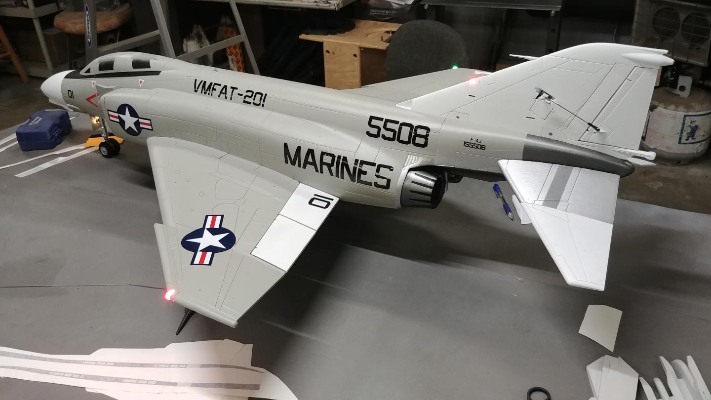

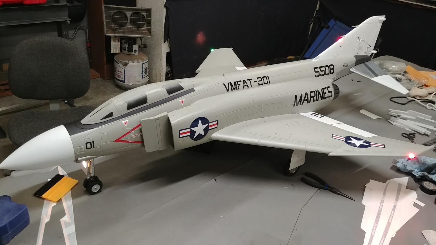

                  Making some headway on my F4.

                      #1730
                      That looks sweet! Nice job!
                        #1731
                        Thanks! Oh yes those are some awfully hungry light poles I can promise you that. LOL
