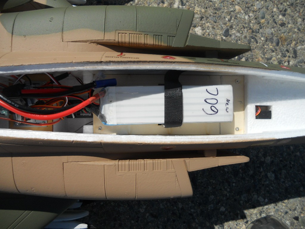

              Got the JF90 installed today, and it fits like a glove! Had to do a little trimming on the hatch cover to accommodate the inlet lip and and mounting tabs, and I had to create a new ply brace for the ESC as the ZTW 150 is wider than the stock 6S ESC.
              I'm just a touch nose heavy at 185mm with the lipos back as far as they can go (plenty of room for 8S in this bird!), but I think that will be OK based on DCORSAIR's post above. CG was checked inverted with gear down, no ordnance or tanks. I did run-up and taxi tests earlier. Even with batteries at 30% charge, the JF90 really sings!
              My stats are:
              JetFan 90 with a HET 700-68-1680kv motor
              ZTW 150A Opto ESC
              Castle Creations CC20 Pro UBEC
              2x RoaringTop 4S 5800 35C lipos
              XPS 6-ch RX
              Dry weight - 6 lbs 9oz, 2977gr
              AUW - 8 lbs 15 oz, 4054gr
              Batteries - 2 lbs 6oz, 1077gr
              Ordnance/Tanks - 6.5oz, 184gr (includes two AIM-7 missiles from the F-14)
              AUW with full ordnance/tanks - 9 lbs 5.5oz, 4238gr
              Now for some weathering details and decals. I have the Col. Robin Olds SCAT XXVII decals from Callie that I will use. More pics when it's completed.
              Possible maiden tomorrow.

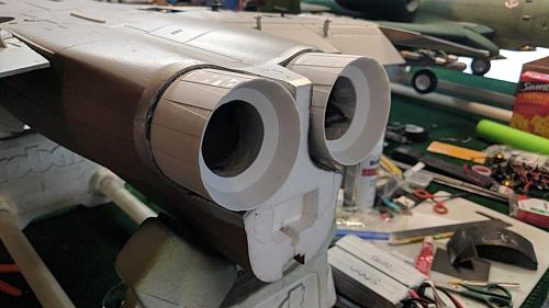

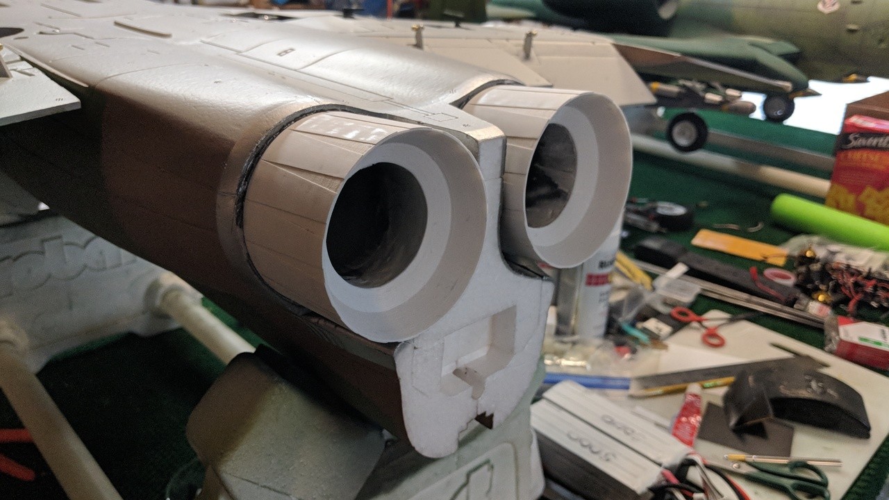

                Check out the cans on that Rhino... LOL

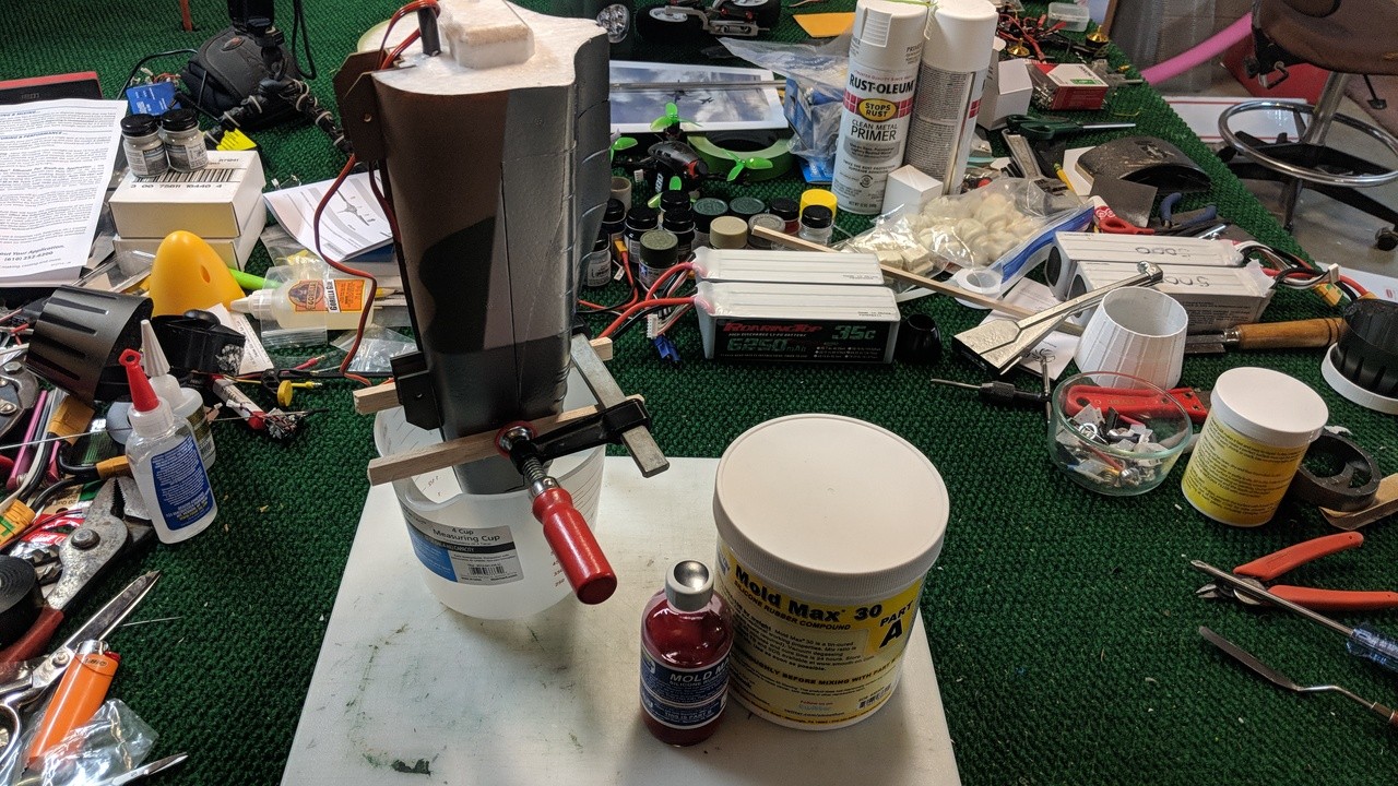

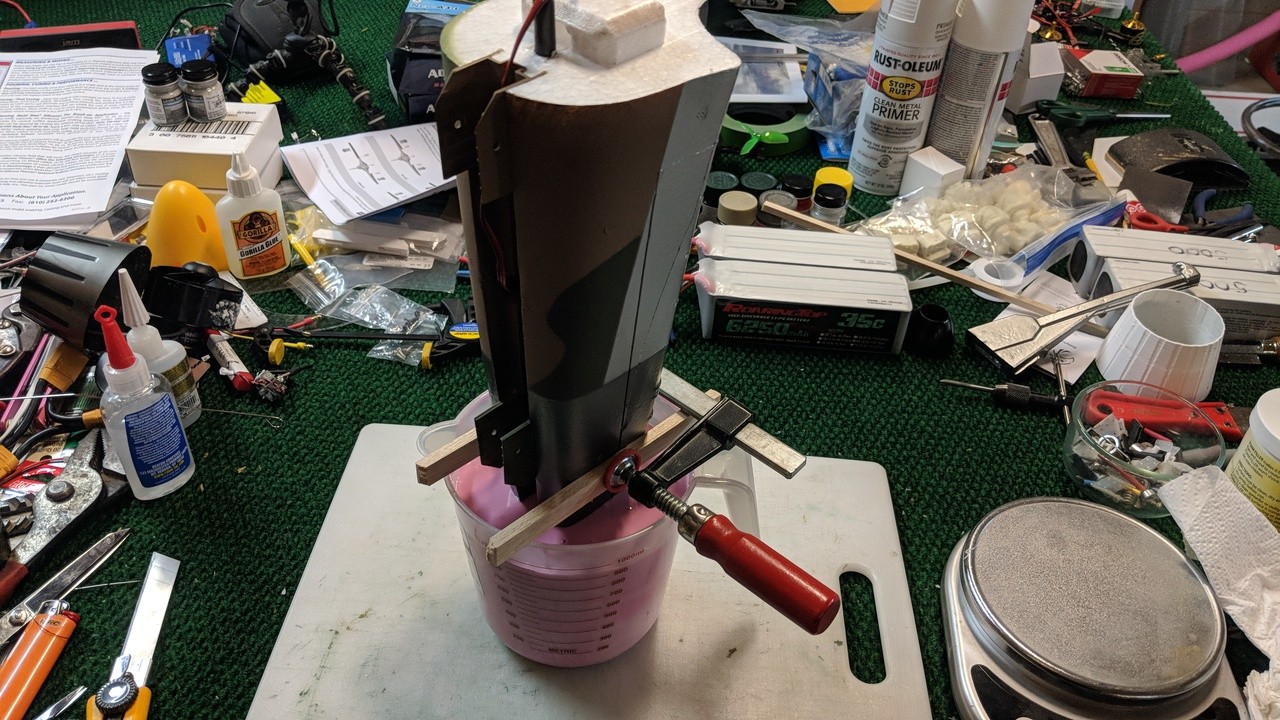

                              Now this is unusual... I may have a new 3D printer but until I am up to speed on how to design stuff to make on it I still have to do some things the old school way. Here I am making a silicone mold of the tail cone to be able to make fiberglass pieces that will hold my chute. Once cured I will remove the tail cone and split the silicone to allow laying up the fiberglass in each half.

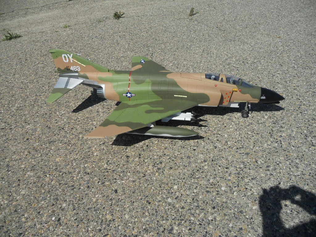

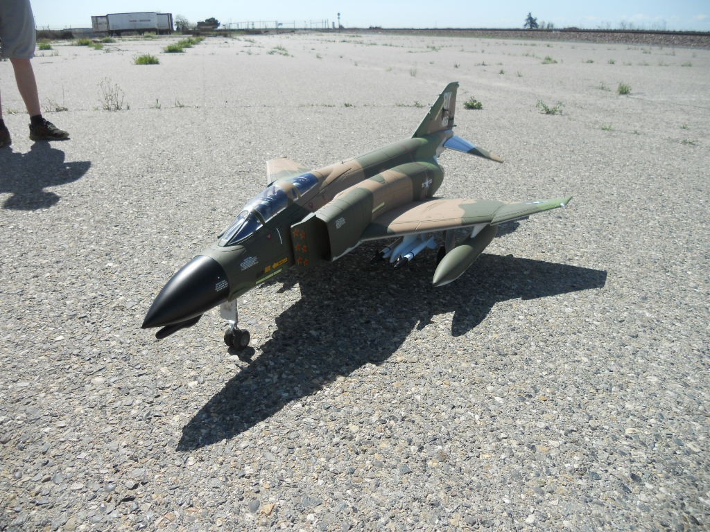

                                      Thank you Steve Betts for taking photos Yesterday. Had maiden plus six flights yesterday and it flies great.
