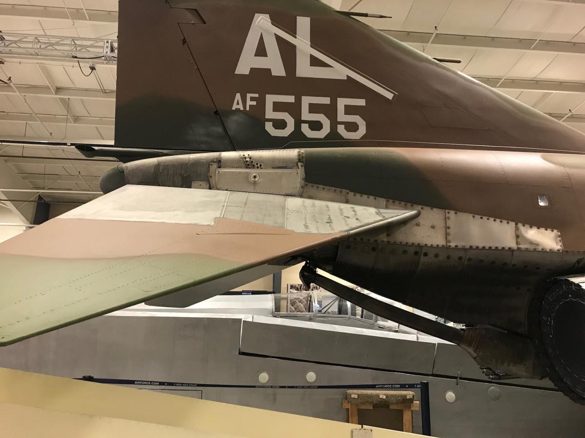

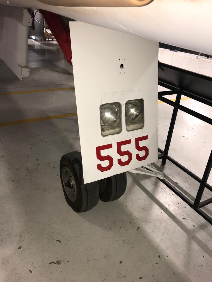

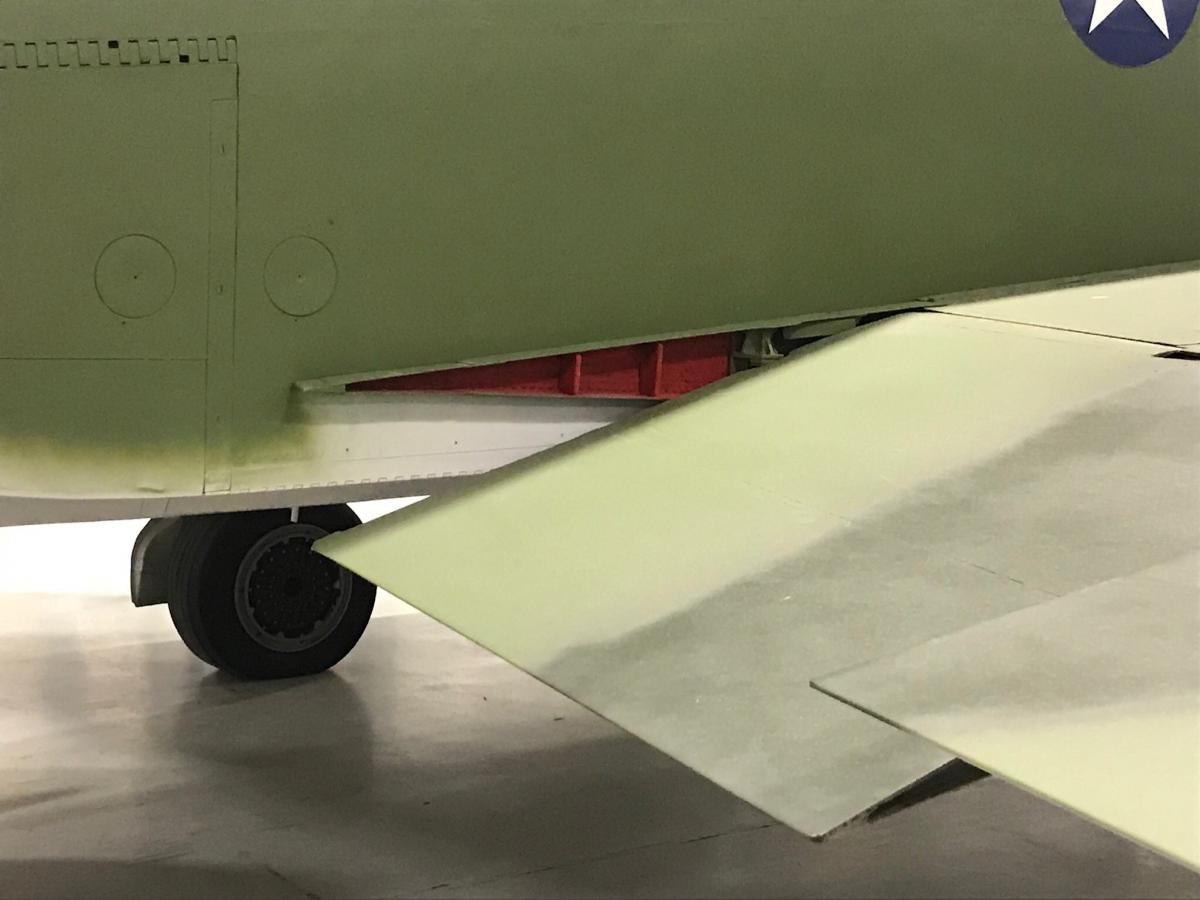

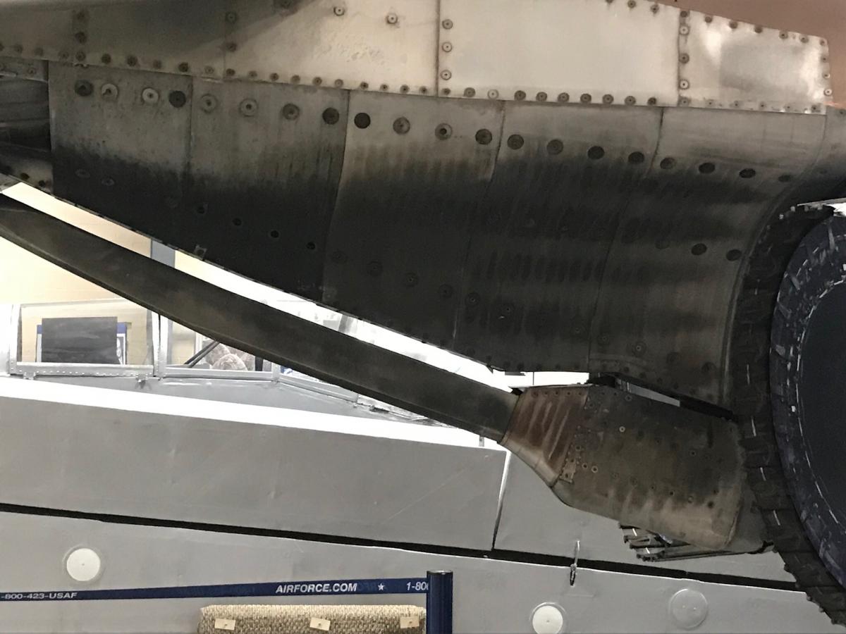

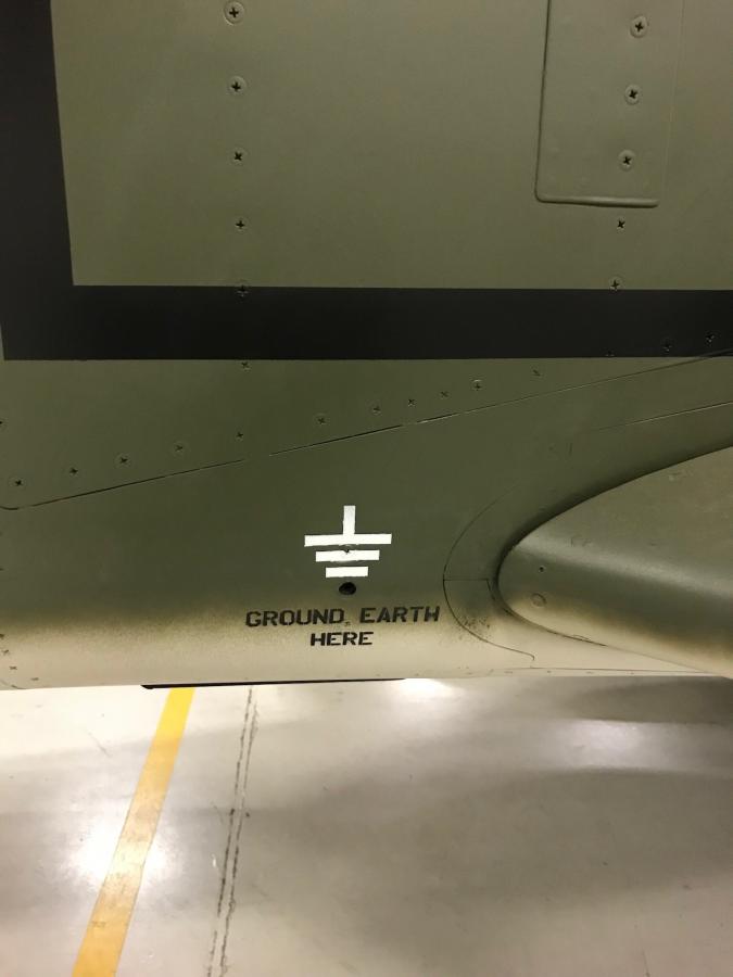

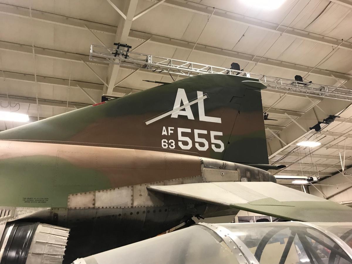

    Here's a few details for the extreme scale nuts among us. F-4 is at the Yankee Air Museum in Ypsilanti, MI.

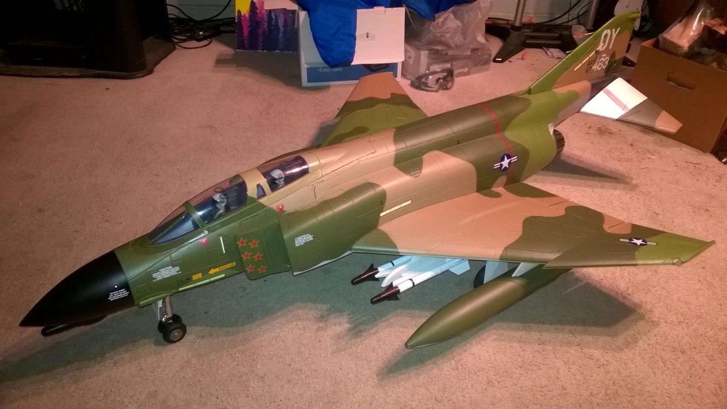

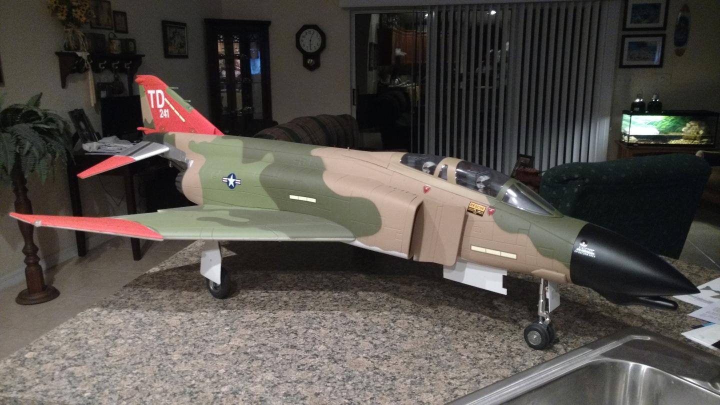

                      Build complete! Due to weather looks like a maiden Thursday morning. I did a little appearance modification from stock, but not to the level of many here.
                      Every time I build a new plane, I'm "allowed" to keep it in the house for 2 days..... LOL It allows me to walk by and enjoy it as I go about other things. Every time I walk through the room I keep saying to myself "She's BIG!"
                      Its painted to resemble the 82nd areal target group out of Tyndall AFB in Florida. A pic of the model, then a pic of the real beast that influenced the model.

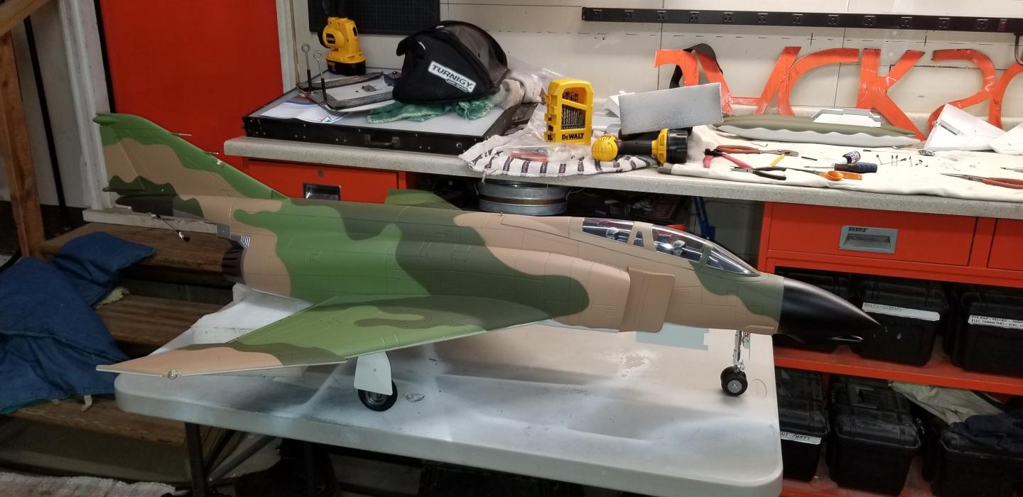

                            Well, I didn't make midnight, but I was only an hour late... :) After the meeting tomorrow, sound system and weathering.

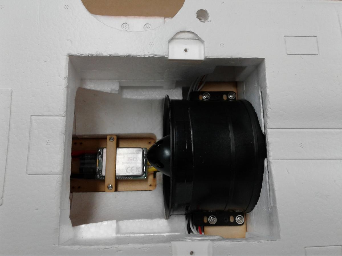

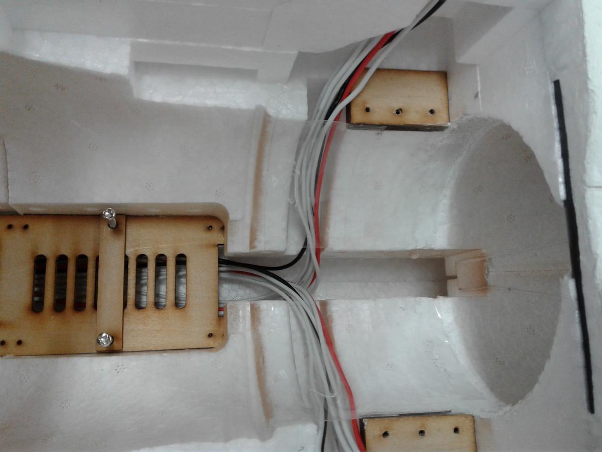

                                    Nice! I got mine too!.
                                    The FMS fan unit went in with minimal fuss. Just had to sand a 10mm ring in the back to get her slide on in. I ended up using the factory mounting holes,but only four of them. I had to drill new holes in the FMS mounting pads. I also lined the area over those wing cables as well as the area I sanded on the top of the engine bay with gorilla tape. This helps the unit slide in easier without damaging the foam.
                                    I can't believe how easy that was.
