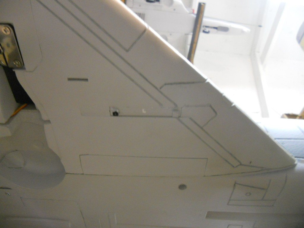

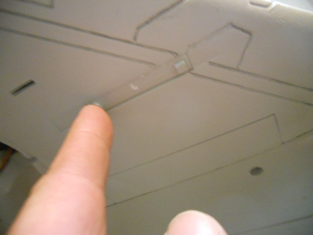

                      It's really easy to balance the F-4, leave off the missle rails and tanks, with gear down, place your fingertips on the rear missle rail tab (see the black dot in the pic) and lift up, if the tail drops first, it's tail heavy, if the nose stays down first, your close, move your finger tips just in front of those tabs, if the the nose drops a little then teeters to the tail, your good to go. You might have to add weight if you can't move your battery forward anymore, I had to add weight and I'm using a Gensace 5000 60c, now that I have 8 flights on mine, I would go with your fingertip just in front of that rear tab for your first flight, 190mm is about where that rear tab is, so 185mm to 190mm you will be fine. Now if you plan to fly with tanks then go with the 185mm, missles are mostly ahead of the CG so they don't make it change enough to worry about. Not trying to sound like a know it all but it worked for me on my maiden flight.

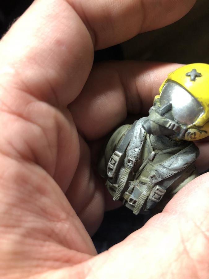

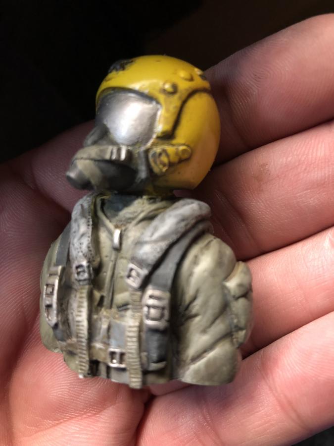

                        Click image for larger version  Name:	IMG_1173[1].JPG Views:	2 Size:	50.9 KB ID:	125608Click image for larger version  Name:	IMG_1172[1].JPG Views:	1 Size:	57.2 KB ID:	125609

                          wanted to cross post this here encase none of you chaps get to the classifieds section.

                            They are going in my VF-84 Jolly Rogers. Yay! They look great Ben! George is the one in the yellow helmet.

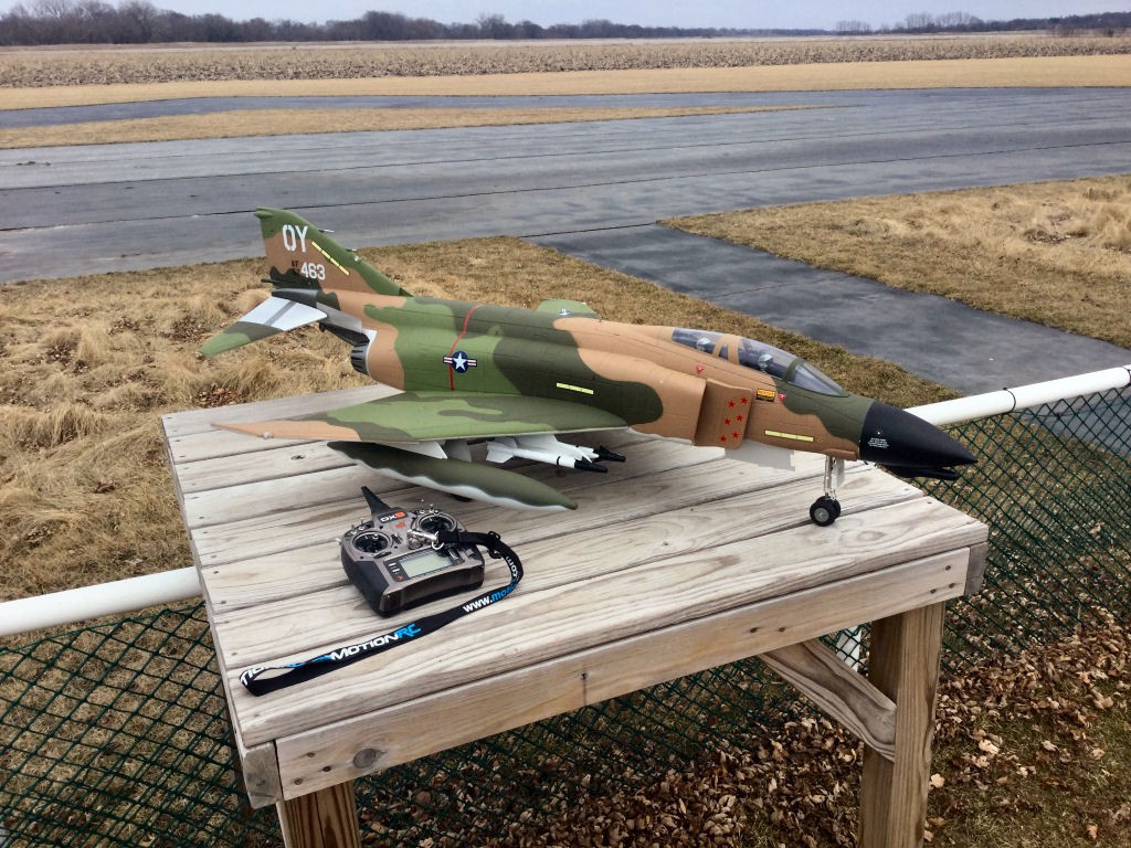

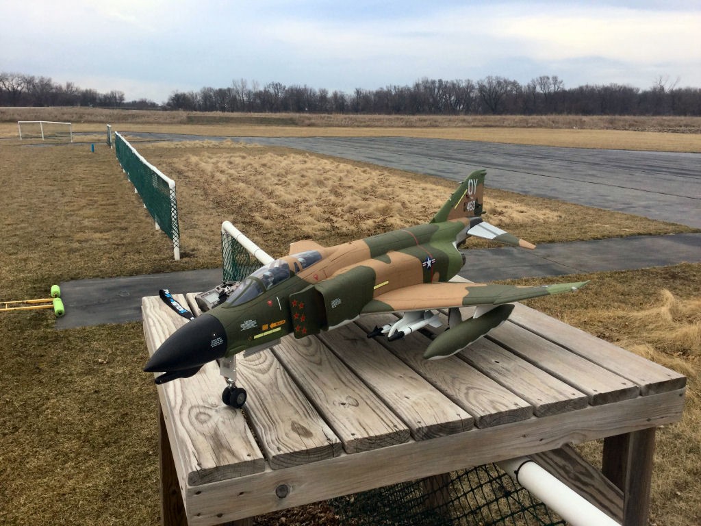

                              Tonight I made the maiden flight on my 90mm Freewing F-4 Phantom.
                              My three flights tonight were on low rates per the manual with 30% expo. This flight had recommended flap to elevator mix which I found out was not enough, flights two and three I doubled it and found it flew much better that way with the flaps deployed as little to no elevator was needed with the flaps down.
                              At the 1:30 mark you'll see something depart the right wing, it was one of the external fuel tanks although we called them bombs in the video by mistake. The plane was really squirrely with all the drag on the left side.
                              I was anxious to get it on the ground so I came around and was fast and landed down wind. Because I didn’t have enough UP elevator mixed in with the flaps you’ll see it porpoise and finally land, you’ll also notice that the other tank came off so I decided to go right back up. Perhaps I did not have them firmly attached with the magnets. I felt like I was fighting the elevator and had to give a bunch more up trip. I thought that was because the tanks were off but after landing I realized I never raised the flaps and since I didn’t have enough mix in I was getting the nose down pitch.
                              I did have a few clicks of up trim on flight one, for flights two and three I moved the battery back a few millimeters and she flew with zero elevator trim. I cannot tell you where my CG is, I went with the battery placement that was given to me by a fellow modeler. All flights were with the older style Admiral 5000 6S batteries. Flight one had the battery as far forward as it would go, flights two and three were with the same battery back 3-5 millimeters and that’s where I liked it and I was able to remove all elevator trim.
                              In summary make sure you use the flap to elevator mix (I’d double it), make sure the neutral position for the elevator is 8mm up as the manual states. I had ZERO aileron, rudder and elevator trim, she flew straight and true.
                              I cannot wait for more nice weather to really wring this plane out, she’s a keeper!
                              Thanks to Connor Johnson for taking the video for me.
