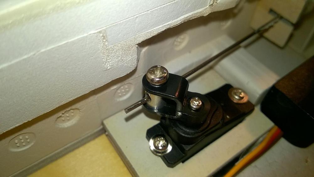

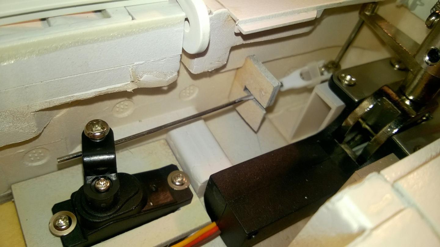

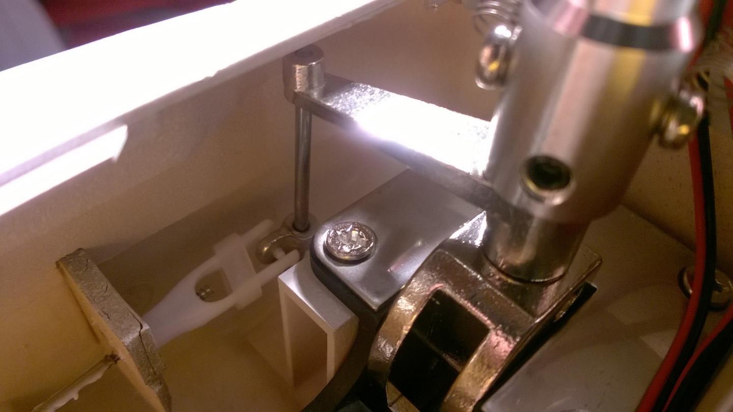

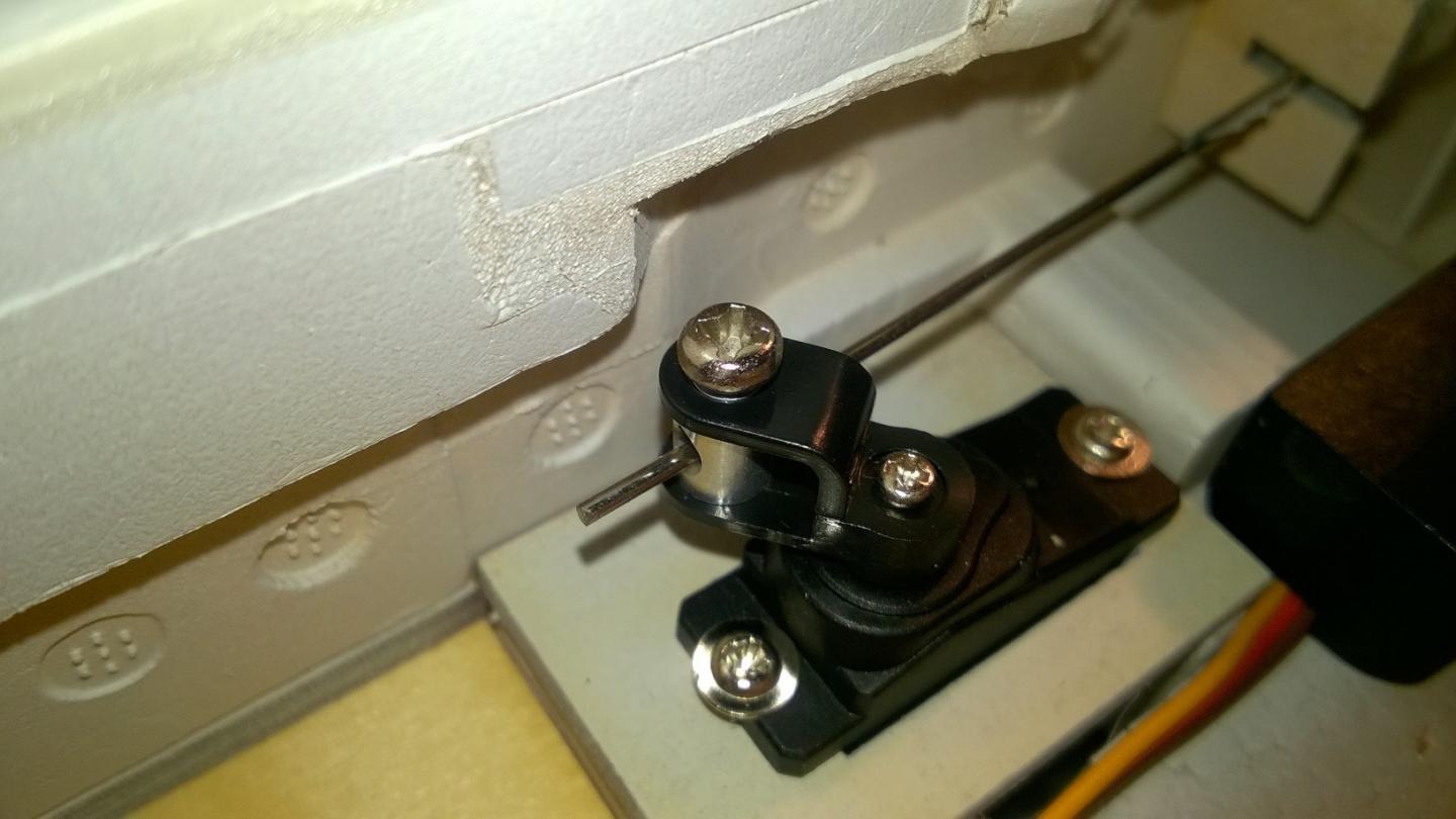

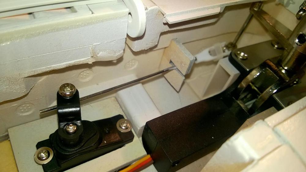

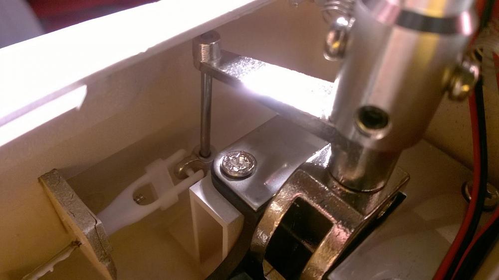

            Freewing mechanically limits the turning radius on many models to minimize the risk of tipping them over after a landing when enough speed has not yet been scrubbed. It's common to see pilots trying to turn around too soon at too high a ground speed, resulting in scraped wingtips or worse.
            To tighten the turning radius, move the clevis to the outermost hole on the steering servo. In models with a steering arm on the nose strut as well (instead of the captive sliding arm), move the clevis to the innermost hole. Experiment with your model and verify that the nose wheel doesn't bind in the retracted position. Two mixes may prove helpful:
            1) A mix that cancels nose strut steering when the landing gear is retracted (this requires the steering servo to be in a separate rx port, however).
            2) A mix that limits the steering throw as the throttle increases. i.e. on 0% throttle, the steering can move 100% of its range. At 30% throttle, the steering can move 60% of its range. Etc, etc. You'll need to experiment with your specific model (and runway surface) to find a balance between having the thrust to get moving, and having enough steering to matter.
            I usually put the steering servo on a separate channel, give it the maximum travel available without binding and jack up the expo to 40%.
            Understand all the reasoning, but it would be preferable to allow pilots to make their own decisions as to what is too much nose turn angle. Dual rates can be used here to address that reasoning, and still allow a tight turning radius when needed.
            As can be seen in the photos below, this model doesn't have clevises (or any devices) to allow throw adjustments. Drilling or wholesale replacement of the linkage are seemingly the only options; this is why I tossed the issue out for discussion.
            And yes, I have the nose steering servo on a separate channel from the rudder. This is de rigueur for tricycle gear models.

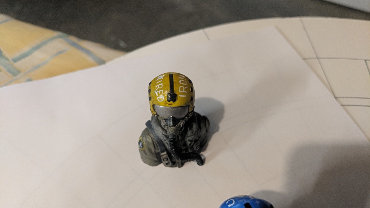

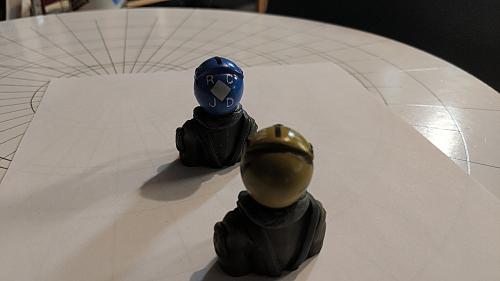

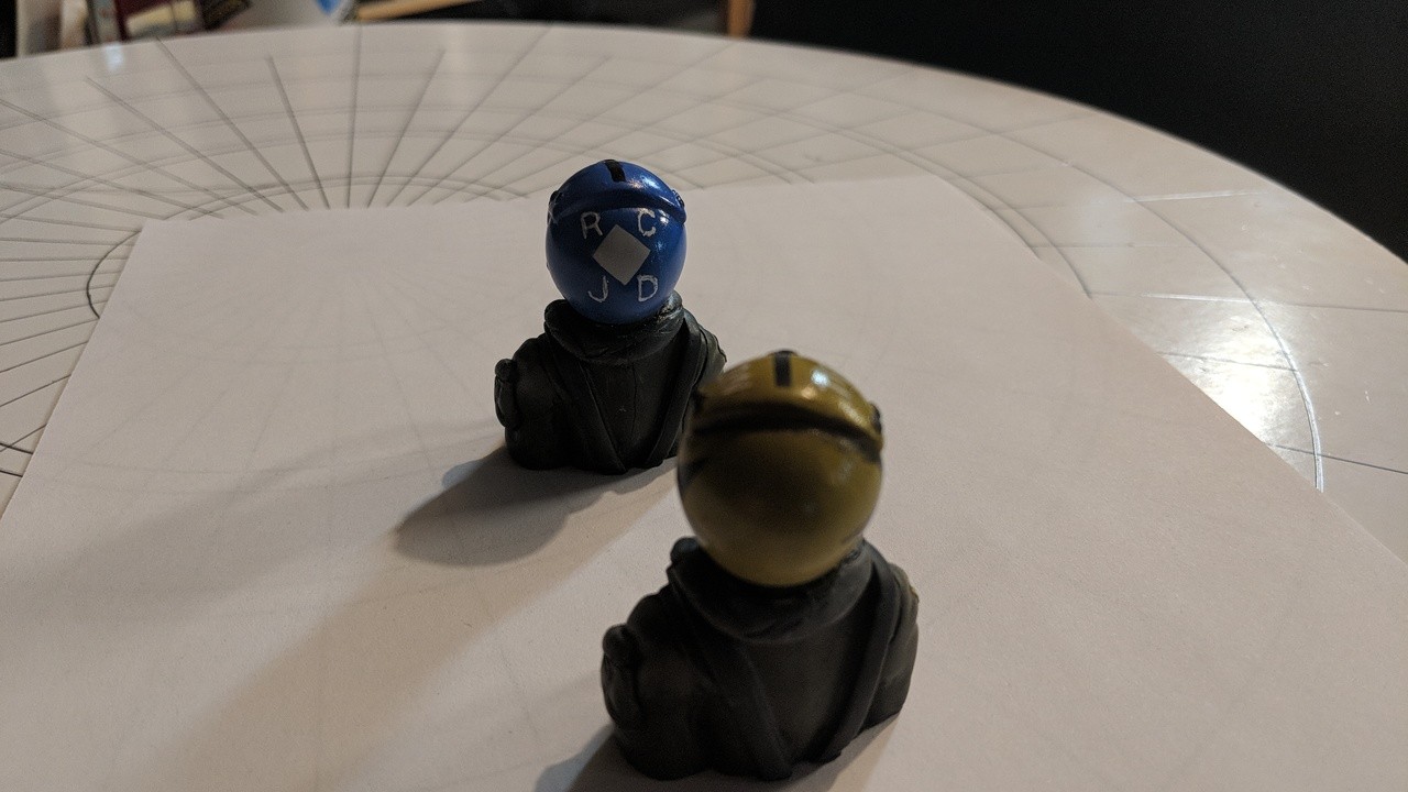

              This is what George will see from the back seat of my F-4. LOL

                      Are those 1/12th JHH pilots ?
                        #1271
                        Yes.
