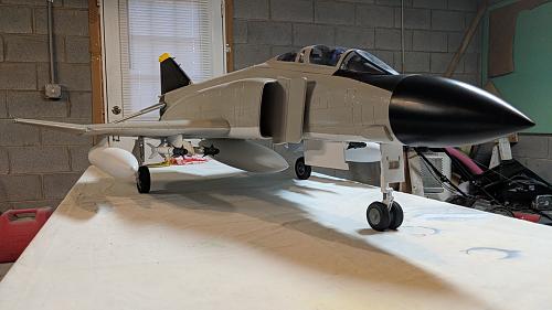

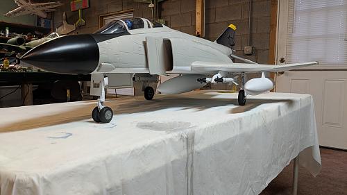

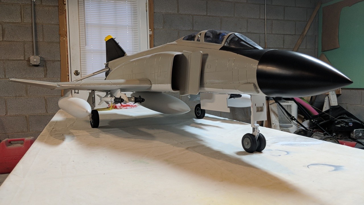

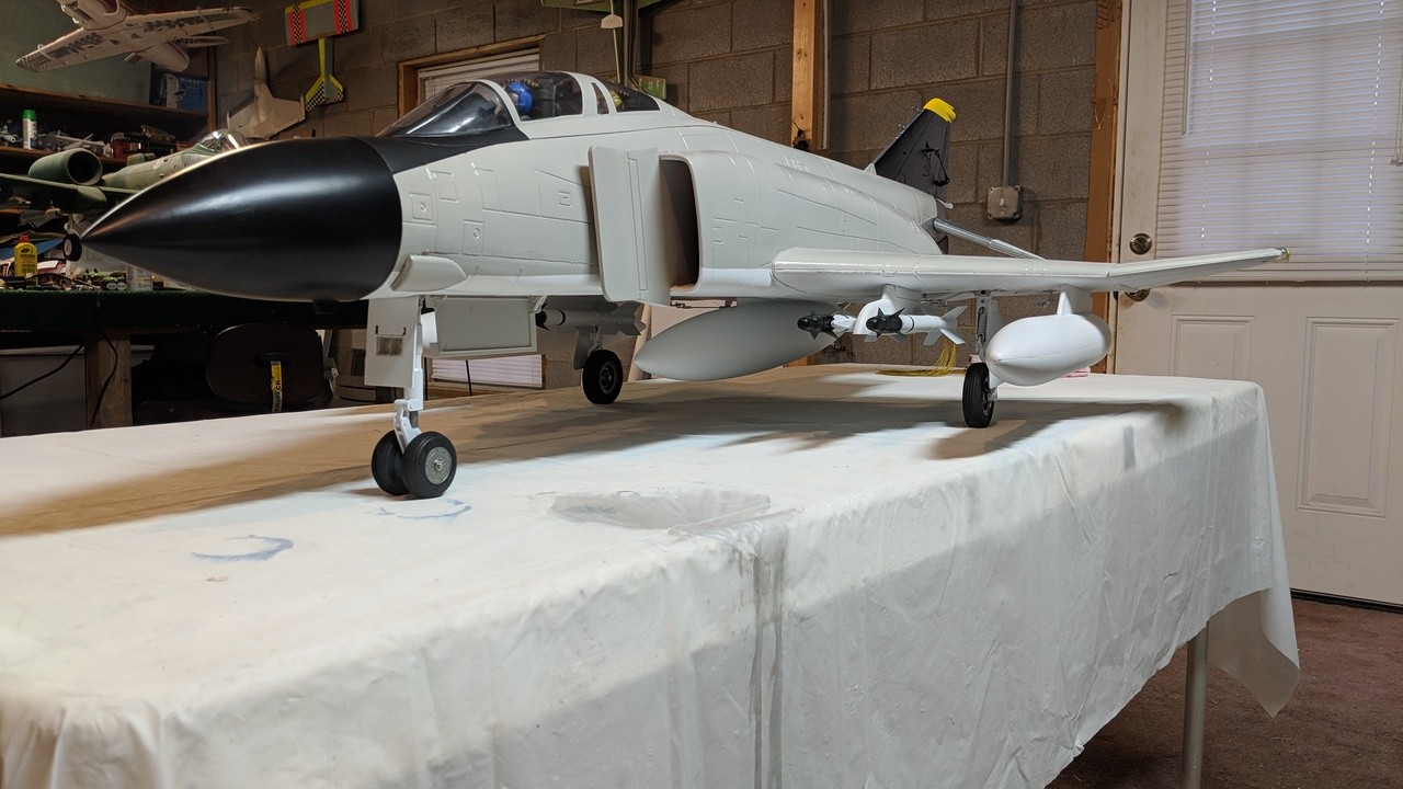

        I just have to paint the fin black and there is some minimal touch up I will have to do but the painting is almost done.

          Looks great Steve, nice coverage and a great gloss already. I'm gathering the difference in the color in the pics is because of the light and that the bottom pic is closer to what you really have??

            Beautiful so far RCJD! I’ll bet she doesn’t stay glossy like that if I know you!
              #1446
              I am going to give it a satin clear coat in the end.

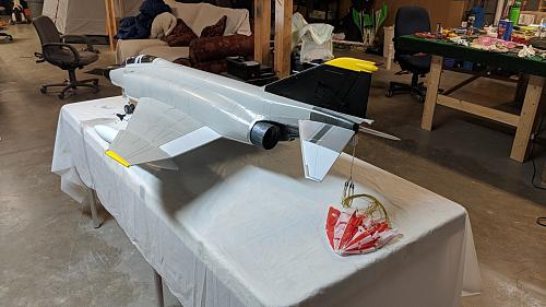

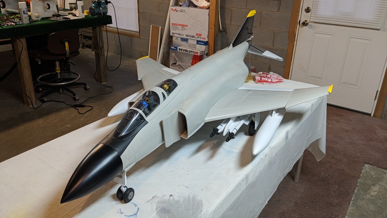

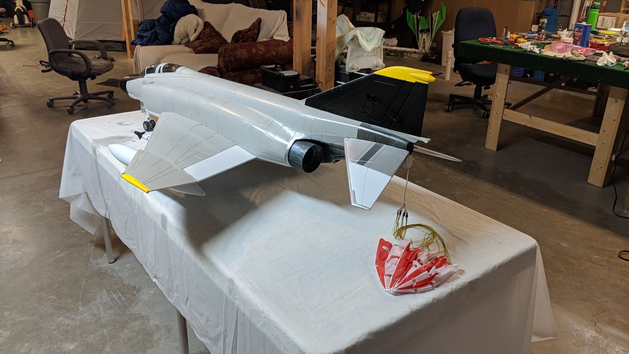

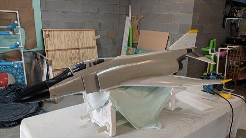

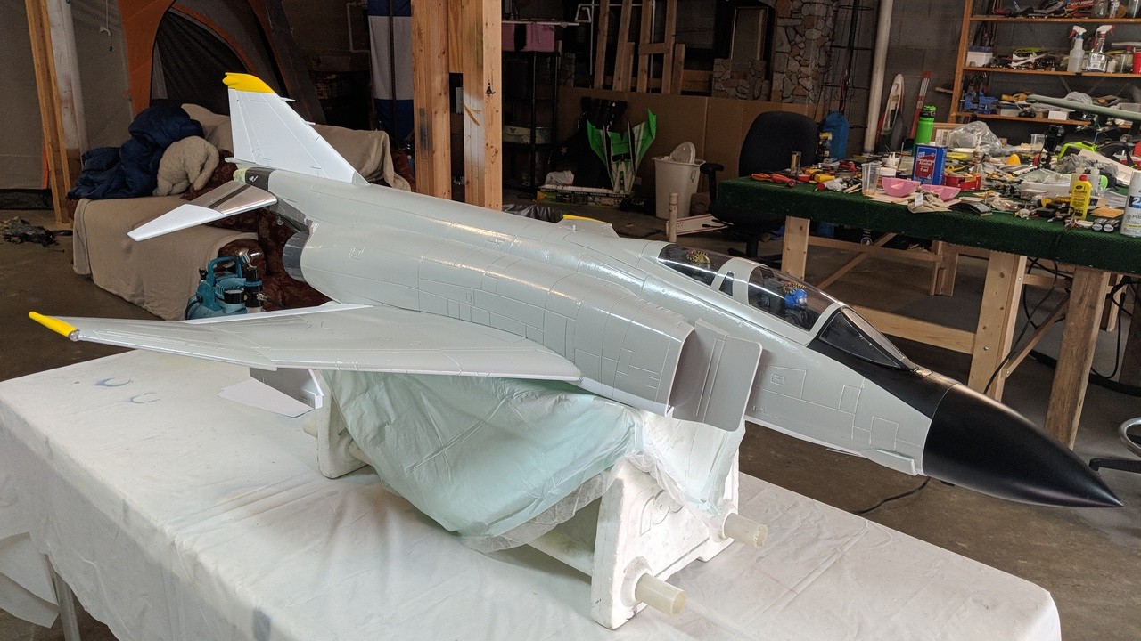

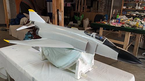

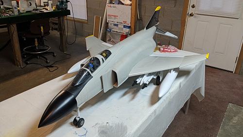

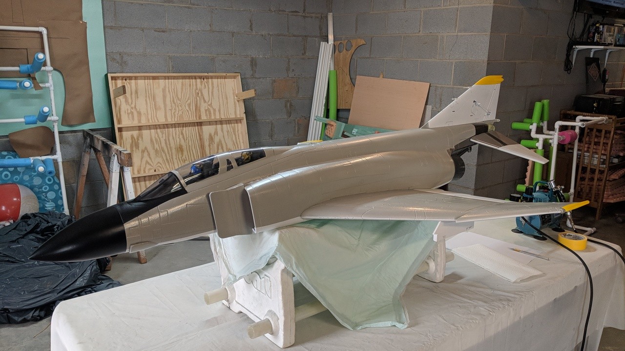

                  Ready for graphics and any other details I wish to add. I love the Model Master's acrylics. They cover well and dry quickly.

                    Looks dang good bro!

                        Lookin awesome Steve!
                          • 4869
                          #1452
                          RCJD, Sierra Hotel. Best, Elbee
                            #1453
                            Nice job!! Looks really sharp.

                              Steve, awesome! What did you use to remove the SEA camo ? I was thinking of acetone.
                              I want a J version so bad. Doubt Freewing will offer so I guess the only way will be to depaint, repaint and Callie.
                              I dont have an air brush brush so was hopeful I could find a rattlecan match.
                              Hawk
                                #1455
                                Hey Dave! I sprayed Rust-Oleum rattle can white primer right over the SEA camo and then went to town masking and spraying paint. I believe all the colors (Gull Gray, Gloss Black, Flat Black and Insignia Yellow) that I used for mine are available in enamel rattle cans from Model Masters. I don't like using acetone or having to strip paint and I use a respirator for any paints with solvents in them. That is one reason I also like the acrylics so much... no noxious fumes. Overall it has turned out good so far. The graphics are going to make it look sweet.

                                  Note: I am in complete agreement with RCJD when it comes to chemical fumes. I used a few items from around the house when I stripped the paint from my FW A-10. Acetone works well removing the OEM finish, just protect your lungs and skin, always. Best, Elbee
