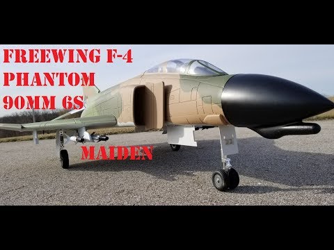

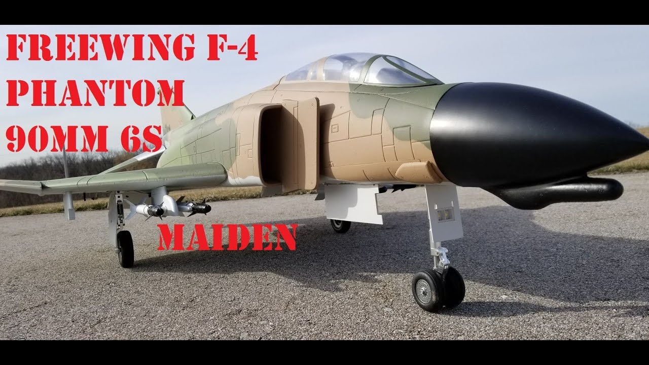

                                  Freewing F-4 Phantom II Maiden.
                                  Freewing F-4 Phantom 90mm 6S Maiden
                                  This jet was a pleasure to maiden. Not a click of trim needed.
                                  I was comfortable flying low during the maiden.
                                  I had 11 flight over the weekend.
                                  Max level speed 105mph Max speed out of dive 120mph (With Missiles, no drop tanks)
                                  I really enjoyed the light airframe. Ability to simply just drop in a 6S pack and wheels up is key for me. The speed was good for me but I did run at 90% a lot of the time. Yes, I would consider upgrading to a Hot 6S system but not right now.....hard to justify. Vertical was ...ok. ...but not near unlimited. I am happy with it overall.
                                  3 mins with average throttle management.
                                  End Voltage 3.8V
                                  Radio: Horus Frsky with X8R RX
                                  Sensors; GPS, Voltage.
                                  Battery: Turnigy Graphene 5000mah 45C
                                  CG 189mm
                                  Thanks, MotionRC!

                                        Nice maiden Itgordon00!
