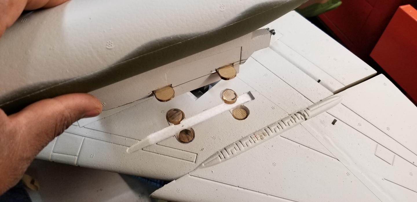

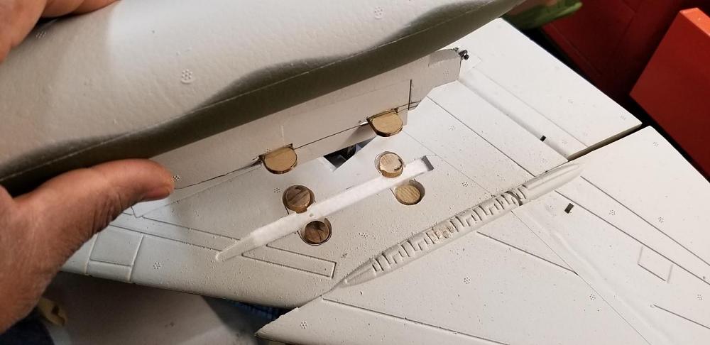

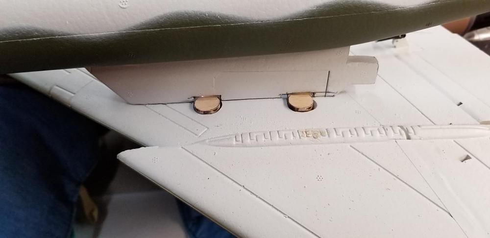

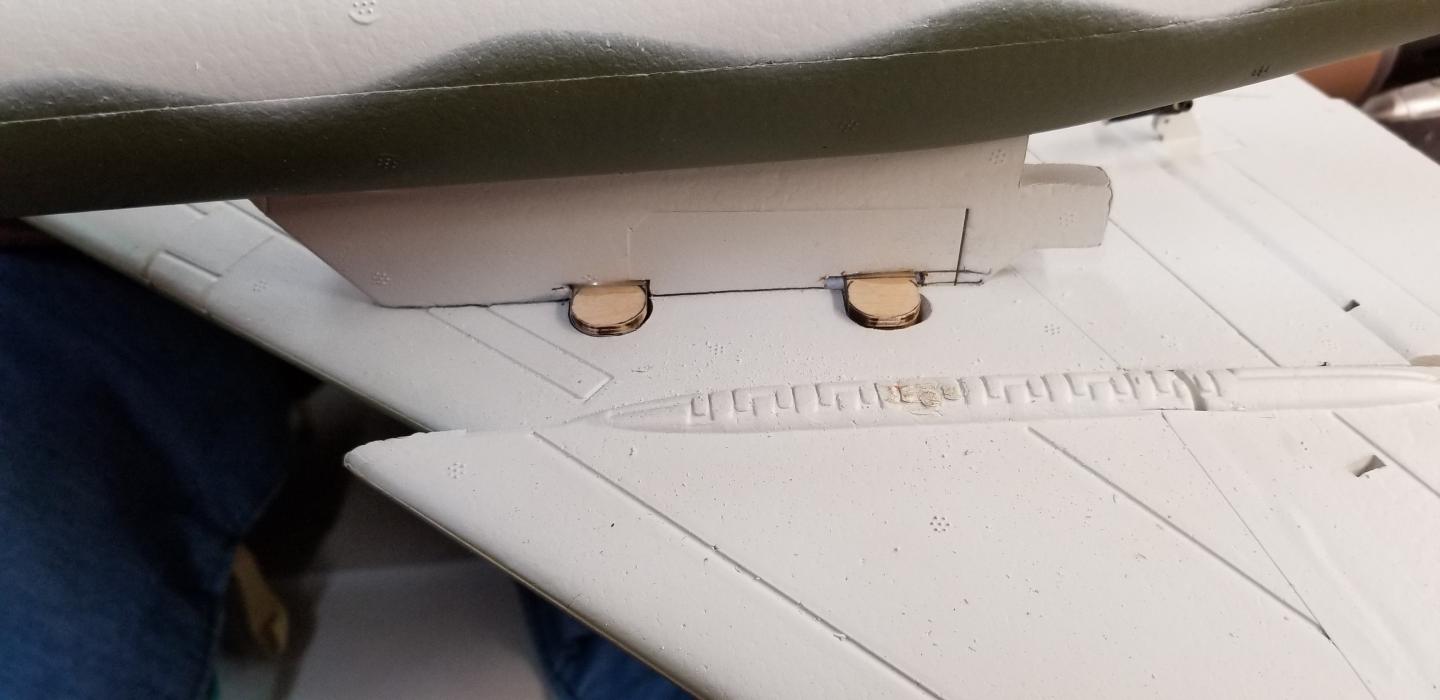

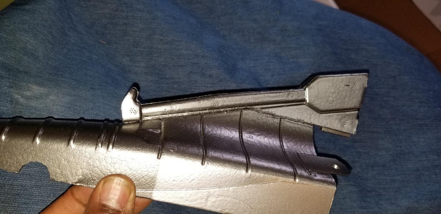

    Click image for larger version  Name:	20180403_050740.jpg Views:	1 Size:	86.1 KB ID:	126805Click image for larger version  Name:	20180403_050716.jpg Views:	1 Size:	69.6 KB ID:	126806Click image for larger version  Name:	20180331_125355.jpg Views:	1 Size:	147.5 KB ID:	126807 nothing earth shaking, just wanted to remove my tanks and pylons ,so I will put screws in this to remove both. This will be good when I want to just go clean and fast.o

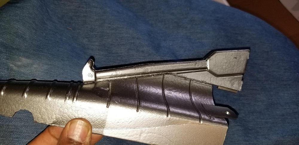

    Glue tail hook like this so the rear cover and hook can be removed for inspections later.

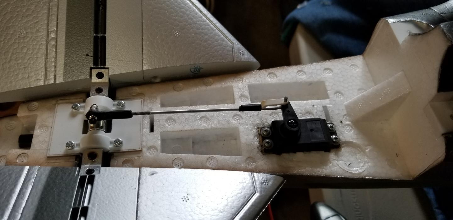

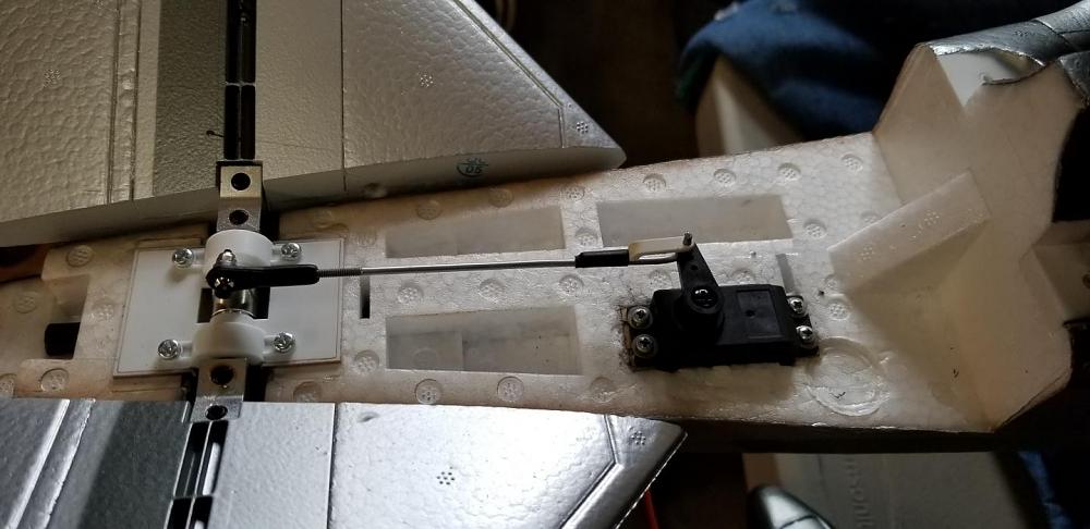

    Replaced all control rods with thicker one's for solid control and no flutter. Also the elevator removed and blocks glued in and servo can be screwed down. Click image for larger version  Name:	20180331_125238.jpg Views:	1 Size:	103.8 KB ID:	126808
