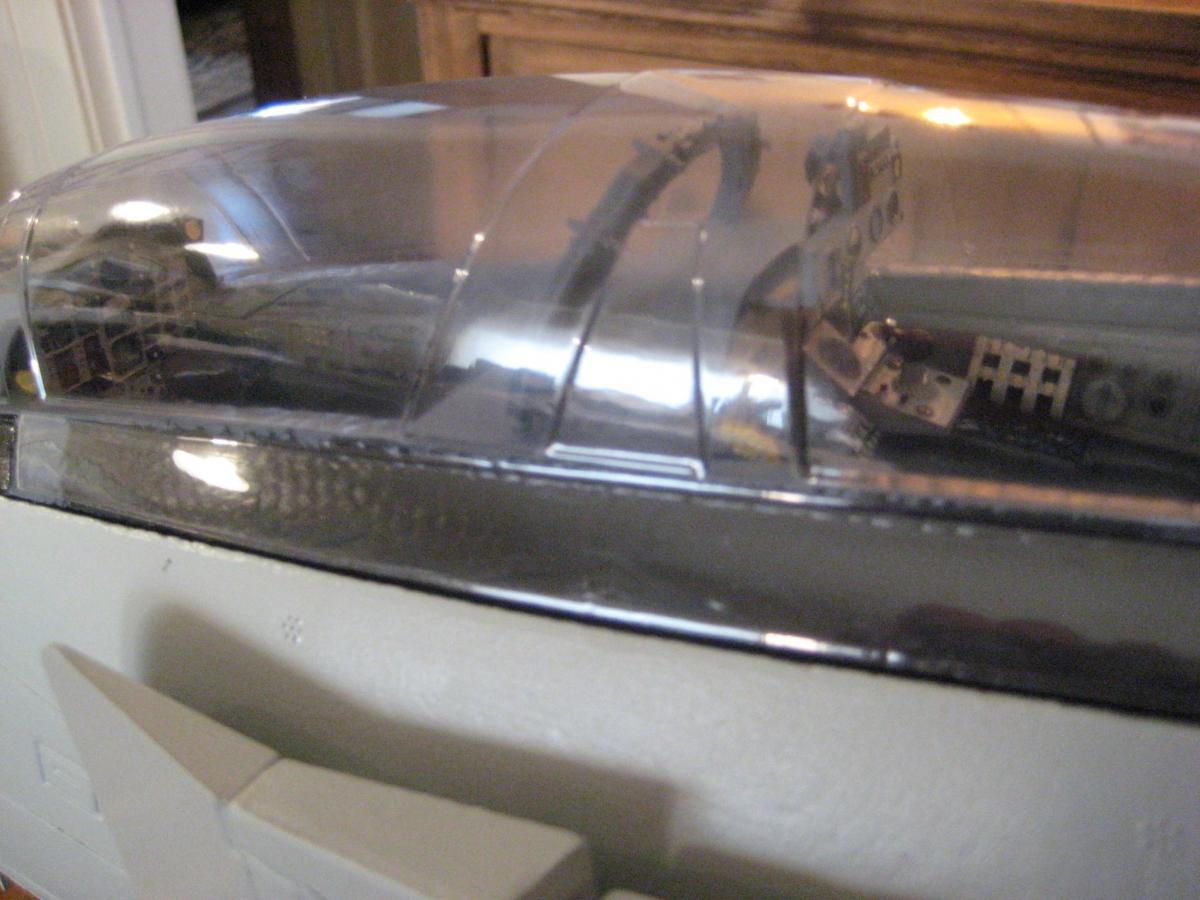

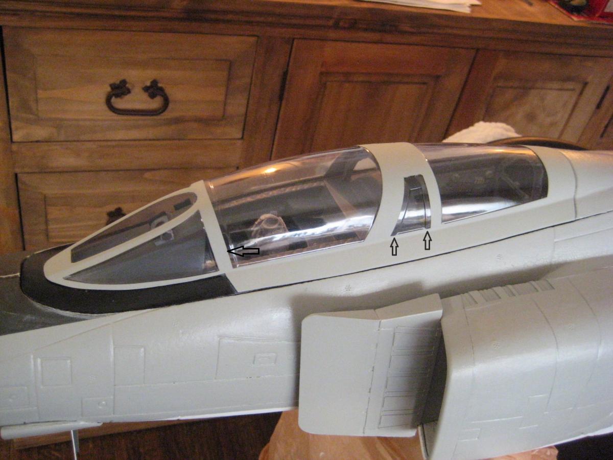

                  • Hey Y'all, Small steps. Stripped the OEM acrylic paint and repainted the canopy with Dark Sea Gray first to the match interior color, then FS36440 outside. The canopy support structure was too wide, so I narrowed the frame at the Pilot & WSO/RIO Stations with the repaint opening the glass area at the center. Looks better, I think, and the frames are closer to scale which eliminated the squished and pulled looking sections. Stripped the OEM acrylic by soaking paper towels with 91% ISP (suppose 70% would work too) then wrapping that with plastic wrap to slow the evaporation. This dissolved the OEM paint in an hour or so. Clean up with more ISP and 'boom' no paint. Best, LB
                    Click image for larger version  Name:	IMG_0087.JPG Views:	0 Size:	103.7 KB ID:	183179Click image for larger version  Name:	Canopy Repaint F-4.jpg Views:	0 Size:	115.6 KB ID:	183180
                              Nice work!
                              And ISP is = Isopropyl Alcohol ?
                              • Originally posted by Xet View Post
                                Nice work! And ISP is = Isopropyl Alcohol ?
                                XET, Yes, sir. Best, LB
