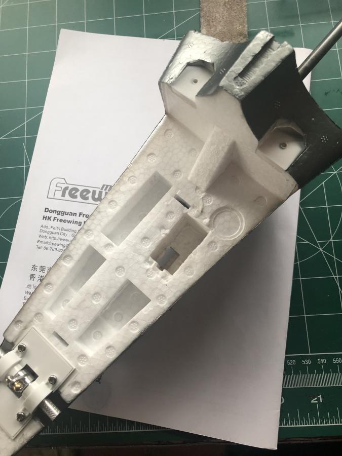

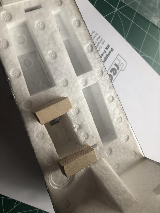

          Edit, the 500g are 5000mAh. The 574g 6000's. I am able to balance okay with 1000g packs. I did cut the foam at the rear of my battery area and moved the ply plate back to get a more rearward balance (you've seen my pictures of the cut). I'm now using 8S Hobby Star 5200 at 865g Pushed almost as far back for a even more rearward balance point.
          Cut the foam...
          I tried putting two of the new Admiral 4S 6000 Pros in my F-4E which has a JP 8S fan in it and I can't get the batteries back far enough to get it to CG without modifications. As it is I just flew it on my normal Roaring Top 6S/2S 5000 70C packs until I can decide how I want to get the 6000's to fit. I don't have any trouble seeing either the gray or camo versions personally. I flew an E-Flite Viper recently and noticed issues keeping it in trim but have not flown the new F-4. I did get to watch one get assembled which was a snap and it appears to be a nice bird.

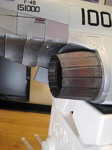

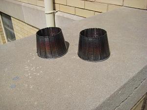

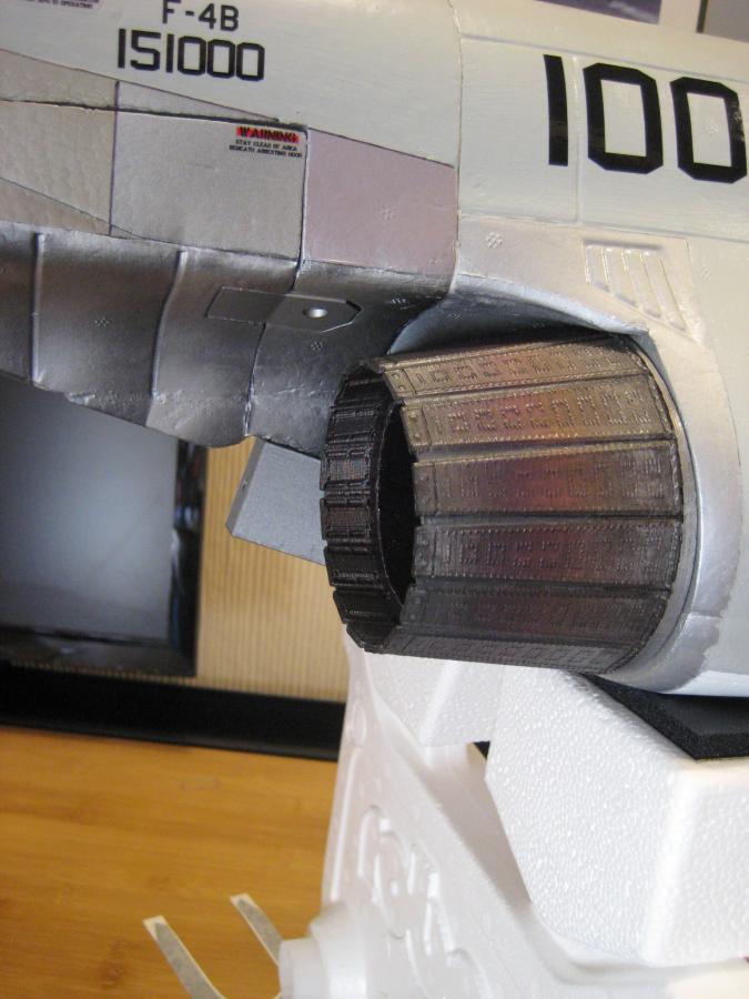

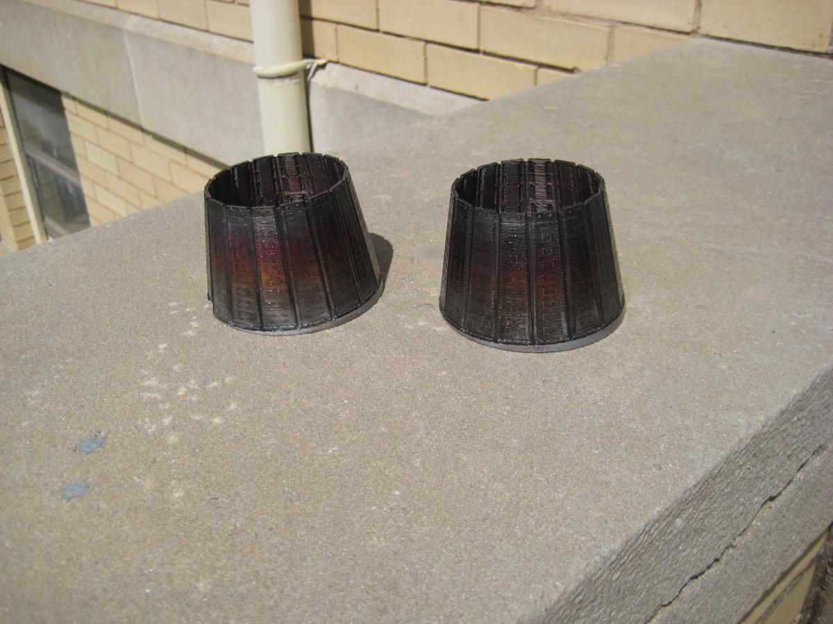

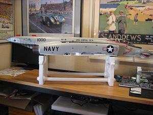

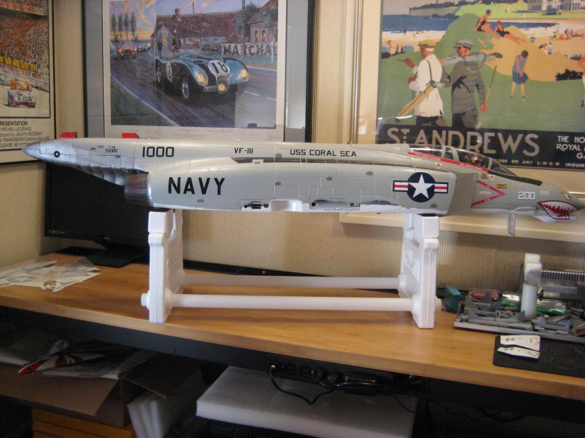

                  Got the nozzles finished and like the look. Best, LB

                    That's gonna be one salty Phantom LB. Looking great.:Cool:

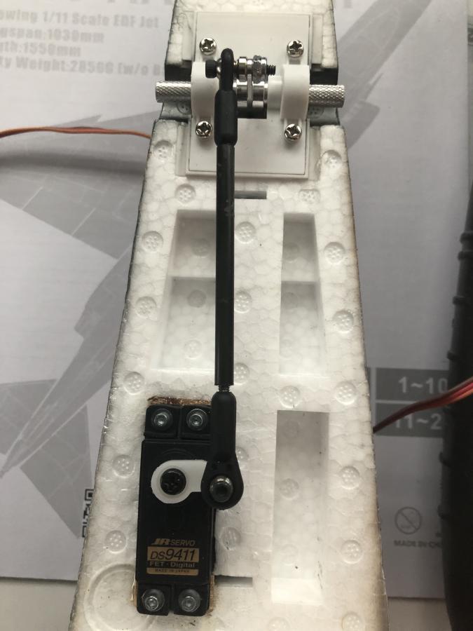

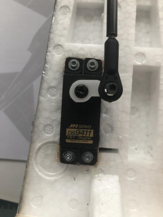

                      We have 4 F-4s (in our club of 5) and 3 have had the elevator servo die without warning. The other F4 has not been built yet. All are first batch runs. Over the years, I've had to ground 4-5 other birds while in the field with them due to what I call "good" failures. This is the only 1 I've lost due to a "bad" failure. Due to the massive damage, I could not say it was a bad servo 100% but given the history of the F4 elevator servo at our field, I would bet a dollar on pennies.
                      I'm beginning to think it may combination of things causing these servos to die in the F4:
                      - The amount of flight loads imposed on it (or any F-4). This had been mentioned before. Indeed, I can imagine some are flying with a forward cg, which does not help.
                      - The power of the servo itself. It seems a 30gm / 60oz/in servo should be adequate but maybe not when you consider the speed this thing is moving at.
                      - When relating to the above, consider how this servo is mounted. It sits in a bed of foam, which it a great heat retainer. Only the top is exposed, and it's facing upside down. Also, everything is in an enclosure, out of the windstream. My buddy in the video reported that his servo smelled burnt when he disassembled it.
                      We are both going to replace our servos with Hitecs and adding some sort of cooling to this area. Other than us getting a bad run of these servos, I don't think it's the servo design itself but I cannot help but consider the environment they operate in. We fly our F4s with maybe 5-15 cool down minutes between flights, so this may be an untested senario by the MRC/FW team. We flew them through the summer with no problems though. In 2 out 3 of our failures, we were on our 3rd-4th flight of the day.
                      Concerning servos, there are good failures and bad failures. A servo that has been jittery or moving irradically (during pre-flight checks) then dies is a good failure. No one should ever lose a bird this way.
                      The bad failures are the ones that die suddenly, without any warning. This cost me my 1st F-4 due to the elevator servo (~86 flights). Because of the "loss of pitch control" this bird can get into, I was especially careful to check it every flight. Not just a stick bang but a slow movement to detect any unusual movement.

                            Wow, those look really good!

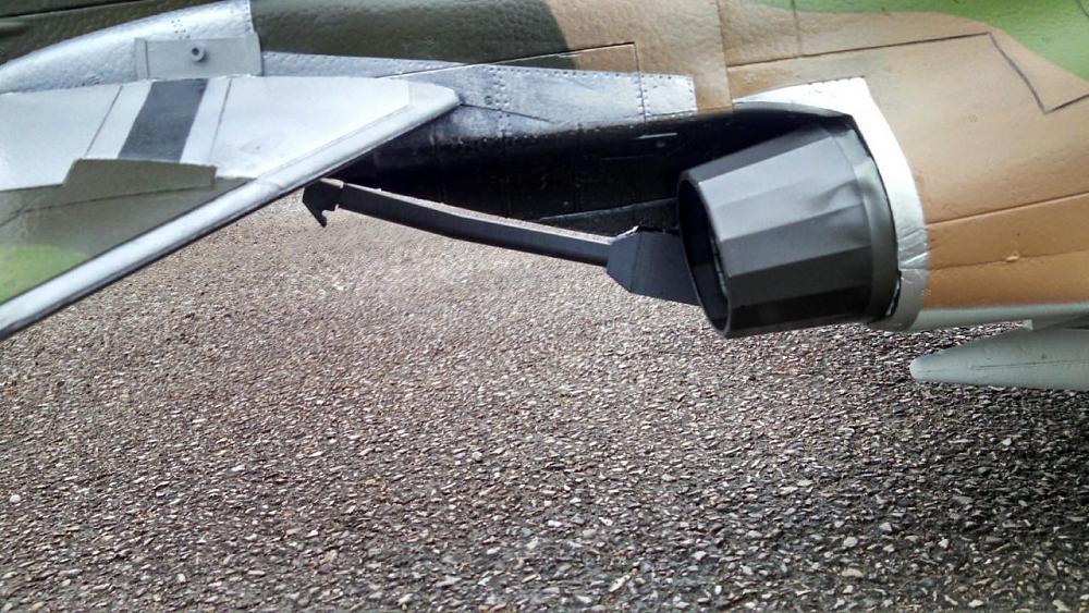

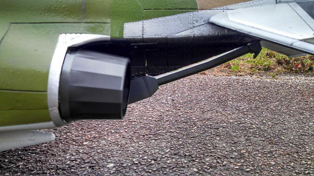

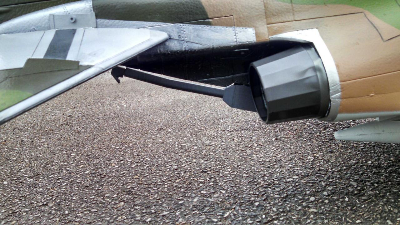

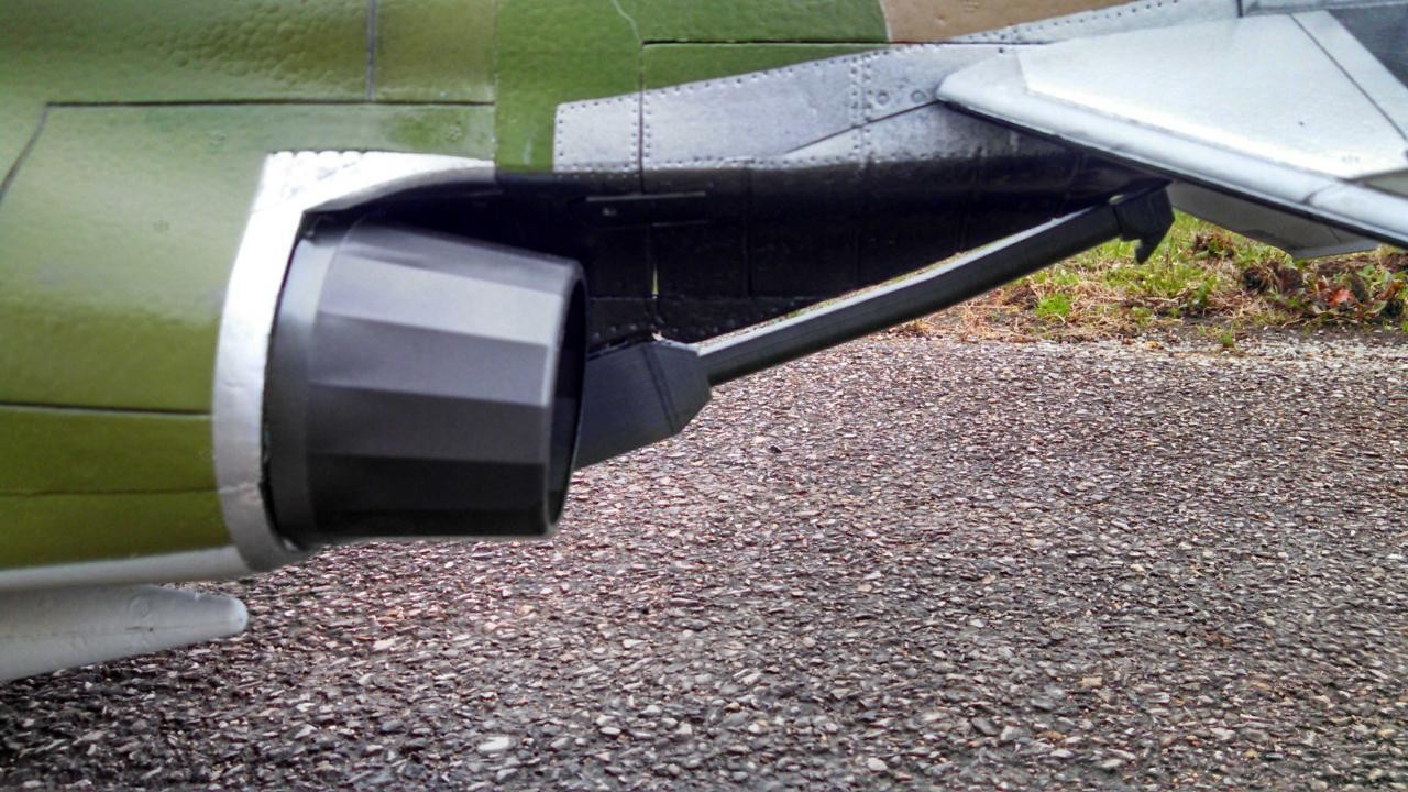

                              Hey Y'all, I know there is/was a 'location notch' for the OEM Plastic Nozzle, but when I removed those, the notch came out with those. My question is where is the 'notch' suppose to be? :Thinking: For example, looking forward from the tail section, RH-12:00, 11:00, ??:00 and LH-12:00 1:00, ??:00. Thanks in advance. Best, LB
                              • TMoyer
                                • 32
                                #3475
                                Looking at the back of the plane forward, mine were at approximately 1 o’clock for aircraft left and 11 o’clock for aircraft right. If you put them on at those positions and then swivel them a bit you can find the sweet spot where they like to sit.
                                  • 4838
                                  #3476
                                  TM, Thank You, Sir. Best LB

                                    This is what I did !

                                        E4DG, I am right at this point in my build and will duplicate your work. Thanks for the tip and the pics. Best, LB
