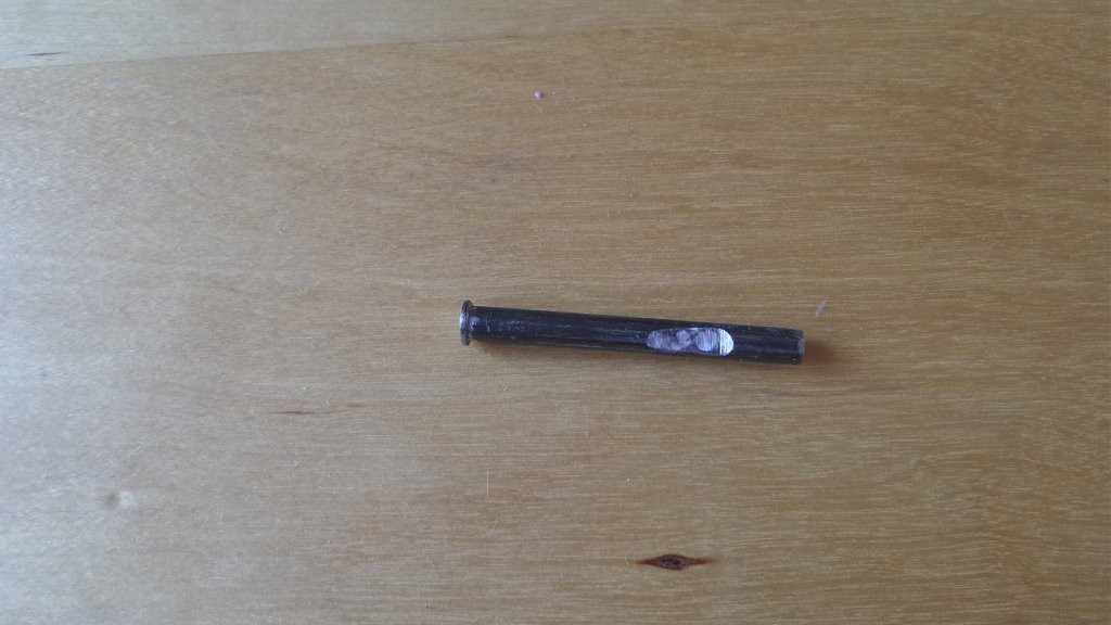

ID:	195718Click image for larger version  Name:	 Views:	0 Size:	106.3 KB ID:	195719 I've also improved the linkage before and made a new pin of better steel for the nose landing gear.

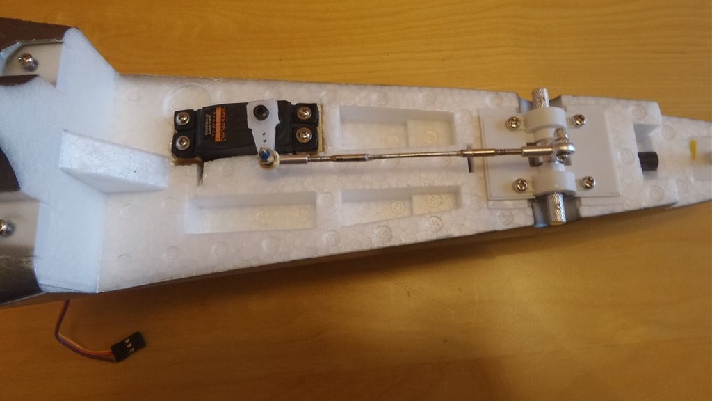

                                My Set Up !
                                The linkaga is exactly what I did. But I have a standard hi torque metal gear servo driving it. If the forces can bend the stock ball link, I figure it may need more torque.
