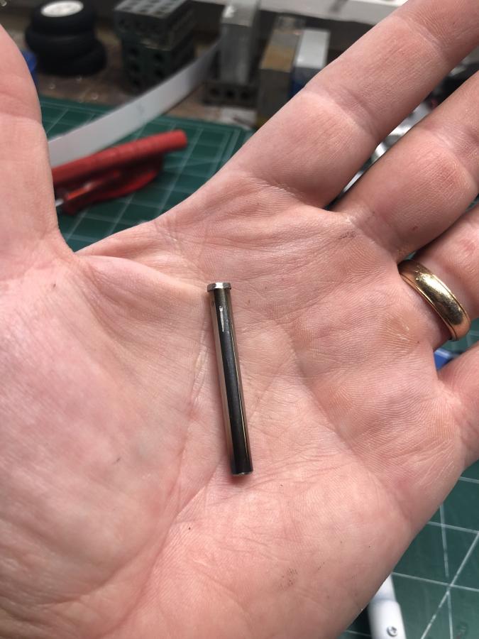

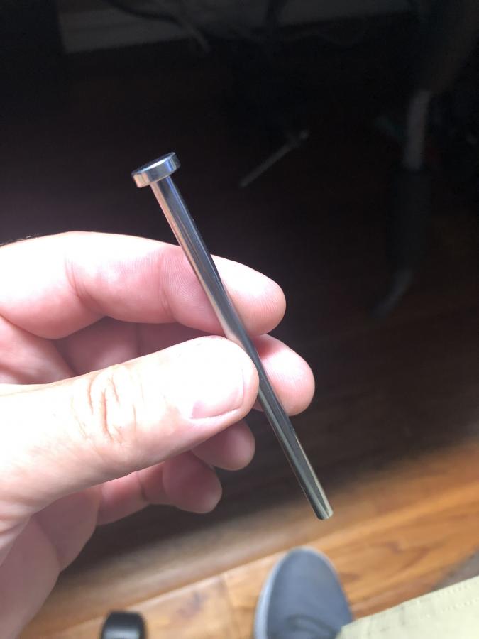

          I replaced my nose pin in phantoms 1 and 2 and will do so again with a pin from mcmastercar. You have some modeling to do ( grinding) but you can get it to work.
                          Or you can replace the nose gear pin with the 1600mm Spitfire main landing gear axel. The head needs to be ground down slightly to a smaller diameter and then grinding flat spots in the correct position for the set screws but the length is the same (for a while when this got in vogue they were always sold out). I changed them on both my F-4's early on when I was "learning" to land these jets correctly and only bent one nose pin. Now that I finally figured out how to land, there's been no problem. The stock nose pin is much stiffer but will break rather than bend on a nose first landing (and of course cause quit a bit of damage to the gear doors and nose), while the Spitfire axel will not break, but instead bend, a preferable option which only needs to be fixed by replacing the pin. I "bench tested" the stock pin by hitting it with a hammer and it took a decent impact to snap it, while a slightly less impact bends the Spitfire axel but you can't break it. Posted pictures and results maybe a year ago, but can't find it now. Of course if you land correctly at a slow enough speed on the mains first, the stock pin is actually more durable. I've since put back the stock pins on both (and you just know I'll pull a nose gear first landing tomorrow now that I've stuck my foot in my big mouth).

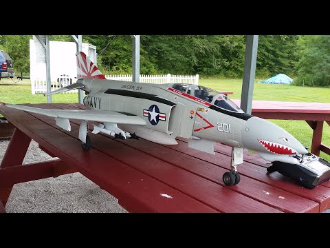

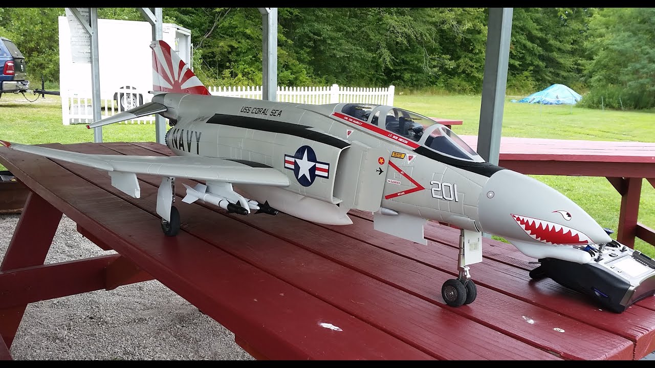

                                      Posting a video - this is from the belly-tank position using the "InstaGO 360" stabilized camera and a custom 3D-printed mount. This camera shoots a 360-degree video and when its played the horizon stays level regardless of what the plane is doing, which makes for some interesting shots. There are two flights - first one at my club field with a Geotex runway and the second one at a much shorter grass field. My model also has a Freewing Eagle A3-L gyro which really helps smooth out the flight.
                                      https://youtu.be/AH1bvB25zqI
                                      Click image for larger version  Name:	Cropped.jpg Views:	0 Size:	54.6 KB ID:	285009

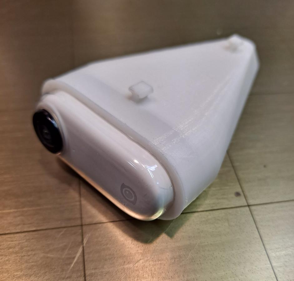

                                        Absolutely love your videos with that InstaGO! Keep 'em coming. Would you do me a favor and take a picture of the camera attachment so I can get an idea of just how you mounted it? Thanks.
                                          • 2715
                                          #4640
                                          themudduck that looks like a custom made casing for the camera. How did you make it?
