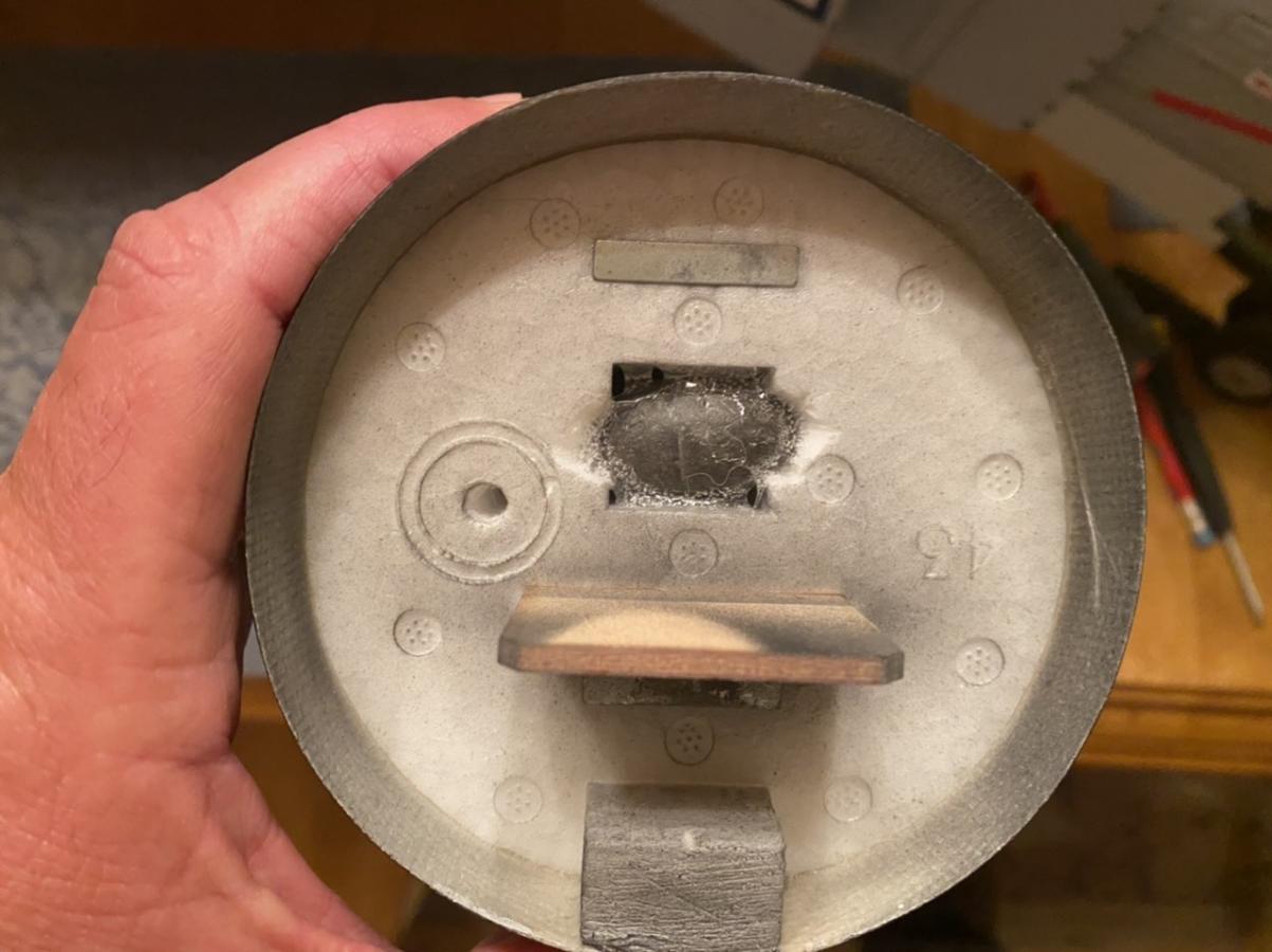

                        After not receiving any replies I bit the bullet and glued 3/4 oz lead egg sinker into the base of the nose cone. This gave me a balance point of 195mm. I can always remove it later if I feel I can move the CG back.

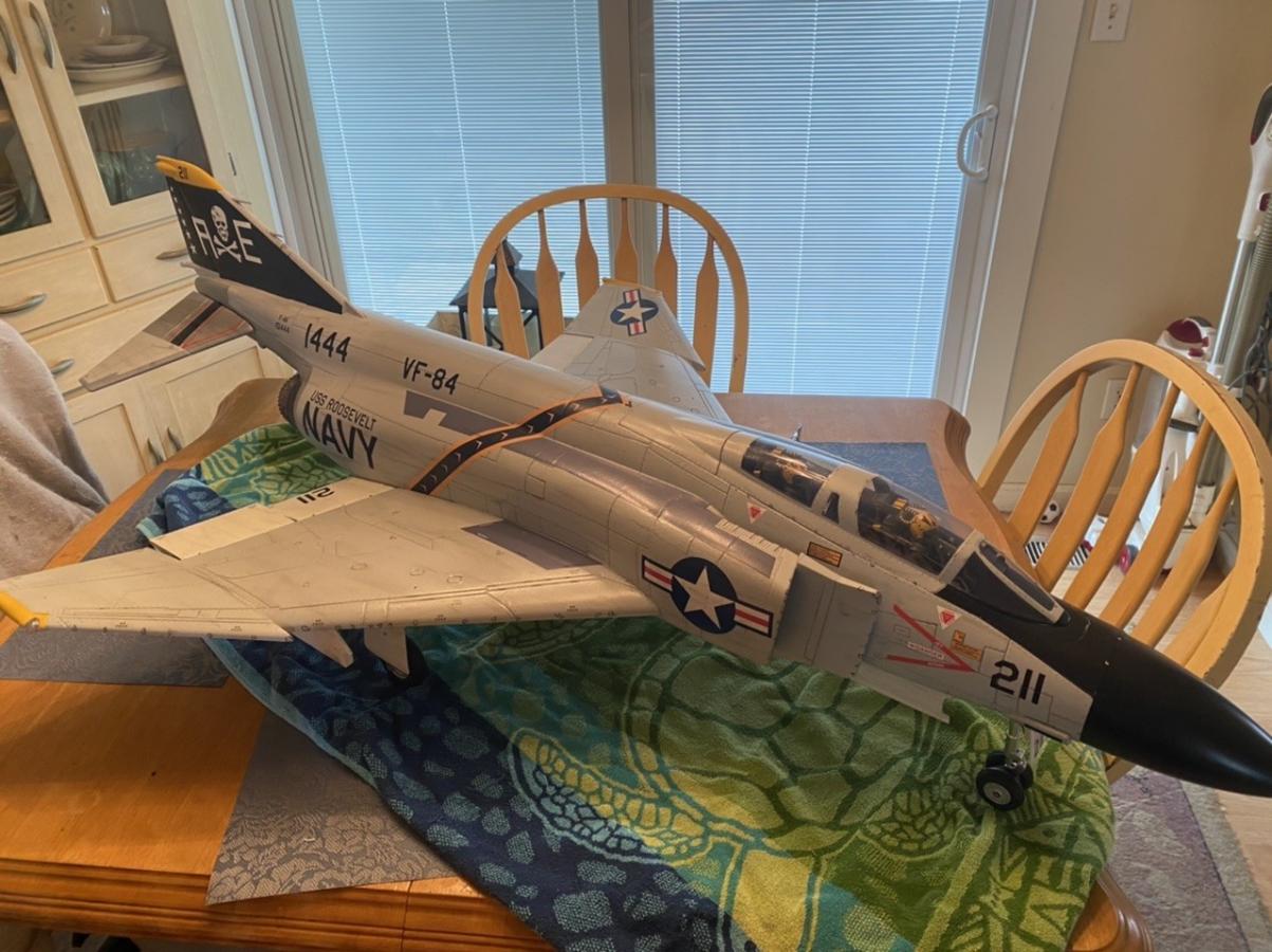

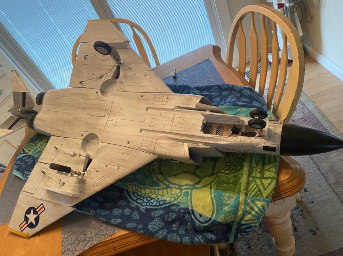

                                #4555
                                While I had the F-4 out I decided to weather it up a bit. I think it looks better dirtied up a bit.
