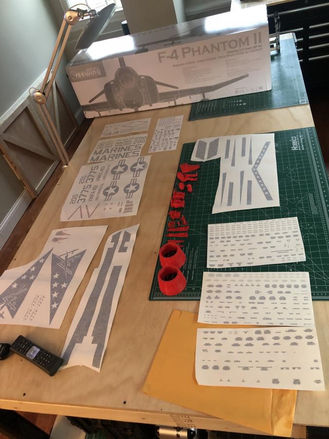

                          Starting on my 3rd Rhino! 8S ....

                              Thanks Elbee.
                              I redid my entire shop to make finishing projects more streamlined. Hope to have a regular cadence of progress. Will be modding the nose gear with a case hardened steel pin, and modding the elevator servo mechanics utilizing a JR digital servo.

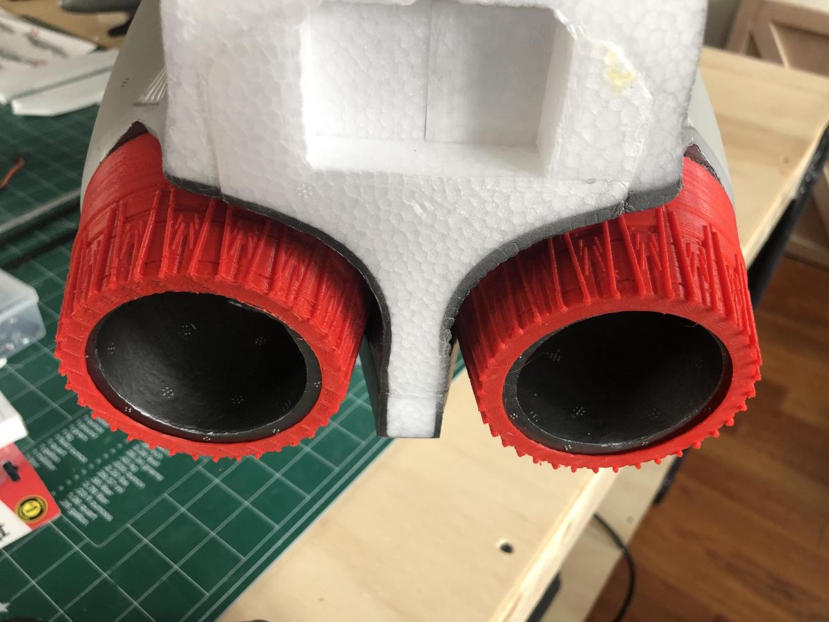

                                  Digging in ....

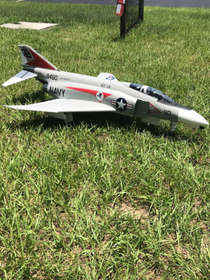

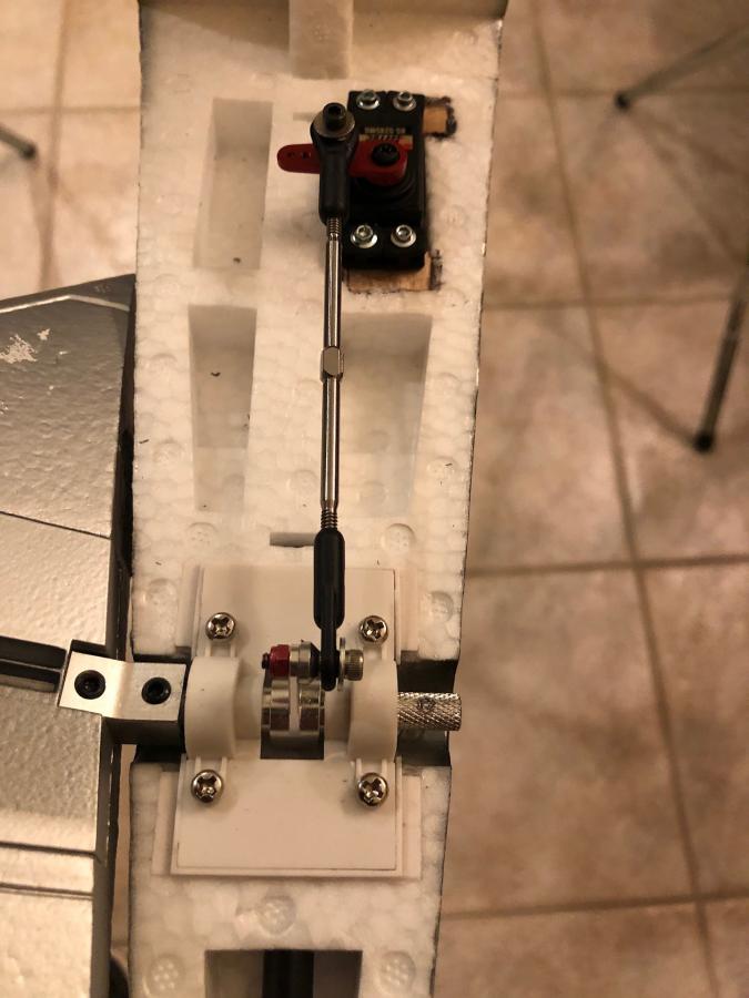

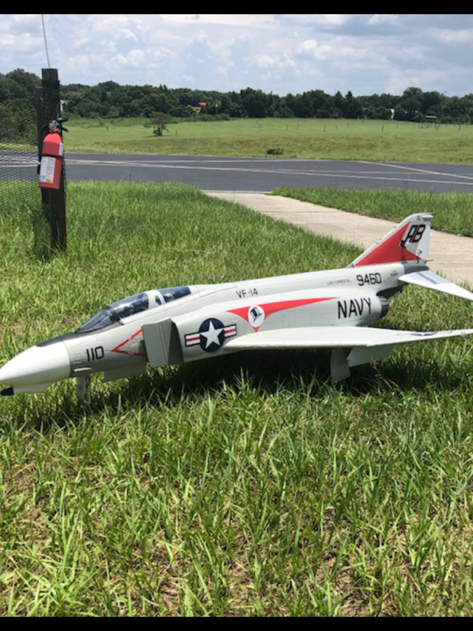

                                    Hi everyone. I’ve not posted for a while so I thought I’d post an update but want to first thank all of you that we’re so helpful to me in the early days of my 8S F4. I really love it in all respects - look, flying capabilities and the absolute ease of taking it to the field unloading and reloading compared to all my other aircraft.
                                    First of all my Phantom still lives. I have 60 flights on it and I have finally mastered it after some tough early days. Took me about 20 flights and a replacement fuse and 2 replacement nose gears to get the balance correct and land it very well consistently. As some know, I fly a variety of turbines as well as large scale aerobatic and warbird gassers. This plane was harder to land then those. I’m sure it’s been mentioned here a million times before that you have to land with power and the balance is critical. I actually added an idle to mine as I really don’t like throttling down and have no power at low stick.
                                    Here are some points on my Phantom that work for me. Some might disagree and I respect that as flying styles and throws are personal:
                                    -I did follow the numerous suggestions re the stock elevator set up and installed a Hitec 5345 with a 4-40 turnbuckle push rod and 4-40 ball links - all excluding the servo that I use in my jets and large scale planes - pic below.
                                    -I am not using a gyro.
                                    -My CG is at the suggested CG of 190mm. I originally used an EZ balancer that was inaccurate and inadvertently flew the first 10 flights with a CG of around 210mm which was far too tail heavy. Fortunately my F4 survived these tough landings. Once I rebalanced and achieved the recommended 190mm CG everything smoothed out and the plane flew great
                                    -In the beginning, I used the recommended throws on all surfaces except the elevator where I used my own lower throws as I felt the recommended throws were too much. I eventually changed the elevator throws back to the recommended throws and they are definitely better.
                                    -I found the admiral 4s 5000 mah batteries below expectations and I’m now using 2 4s 6000 mah packs that I bought from Amazon (2 for $95) that give me about 4 minute flight times that I’m still slowly increasing.
                                    -I ordered the grey scheme as I wanted a specific custom scheme. I ordered the custom graphics from Callie which were reasonably priced and arrived on time in line with her originally stated timeframe. I told her she could offer it as an option if she wanted to. Pic of plane below.
                                    -Lastly, treat the plastic clevises and other free wing hardware with care as they are very fragile especially the plastic pin that goes into the hole in metal steering part of the nose gear. I had to replace that clevis a couple of times and it’s not easy until you do it enough times to develop a system to make it easier. I now have a masters degree in that 😂😂
                                    Good luck with your Phantom. Feel free to post thoughts or questions. I’ll be more then happy to help as I was helped. Happy flying.

                                          Digging in ....
                                          E4, And so it begins.... Best, LB
