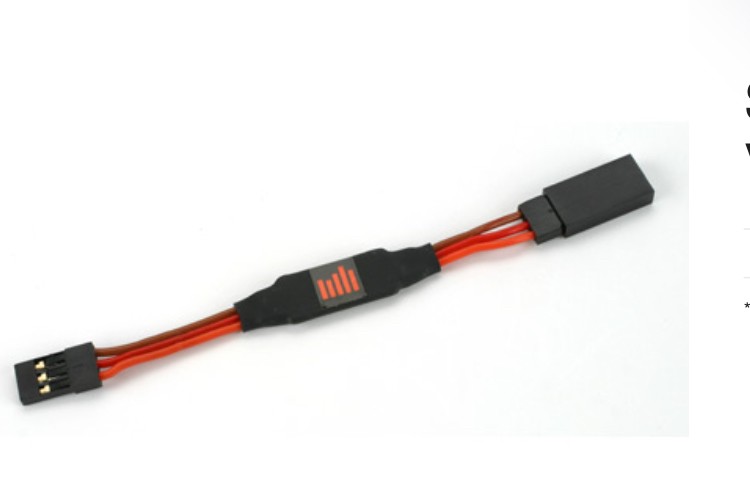

      re my control issues / signal loss in my f4, I came across this in another spectrum rx manual, I am using y-harnesses, no idea if they’re amplified or not? Is there a way to tell?
      “IMPORTANT: Y-Harnesses and Servo Extensions
      When using a Y-harness or servo extensions in your installation, it’s important to use standard non-amplified Y-harnesses and servo extensions as this can/ will cause the servos to operate erratically or not function at all. Amplified Y-harnesses were developed several years ago to boost the signal for some older PCM systems and should not be used with Spektrum equipment.
      Note that when converting an existing model to Spektrum be certain that all amplified Y-harnesses and/or servo extensions are replaced with conventional non-amplified versions.”

        Amplified will have circuitry....similar to this

            Ahhh! Ok, no... just standard y-cables then I think! Think I’m going to switch the Rx that’s in avanti (which works super well in that ) and see How that goes.

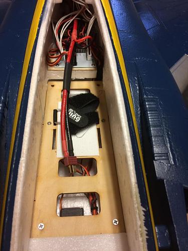

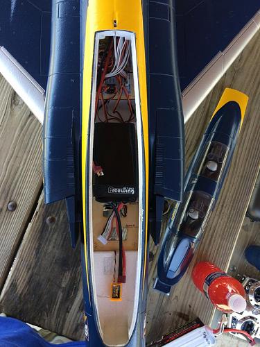

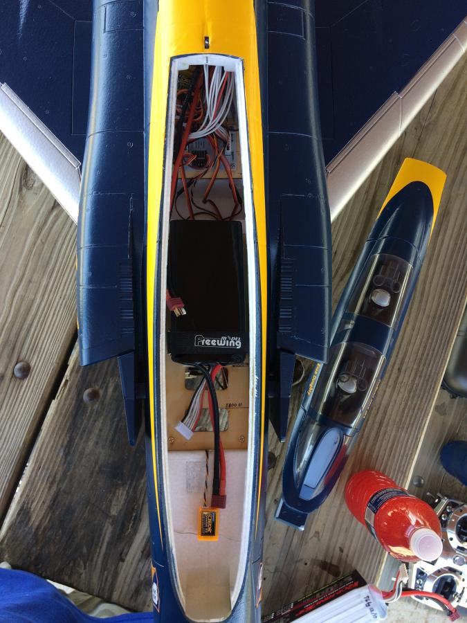

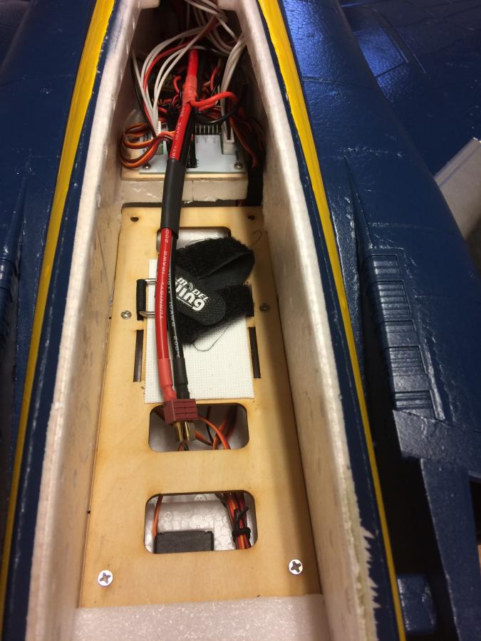

                    Mine's in the back of the bus with a satellite all the way forward... My battery bay may look funny because I moved my control/ interconnection board aft and cut foam to move batteries back. Then I moved the battery tray back and added a small square of foam in the front to cover the space. The pic on the left is how it looks now and the one on the right before I moved the tray. When I built it I was using 1050g 8S packs. Now I'm using packs that weigh 880g.
                    Click image for larger version  Name:	IMG_1343.JPG Views:	0 Size:	79.1 KB ID:	269840Click image for larger version  Name:	IMG_1205.JPG Views:	0 Size:	99.8 KB ID:	269841
                              Evan, please tell us what batteries you are using that save you so much weight. Thanks!

                                Not news as I've mention these in a lot of threads here and on RCG.
                                I have 13 (but four are for sale on RCG) of the 6S and 8 of the 2S. That site also has E Speed versions of the 5200 and I have 3 of the 6S and 3 of the 2S. I also have a few 6S/ 2S combos of the HS 6200's and I still have 3 of the the old Zippy Compact one piece 8S 5800's but they are heavy. Before Covid RC Juice used to have great sales and their sale prices were just awesome. Plus they would swap connectors for free.
                                https://www.rcjuice.com/lipo-batteri...o-battery.html
                                Using one of these- https://www.rcjuice.com/hardware-acc...-no-wires.html
                                And I have two of these- https://www.rcjuice.com/lipo-batteri...o-battery.html
                                All that said I constantly sell off batteries that start to get puffy when I find better ones available. It seems the newer HS's get soft faster than older ones I have. The E Speed seem a little better. I am really liking a new brand I buy from Amazon, Socokin, but have only bought their 3500 4S. I love them and already have a dozen of them. I have the three Flight line twin war birds, the P-38, Tiger Cat and Bronco I use them in, in pairs plus use them in a bunch of other4S birds. I hope they release more sizes.
