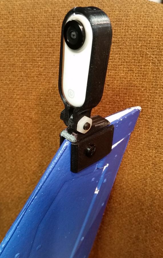

    themudduck that looks like a custom made casing for the camera. How did you make it?
    Hi Hugh, you're correct!! It was designed by a friend and I printed it using a 3D printer. I am going to post the file soon on Thingiverse.
    I also have a different mount that attaches to a vertical surface (like a tail fin).

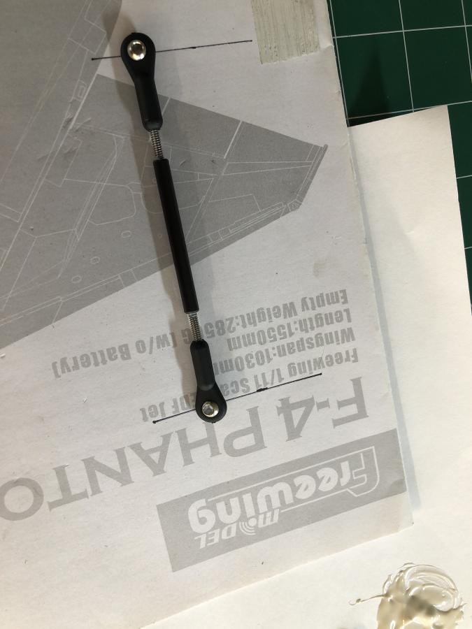

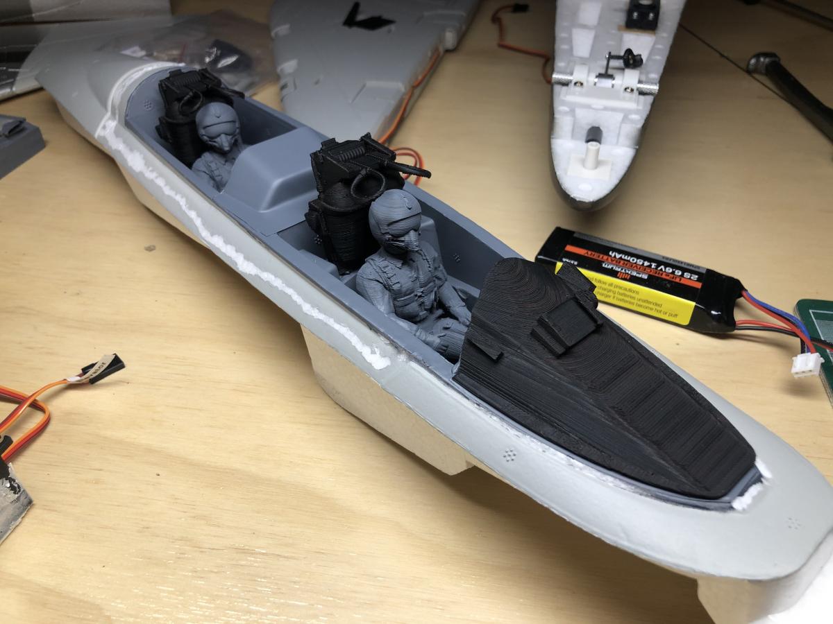

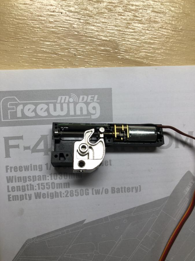

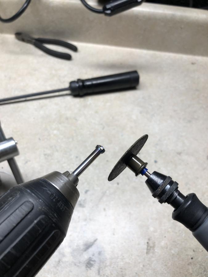

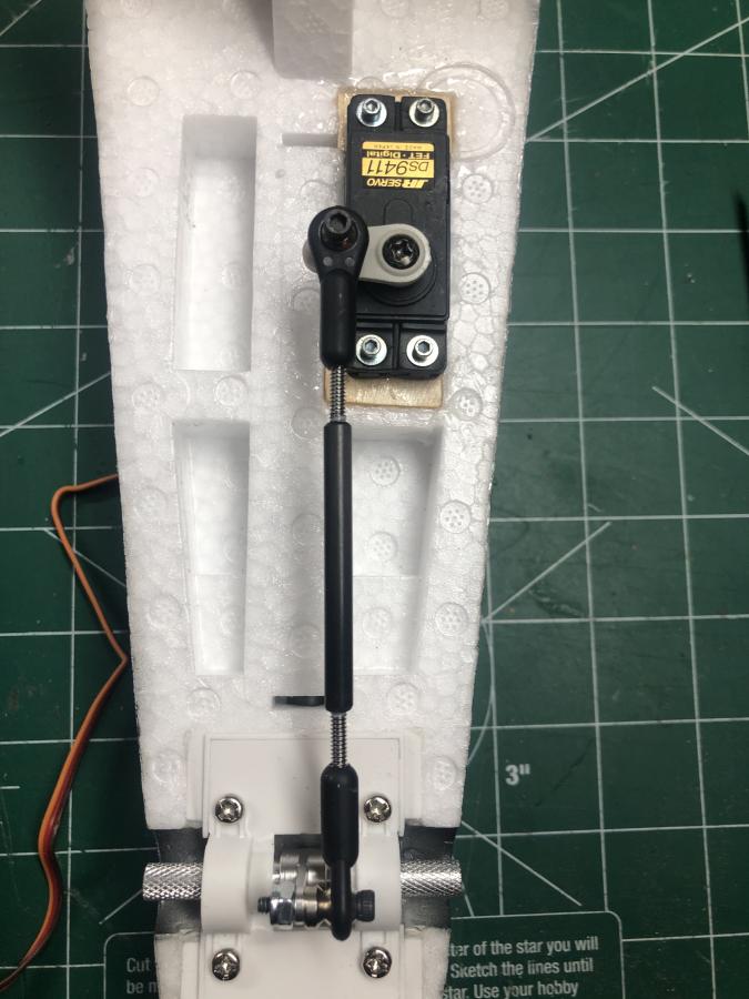

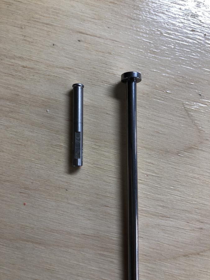

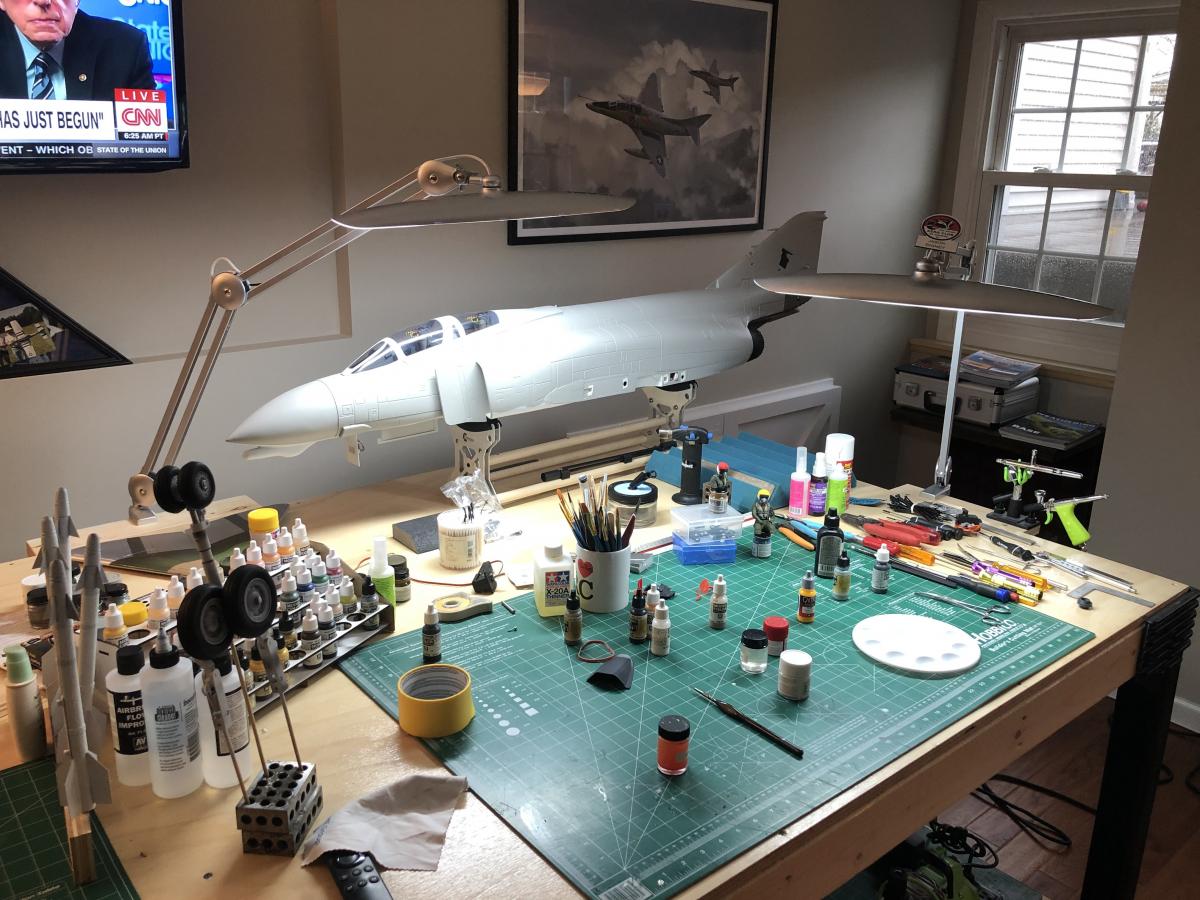

          Still making progress... Albeit work Is preventing more expedient progress..... Pictured is the Nose pin upgrade, the Elevator servo change and linkage rebuild and cockpit progress.

            E4, Lookin' good! Best, LB

          " Elevator servo change and linkage rebuild and cockpit progress."
          When I tested me tail servo after my crash it was juddering at the centre position like crazy, a result of the impact no doubt, although there was no actual damage to the tail of the plane. I've changed it out for a standard analogue servo about the same weight. It is a wee bit slower but apart from that it seems good to go.
          Any pros or cons ?????????????? :thumbsdown:

            The original servo probably broke a gear tooth or two.
            The analog servo won't be as strong, and won't hold the position as well. On the pro side, it won't draw as much current and it will be functional of course.
            I would hazard a guess that most of us won't recommend this for the Phantom. The elevator is under a lot of stress and you'll probably have better results with a good-quality servo and a beefed-up installation like you can see on E4Dragongunner's post. Motion's digital servos aren't very expensive.

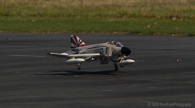

              My friend Brent Lane caught a few great pics of my bird during the flight where I took that belly-cam video a few posts back, here they are. I love the way this plane looks (and how it flies)!
              (the camera can be seen in the first pic, under the "stars and bars")

                Just love the pics!! Love the sundowners!

                    I never liked the idea of combining digital and analog servos, so I recommend you not use the analog one in the elevator either.

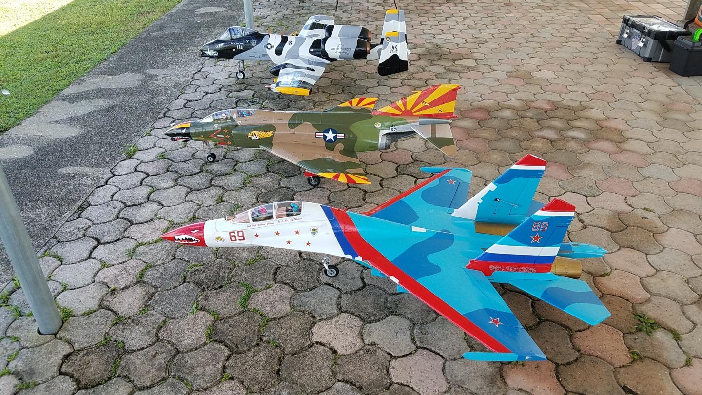

                              We finally had some decent weather today after 3 weeks of 45 mph winds and constant rain so I got a few birds out including the F-4. Definitely one of my favorite flying EDF's (but it did take me about 80 flights to get it there). Come on BenAtkinsonUK tkinsonUK, get that baby back up in the air. BTW, early on when they first released this, a lot of guys where complaining that the nose gear pin would break. I changed mine at the beginning on both F-4's because of those comments to a modified Spitfire Wheel Axel. In testing it, the stock pin was stronger, however, on a rough nose landing it would just snap instead of bending, where the Spitfire Axel was not quite as strong, but it would bend but never break based on my bench testing of the 2. Early on I did bend a few, but back then I thought I needed to land at 50 mph to keep from stalling. Now that I finally figured out how to land slow on the mains, haven't had a problem in the last 60 flights. But I did notice today that after some 60 flights on grass, the Spitfire pin was actually getting slightly bent, and to the side, not backwards. So I just put the stiff stock pin back in for the first time since I got it (hopefully my landings don't revert back to my original stock landings). So I say this just in case anyone else out there changed them a while ago and forgot about it, that pin is still softer than the stock and if you have mastered this F-4, you may want to go back to the stock pin, which is the same as the one in the A-10 and F-16, because after a lot of landings, at least on grass, it will end up bending slightly.

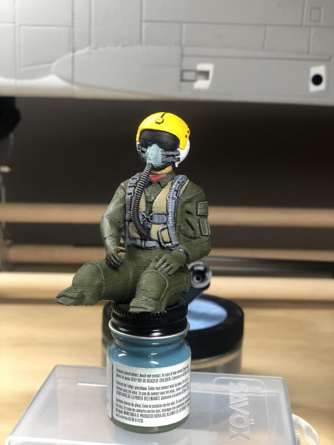

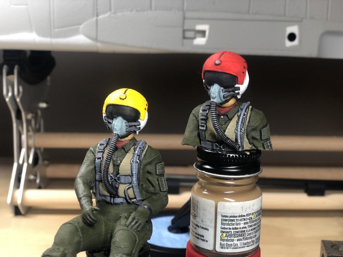

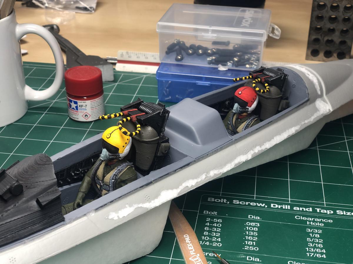

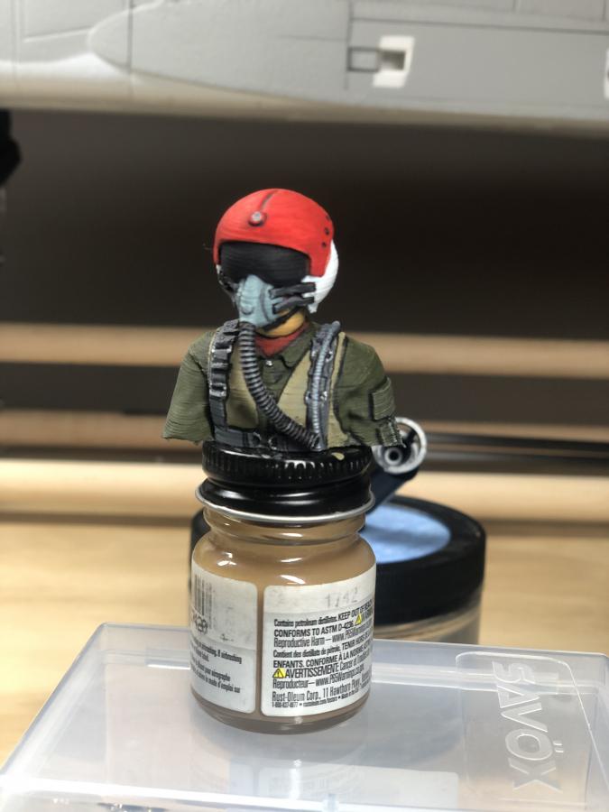

                                Some more progress.....

                                  E4, Now those are some handsome 3DP pilots. Great work, Sir. Best, LB

                                    Thanks Elbee ... Pre shading has begun.. Pics to follow.

                                      I have been searching through this thread (a lot of pages!). Can someone please direct me to exactly where the nose pin upgrade is outlined (if there is one)? Thanks!
