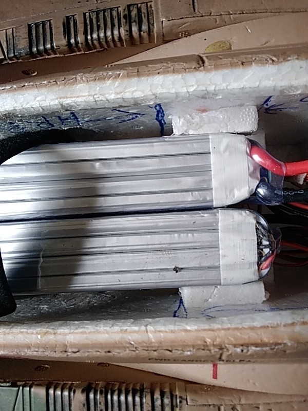

            8s done and dusted,,, wow like a new plane,, think the xtra 300 grams makes it more locked in.. take off speed reached way quicker,, flys well at 50 or 60 percent throttle,,, awsome value up grade,, i think its an 8s plane..... for sure. Flap mix is out now so cg must b a bit different,, 4.5 minuts mixed at 3.75 per cell did glue Click image for larger version
ID:	401828 in little foam blocks to stop battery wobbly wobbly with 1 strap

              Excellent News, f4u aussie!! Looks like you have a great combo there using 8S. I think if I buy another F4 someday, I'd start it out at 8S power. Mine does ok right now, got lots of flights on it with 6S, but I'm intrigued to see what it could do with 8S power, especially up here at 5000' MSL!
              Good job!

                Welcome to the 8S club!!!🤙 Told you you'd love it. I believe this model is made for 8S. Even more stable when it's a bit heavier, also found it flies/lands better balanced a bit further back at 200mm where I believe my 6S was better at 194mm. Couldn't believe how much better it is on 8S. Changed my FW 90mm F16 to 8S also, a sizable enhancement all around, but the F4 showed the biggest improvement.

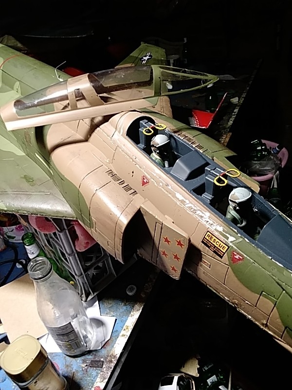

                  More learning to b had havin a go at detai cockpit. One small step,,, lotsa detail to do Click image for larger version

                    f4u ausie, I'd say you're doin' just fine; Bravo Zulu, Mate. Best, LB

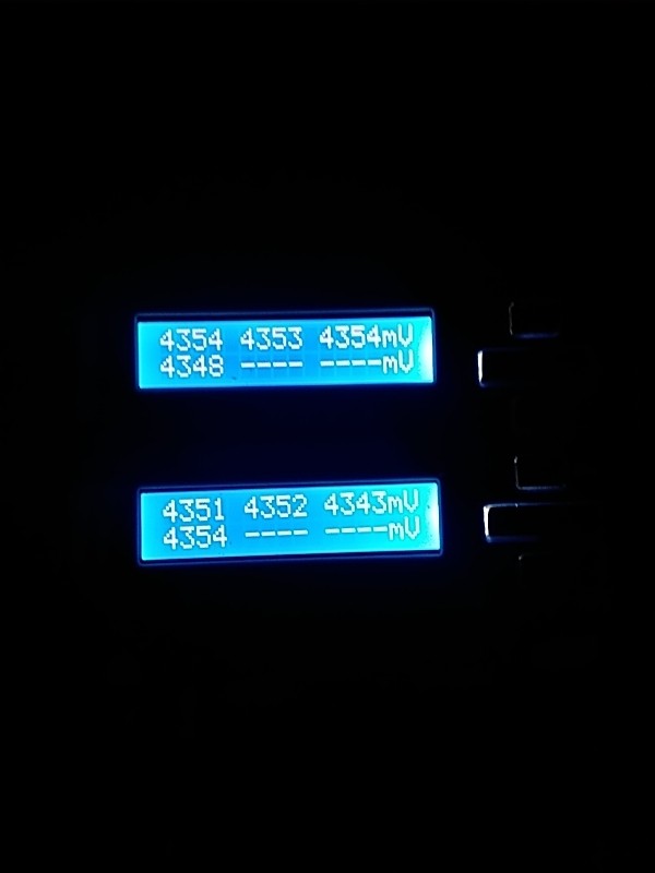

                      Hi team again more learning to b had,,,, i felt the need to Click image for larger version
ID:	403671 Click image for larger version
ID:	403672 try. And charge my ,, standard commond hrb packs to 435 volts per cell ,, nihv on your charger.... was nervous,, fires bla bla... last night a 6000 6s no prob to 435 per cell... tested at around 4 minuts al37..... instead of 3........ so tnite after work,, 2 4 s 6000 hrb 8s volts per cell as u c 435 per cell.. pics for proof.. goina bench test for time let yas no

                          WOW, you got some major cajones! :exploding_head: (Don't feel bad if you have to look up the translation of that common Spanish slang) Keep a fire hose handy and give us updates on any potential bon fires, I'll bring the marshmallows. I'll probably just have to look West one night and the skies over Australia will be ablaze and most likely be visible from Florida! :fire:

                            Same thing I said, Hugh. It's like when you're trying to light a match. And it won't light every time you strike it. Until that one time. Then, BOOM!. You would hear f4u aussie telling his wife, "Honey, I finally got it to light!!!".

                              Dont worry i had a kangaroo steak ready,,,:see_no_evil: only time wil. Tell,, absolutely no heat charging to to 435,, hrb 6000 50 c 6s and then 2 4s6000 50c... danny told me he was testing cells currently,, only way to get hv packs here, was direct from hong kong.... makes sence,, mayb a lipo cell is a lipo cell,, needless to say, all my lipos live in a ammo box,, inside a bigger ammo box,,, always have..... i too hugh have seen the nasty lipo,, i dropped it fully charged,, on garage concret floor,, within a nanosecond , i could not see the walls of my 20 foot garage,, kicked it outside ,onto the grass,, and watched the fun... least i didnt poke the bear like ya good self hugh ,, any way will update if needed we roll on them hugh i will trust ya spelling, never mine
