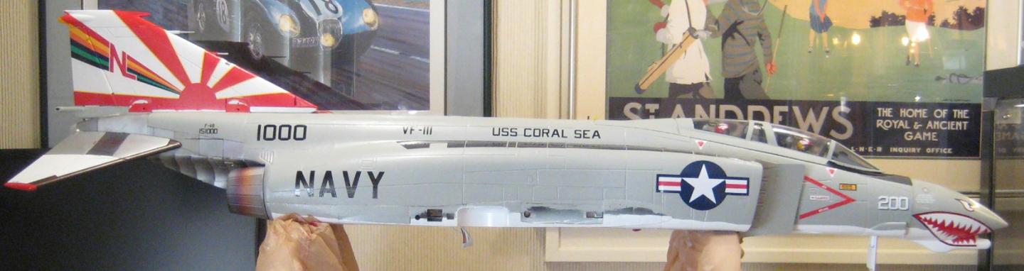

    Hey Y'all, I applied some of the 'big' graphics from Callie and the PH-4 is starting to look like the CAG's. I really like this part of the build when the airframe starts to take on some personality. Best, LB

    Outstanding, love the "burnt nozzle" work you did.
      Thanks, Hugh, I will tone it down with a bit-o-soot and some panel highlights but I like the idea of subtle heat staining. Btw, how's your F4U coming along? Best, LB

        ...I will tone it down with a bit-o-soot and some panel highlights but I like the idea of subtle heat staining.
        I am absolutely going to start doing that with my jets, especially the 3DPup nozzles...What's your technique? Looks fantastic!

          Hey Aros, There are a couple of vids in the yewtoob universe, though the easiest is get silver, bronze or gold tones, purple, blue and soot-like paint colors. I used a small turntable and airbrushed the exterior base black, then silver, then bronze to purple to blue to blackish tones spinning the turntable. Light coats go a long way as you can always add more. The next phase I will gloss clear then add some burnt iron/soot colors, highlight the inner panels with brightish silver to simulate the abrasion of the inner panels against the outer panels (very rarely added) and finish with matte. The interior is painted to simulate mostly soot. Hope this helps. Best, LB

            That looks real nice Elbee!

                    Outstanding LB!! Go Navy!
                      Thanks H52,:) I do like the VF-111 Sundowners livery, though might be a bit cliche' for some. It's all about the presentation, I think. Best, LB
