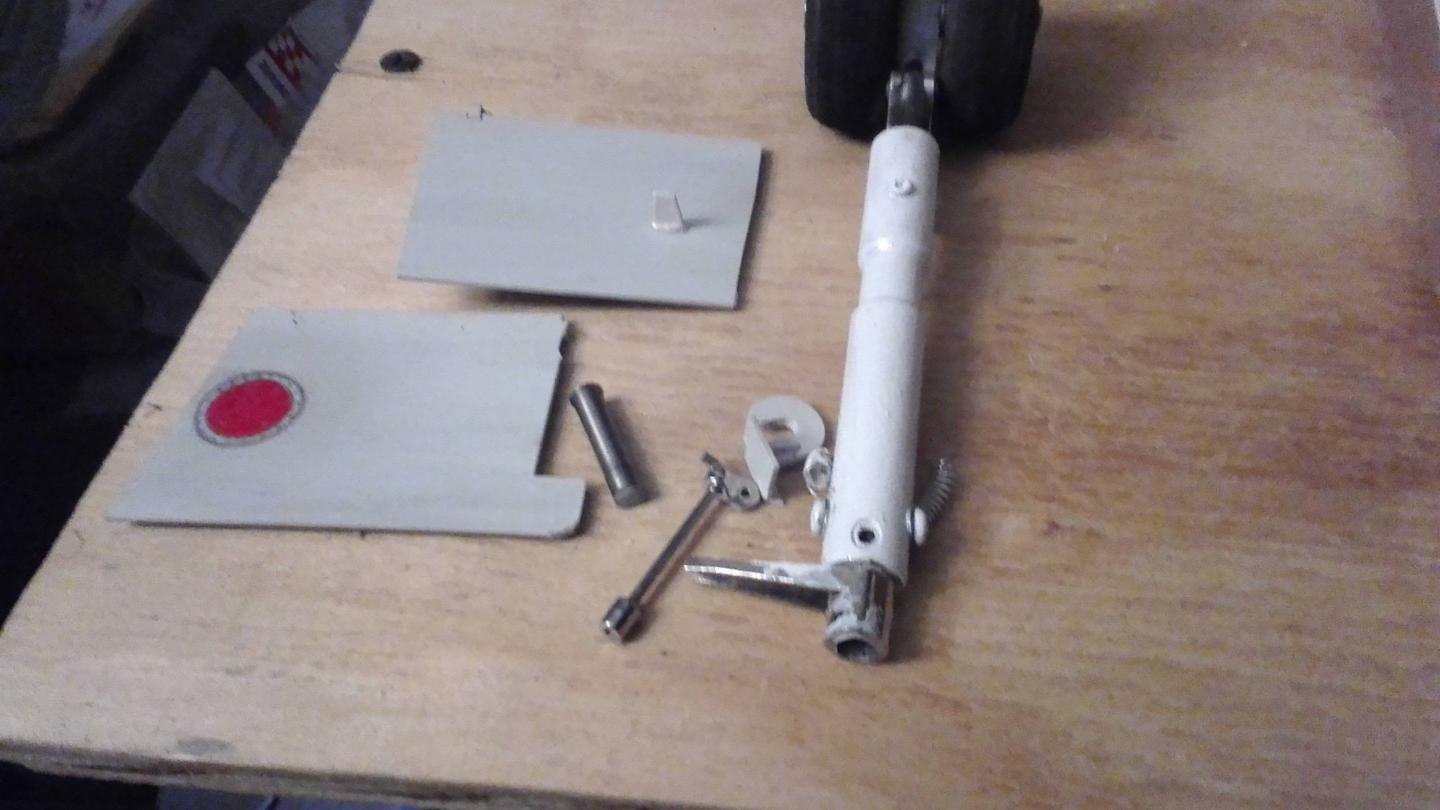

              My first flight Sunday was a little to fast on landing, hit a bump at the end of the runway and sheared the nose gear strut pin. Fortunately no other damage thanks to the grass. Going to try heat treating the new one when it gets here. Hopefully get rid of the brittle problem.

                #3387
ID:	185325 ​​​​​Broke my second one this afternoon during a routine landing. Get a lot of collateral damage on Asphalt Runways. Bummer when it happens Working on my No. 2 F-4 with a modified LongNose Conversion Kit from RCGeek. Need to solve this problem before that one Rolls-Out !! Click image for larger version  Name:	IMG_20190319_180522.jpg Views:	45 Size:	95.2 KB ID:	185269Click image for larger version  Name:	IMG_20190319_180523.jpg Views:	30 Size:	83.9 KB ID:	185270

                  #3388
                  Originally posted by Bobaroo
                  Try using the 1600mm Spitfire main axel. You will have to modify it a bit so it rotates freely by grinding down the larger end into a smaller dimension. See my post from earlier on the nose pin, post number 2619 on Oct 12th on page 131. The nose pin in the F4 is a hard metal that breaks instead of bending while the Spitfire axel is a slightly softer metal that will bend but never break, at least eliminating collateral damage. The axel will actually bend before the breaking point of the stock pin, but any hard nose landing will surely snap the stock pin off. Although I never broke one of the stock pins in my 2 F-4's, I replaced them anyway as I've done some detailing on the nose in one of them and did a blue angel in the other and the last thing I need is to skid down the runway on the nose. :Scared:

                    #3389
                    Try using the 1600mm Spitfire main axel... .. last thing I need is to skid down the runway on the nose. :Scared:
                    Like I did yesterday !! Yes, it was unpleasant.
                    The NoseGear is subjected to a variety of Stressors on a typical outing not just from Landings, but steering corrections on the TakeOff roll, Landing Roll-Out, even wobbling around during transportation to the FlyingSite in the back of the Truck are putting Loads on that Pin along with the Rest of the attachment apparatus. Yesterday's landings were superb, the Roll-Outs were interesting with the crosswind (I would have thought the tires were going to roll sideways off of the rims from the lateral loads the Jet was absorbing on the coast down), but everything remained intact. Maybe these Load Factors are cumulative !! Maybe these FW F-14 pins need to be changed out regularly !! I don't know.
                    What I do know is, a Steel pin should be of sufficient strength and elasticity to endure these forces indefinitely !! Steel pins should not be breaking without a bunch of Foam and Mounting Material coming up through the Wings on this Jet.
                    Thanks, I'll probably try the Spitfire Axels next !! See if this is the solution. Bending would certainly be preferable to the Snapping.
                        I've had the same isue and broke at least three of the pins upon routine landings. I've replaced the pin with a hardened one called "Zylinderstift" (cylinder pin) here in Germany. On the top side a little slot has been grinded and a c-clip inserted to act as a collar. No more problems ever since.
                        Click image for larger version  Name:	DSC04115.JPG Views:	0 Size:	91.9 KB ID:	185447Click image for larger version  Name:	cylinder pin.jpg Views:	0 Size:	8.8 KB ID:	185446
