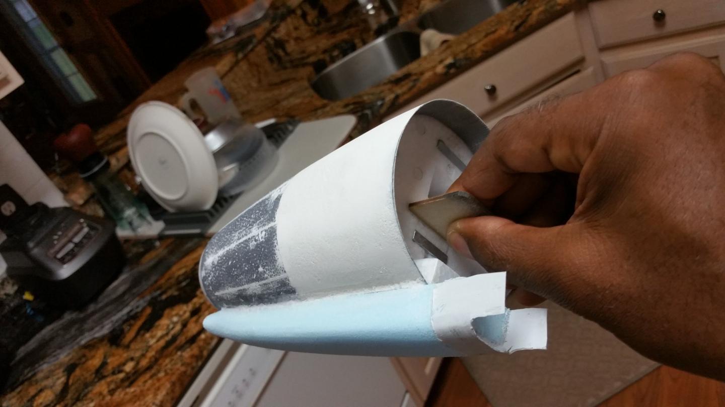

                  Expanding a bit on Herb and Boobaro's design, I added the full gun fairing. This total mod adds about 2oz more than the stock config, so I added an equal amount to the tail. I just didn't feel like working on moving the lipo back now.... maybe at a later time. If I had it to do over, I would use blue foam as boob did. I think I could have shaved off about 25gms.
                  I haven't flown it yet. Since there is a slight nose droop, as a precaution, I'm adding changing elevator high rate to 22mm vs 16mm. I'll keep 16mm as the mid rate. I also added 2 more magnets. Even with the wooden tongue, I was worried about the nose separating so I added 2 more magnets.
                  Forgive the off color on the nose... it's the best I could match by eye. It's actually not that bad in different lighting. I wish I had a Home Depot close by as the Lowe's here sucks. I give them a FSN and they look at me funny, then proceed to try to match using their color swatches.

                    Barron06, Great mod! Just add some weathering to your newly painted section and possibly feather 'that new' color into the OEM paint on the rest of the canopy and use it on other panels on the rest of the fuselage. Looks really good, sir. Best LB

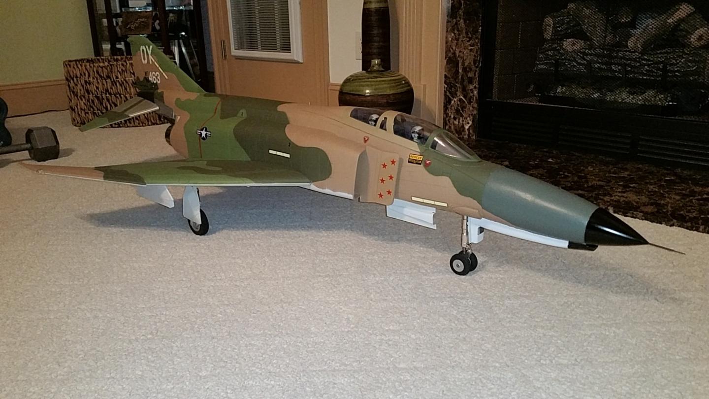

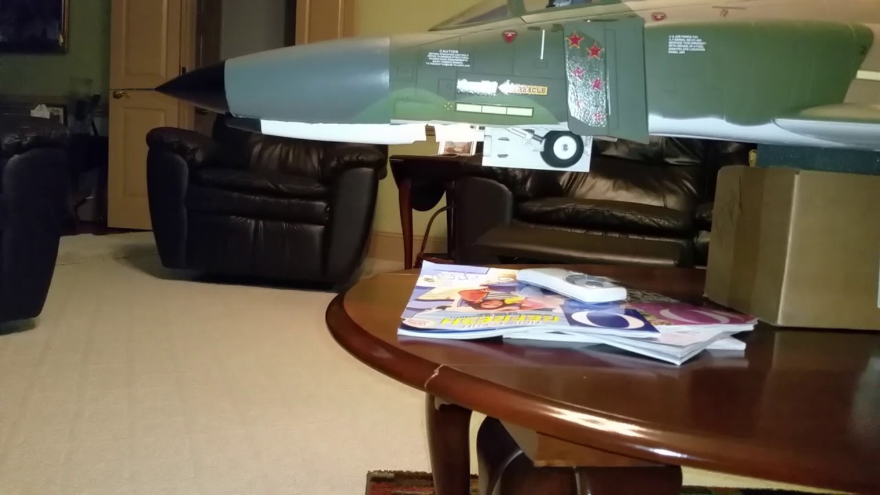

                                    Guys.... Please check my work. .... CG AT 190 MM. ( 7.5 INCHES) Gear UP!
                                    See photos ....
                                    Thanks,
                                    Reason I am asking is Pilot Ryan was starting that he cut the canopy on the 6S to get the batteries where he wanted em. .. This is an 8S. :-) looks good to me.
                                    Almost ready for Maiden.....

                                      I balance mine gear down with finger tips on the rear missile mount lug. It's close enough
                                        Yep, same here, it works.....:Cool:

                                          I also do gear up as 90% of the time is when its flying
