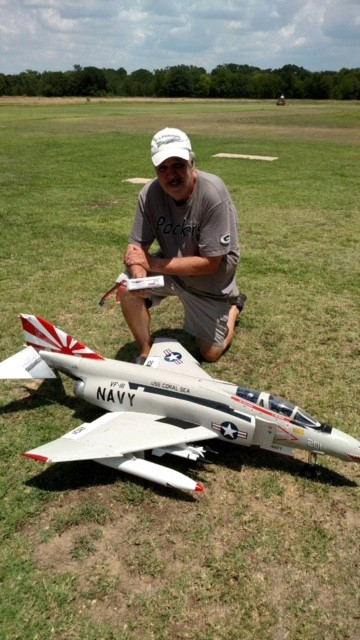

Name:	jetwerx 6000mah.jpg
                    So I went back to the field today to re-test now that I had gained an additional 400 watts ( +21%) by re-calibrating.. 2300 watts
                    Nobody around to take a vid, sorry. I felt it was slightly better but not drastically better than the maiden. Still too slow and believe me, I'm not asking for much. At least fly like a Stinger 90. She should fly faster than my A6. I used a fresh 6S 6000mah 60C RT.
                    In fact, Andy from RCjetwerx.com stopped by to see how I was doing. BTW, he has a bunch of these new 6000mah lipos coming. He's getting 4S 5000mah in too for the 8S crowd.
                    He did notice a few things that may be contributing to my low power situation. Felt that the Center Afterburner was clogging the air flow. I've heard a few reports of this but for as many negative, there 2X as many positive. And he noticed that the 12B Changesun with 1620kv looked like it was not mounted perfectly level. He could se e a gap and indicated that the fan appeared to have a slight downward angle. No Bueno . When I mounted it, I had actually taped it so it would be snug against the face of the bore so there there would be no gaps. Obviously something had changed.
                    Andy has a stock 9B setup he is going to let me try. I'll do that next without the AB and see how well she performs. If that doesn't show improvement, then I'll swap the no-name esc with a Hobbywing as I have the programming card. Might be a timing issue as a few have suggested but I want to eliminate one thing at time.
                    If that doesn't help, then I'm on to a hotter 3000watt setup.
                    Hawk

                      are you flying with ordinance?

                        ​​​​​​ your F4 Sundowner scheme looks awesome! you make me want to get a Sundowner scheme from Callie graphics!!
                        i agree with bbaumer. Ordinance on the plane will make a big difference in how sluggish it feels to you, and slows it down.
                        If I were in your position I would go with this FMS set up with your no name ESC.
                        http://www.fmsmodel.com/fms-90mm-12-...fan-with-motor
                        I'm tempted to buy it and replace the stock 6s freewing setup it appears to be that good to me. I wouldn't let the center burner that you have right now determine what motor combo makes you happy.

                          #2312
                          Tork,
                          Thanks and I appreciate your opinion. I was going to at least try the stock setup cause I have nothing to lose but yes, FMS sure does make some nice combo's. I have an 80mm FMS setup in my F-5 and it improved performance dramatically.
                          I can order an out-runner 3D printed LED holder from Chris. I do wonder if that's causing a disturbance to the airflow coming out of the fan. I've seen others fly with it and it looks like there's not an issue.
                          I did spend a lot of time detailing the "Sundowners" including adding black weathering to the rear fuse. The F4B was a huge smoke producer.Callie does such nice work on the vinyl. Have the 3D cockpit printed as well as some Aim-7 sparrows.. Now if I could only do miniature painting. Might check out AkumuZeta here. He does amazing work.
                          I didn't fly her with the tanks on. Just a picture for Andy from www.Jetwerx.com holding the new Roaring Top 6S 6000mah 60C so he could post on his Instagram page. I did fly her with the missiles mounted though.
                          Don't get me wrong she flies- well, okay, kinda, sorta. But I know it can be much better cause I've seen the stock models fly in person and they would pass mine by like it was standing still My A6 is is pretty slow but understandably so. It wasn't a Mach 2 fighter. This Phantom flies about as fast as the A6. For now anyway.
                          -Hawk

                            Hawk, think you were on the right track eliminate the center burner and try that.
                            I think everyone always wants more power. I was looking at the 8S setup but I couldn't justify spending that much money for just a small gain. I saw someone recommend the other 6s set up to you and after I check the specs. I wanted it!!
