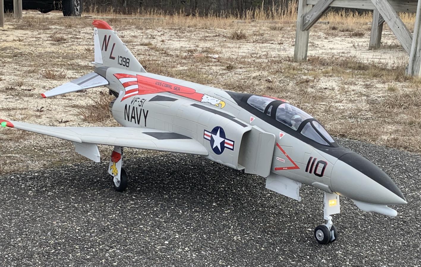

I just got my ghost grey 8S phantom in the mail. Showed up with the tail blue and all decals applied already. Wasn’t this airplane supposed to show up Grey and you do all the paint work and decals yourself??Current Fleet: Flightline Tigercat, Flightline Bearcat, Eflite Corsair, ESM Skyraider, Pilot RC Yak-54 30%:corsairComment
PN, glad to read you invested in another Phantom. Great livery choice and nicely done, Bravo Zulu, Sir. Best, LB"I am having an extraordinary ordinary life."~Lucky B*st*rd~

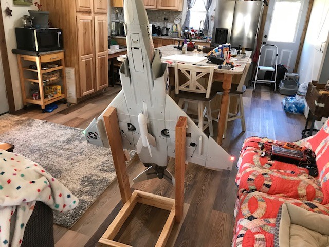

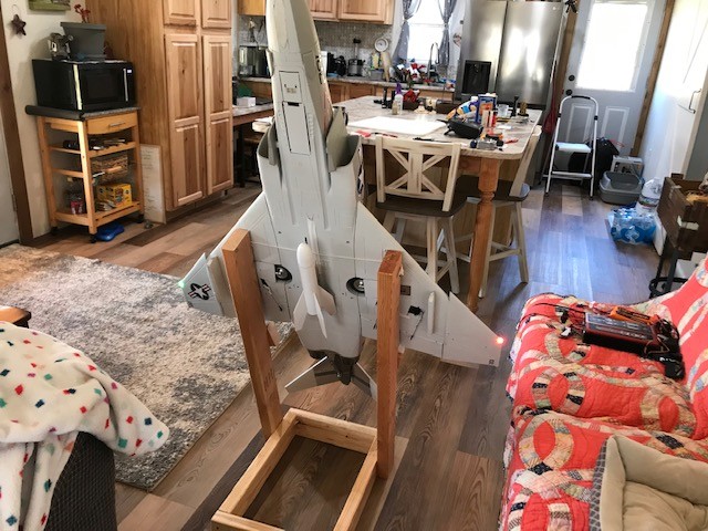

With the proof of concept complete with the successful A-10 launch of an Estes rocket I wanted to do another launch with the A-4. The more I studied the A-4 space was becoming the issue, there is not enough space in the A-4 for the triggering mechanism etc.. I then switched to the F-4 and studied the feasibility and concluded this could work and not be out of bounds for the authenticity of the real one. I remember loading target drones on the F-4 back in the early 80's, AQM something or other and I think they were made by Beechcraft, can't remember.
Trying to decide whether to launch slightly nose up or to ground attack in a shallow dive. I hope to have better videos of this shot than of the A-10 shot.5 PhotosComment
LB, it is a push button switch - OFF/ON. The servo when activated will push the button to on. That will complete the circuit and off it goes.JPR, is like a small mag to generate the spark? Quite clever it seems. Good luck, Sir. Best, LB

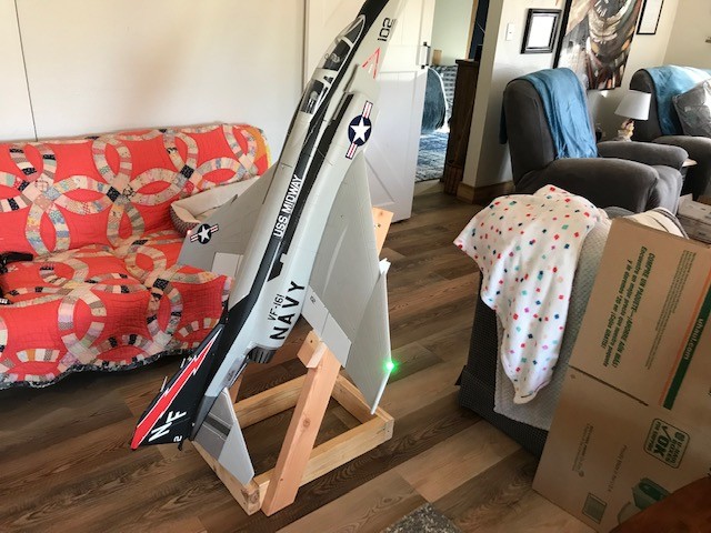

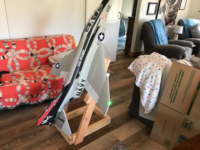

I made a stand to rest the F-4 on and will test launch the rocket today. If all goes well I will start test flights with the plane, the first being a flight with just the launch pylon followed by test with the rocket on but no firing. I need to know that should I have a miss fire she will land okay. I should have video of the test firing of the rocket this evening.

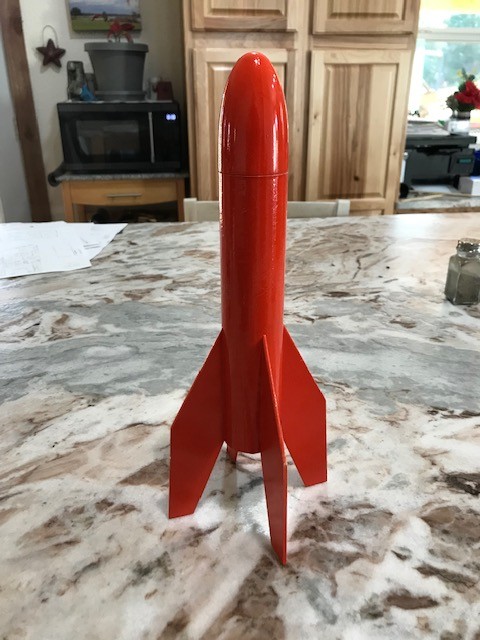

I painted the rocket Kabuta Orange in order to see it. I had my doubts about recovery but the chute opened and I was able to locate it in the field next door.

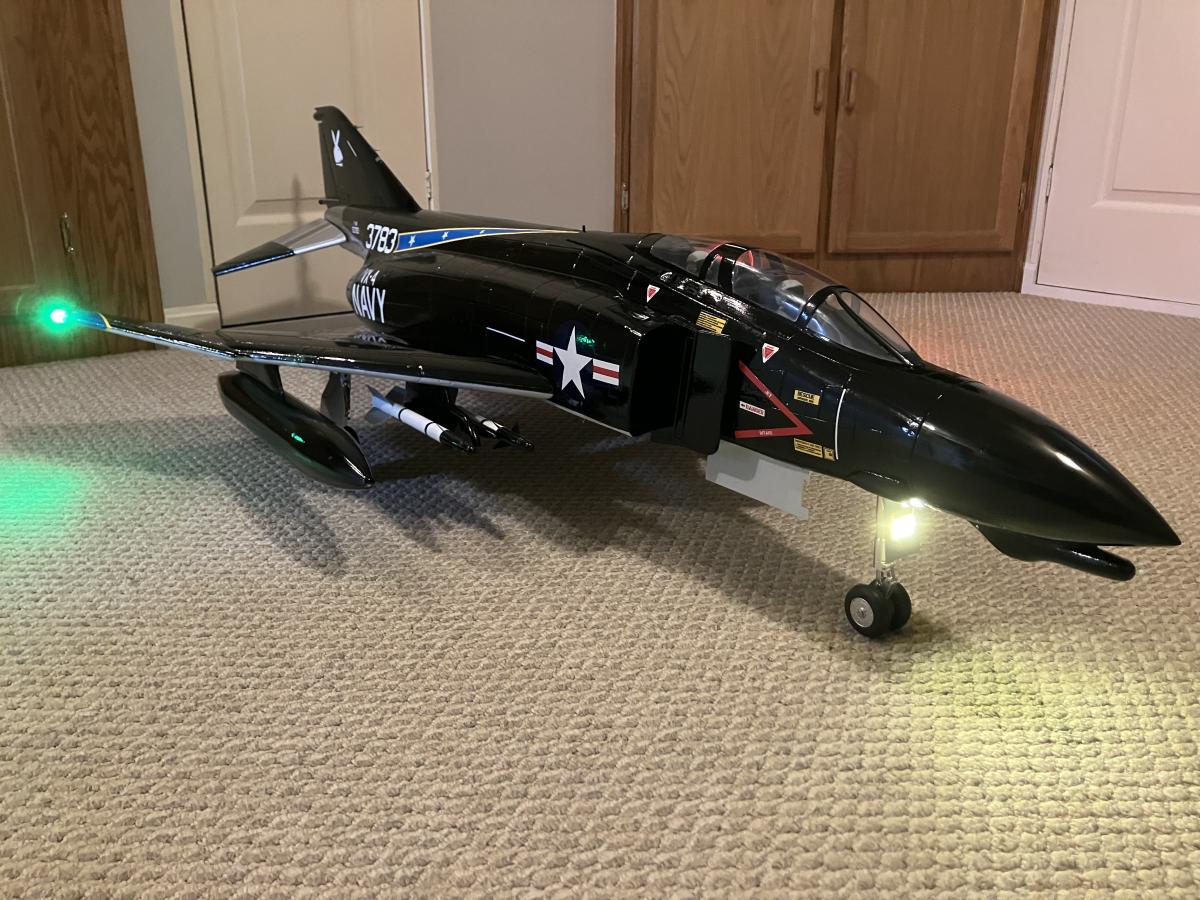

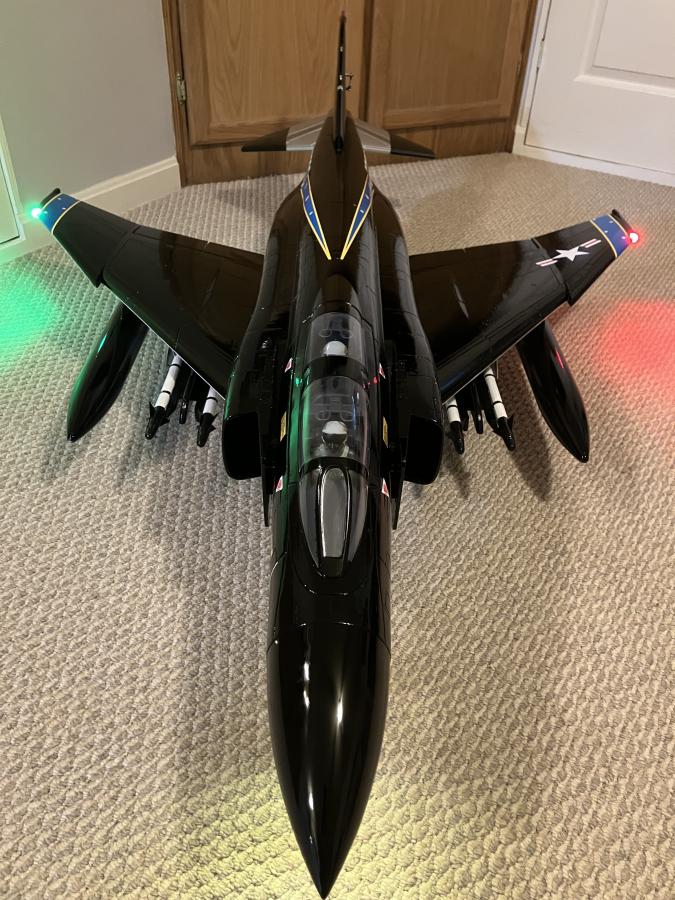

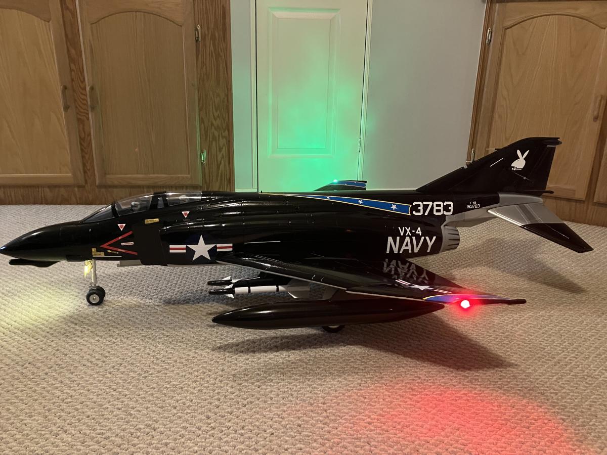

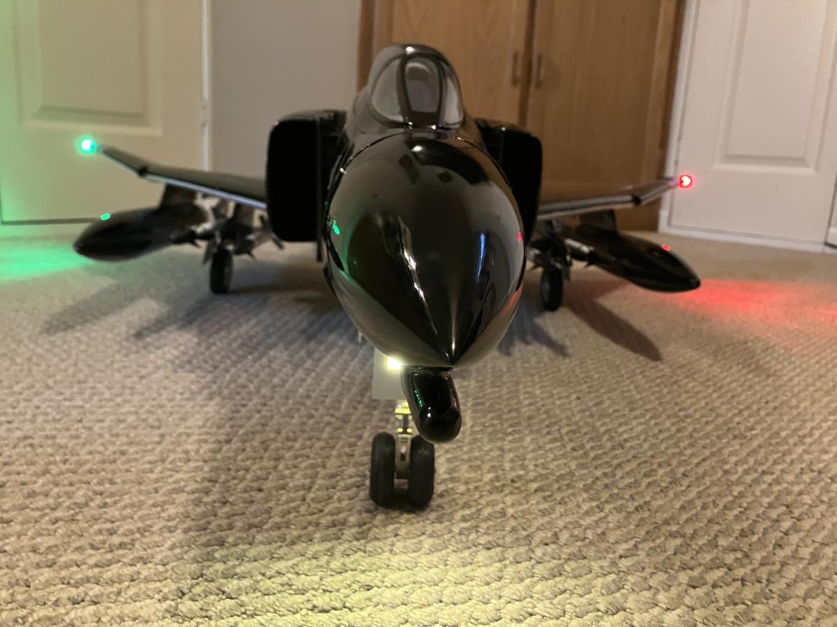

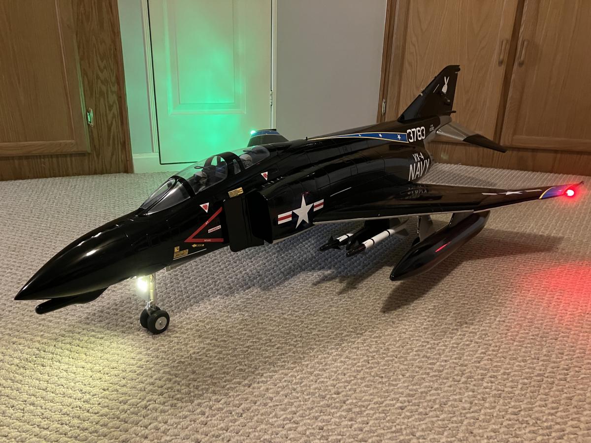

Just completed my build of the Freewing F-4 Phatom. Went with the Black Bunnies livery with graphics from Callie. I left the bottom of her the ghost gray so it would easier for my old eyes to tell is she is up or down in flight.
Equipped her with a FMS 90mm 3670-1950kv Inrunner 12 blade, Freewing 150amp ESC, Hitec HS-5245 servo for the Elevator. Also included an afterburner for the real jet effect. I've read through most of the posts here and adjusted throws and elevator to what most of you guys are setting yours. Setting CG to 190 to start and will see how that works when I maiden her in the spring. Alittle too cold here now on Cape Cod for flights. So for right now she will just look pretty on the rack waiting to get into the air.
